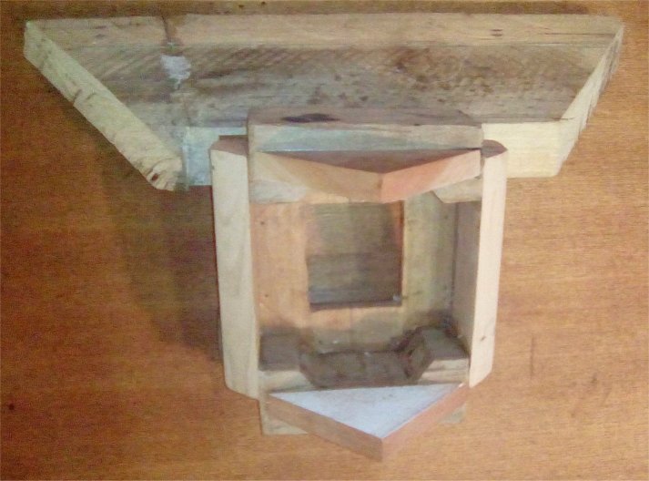

Being the corner sort of guy I am, when I say cylindrical it's more quarter space spherical lemon wedge style. With a 90 degree tweeter waveguide in the way though there are limitations.
For ~100-700Hz one thought is horizontal 90 degrees across the band and 60 degrees vertical at the top, rectangular pattern, to match power and avoid the floor. Vertical widens to 180 at the low end.
Alternatively 90 degrees circular, widening but limited at the sides. This concerns me as being tricky as I feel I'd rather keep the sides constant.
The thought of cylindrical came from the desire to keep reflections off the floor (30 degrees) down to three hundred and something hertz.

That's right, hence the squared pattern at the sides. I've gone over the theory from all the points of view I can think of. 90 degrees horizontal across the band and the floor bounce mostly managed. I had a renewed interest with the thought of an array/virtual waveguide.
Major issues were fitting the driver as close to the corner as possible without cutting into the drywall and ensuring the wavefront could function as intended. Then there's controlling the mids with the sides walls proper whilst allowing the lows to drop off onto the room walls. Then there's the issue of fitting it under the tweeter and still keeping it off the floor.
The front is baffled into half space (quartered), depends on the point of view for the frequency of interest I guess, but the DI can be made (in theory) to fall gradually and fairly consistently with frequency.
