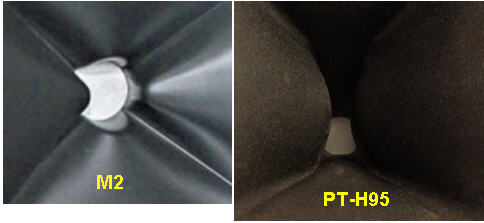

Hi Gedlee,
As D500 is 1-inch driver, I can imagine (from my experience, and a kind of approximation formula) that You can get quite good dispersion up to about (345/0.0254)*1.1 = 15000Hz
So, for 1.5-inch driver (as 2435), I can imagine that such frequency would be round up to [345/(0.0254*1.5)]*1.1= 10000Hz. If higher frequency would be of interest, then a kind of constriction has to be applied in-order to induce diffraction, but may be such solution is not so nice to for listening, so JBL have introduce more complicated slits shape ( M2, PT-H95 )
On most of the mentioned JBL horns it has been "applied" a kind of about pi/4*D ( D-driver mouth size)
slit in one plane (horizontal or vertical).
JBL M2 has more complicated solution, while on and PT-H95, such has bee applied in one plane, but not a uniform slit, as on the previous solutions (2380, 2360,.....)
Sorry for my bad English.
Regards
ivica

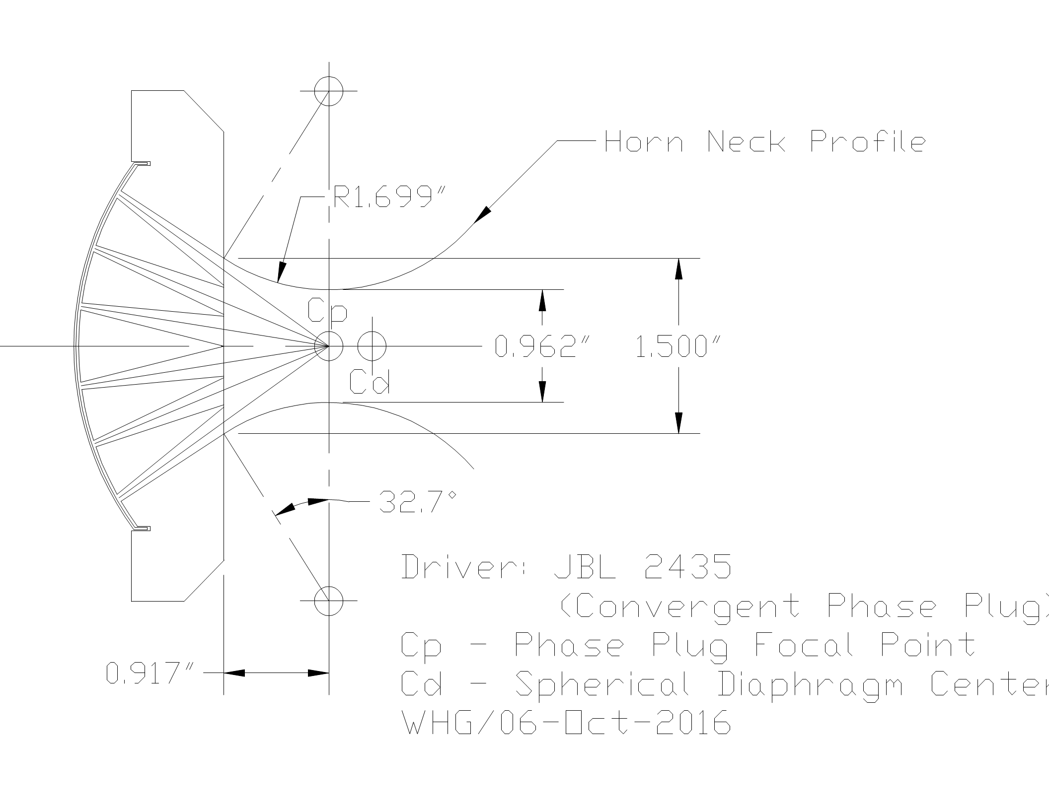

Barry,
Did you observe any curvature of the phase plug slits?
You don't need to put effort into this. I reckon you have another project that should be priority :D
Reverse Engoneering
Thanks whgeiger that's very generous of you. I'm using an Excel spreadsheet for the profile (based on the spreadsheets previously made available by Gedde). I only have to include a round-over to the mouth before I can say it's complete. If you're willing to approbate it when finished, I'd be grateful. Always better to have two set of eyes :)
You have confirmed my suspicion with the negative angle. The pase plug however do not use fixed angle for the slits. Do you know the optimum WG entrance angle to use with this CD? I believe it would be a compromise regardless?
BTW, to my understanding the throat profile lines (vertical + horizontal) would look something like the figure below - example with -15deg entrance for the purpose of illustration
Here is some 1st. approximation detail.
WHG

1st. Approximation
The equations in my excel sheet did not match up to the profile you suggested. Can you share your method for the iteration with regards to the curvature?
I simply used a circular arc to demonstrate the concept. I have no specifics on the bounding hyperbola you are using for your horn profile. I positioned the apex on the focal point plane. That may not be the optimum position.
Moving it closer to the plug exit will allow a larger ID at the pinch point. Curvature of the negative leg does not necessarily need to be equal to that of the positive leg. We are simply trying to get rid of the diffraction edge by using a 'gentle' curve. Try to make the curvatures materially match at the apex for both legs. WHG
WHG
Hi Whgeiger,
Very interesting drawing, but if it near the realty, that would mean, that wave front at the CD mouth is not planar, but spherical, as the length from the peripheral phase plug slits is longer then the one in the center, so may be the horn-throat angle has to be positive, in order that the horn-walls be perpendicular to the wave front.
From Your , attached, drawing it would be possible to get the radius and the center of such spherical surface that would "correspond to the" shape of the wave front.
Regards
Ivica
