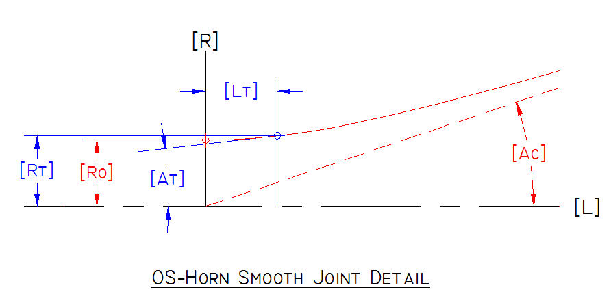

May this can help for calculating OS-WG horn profile:
Ro =driver throat radius
To = driver mouth exit angle
Te =coverage angle (form axis)
Then
ro = Ro*sqrt( 1 - [tan(To)/tan(Te)]^2)
Xo = Ro/tan(Te)*tan(To)/tan(Te)
y(x) = ro*sqrt( 1+ {[(x+Xo)/ro]*tan(Te)}^2), x={0……}
Regards
Ivica

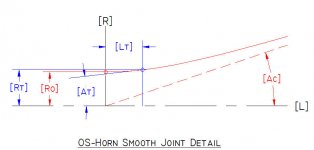

To be 'compatible' with previous drawing
(RT) =driver throat radius
(AT)= driver mouth exit angle
(AC)=coverage angle (form axis)
Then
ro = RT*sqrt( 1 - [tan(AT)/tan(AC)]^2)
Xo = RT/tan(AC)*tan(AT)/tan(AC)
y(x) = ro*sqrt( 1+ {[(x+Xo)/ro]*tan(AC)}^2), x={0……}

I have (AGAIN) made an error it has to be radius=Lamda/8
so it is better to see the figure
But here I want to emphasize that the loading of too large off-axis horn flare angled horn, would make very bad driver loading for lower frequency. I would suggest You to see the results from the:
http://www.diyaudio.com/forums/multi-way/103872-geddes-waveguides-717.html#post4062036
so over , say, 45 deg horn wall fare would suggest to use the driver may be over 2kHz.
Try to see the results from the famous 'HORNRESP' simulation program, and see the driver acoustical loading.
regards
ivica

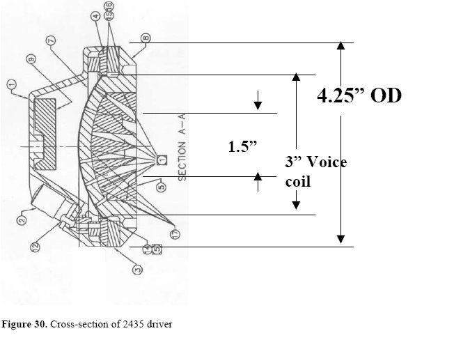

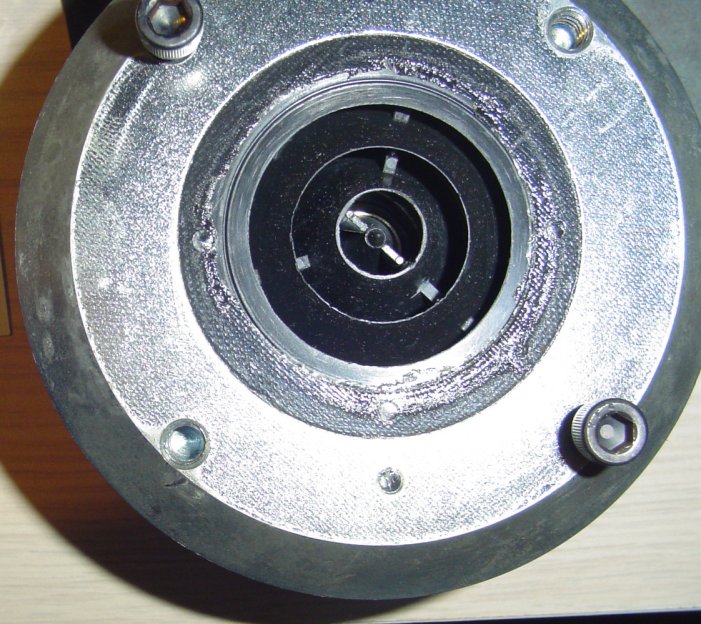

Hi
I am curious to try a larger OS with JBL 2435h (actually 90x60 EOS). Can someone please assist determine the optimum WG entrance angle to be used with this CD?
For information I have attached a picture (taken from Robh3606 at audioheritage) of the phase plug and a cross-sectional drawing from JBL.

Tie angle will be negative and to the left of the apex given the horn mouth on the right, If you need a sketch I can provide. WHG
Hi
Bill is correct, the angle will be negative and this poses some issues. One will have to do a reverse OS contour to some section with zero slope and then an OS which starts at a zero slope. The effect that this will have on performance is unknown, but I would not expect it to be good.
One could - and this is what I would do - assume that the wavefront at the exit aperture is flat (which is not very likely, but it is likely that this was the design intent). Then one would just use an OS contour with zero slope at its entrance.
Either way, this is not a good driver choice for an OS waveguide.
