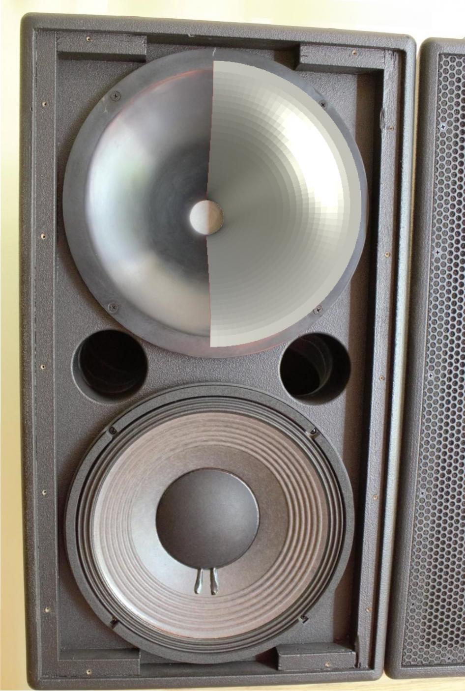

(Custom) OSWG by JBL?
Compact 2-Way monitor with a JBL 2206 12" and a 4" diaphragm/1.5" exit 2450, made to order by JBL Custom Shop.
