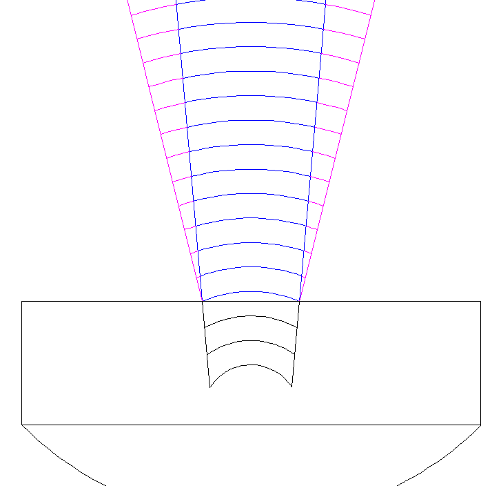

If, at the exit of a compression driver a wavefront has been brought together which conforms to a certain angle of radiation, and yet the walls at the exit are at another angle.. should the waveguide added from that point support the wavefront angle, and what are the potential downsides of this scenario?

I wanted to draw what I was talking about. Errors of this nature have come up before.
Shown, is a driver with 5 degree walls and an erroneous 14 degree wavefront (it seemed easier to use as an example). Blue shows the waveguide continuing the wall angle but the wavefront is never normal to it. Magenta shows the waveguide supporting the wavefront at the expense of a visual wall discontinuity at the throat transition.
Supporting the wavefront would seem the right thing to do, potentially reducing diffraction compared to the blue option. Apart from this, what negative effects could we expect from the visual wall discontinuity?
