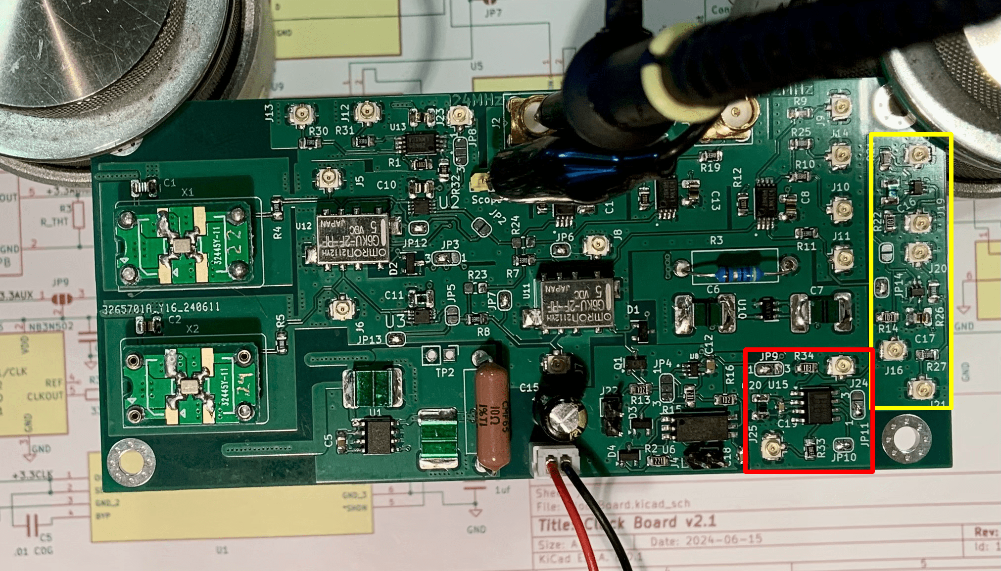

Clock board v2.1 (with PLL) is starting to warm up:
Found two old NDK SDA 22/24MHz clocks on adapters in a drawer. Area outlined in red is the PLL area. Its programmed by two solder jumpers. The contingency inverters had to be moved over to the yellow outlined area. Added about 2.5mm to the length of the board. PLL is correctly outputting 45/49MHz. It is (optionally) fed through JP14 as can be seen in the yellow outlined area. Also, right now the PLL is solder-jumpered to run from the Auxiliary Power regulator. In addition, the auxiliary regulator now has a 47R load resistor to ground. Another change is the clock dividers can be bypassed with solder jumpers (which they are in this case).
Will give it overnight to settle-in some, then try it with a dac tomorrow.

Hand Soldered with Hakko micro soldering rig, plus two Hakko soldering vices. Schematic attached; last time Microsoft Print to PDF failed so I had to take a screenshot.
EDIT: Added updated notes file.

Oops! Soldered the wrong relays on there
Correct relays should be here in a few days.
Other than that, it worked in the dac. However, my impression was the NDK SDA clocks sound rather rough at least as compared to much better clocks. Of course, maybe some more running time would help. Those particular clocks hadn't been run in years

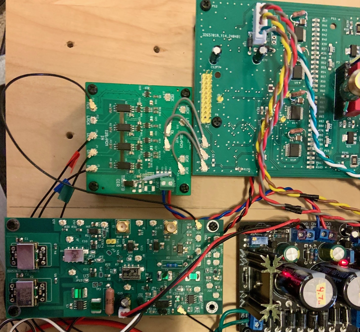

Clock Board with PLL is now operational. Fitted with 22/24MHz Crystek clocks at the moment (with .22uf Rubycon 805 SMD film caps soldered to the underside of the clock adapter boards):
Sounds better than NDK SDA to me. Always been my experience in the past too, at least of if Crystek are fitted with the bypass caps they like.
The USB board is now being driven at 45/49MHz by the PLL output.
Also, looking at the PLL output with a scope, looks like it is roughly in quadrature with the PLL input at 22/24MHz. However, reclocker board is handling the time shift fine. That said, if there were to be some timing problem, the solution could be one possible use for the contingency inverters at the end of the board; they could be used to introduce a small delay and or inversion if needed.
With that, I think this thing is working as I said I would do for the forum. Probably will upload supporting files later to today or tomorrow morning. As this is diy project with the full KiCad files, there will probably not a be a formal BOM. The board can be configured in different ways with some different parts values depending on intended use. The Clock Board Notes document should be enough to provide any needed information. If not, please feel free to ask.
The next topic should probably be what to do about a reclocker board (for those folks who don't feel comfortable doing their own). However, it may be that not any particular reclocker board design will be well suited to every dac.
Regarding the performance of Marcel's dac with the setup as it is configured here (except using an Iancanada clock instead of Crystek), it was starting to sound better than my Andrea Mori dac setup. Which is to say Marcel's dac can sound very good indeed with no output stage other than DC blocking into a line level transformer.
Would also note that while waiting for the correct relays to arrive, the past few days were spent modifying my Andrea dac. Its now back in 1st place but it took some doing. I have emailed Andrea to advise him of the changes.
