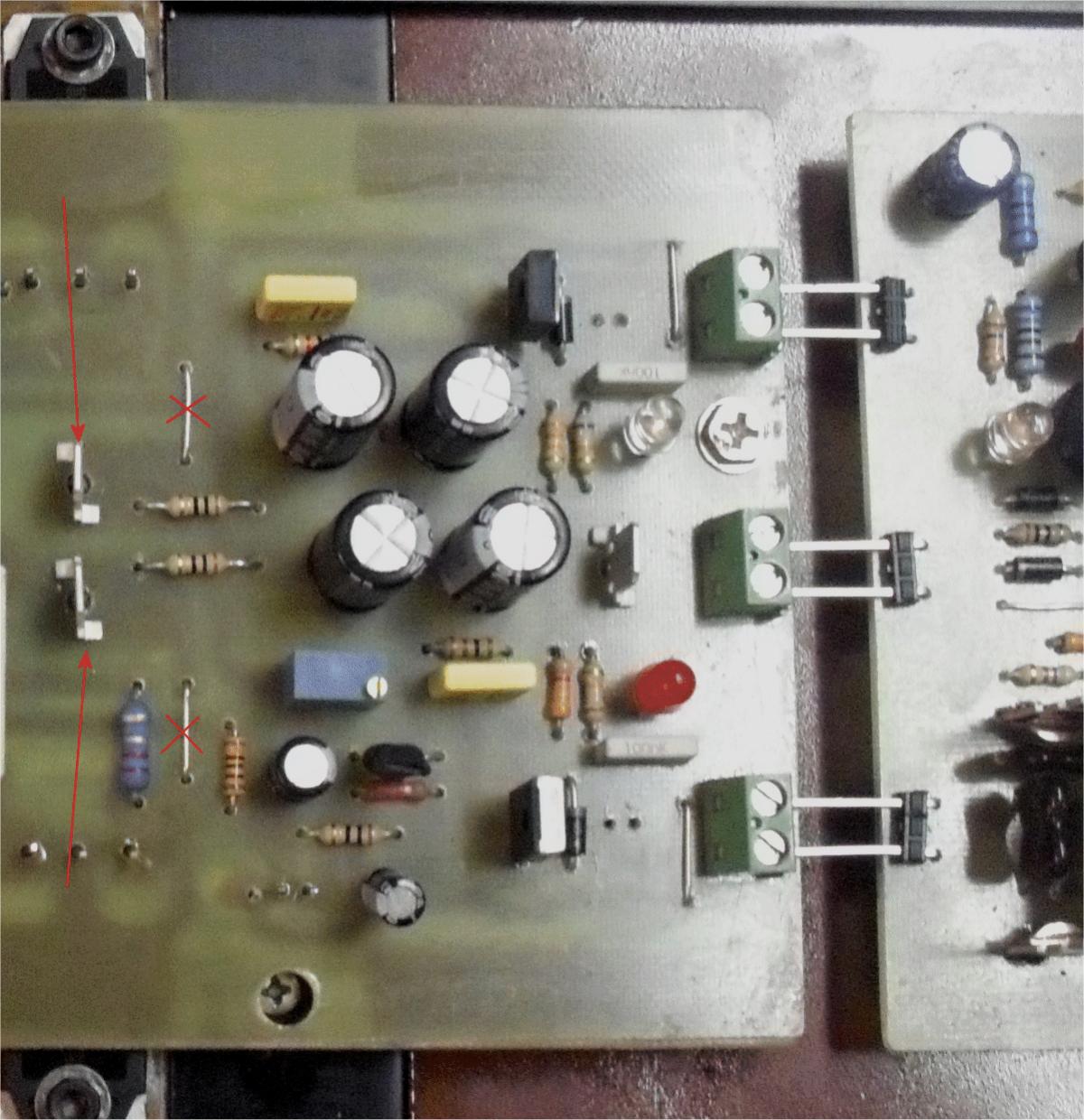

Anthony, I am not suggesting that this is the cure to the 7815 problem, but since you say this is a notorious for this particular the amplifier, using a diode across the in/out of the regulator biased in the direction so that the output cap can discharge bypassing the regulator. This problem may only occur once in a blue moon, but it can. In fact a very cost effective precaution.

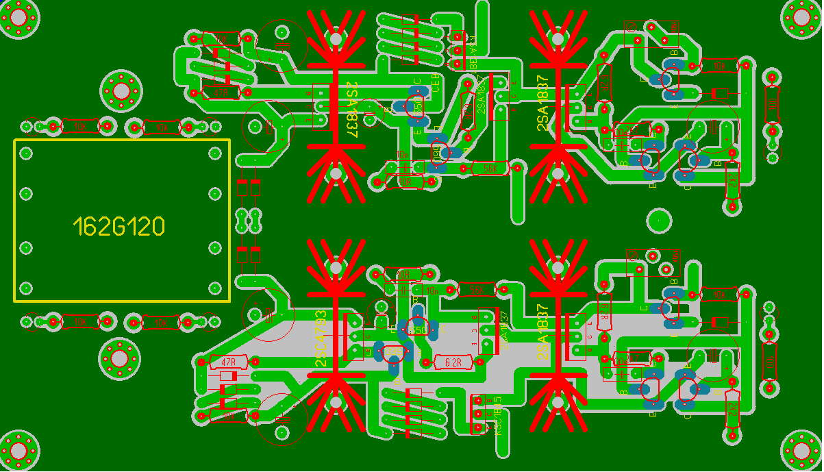

Ost Kris & Kean,
can the Mongrel physical size be adopted for this amplifier output stage?
That way we can use any of the Mongrel output stage with a gold input stage and we can use any input stage with the gold output stage.
Any combination we think might be worth listening to !
Some of the 6pins linking output to input will be redundant if a separate supply is fed to the input. I would keep all 6pins on all PCBs and use a removable link between two pads to cut off the Output fed power supplies to the input PCB.

could the 7815 be driven over voltage at start up due to discharged caps appearing as short circuits?is the cure to the 7815 problem,

Absolutely , Now that I've "standardized" with sprint layout AND have a handful of power Mosfets now , a Board will follow. Unfortunately , I tried my version of the GM and ended up with a oscillator (fried a zoble). I took out the BE and it worked. I now subscribe to nico's vision of simplicity and will most likely just make a goldmund clone with "simple" 4 transistor VAS , plug it in ... be happy.
You can listen to all the combinations in minutes , amp heaven.
BTW , I even use the "diode" (reverse bias protect) on my multipliers. The voltage boards are so efficient that the output cap on the multiplier will stay charged reverse biasing the transistor , same as what would happen on a 78xx without the diode (they are in the picture near the trannies)

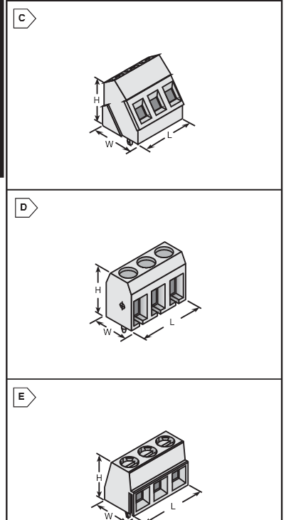

Also in what form Electro-Mechanical connections should the input(110/220vac) and the outputs plus and minus voltage with a ground be? Wires, OS type connectors or what?
For lower current (5a and under) 3 position euroterminals ,for 5 and up to 20A the faston is the most economical way. They do make "monster" euro terminals but they cost a fortune ... fastons like mine 63066-1 Tyco Electronics / AMP Terminals
just need an 1/8" hole and cost $.16. For AC or something that needs a lot of clearance (HV) the faston is also the best choice.
apiece.
