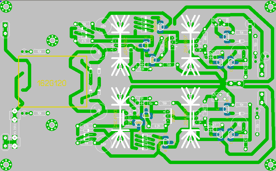

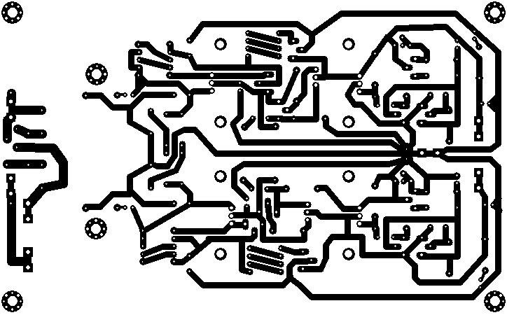

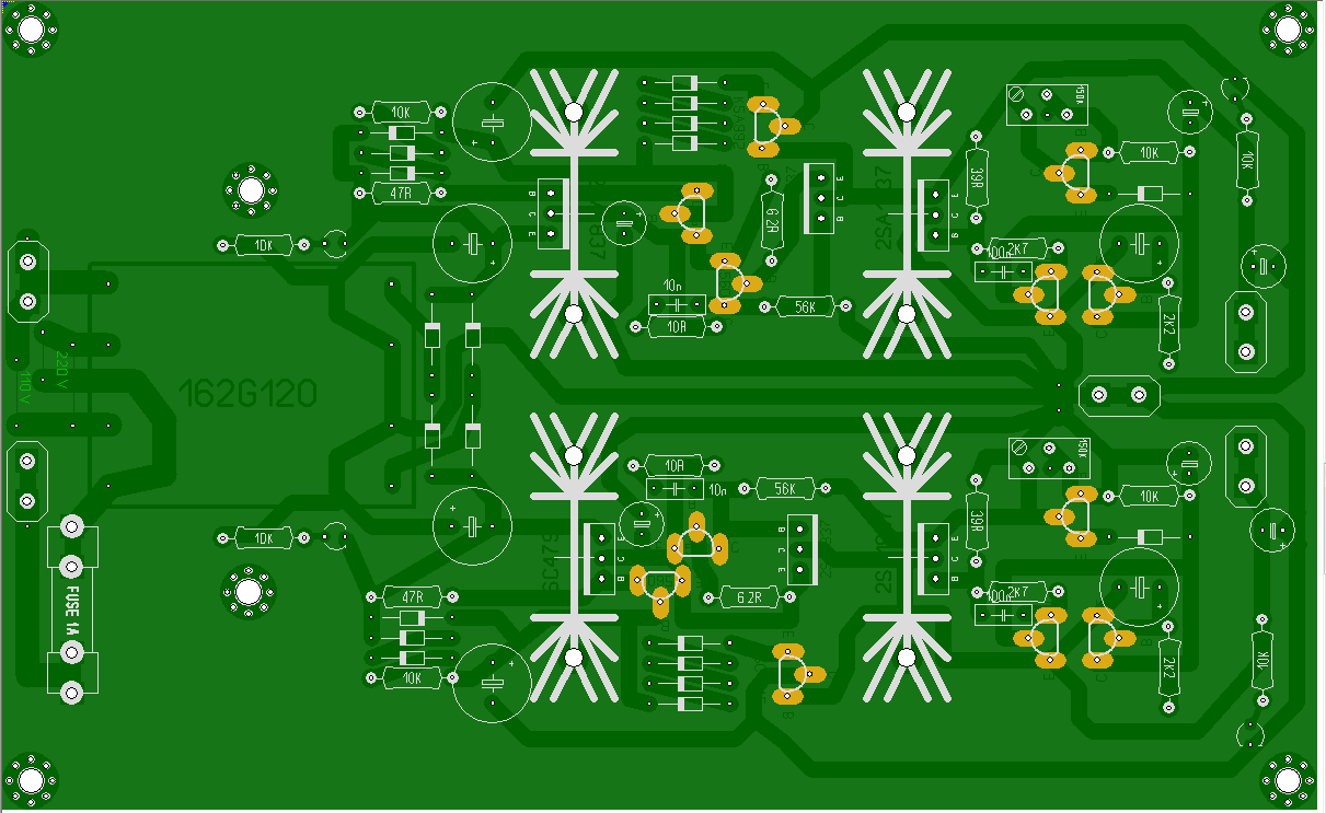

I don't care who uses my designs as long as it's not for profit beyond one's means. And I'd appreciate it if you'd tell me about your project if you use something of mine.

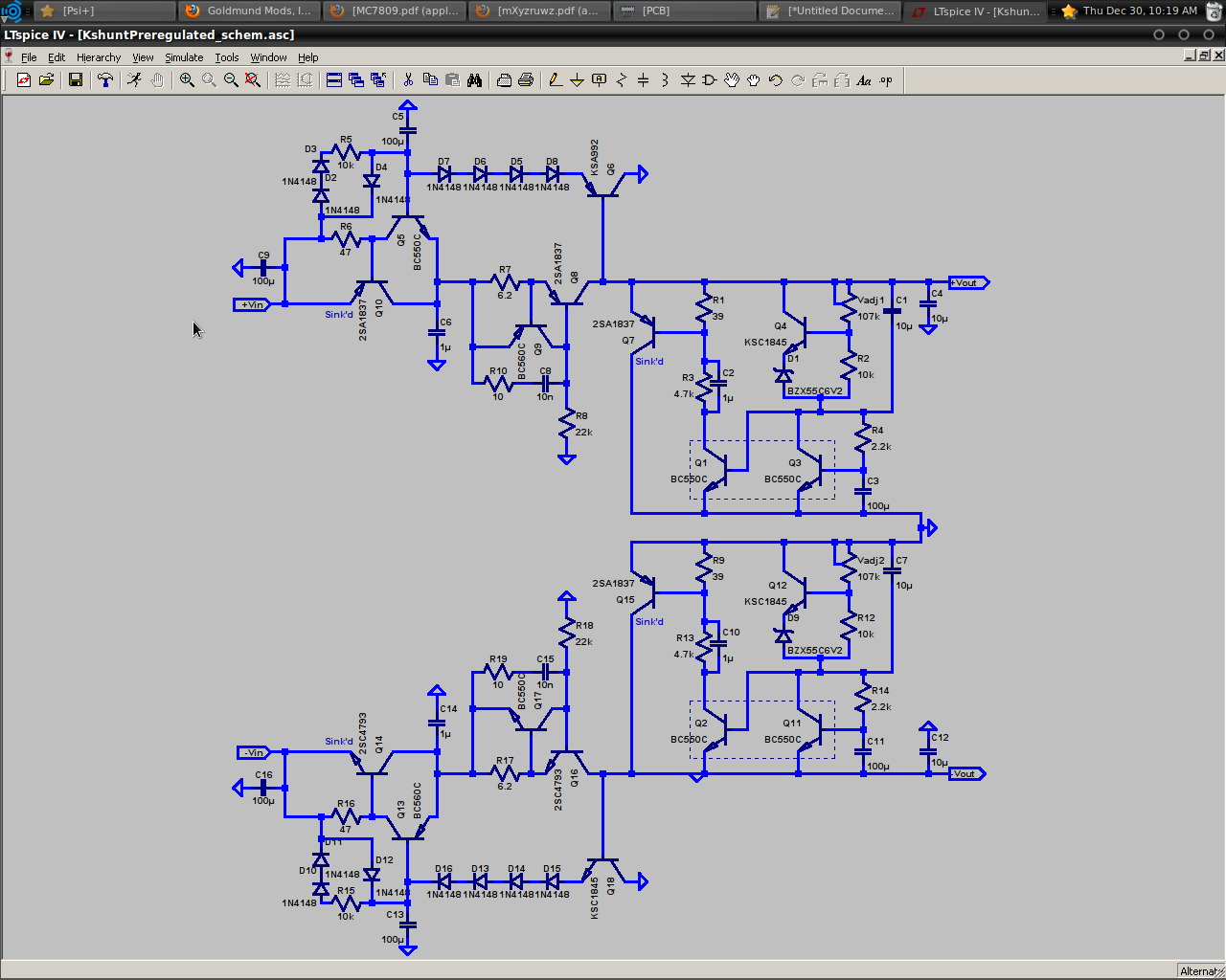

Krisfr, that is a 39R resistor, let me make a new schematic without the stupid grid...
EDIT: Attached

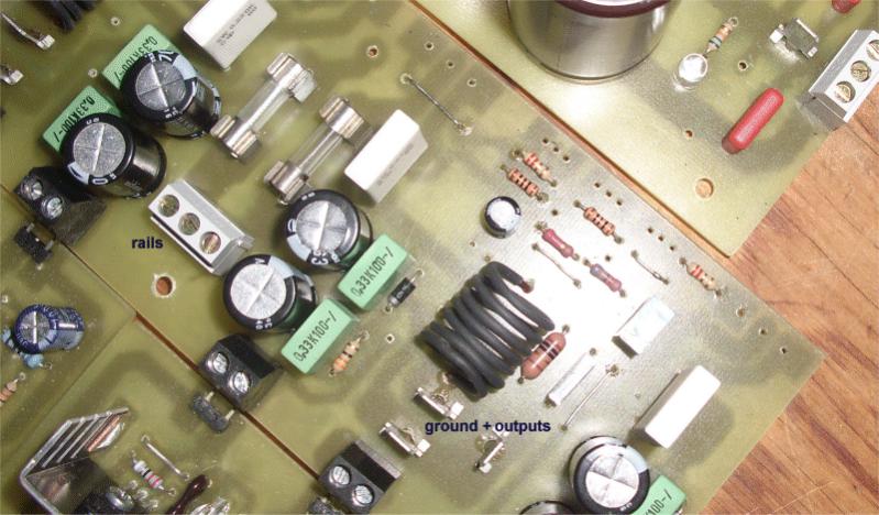

OS are you talking about figure "D" on mouser catalog page 1582
"D" is the standard 5mm pitch euroterminal , they make a 7.5mm lead pitch one that will handle 15A as well. Fastons are much cheaper but you have to solder a spade onto the wire.
I even mix and match euro's and fastons. Fastons for grounding and euros for the rails (lower voltage/amperage projects - below)... many options for physical layouts and interconnects.

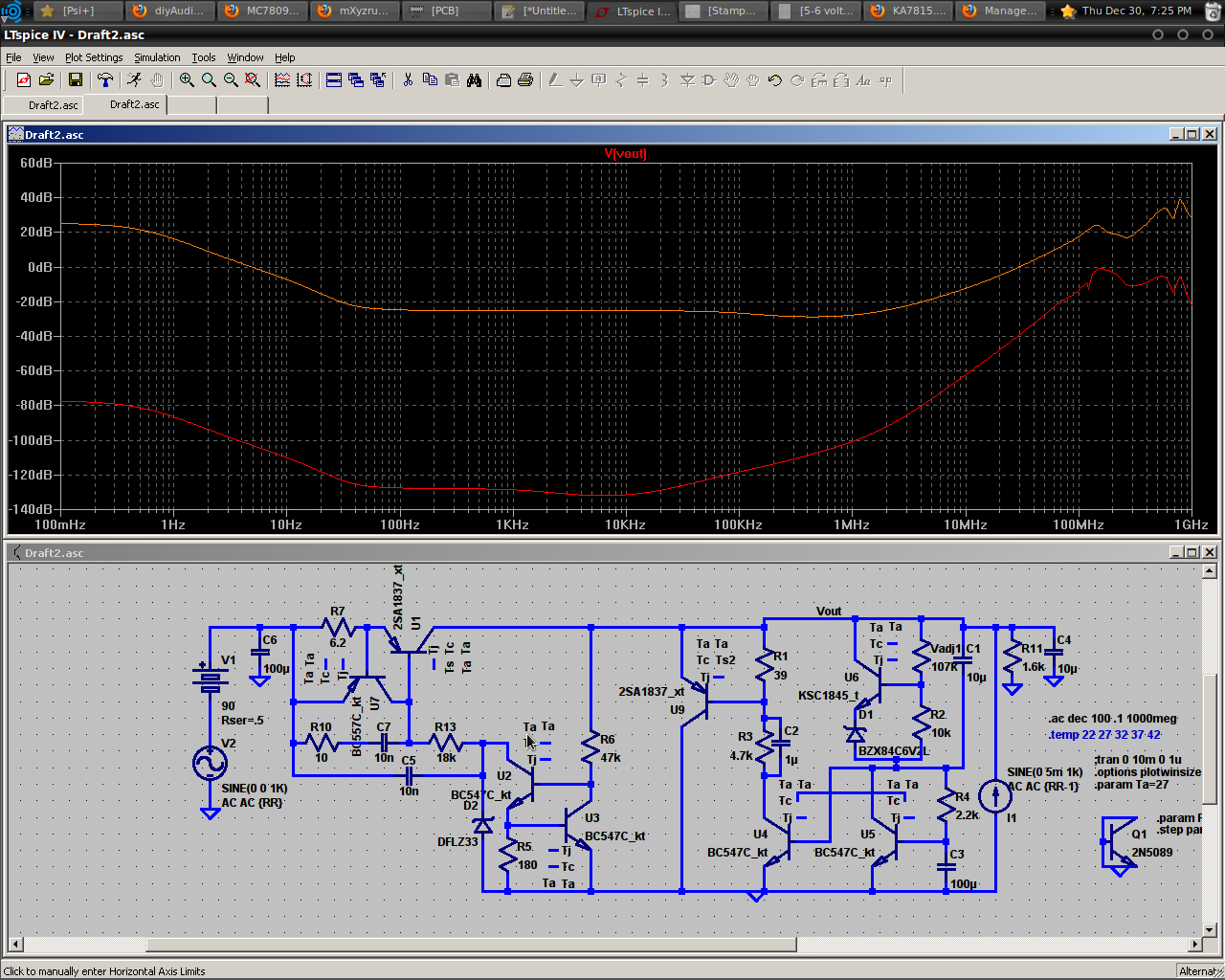

110uV (wow that's a lot).
My god!, that's 0.00000733% of the total voltage output...shocking!
Yes, if I floated the 7815 at 15KV it would be .00000000733%. So if I floated it at 15MV, I would technically have an ultra-low noise supply, right? Right? It's not very useful to compare AC noise to DC voltage.
My scope measures to 10uV and compared to circuits I've made, 110uV is actually a lot. Mostly what I've measured is at or below 10uV. Of course this is discrete DIY circuits, not IC's.

Whatever floats your boat kean. Build a reasonable 7815 regulator circuit and connect your headphones through a cap. Report on the AC noise you can actually hear.
You see it on your scope - that's fine, it exists. What you are after is the DC component to run your (most likely a lot more noisy) circuit.
The Zener is to ensure startup. Salas' circuit doesn't have this and seems to work anyways, but it is different. Q1 and Q9 need sink'd.
The difference between this circuit and my last will be in the PPB or low PPM. The need for the "enhancements" is to increase the DC PSRR. Otherwise I wouldn't have bothered.
Those who want can still build the earlier circuit, it is still valid, but could quite possibly be overkill.
