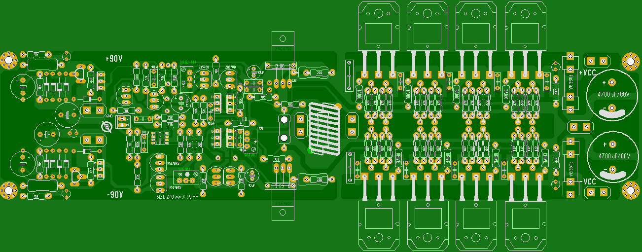

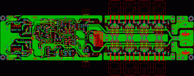

What a darn nice looking pcb, I would have been very proud to have been able to show something like that.
Kind of "long". If he broke it in 2 parts (voltage stage/OPS) and stood the voltage stage up on end it would fit in half the space.
Krisfr ,Much better work in a such a short time.

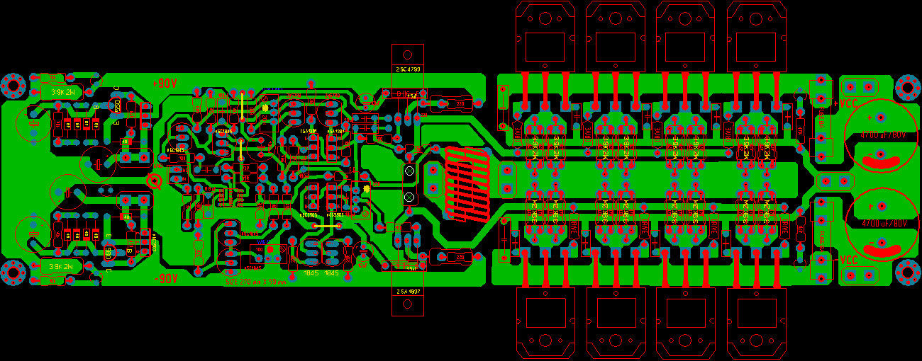

The added cap and res from this post number 1133 has been added as well as TMC to the board.
All the comments have been noted and appraised, so I am ready to etch a couple of these today, then tin drill and stuff.
Thanks for all the input![]()
This amp will not do TMC (well), the VAS is essentially a differential... the TMC error "pulses" will basically cancel out and a nasty spike will appear in the bode plot in this case. TMC "likes" a single ended super high OLG amp (110-120db) with a rock solid CCS (ax). I don't want to see you do as I did and make a "dud" for your "goldmund killer".
My EX is basically the original goldmund with MJE340/350's for the VAS. I took the 2 beta enhancements out of my failed amp and tweaked it to perfection. Since no one has actually built this yet except me , be prepared to jumper your beta enhancement trannies. You can (almost) get the same OLG by using BJT's for the input pair instead. I did not experiment much with the fet's so who knows ??? I reached the conclusion to "keep it simple" and ended up with basically the original goldmund. BTW , I ran the EX on a pair of the original mosfet outputs (to-3) ... they sounded great.

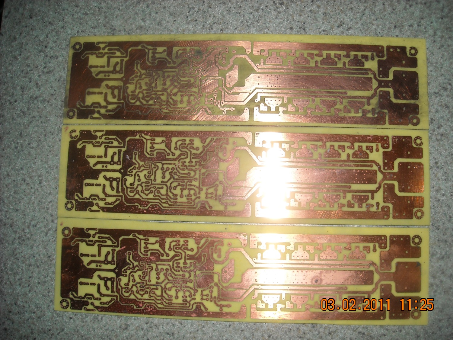

I etched one, after I botched the first two by not applying enough heat. So I cleaned them off, and reapplied some HEAT...
Cleaning off the paper and will etch them before the night is out.
I inserted the last recommendations too. I do not have to put in the TMC componets so it is not a big deal, but it was better to have and not need etc.
It is going to take time to get these up and running, slow but sure as with anything totally new...Maybe I will learn something while doing all of this, I hope so, so I can share back to you guys...

The best learning comes from doing. Or that's the way it is for me. I learn plenty, especially from my frak ups.
Coming from you that is a Real ComplimentNice!
But you had input into all of this for me
and Especial for Alex...
With a couple of small blemishesI am done for the night...
Tomorrow starts with tinning, thanks to John![]()

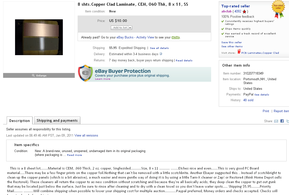

Very nice (material) , and etch. Is that the same CEM-3 you gave me? Built like plywood , the traces are nearly impossible to burn off ... 2 oz. Killer stuff. You be a [man of action -tm] .. too !!
OS
Yep, same MO Works like a charm...Very nice (material) , and etch. Is that the same CEM-3 you gave me? Built like plywood , the traces are nearly impossible to burn off ... 2 oz. Killer stuff. You be a [man of action -tm] .. too !!
OS
Maybe Keantoken can take advantage of me and get one of these with the Suface mount LSK389a on them. They where shipped from Linear 2 days ago. They are nice folks
Where did you source that material , if i may ask ?? I want a sheet or 2.
