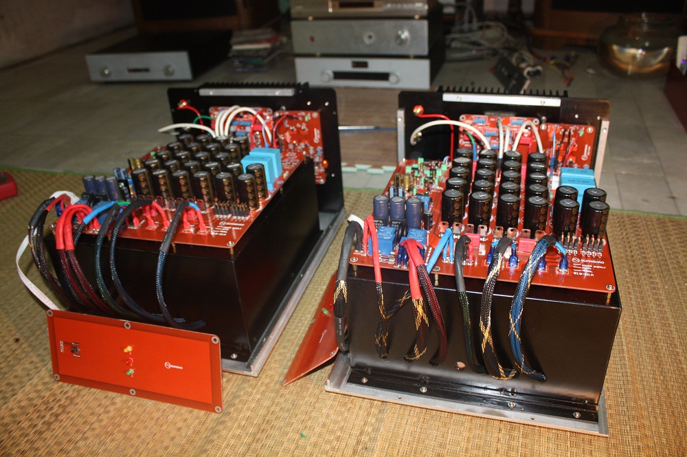

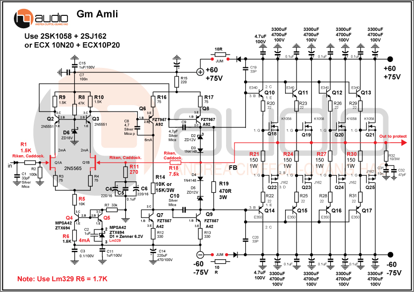

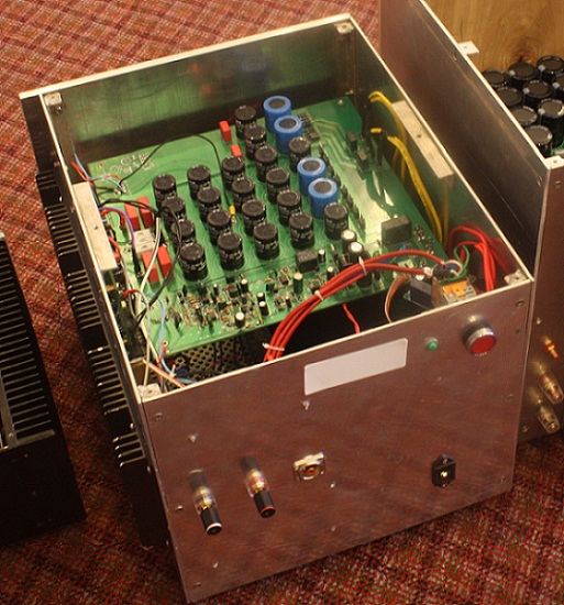

1. I need the complete sound of Gm. because I love this sound!
2. I need to remove all technical issues when using and causing errors. It's a high-frequency self-inflicting problem, which causes a very bad sound and kills the key components. If you only do it once, you'll think it's great. And you'll say I'm successful - This is a serious mistake!
3. I need to check between PCB schematic and PCB of Gm, and versions of Tl400, 600, 2500 and even Tl500, what's the difference? And I find them very little different.
4. I opened the TL400 and copied the entire PCB and the circuit- leading to almost 95% of the Gm audio output.
5. I have measured and tested on many systems, time and use the dedicated meter Tek AM700. I did it about 4 years ago.
6. After 15 implementation and results achieved:
Gm copied has become the reference sound in my home audio system, and many of my friends.
7. There is a semiconductor solarium competition, in which I participate to help my friends make six different and three of which won the first, second, third, and the other three ranked from: 4. -6. What a surprise!
8. Hanoi Television in Vietnam invites me to film a program on this sound, see here: YouTube
Thank you for all of my sharing for you, if you want to copy GM for yourself then pay attention:
1. Non-1 component values, as well as standard 100%
2. Most important is the PCB and the conductors on the PCB, as well as the connections!

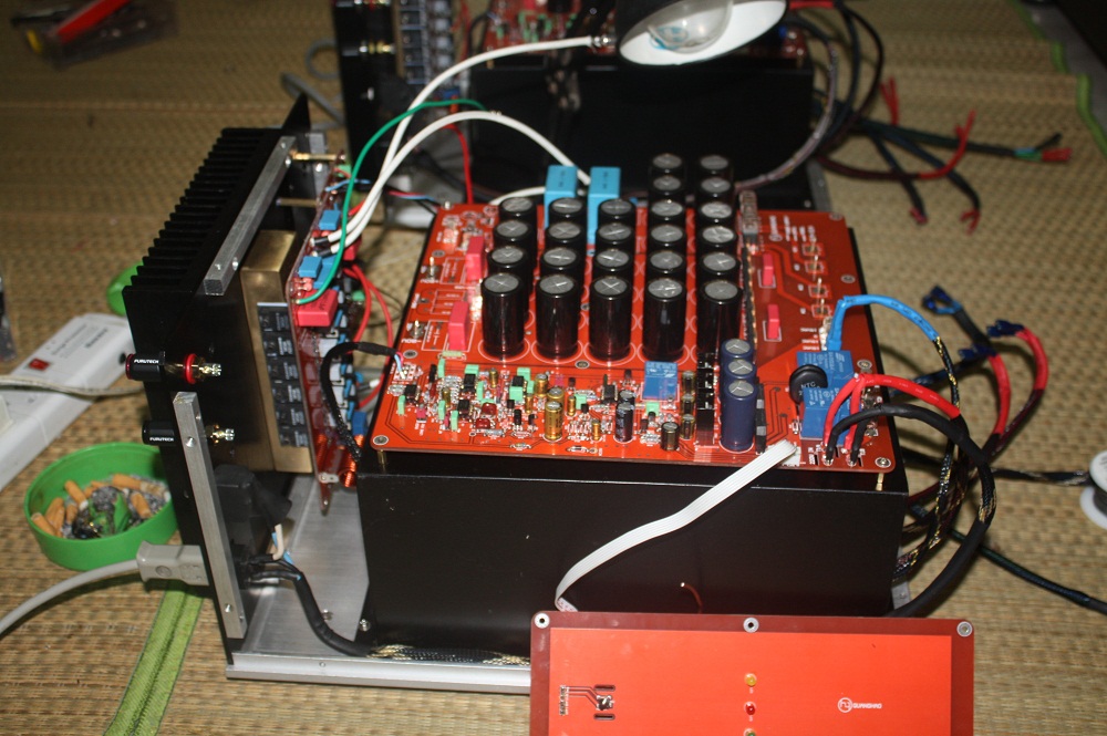

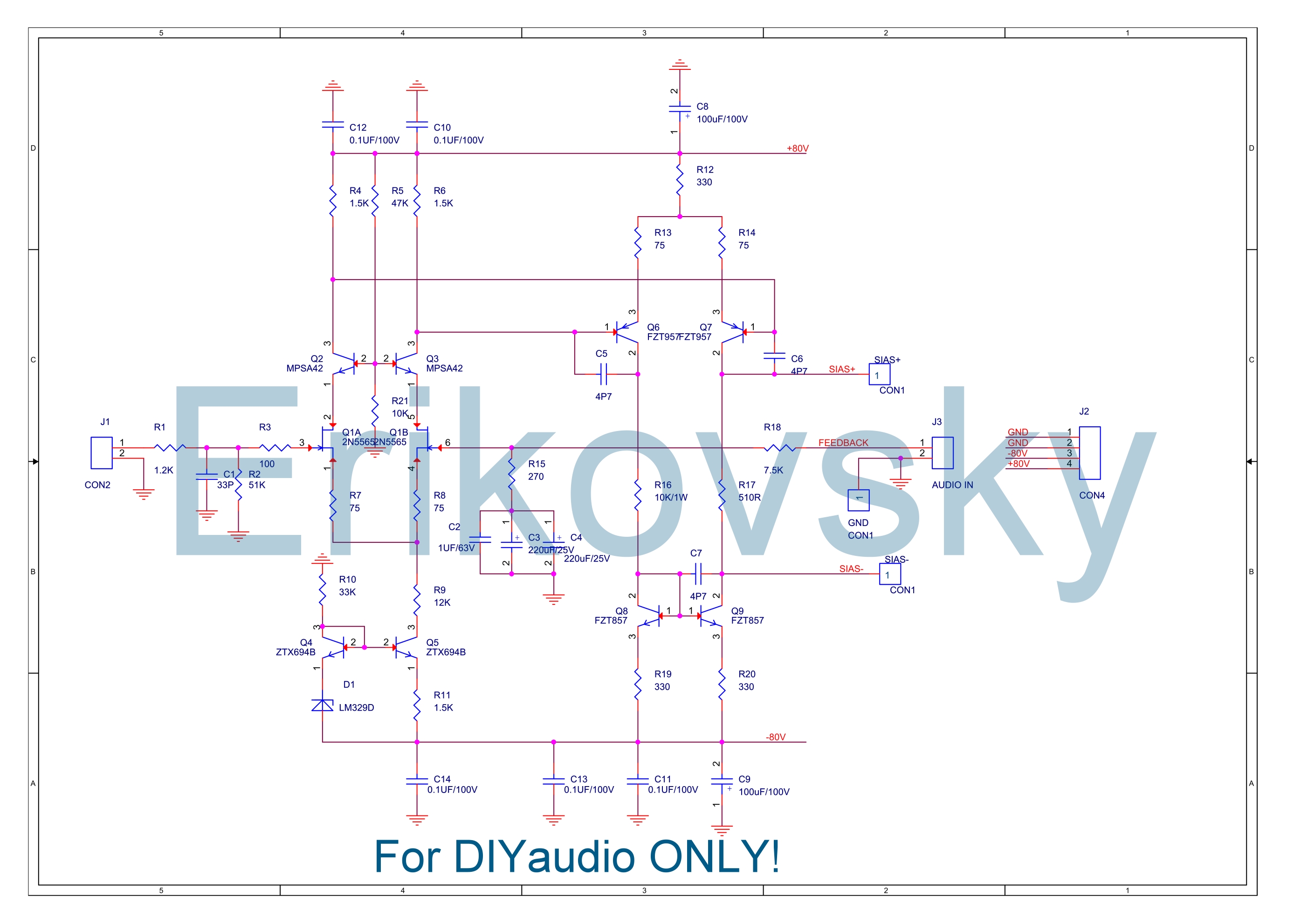

The amp I made was using your PCB ! And that is working fine after it has been in use for 4 years or so.Hi koldby!
Value is not the first important issue,
Most importantly is PCB, is it running stable and great after time ??
The values you have, it's the moment I made them when not directly opening the TL 400, but it still works well. Gm has minor changes in the versions, and the schematic with the product is adjusted to match!
In the schematic R33 is wrong if you use +/- 80V . It should be 330 Ohms. The PCB I showed was somthing I am working on, but not produced yet.
I want the see the resistor value Input LPT and VAS of TL600.
I can't send direct orignal schematic at here. I has send to some other member of this forum. They are will know and judge. I will stop cmt at here.

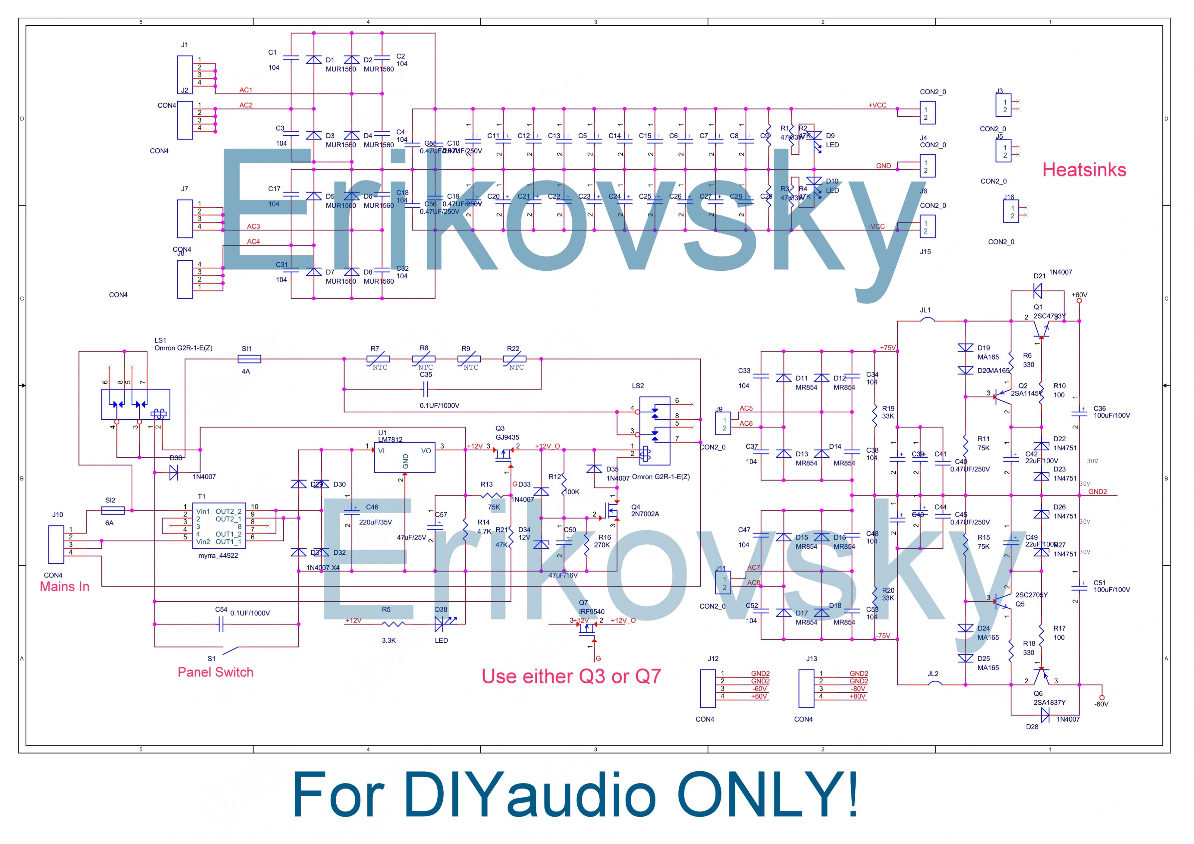

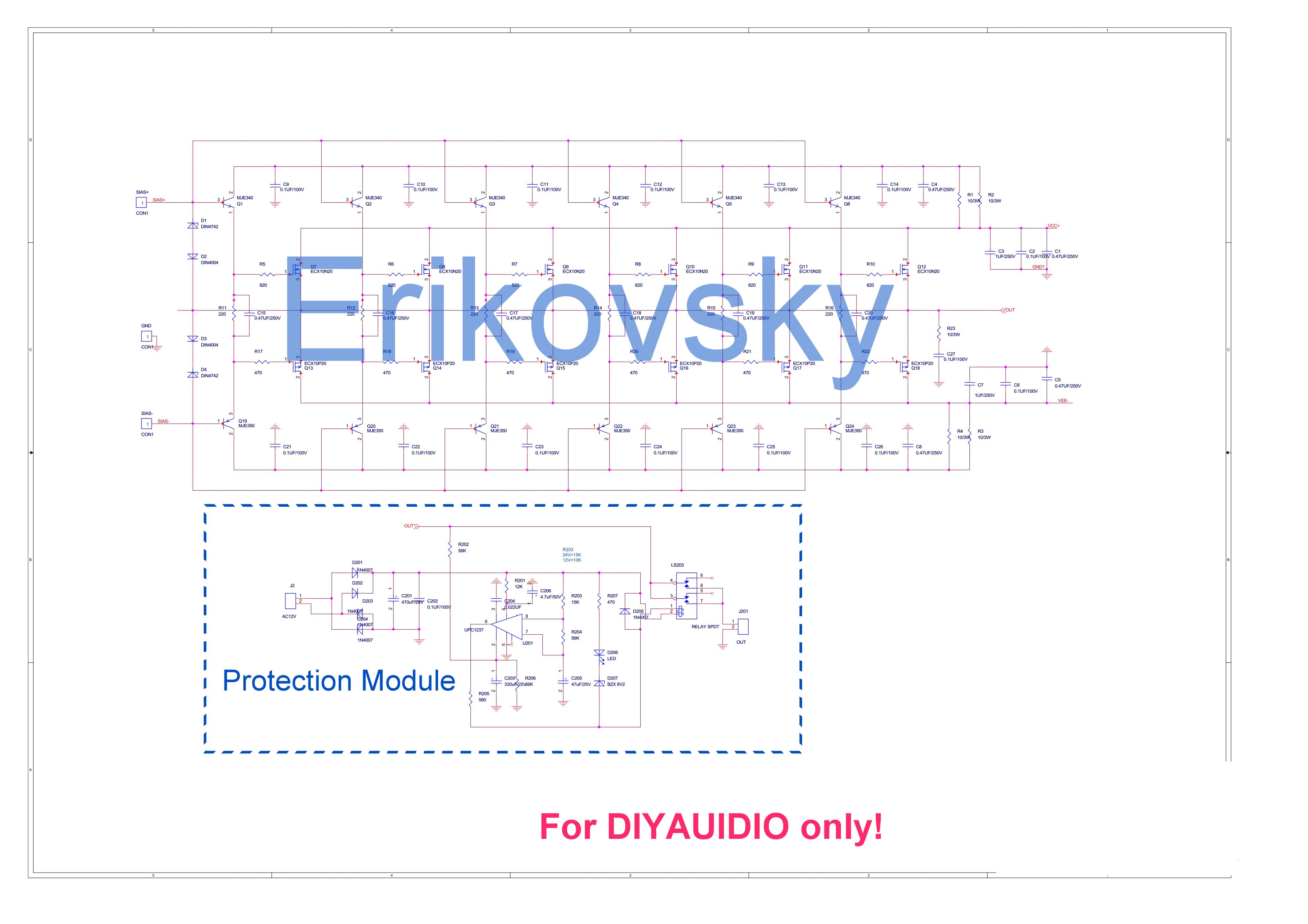

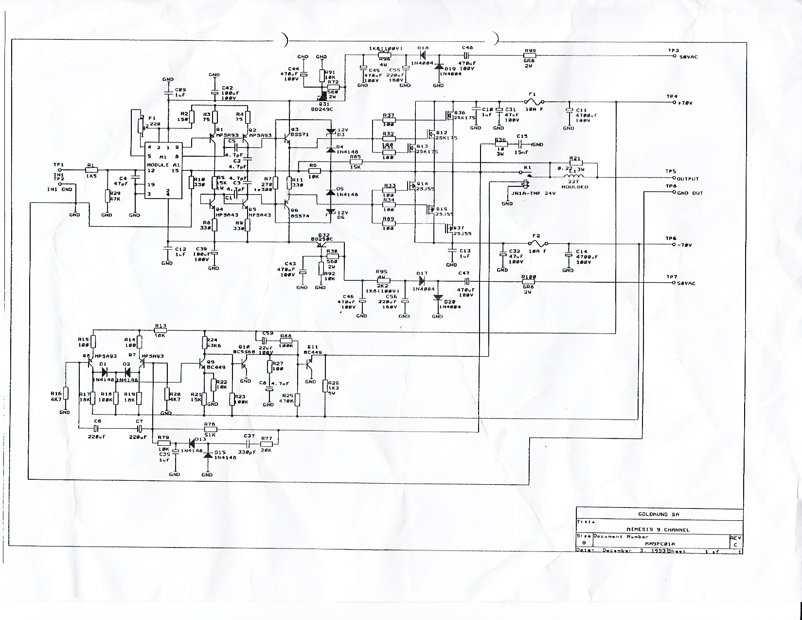

Hey Guys,
I am sharing this schematic. This is a larger power rating model.
Enjoy!
Eric
A thing that puzzles about the schematics. The regulated PSU for the front end only puts out +/- 60V , but in the input schematic it says it needs +/- 80V witch also must be the case for full drive to the output
