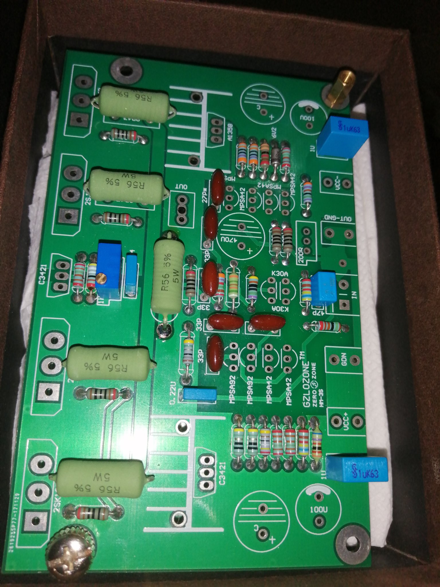

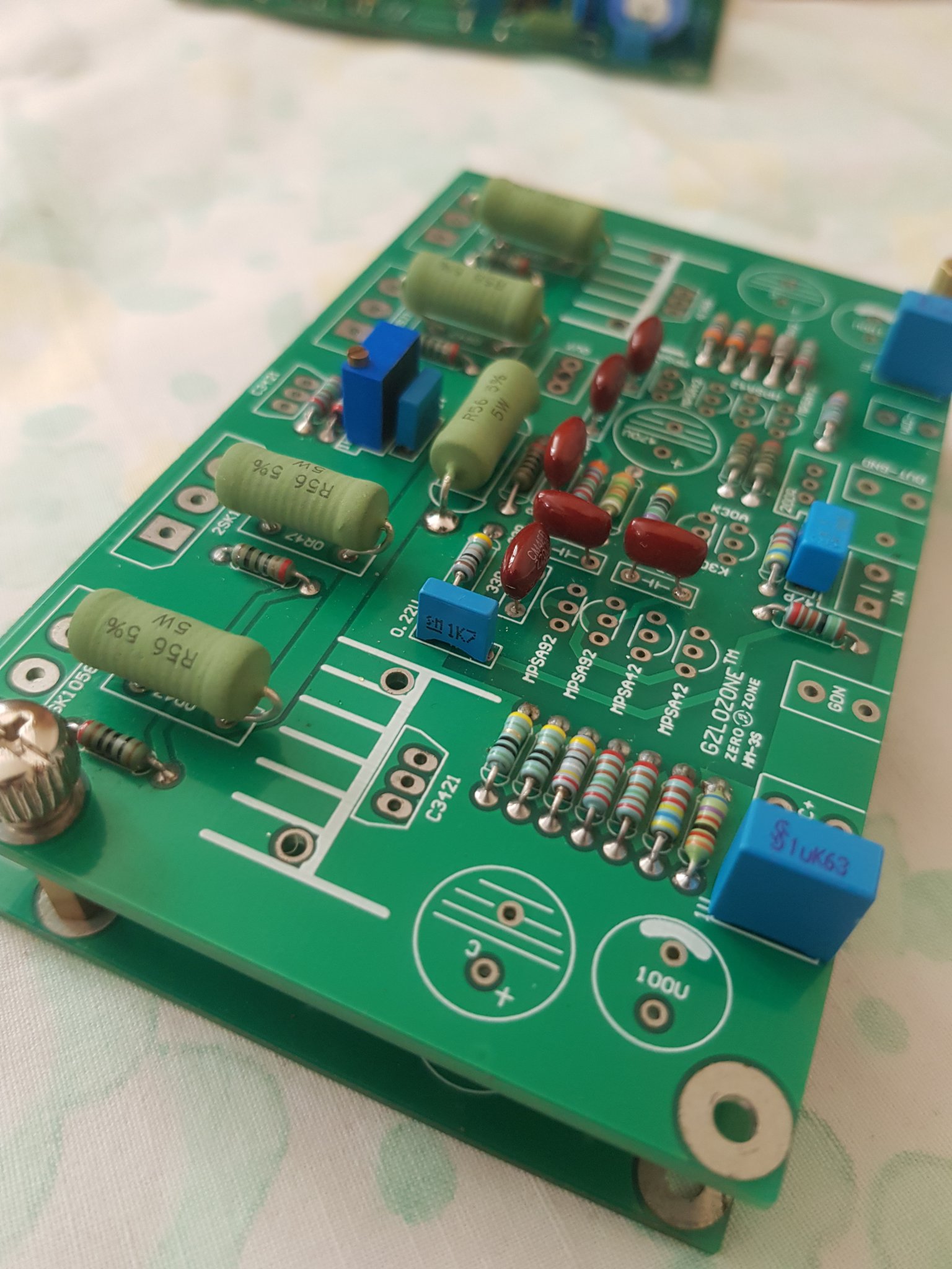

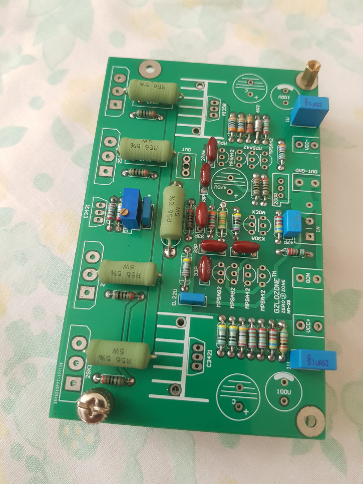

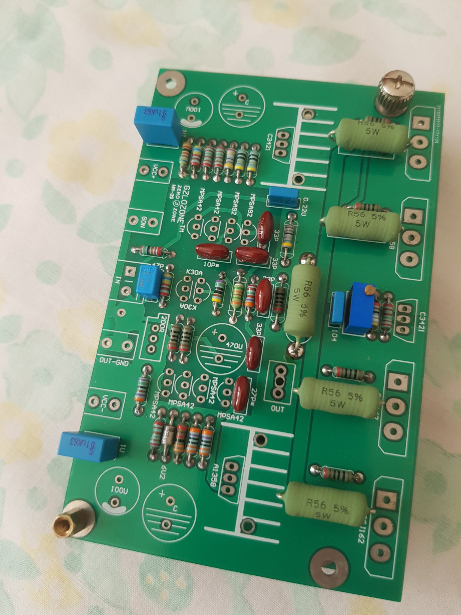

Very nice..My Goldmund amplifier from 2013 , PCB layout by me !
Alex

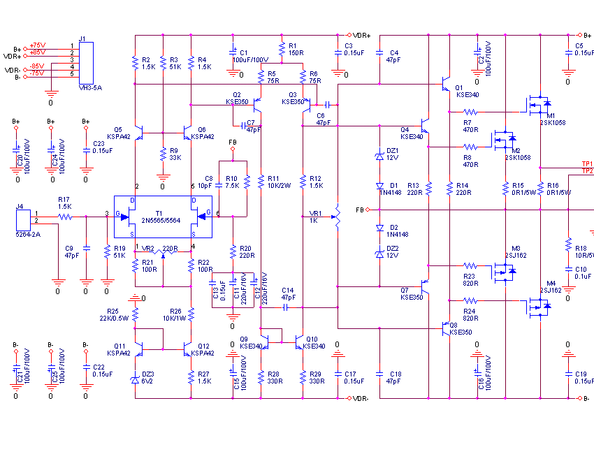

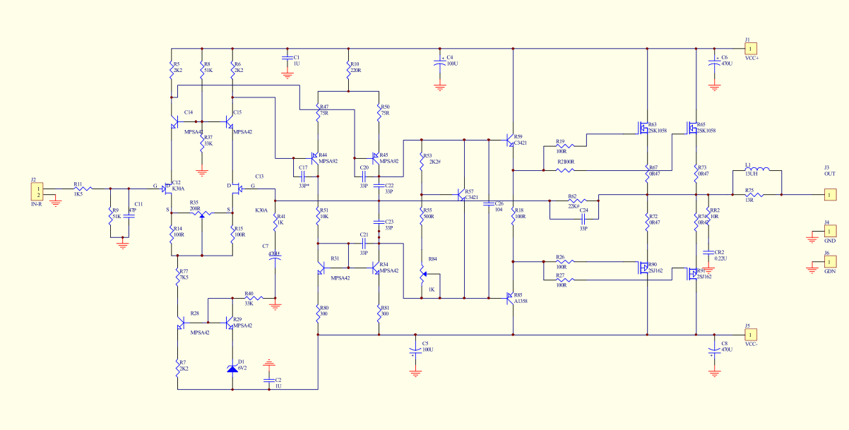

My Goldmund transistors are mpsa42/92. I am attaching the Goldmund Umun schematic..KSE is the Fairchild-noting of the MJE-equivalent. Like KSC for 2SC...

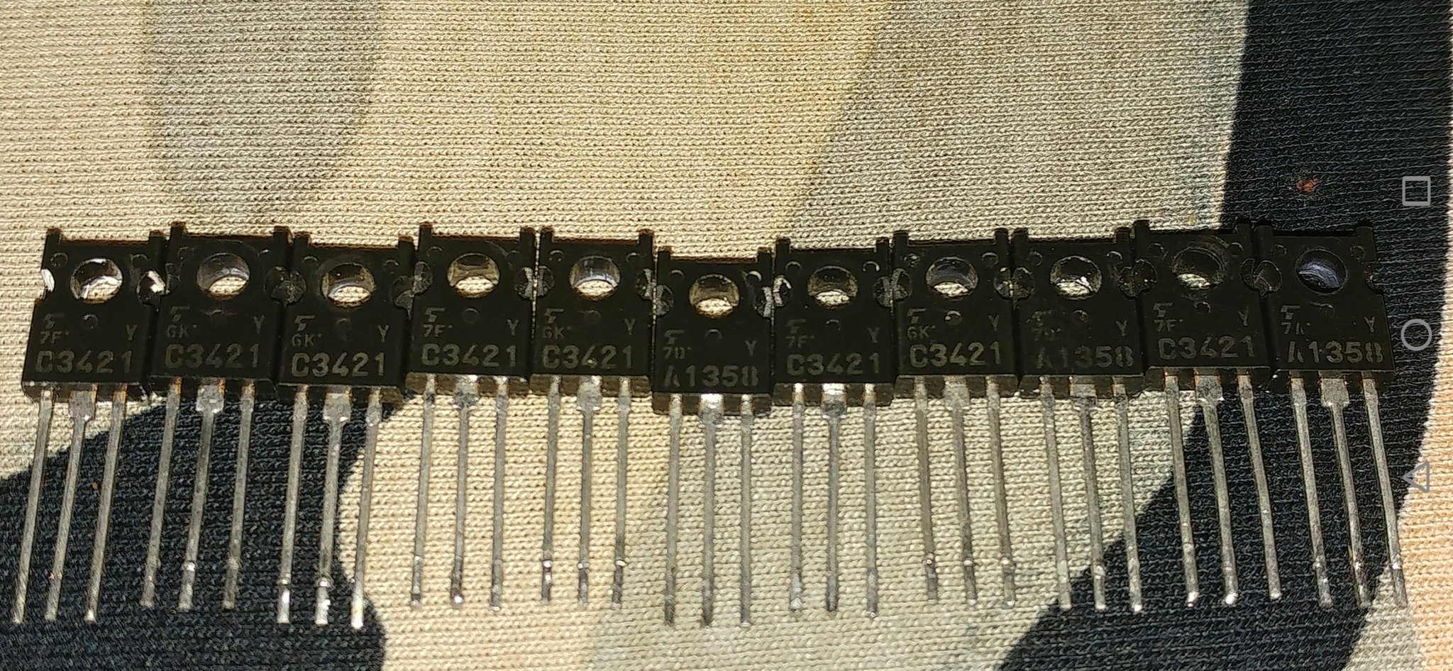

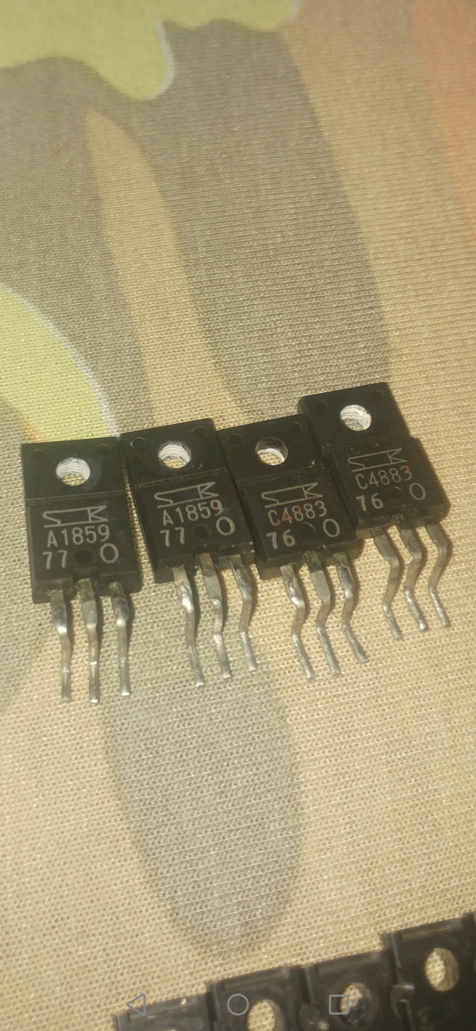

I will be using 2sc4883 2sa1859 as vas driver.KSE is the Fairchild-noting of the MJE-equivalent. Like KSC for 2SC...
Alex! From 2013 to 2022 do you think it is necessary to make any updates?My Goldmund amplifier from 2013 , PCB layout by me !
Alex

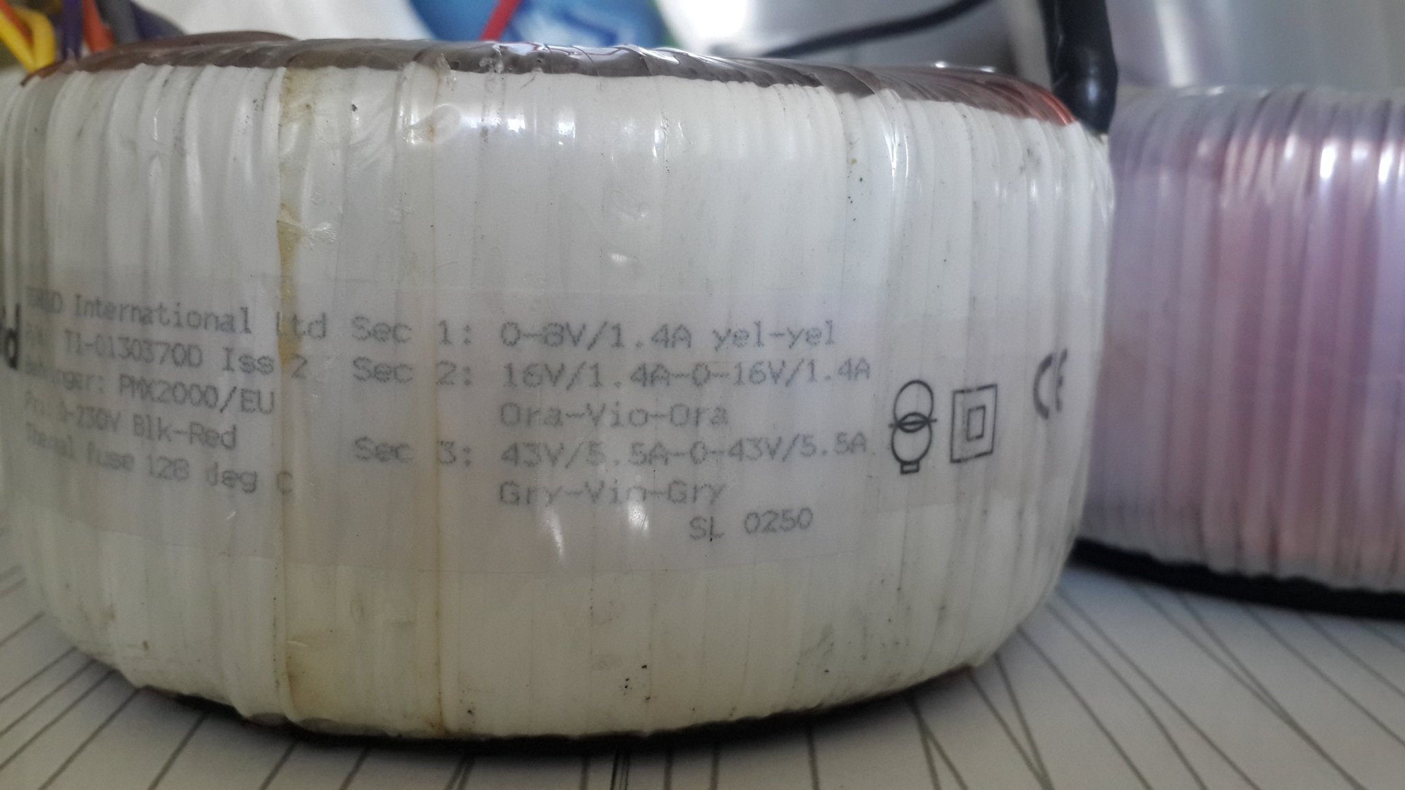

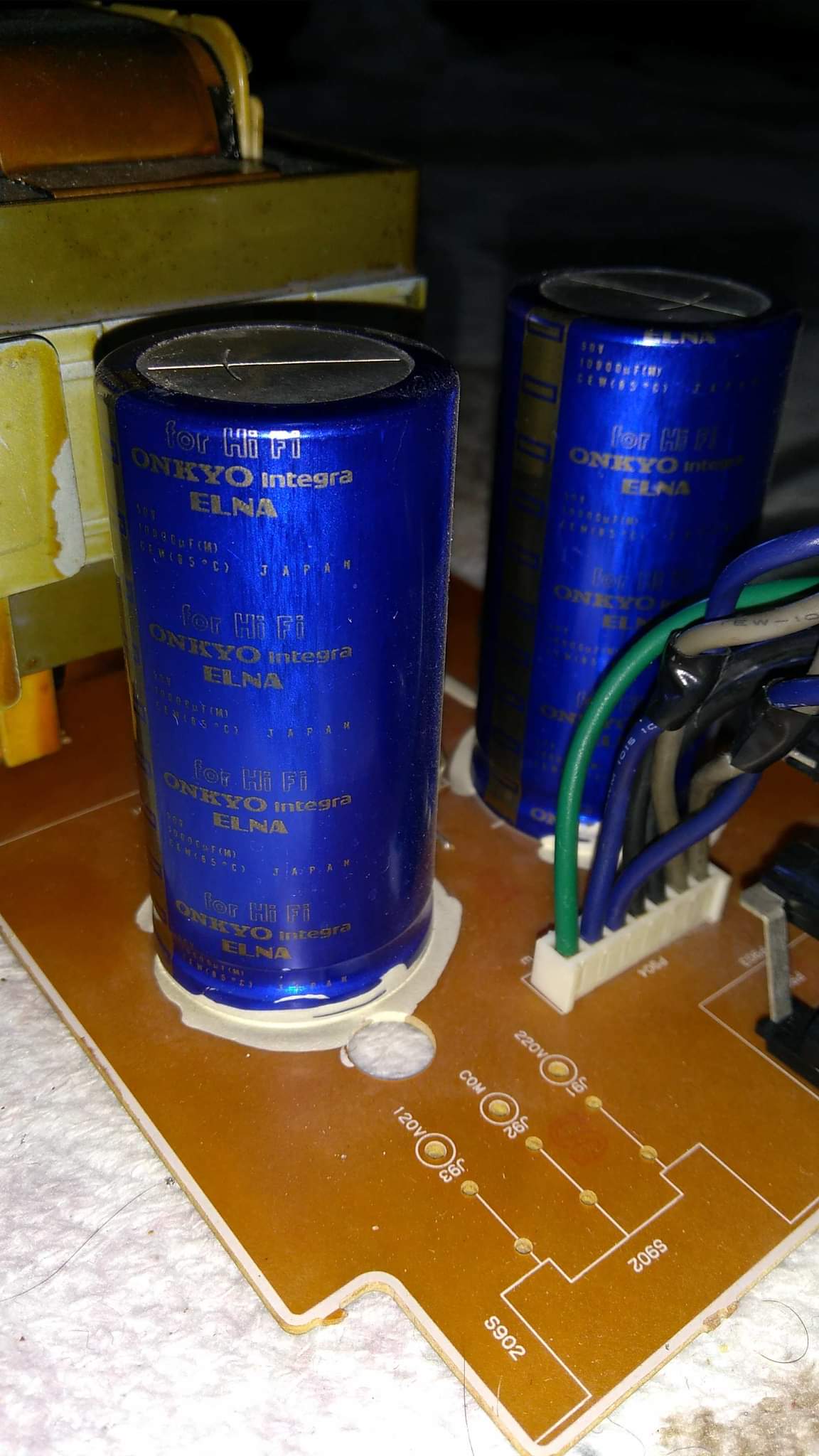

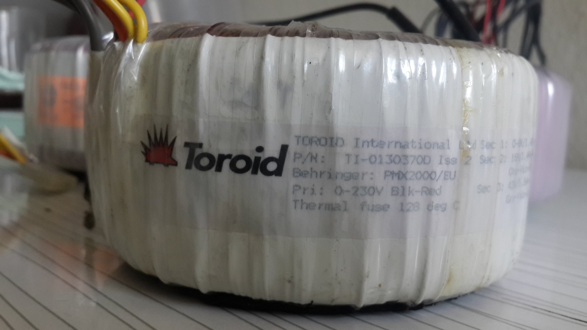

What are the electrical specs of your power supply?
They are great devices - if you use them right. They're great as drivers in an EF2/EF3. Some are using them as cascoding-devices in combination with low Cob/Cre semis in the VAS (even Marantz in some bolide-style integrated amps). But personally I wouldn't use them plain in this specific VAS. Even the 340/350 are better for this here.I will be using 2sc4883 2sa1859 as vas driver.

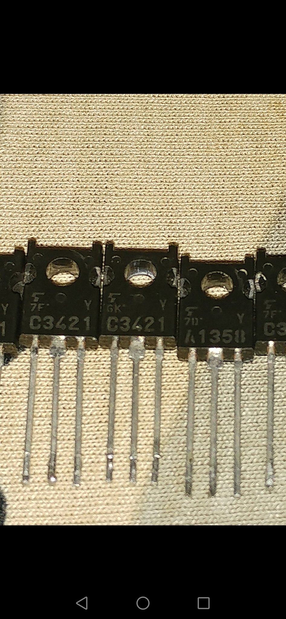

BTW: Your 2SC3421/2SA1358 are now called TTC004/TTA004 with the same specs and are widely available through the big distributors... No need to buy some out of questionable sources...
Thank you nfsgame In the diagram 2sc3421 2sa1358 these are also available I am undecidedThey are great devices - if you use them right. They're great as drivers in an EF2/EF3. Some are using them as cascoding-devices in combination with low Cob/Cre semis in the VAS (even Marantz in some bolide-style integrated amps). But personally I wouldn't use them plain in this specific VAS. Even the 340/350 are better for this here.
Are the ECF 10N20/10P20 compatible with this project?
CompatibleAre the ECF 10N20/10P20 compatible with this project?
