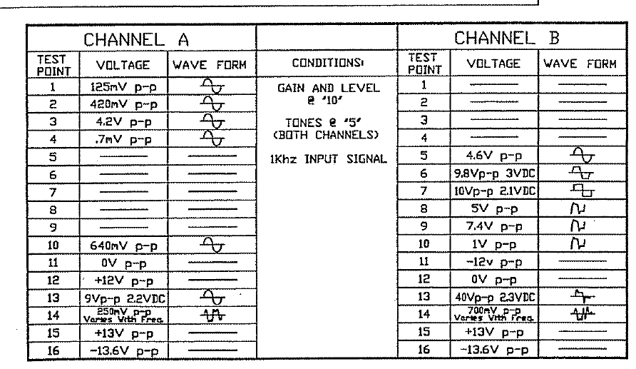

I take a few basic measurements and things look normal. I hook up the signal generator and attach the ground clip of the scope probe. In the schematic, they included a little chart showing the expected voltages and waveforms at various test points:
Using this I quickly determined that the preamp seems to be working properly. A few of the voltages are off but this may be due to the lower B+ voltage. Tomorrow I'll connect the reverb tank and make sure that part of the circuit is correct.
![117.PNG 117.PNG](https://www.diyaudio.com/community/data/attachments/123/123489-4e9ba7a2970cebb87a540f4c036b0804.jpg)

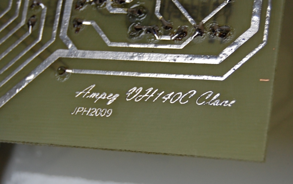

For my better boards, I do the silkscreen in copper (etch it into the top layer of a double sided board). Winds up looking like this:

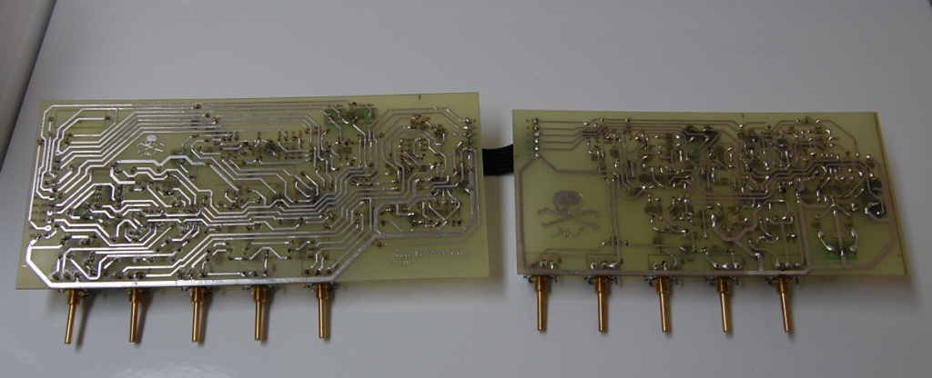

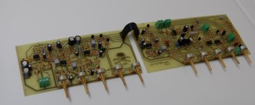

As promised, I have some pics of the preamp boards to show (finally got my camera back).
The component sides:
The solder side, boards neatly tinned:

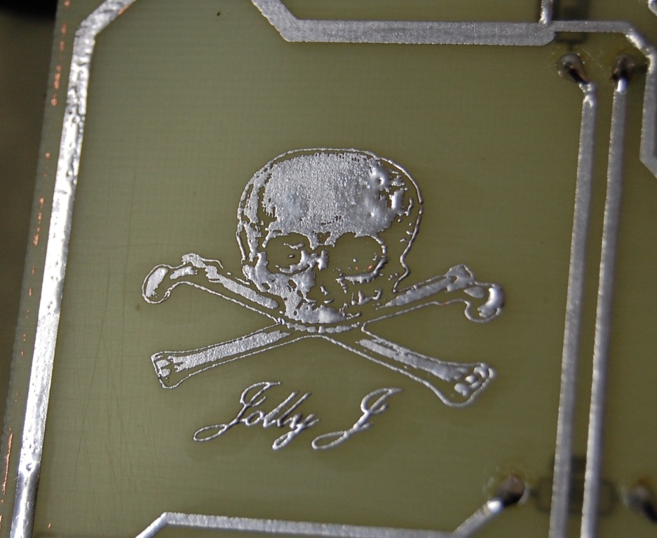

I had some space so I added a trademark:
Some more detail:
Like I mentioned earlier it seems to work properly, at least from a measurement standpoint. I want to run some music through it to see how it sounds (still don't have a guitar).

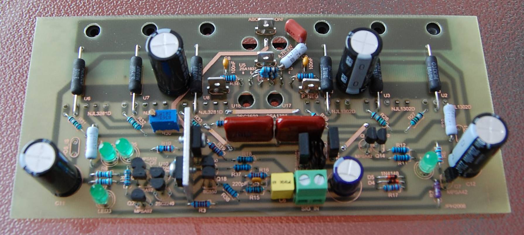

I've started work on the chorus board. This time I'm doing a schematic capture before I do the board layout - maybe save myself some grief.
![_14.JPG _14.JPG](https://www.diyaudio.com/community/data/attachments/128/128021-333b91321cc5aa8423443086fe5e7c0f.jpg)
![_9.JPG _9.JPG](https://www.diyaudio.com/community/data/attachments/128/128027-8c60f0a58da6de7217e125639affdbbe.jpg)
![_7.JPG _7.JPG](https://www.diyaudio.com/community/data/attachments/128/128038-47bb887720b3f079bfc09d66537947b5.jpg)

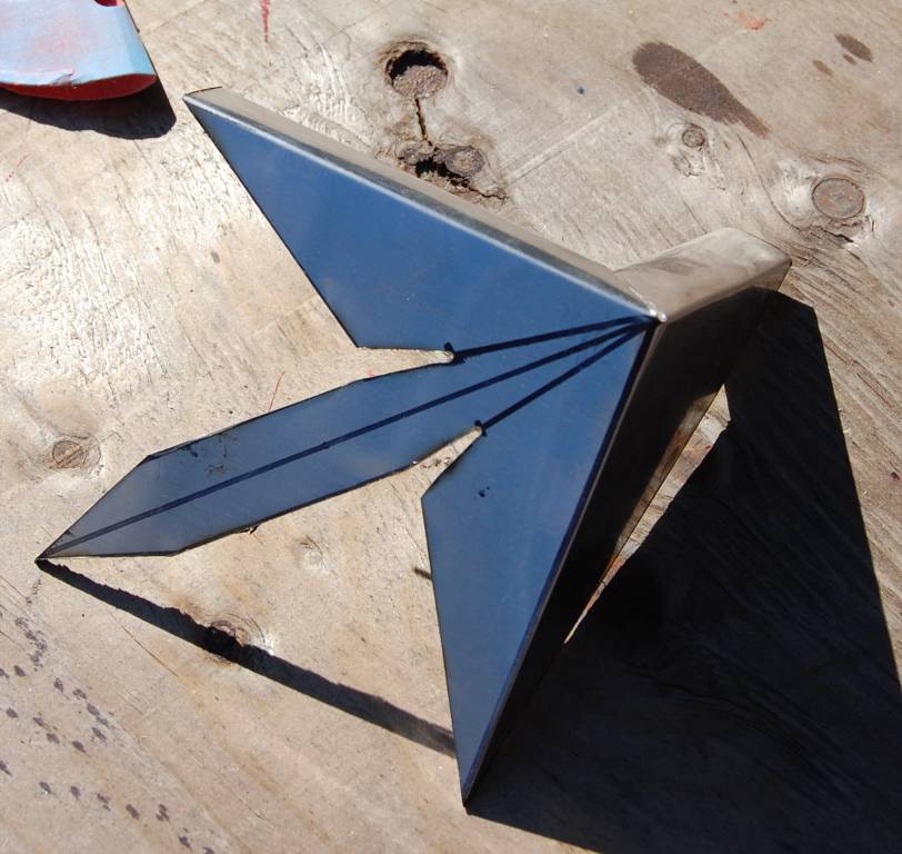

Some metal work.

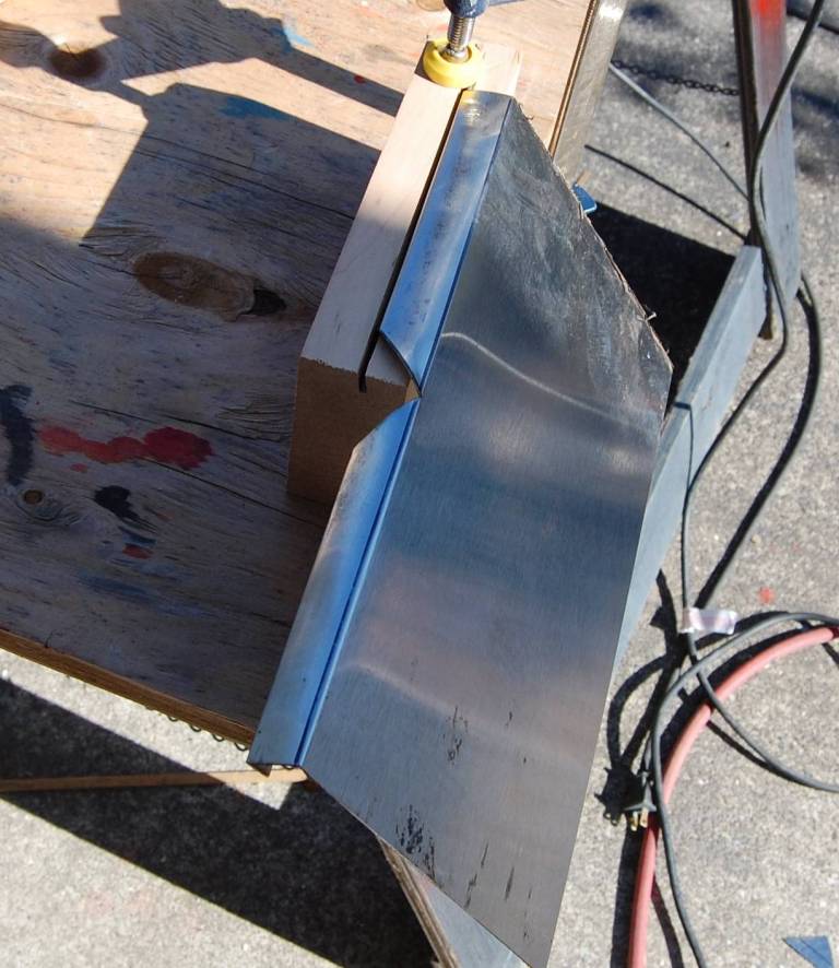

The corner protectors I've seen are plain and boring - being an industrious sucker for punishment, I figured I'd make my own. I planned the control panel faceplate to be stainless steel (I have lots of this) and so to match that, I'd make the corners from the same.
I am using 16 gauge stainless that is surplus kickplates for doors. It's hard to cut and drill but not as bad as better grades of stainless.

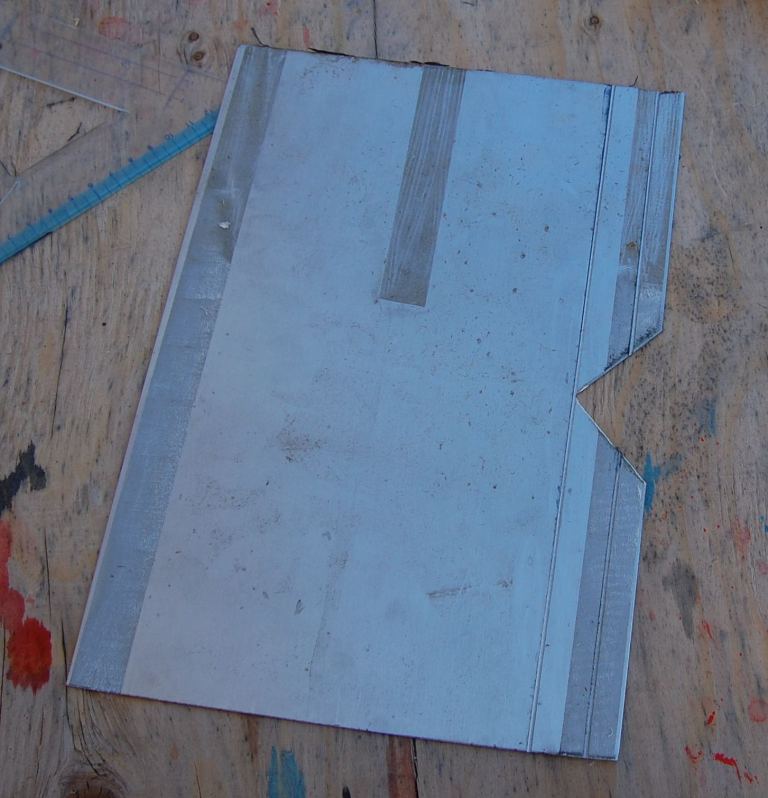

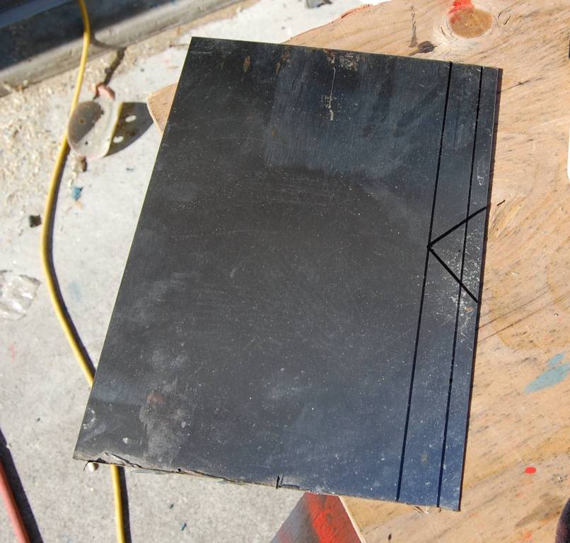

Some layout:
And the first cuts. Notice the scores with the cutting blade along the lines that need to be bent. This makes bending this thick metal manageable:

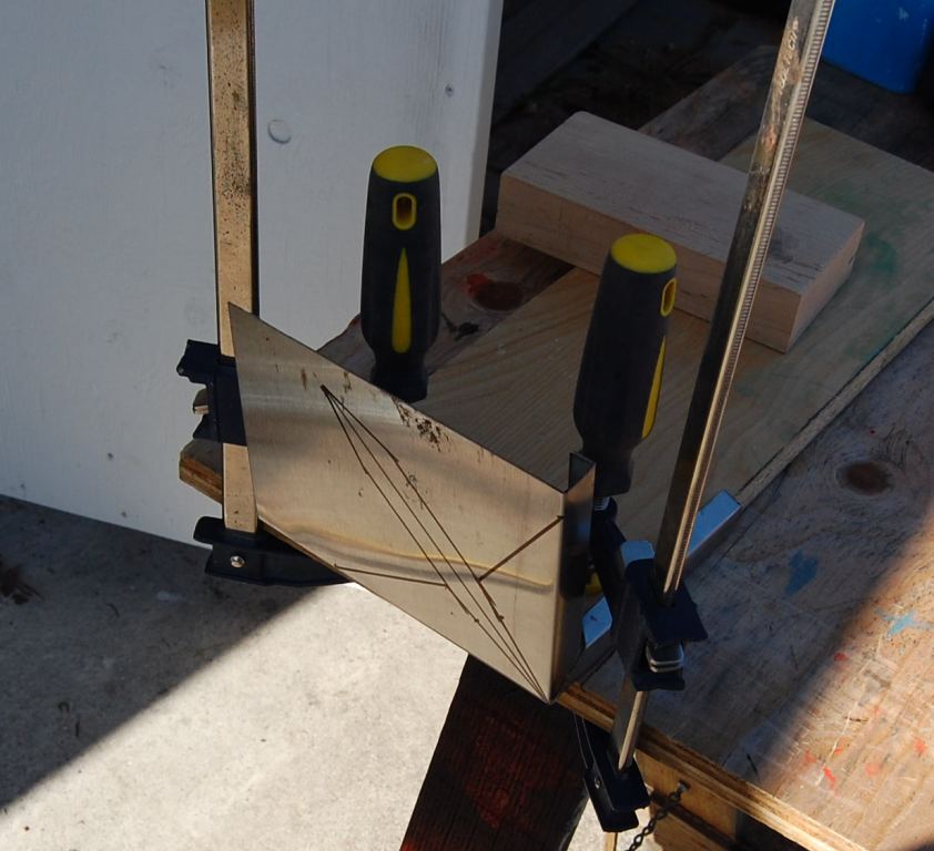

Bending:
I used a block of hardwood with a slot cut into it for the metal edge to slip in and help with the bending. Some pounding with the hammer finishes it off.
More bending and you can see a rough pattern drawn on the side:
And that shape cut out:
Continued...
