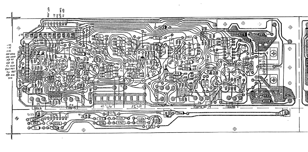

Just like the preamp section, I'll be following the original layout closely:

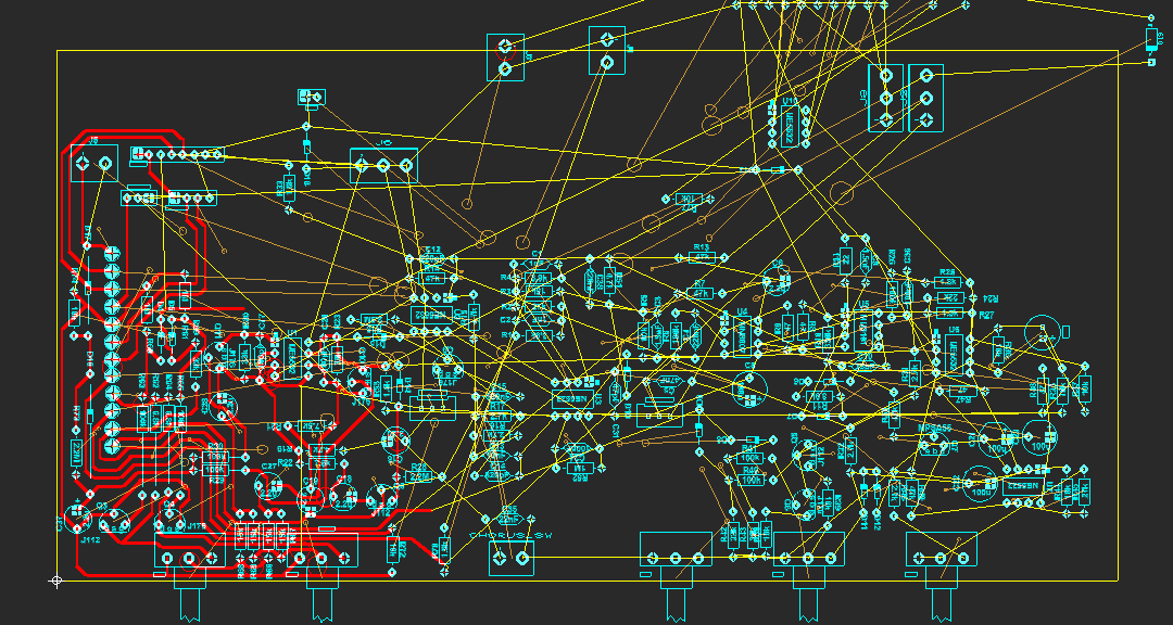

This is as far as I got, all those months ago:
A way to go yet...

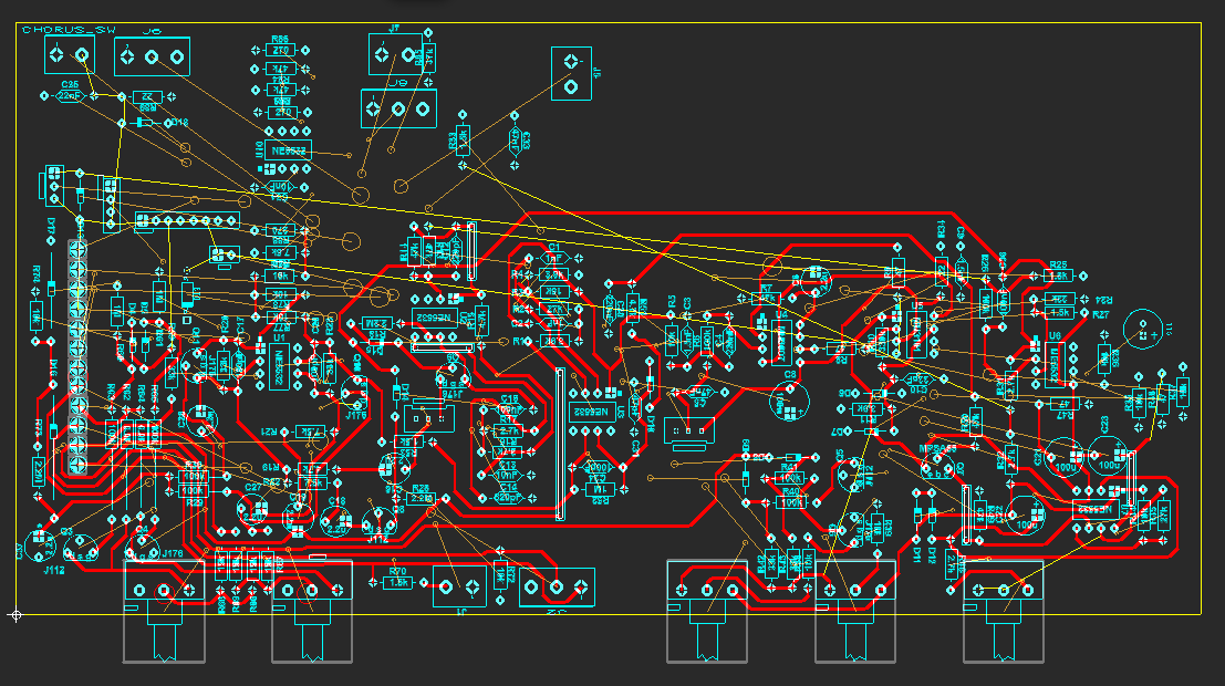

Some work on the chorus board:
![111.PNG 111.PNG](https://www.diyaudio.com/community/data/attachments/180/180236-94103ef84b2d5c0d83f6e5c09daf6722.jpg)
Yeah, it doesn't look like much but believe me, it is. I needed to change my plan of attack, since I added power entry and a couple of other things that are not on the original layout. It is hard going but I'm making steady progress now. Once all traces are routed, I'm going to etch a prototype, just to verify that everything is correct. If all systems are go, I'll refine the layout and etch a final version.

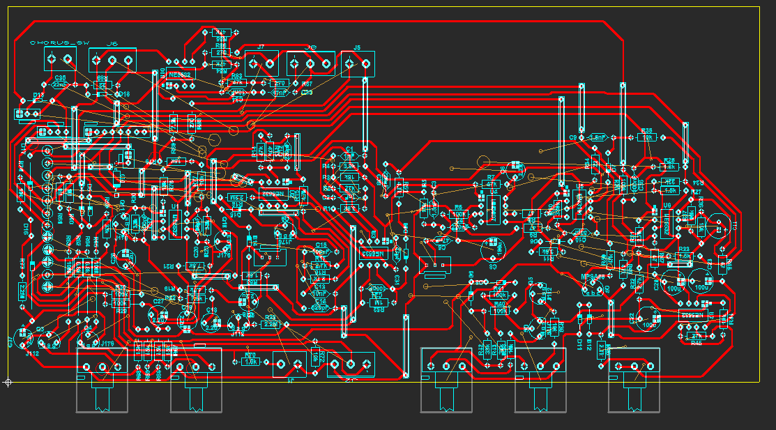

Hard to make any progress on the layout, what with this time of the years drinkin' and eatin'. I have gotten this far on the layout:
![111.PNG 111.PNG](https://www.diyaudio.com/community/data/attachments/186/186589-2788ac89d6fb00d5b716669f43e5e7d9.jpg)
just the few components in the left hand top of the board to do. Possibly get that done tomorrow.

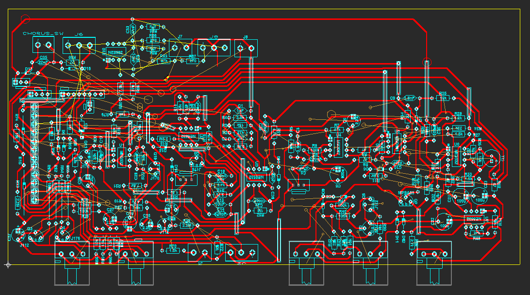

Chorus is fully laid out now:
![111.PNG 111.PNG](https://www.diyaudio.com/community/data/attachments/187/187000-7507b874da82eecd0dcd6f9edb9fc10e.jpg)
A little sloppy, too many jumpers but good enough to etch, stuff and try out. If everything works as it should, I'll tidy up the layout and make a new board.

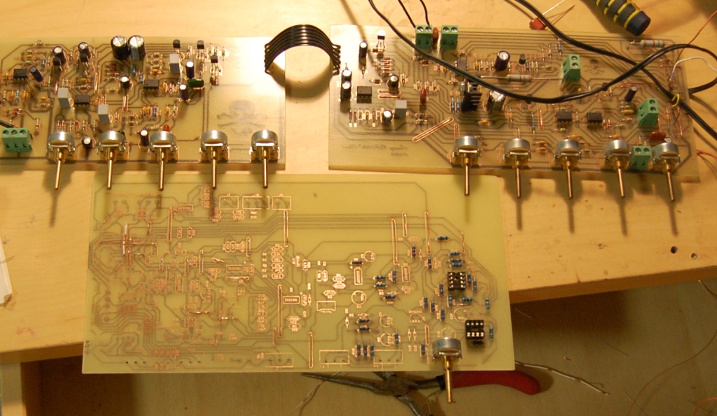

Chorus board (at long last) is etched:
and I've started the tedious process of stuffing it. Jumpers first, then resistors. The board is bigger than either of the preamp boards but that will probably be improved upon in the final version. It's a pain to lay out and etch a board that will be only for testing but that is the nature of my psychosis - I want a good looking final product.
One problem so far: I don't have enough 10K pots. Both the reverb A and B plus the chorus A and B are 10K and I only have 2. I'll use trimmers in place for testing until I can order another 2.
If all goes well, I should have it ready to test by this time tomorrow.
