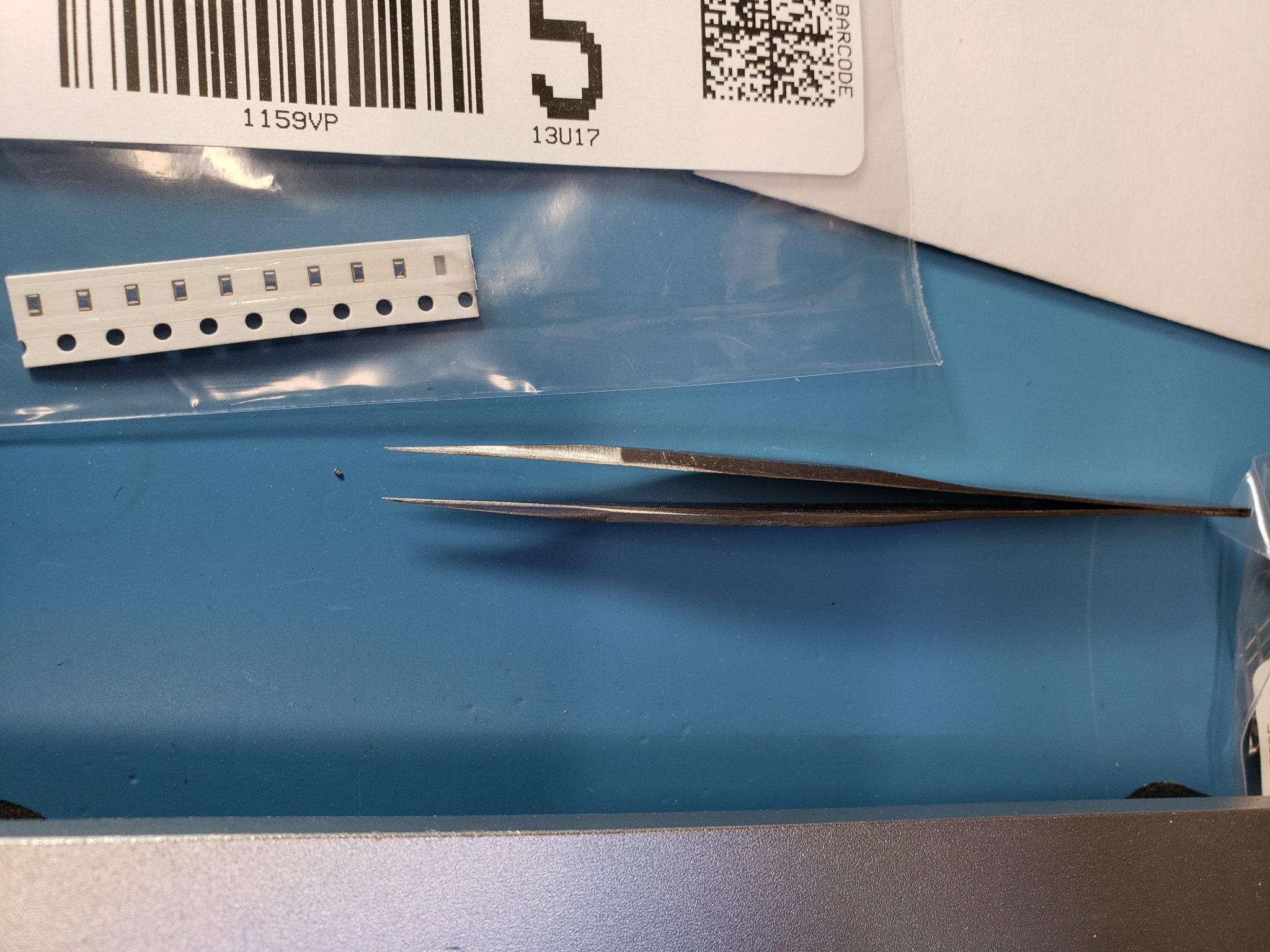

Pretty sure the Rg resistors have the wrong part number on the documentation. The called out part is a 0306 size part in inches. So small a pair of needle tweezers can't hold them and barely long enough to bridge the pads. The zero ohm jumpers are 0603 size parts in inches and fit the pads correctly. The part number for the the corresponding Susumu part in the correct size is: 754-RG1608P-221-BT5 from Mouser.
Joined 2014
Here is a picture of the part from the documentation beside the zero ohm jumpers in the correct size.
