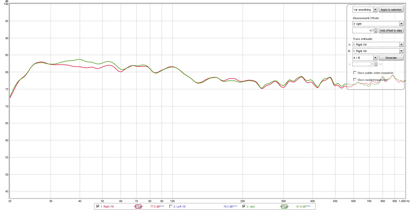

Left Ch. https://www.dropbox.com/s/yvychnovgjcscll/05 23 15 REW MM Left 1M.mdat?dl=0
Right Ch. https://www.dropbox.com/s/t9eczhz3gtcawtt/05 23 15 REW MM Right 1M.mdat?dl=0
Here are some new mdats. I changed things a bit.
Lets try the 3 cycles, and can we knee the response at 5K to be flat to 20k?

I'd say first try a few other target curves to know what does what.
But it's difficult to judge after hearing only one song. The difference in target curves does a lot to the perceived sound, even if it's a little change.
You could also do 4 cycles below and 2 up top...
Good point. Small changes in FR target make a big difference especially when the IR is clean. Also, I think our choice of FR target is probably affected by the time domain behavior of the system; once the IR is very clean we may no longer be happy with a particular FR target.

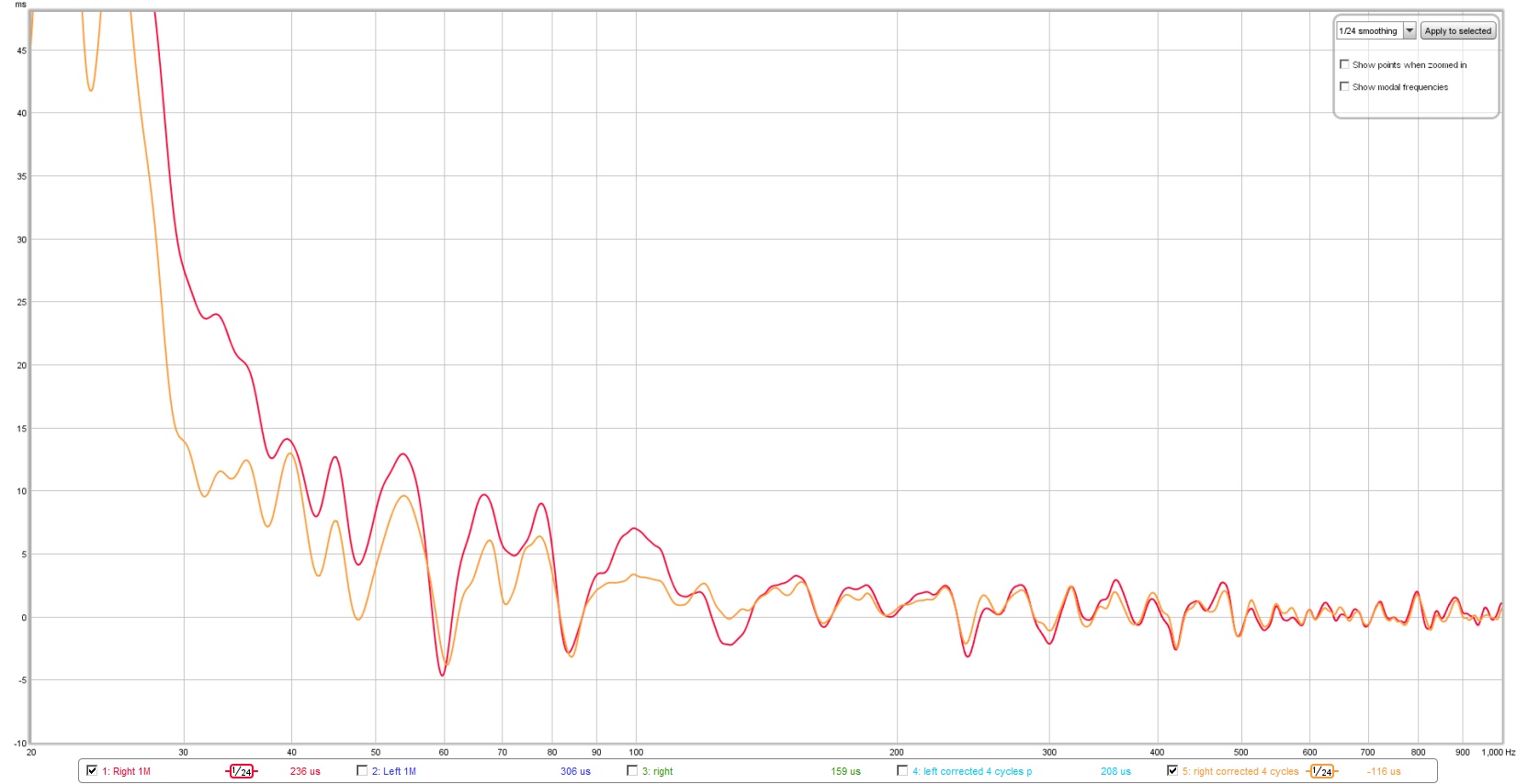

I remember. I have also read that one octave above the tuning frequency, The GD of a ported speaker is about the same as a sealed one.
I have retuned my main sub to 16hz, and my mains to 26hz.
So at 26 Hz it will be 38.5 ms delayed. Don't look at the wiggles, Smooth it a bit to see you're below 5ms at 55 Hz. The wiggles aren't static, they move with time.

Couldn't you seal off the mains? Let the 3 subs do their job there?
I'm sure Greg will eek every ounce of Group Delay out of it.
No. Lose too much SPL, and creates cone excursion problems.
