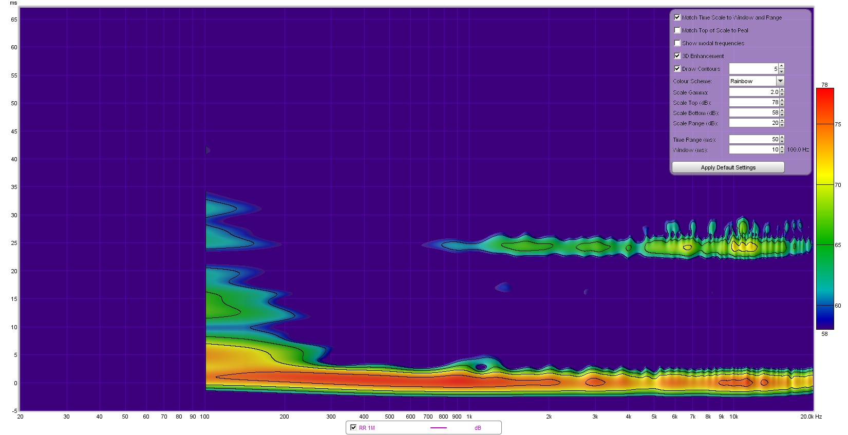

I think things sound better with it than without it. In my case, where I have tons of absorption, the sound gets a little dead. The kicker brings needed life back into the room without most of the negative effects of early reflections. For a room not so dead, I am not sure it (the kicker) would be as welcome.
As far as the bandwidth of the kicker, ive read 500hz to about 6k is optimum (not sure everyone agrees what this should be). In any case, if your doing this acoustically, that is using reflective panels to bounce the energy around, your going to get the higher stuff whether you want it or not. But I have experimented with having less or more >5K and I like the higher frequency energy being there.
![spectro 2 now.jpg spectro 2 now.jpg](https://www.diyaudio.com/community/data/attachments/449/449989-10daed67b7f6c7e0a5ecd4535e47f288.jpg)
Measuring where the ear actually is, a spectrograph shows pretty well what I am getting.
When it comes to kickers, not only is bandwidth important, but when it occurs and from what angle of incidence as well as magnitude. Timing wise, 20-25ms seems optimum. Incidense wise, 110 +/- 10 degrees would be (about where you would put rear speakers in a 5.1 setup). Magnitude wise, I like it around -8db (-12db is required for the Haas effect).
