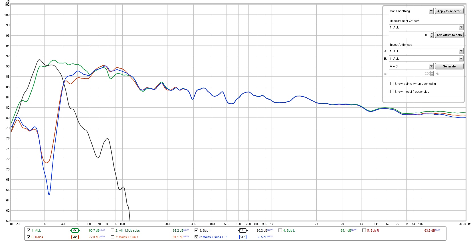

Is the sub adding or subtracting from the signal above 40 Hz.
If it's subtracting it isn't really in phase, if it's adding it is...
I didn't misunderstand you here... that's why I added; only if you want to.
I remembered the fixed slope. But that doesn't mean everything is actually in phase and adding to the signal the way you have it setup.
If it is adding and providing a nice bridge between the 2 rolled off drivers you're all set. It's that simple.
Not bad at all, you do see how the peak from the sub (80 Hz) is out of phase and actually subtracting from the mains. No big problem as you had a bump there otherwise. Same can be seen on the lowest end. But very close to perfect.
Nice! Looks like you're winning on this journey of yours. Satisfied?

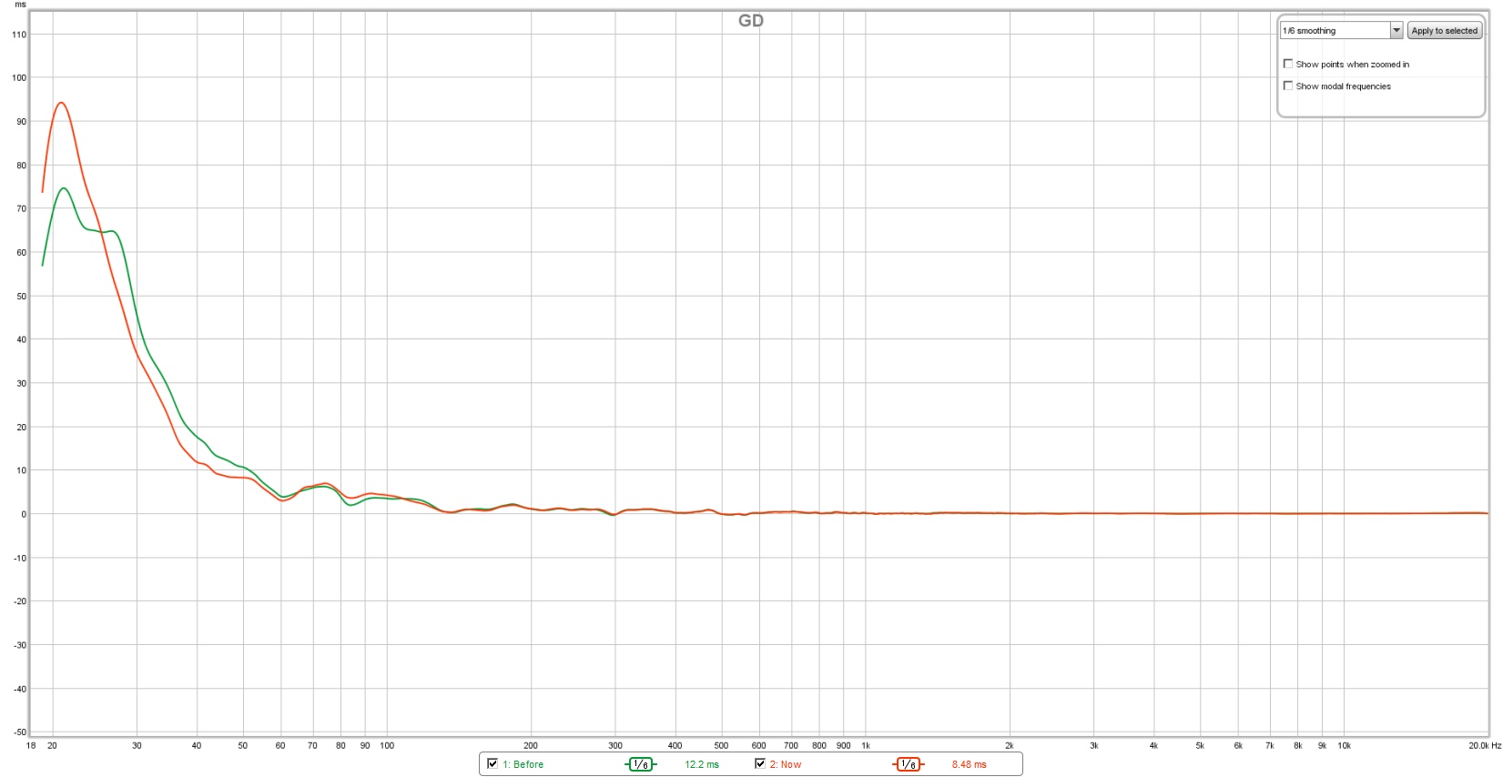

I am not sure.
![GD N B.jpg GD N B.jpg](https://www.diyaudio.com/community/data/attachments/438/438867-4790b671e0c1415d5fa260cdbff202cf.jpg)
![FR N B.jpg FR N B.jpg](https://www.diyaudio.com/community/data/attachments/438/438878-5b0d87990f8752c8a3a23526037a248a.jpg)
Which would you rather have?
Orange or Green? (anyone answer)
I'd say green based on FR, orange based on GD
But only you can hear it. And it's difficult at that. There are going to be differences but is it the timing you hear? Or less really low bass putting the emphasis on the part above it.
Which do you like, that is the question. Not an easy one I presume?
Edit: I like the low extension of the orange one. On some music it's wonderful to have that low roar at 20 Hz, not really to hear it, but you definitely feel it! Based on that the orange one could win me over. As long as you feel nothing is missing. I reduced output of my arrays at 20 Hz, sloping down from 30 Hz.
But some pieces of music never felt the same. Even though there's still output there, it's not flat to 20 Hz anymore and I miss it a bit. Yet I'm afraid of letting my little cones do that for me, just for that feel. I want to keep them I think. A sub or 2 or 3 might be in my future. All sealed of coarse.
I'd say green based on FR, orange based on GD.
Thats the thing. I knew what FR differences sound like. But didnt know what low GD did. So I had to go all out to lower the GD to get a sense of what that sounded like. As you noticed, I had to sacrifice the FR I wanted to achieve the lower GD.
The idea I am toying with right now is to use a RLC notch filter on the woofers of the mains to bring down the 70-110hz energy 1.5 - 2db or so on the Orange FR.
Listening to it both ways, the charts pretty much tell the story. I like the bass tightness of the Orange, but the FR of the Green.

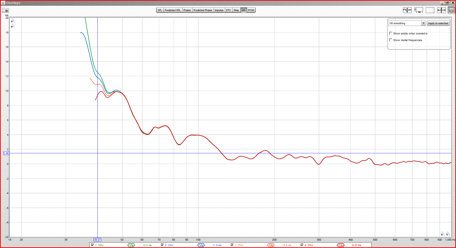

I know, its been a long thread. But we have already covered this. Yes, its needed (I'll explain it again if you want).

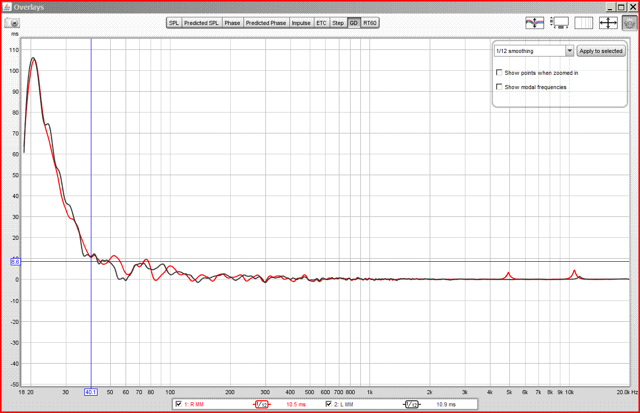

I'm at 10.7ms of GD at 40hz. Thats less than 1/2 a cycle. You really think it needs to be 5ms shorter?
Sorry I missed it. I only said it because I did the same thing and saved myself 5ms at 35Hz.

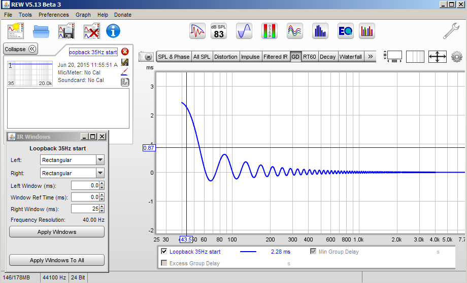

IR measurement is a map that gives the relative amplitude and phase of all sine waves within the measurement bandwidth. GD is first derivative of phase. Absolute phase of all frequency components are measured relative to point chosen as t=0 for given signal.
REW: When upper and lower frequencies are chosen for a sweep measurement, the software limits display data to only within the selected sweep endpoints. For sweeps starting below 20Hz REW generates a sweep with corresponding inverse that is capable of measuring to DC point. For sweeps with 20Hz and up start point REW creates sweeps with brickwall high pass filter. All this is readily observed when digital loopback measurements are made with REW.
Gating: term is used very loosely. I see the term applied and often from displayed results it is clear to me that a gated response is not being used. A gated response is rectangular window. All values outside window are truncated to zero. Windowing that does not fully capture high pass filter behavior of IR induces low frequency ripple in the observed frequency response.
REW generates all displays by applying calculations to measurement's current windowing. Only samples within window are used. For rectangular window actual sample values are used; otherwise the windowed sample values are used.
Here is digital loop back GD measurement using 44.1kHz sample rate with sweep start 35Hz, sweep end 22050Hz using 512k length setting with 25ms rectangular windowing starting at IR peak centered at t=0:
![Digital loopback 35Hz start.png Digital loopback 35Hz start.png](https://www.diyaudio.com/community/data/attachments/442/442712-681f61cdabe0682ca303b451d50f777b.jpg)
In answer to the bolded area, it this to say that REW sweeps should always start below 20hz as to not induce frequency ripple? (when analyzing low frequency GD).
Is the default settings in REW sufficient to capture the high pass filter behavior of the IR? (those settings besides the sweep frequency which is addressed above) ? For instance the gate settings (left and right window lengths) ?
As for the rest, I thank you for a very thorough response. But I am not sure I am getting your intended point. Is there a conclusion you draw as to GD accuracy based on sweep frequency width? I see your "ripple" pic.
Is what your saying as simple as; Sweep lengths that begin 20hz or above are subject to "frequency ripple", making GD measurements less accurate. And I guess the further you are from 20hz, the bigger the ripple?
