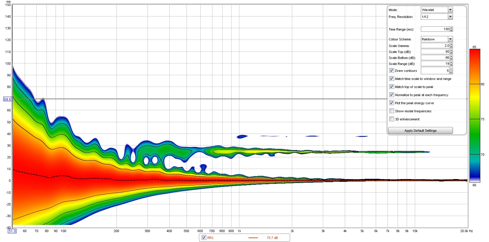

ra7 - But both plots you mention are merely different representations of the same IR response. That's why I like the APL_TDA view, you basically "see" the group delay in that plot:

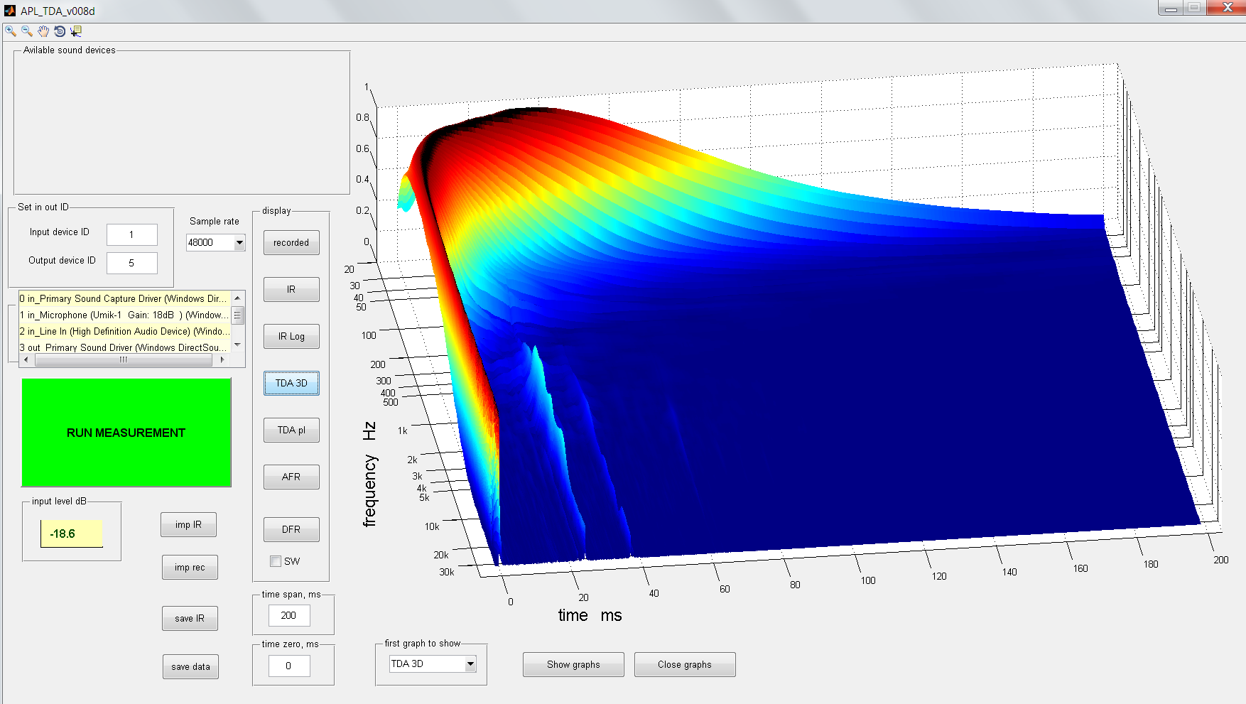

Measurement of my FIR correction with the demo version of the TDA software in my room, stereo pair at listening position.
![TDA_3D.jpg](https://www.rsr-concepts.com/diyma/TDA_3D.jpg)

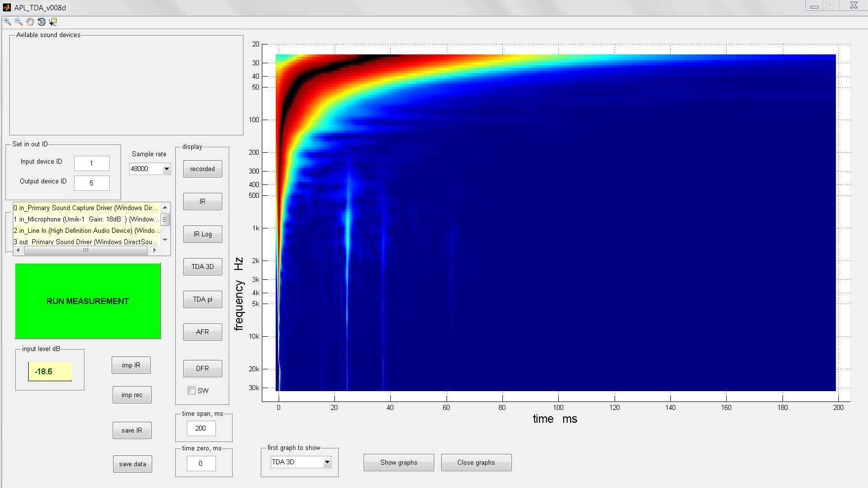

After installing the demo, put the right sound out (Output ID) and sound in (input ID) from the list above it (1 and 7 in my case) and run measure (as in REW). Do keep the level down at first. You can find it by Output: mono Level -10 dB in my screen grab.
It will run a short sweep and calculate the graphs and done... a visual representation of what's happening. As if you were reading the group delay without the hassle, just a visual. In 3D and 2D and the belonging frequency graph (AFR - Amplitude Frequency Response) and group delay (DFR - Delay Frequency Response) are there too. The paid version lets you do distortion etc. and save graphs and probably more as this is the base measurement suite of an entire product line. Targeted at a Pro Audio group, it should fit well with your room.
The key being the visual representation of the integration in time of your speakers and subs. A lot harder to really see in REW. See it as a high resolution version of the wavelet in REW. One that shows you that piece of information in high definition and 3D.

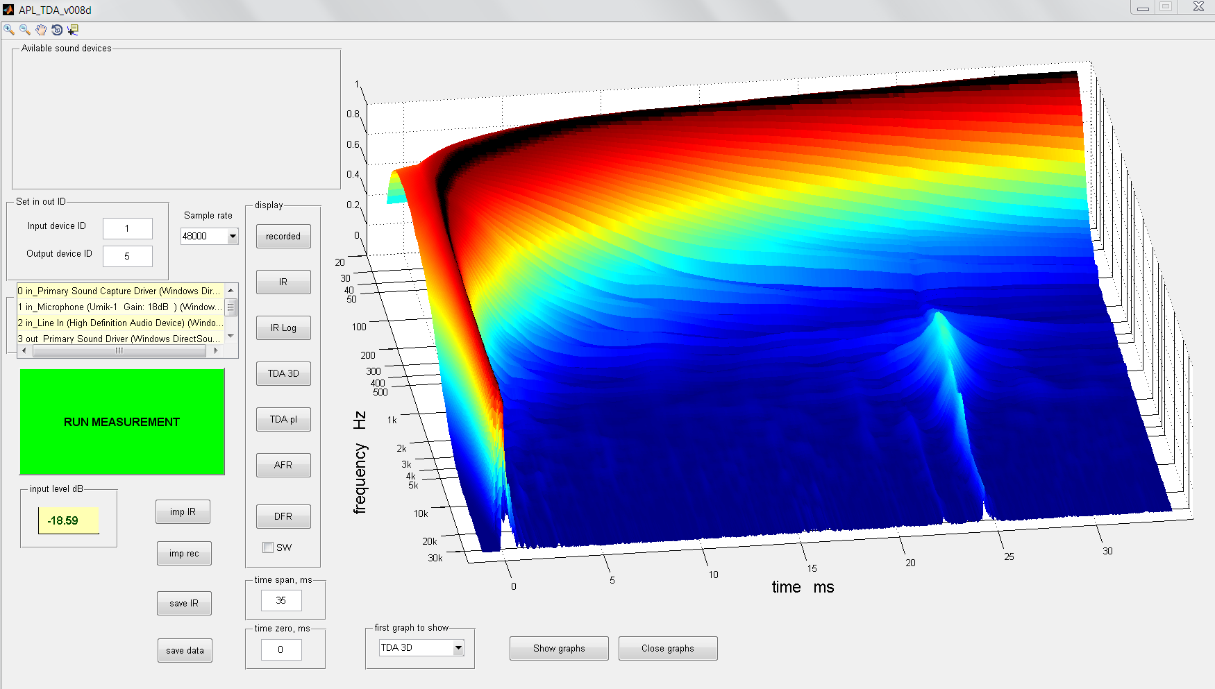

View the 30 or 40 ms window, it is set to 200 now. That will likely show the phase turn you get with the chosen crossovers, as the rest of it is remarkably clean. This shows a fluent handover from one driver to the next. Basically textbook on first sight for a speaker with crossovers. What did the DFR tab look like? That's the equivalent to the group delay I guess.
Compare to my plot, one page ago. set to 30 ms window. No group delay other than minimum phase roll off.
Remember my quest for time coherency?

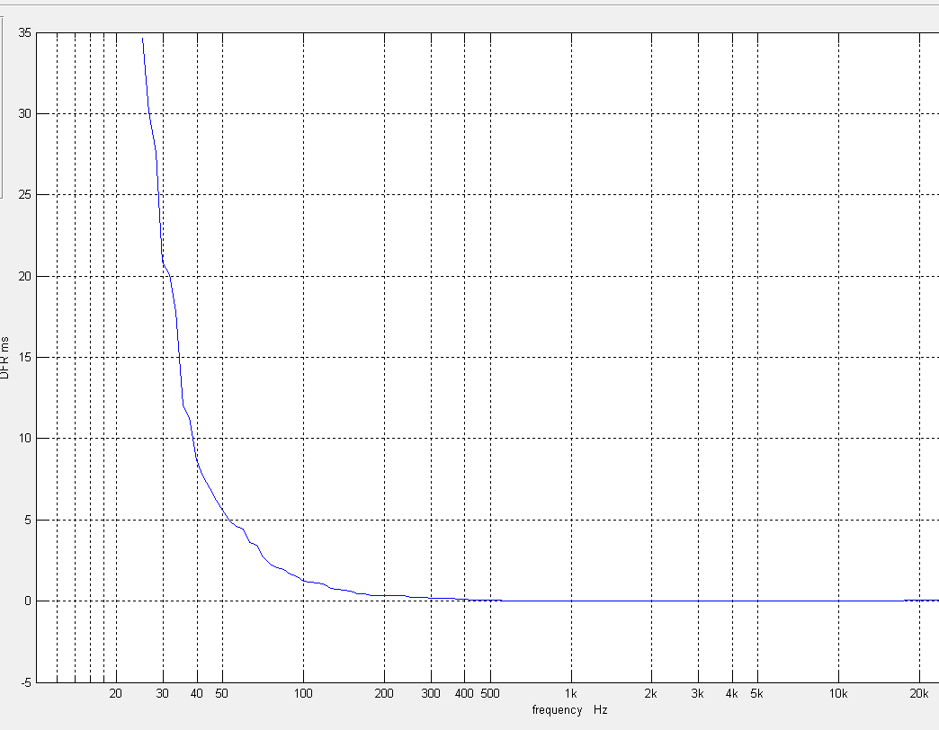

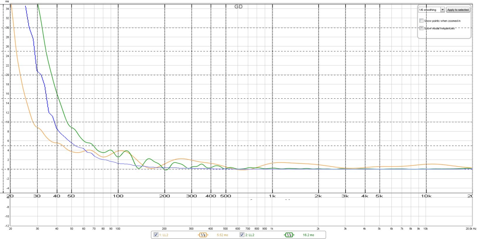

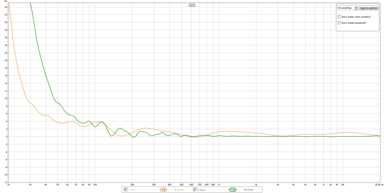

If in the new REW, you set a 1/6 octave frequency dependent window on your measurement, then view group delay, does it agree?
Still doesnt agree.
Very beautifull clean 3D plot jim1961, guess little more delay in lows than wesayso's are his XO-less sealed box verse multi-way XO and or ported woofer roll off.
Thanks. The 24ms ridge is there by design FYI.
If in the new REW, you set a 1/6 octave frequency dependant window on your measurement, then view group delay, does it agree?
For illustration sake, adding a frequency dependent window changes the GD in REW from the green plot to the orange one.
Interesting, to see the differences I've overlaid both graphs:
Not much I can say about it though. The APL_TDA software claims 10x better time resolution than the normal FFT approach REW uses. I'm not enlightened enough to know if that claim is true yet.
But it is interesting to compare these results. But I don't know which one actually is closer to the truth.
