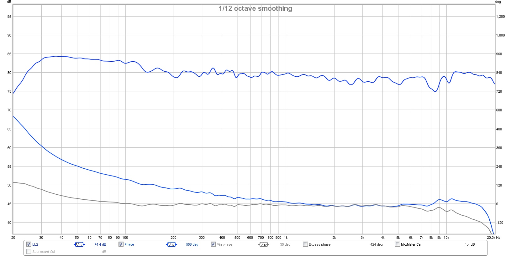

Ive been trying to follow what you mean by the bolded parts of what you said. Can you apply what your saying to the attached graph? What would need changing? Can you explain?
In my case, <27hz or so I cannot make it flat and protect my sub. So my bandwidth is limited to 27-20K.
![525050d1452813591-group-delay-questions-analysis-ll-min-phase.jpg](https://www.diyaudio.com/forums/attachments/full-range/525050d1452813591-group-delay-questions-analysis-ll-min-phase.jpg)
The minimum phase (if everything is optimal) follows the frequency shape closely. You can see actual phase in your plot starting to deviate from that minimum phase plot. That is creating the delay you see in the lower frequencies. This is because the phase turn is caused by the crossover type used. If we look at the above plot, at 30 Hz we can see the phase has turned 360 degrees. In other words, the signal at 30 Hz is lagging one cycle behind the initial impulse at that 30 Hz frequency. A group delay plot would show about 33 ms group delay at that point.
If the actual phase was following the minimum phase plot, we see the phase would be at about 90 degree at that 30 Hz frequency. In that case the group delay at that point would be around 8 ms. A quarter of what it is now.
But it's not as easy as to slap on a correction, as yours is a vented design.
It's text book behaviour for how it was created.

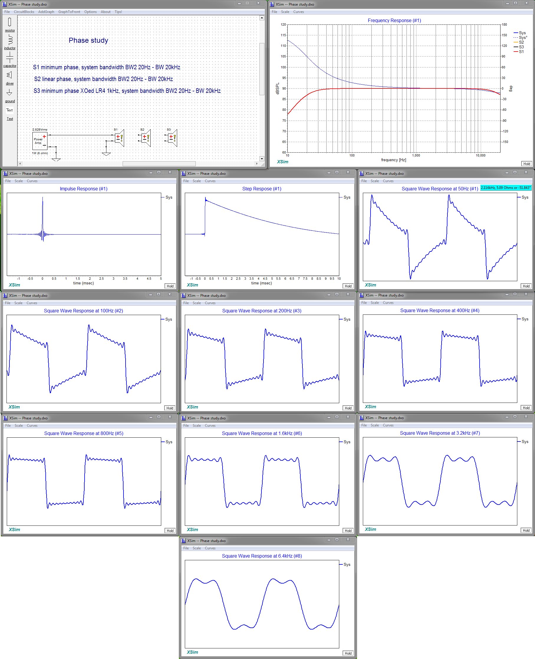

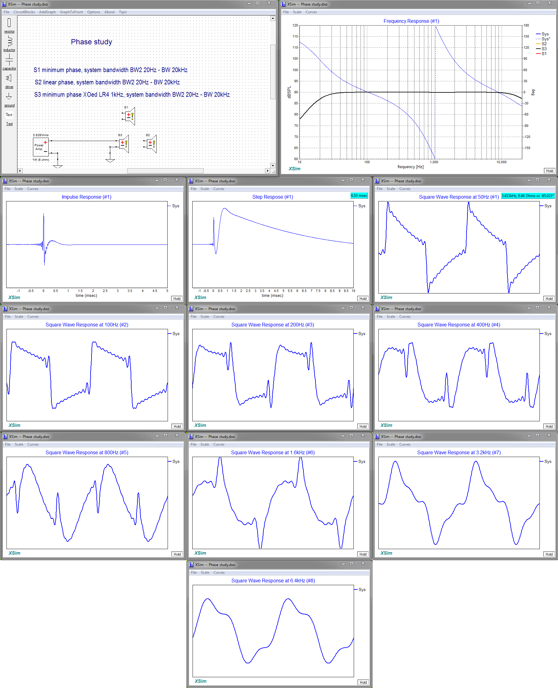

Look at these plots created by BYRTT to show a minimum phase system vs a 4th order crossover.
First the minimum phase version:
And compare to the 4th order at 1 KHz:
Look at the square wave shapes these 2 different setups play.
Your speakers have a 2th order crossover if I remember right and the effect will be somewhere in between these two plots.
But your setup has also reflex port design in the sub (and mains?) so as seen your phase rotation starts a little later and is less severe compared to that 4th order at 1 KHz.

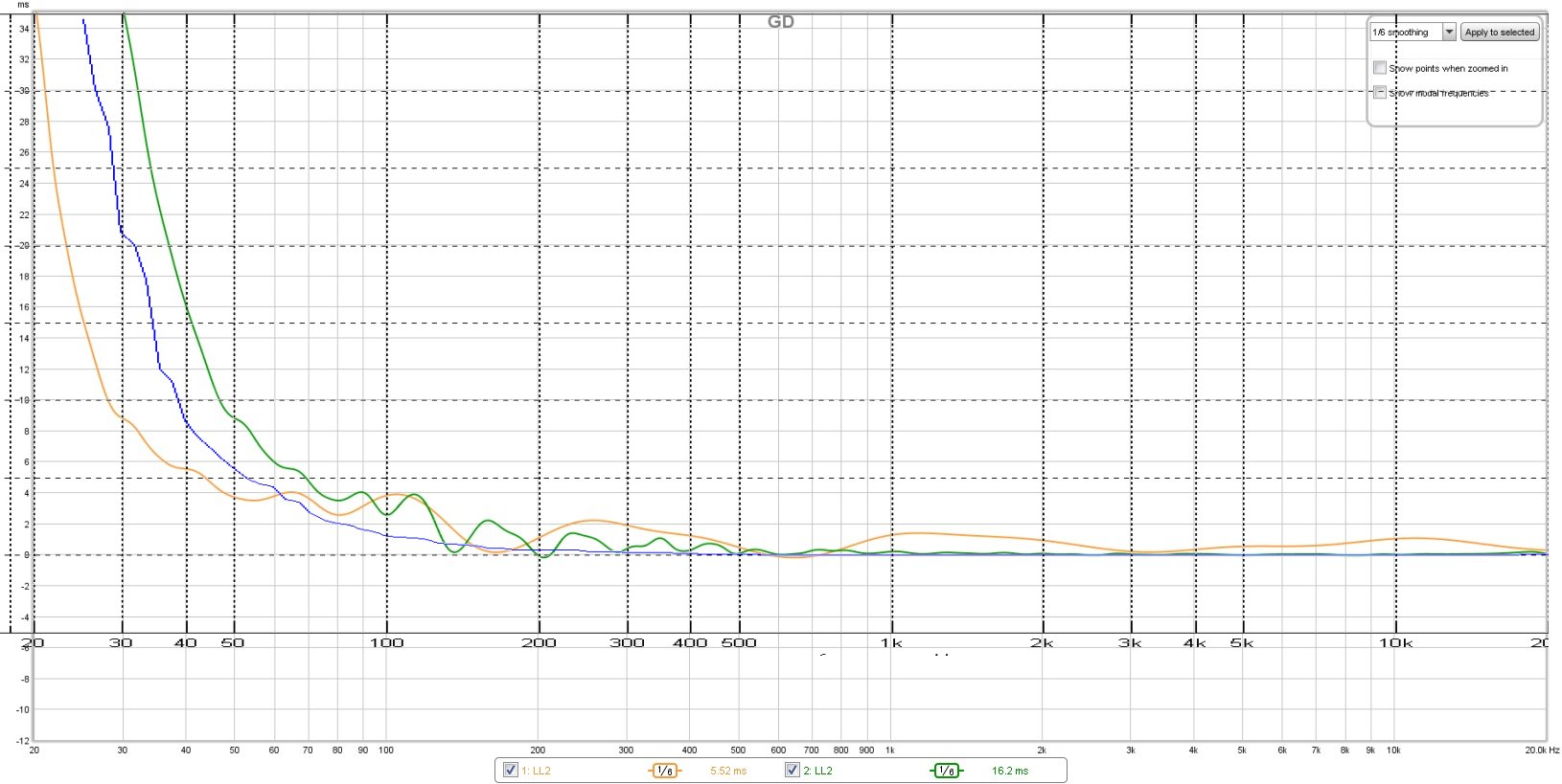

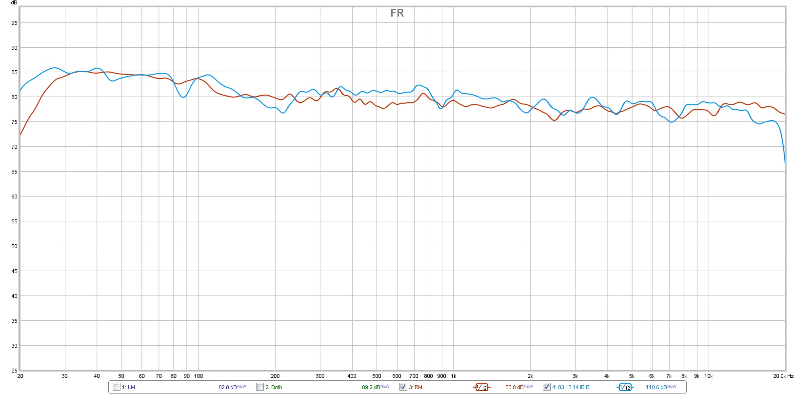

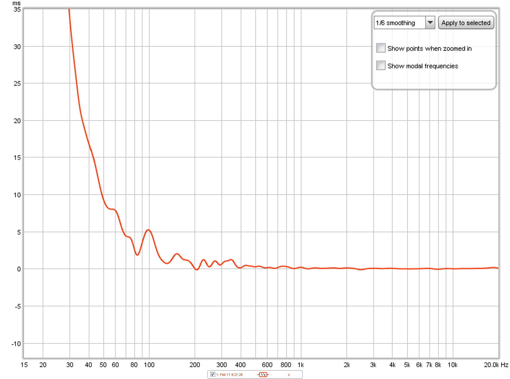

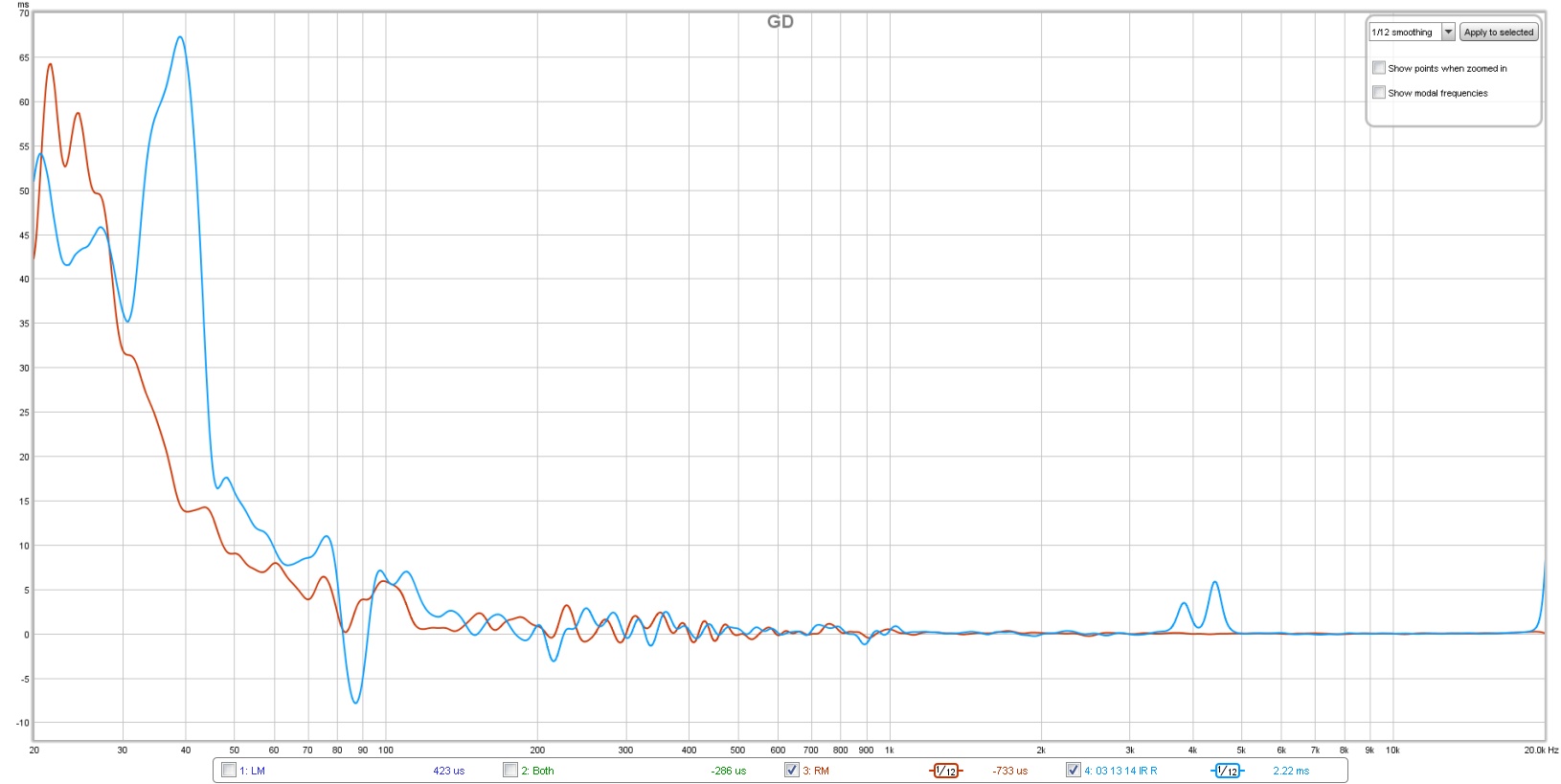

Back to the topic, I thought id go find the oldest measurement I could find and compare the GD's.
The FR's were not that different oddly.
Think what looks really good in new present one if we omit what is best FR and GD theoretical is that its smooth coherent GD as was it one wide band driver without XO and band pass ctc distance distortions.

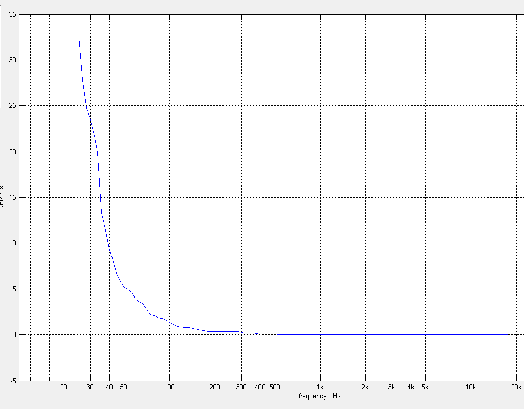

Interesting, to see the differences I've overlaid both graphs:
Not much I can say about it though. The APL_TDA software claims 10x better time resolution than the normal FFT approach REW uses. I'm not enlightened enough to know if that claim is true yet.
But it is interesting to compare these results. But I don't know which one actually is closer to the truth.

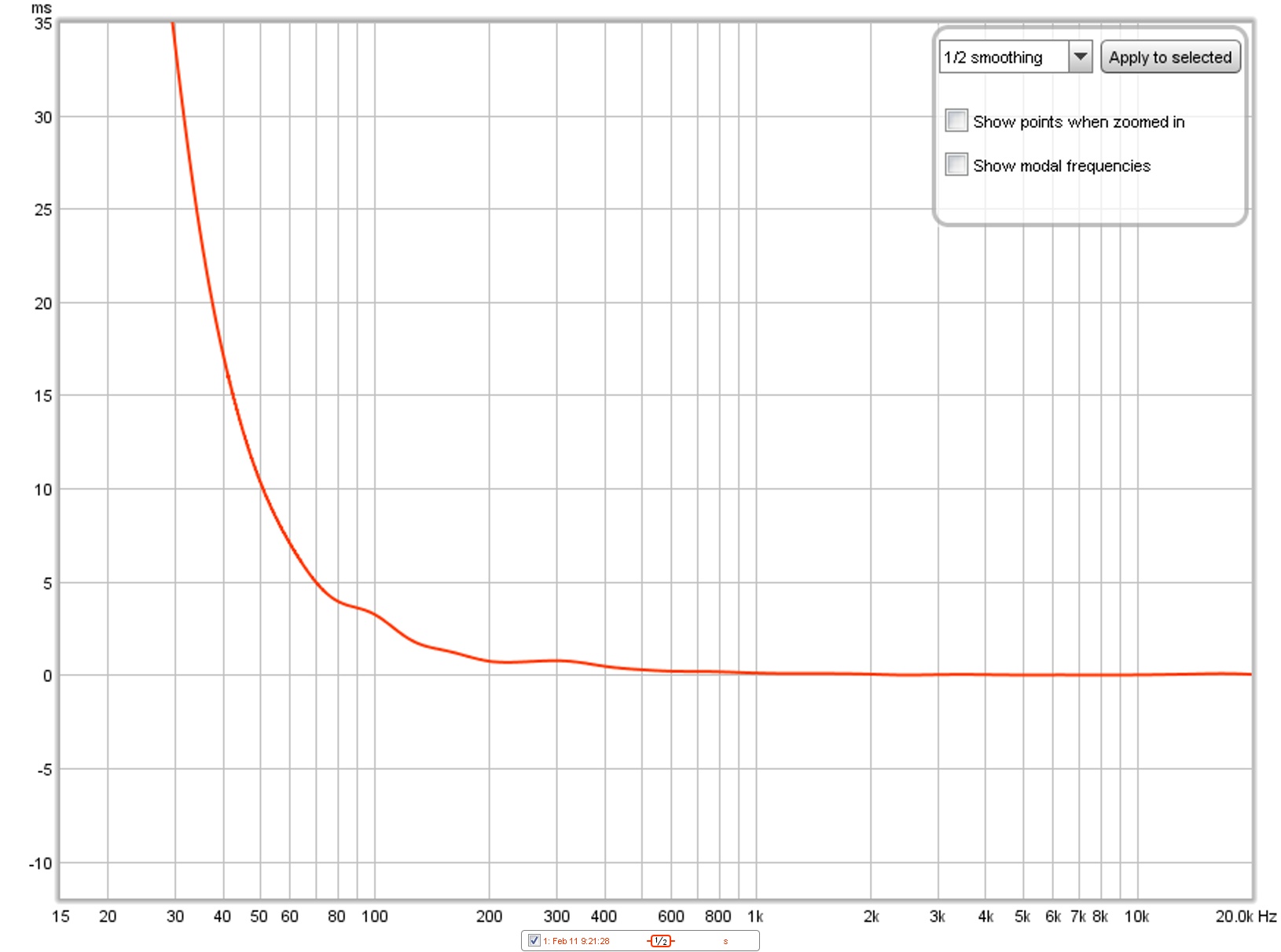

I just ran these. The interesting part is not only the different values per frequency, but APL misses the bumps and wiggles that REW shows at 1/6th oct smoothing. Its only when I display REW at 1/2 oct smoothing do the graphs look similar.
So the question arises to why DFR doesn't show those bumps and wiggles? Is it extremely smoothed?
When looking at the AFR of APL vs FR for REW, it also takes a good deal of smoothing to make the plots look similar.
