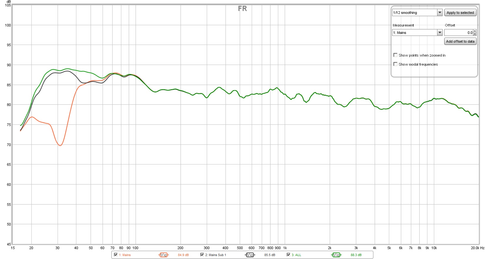

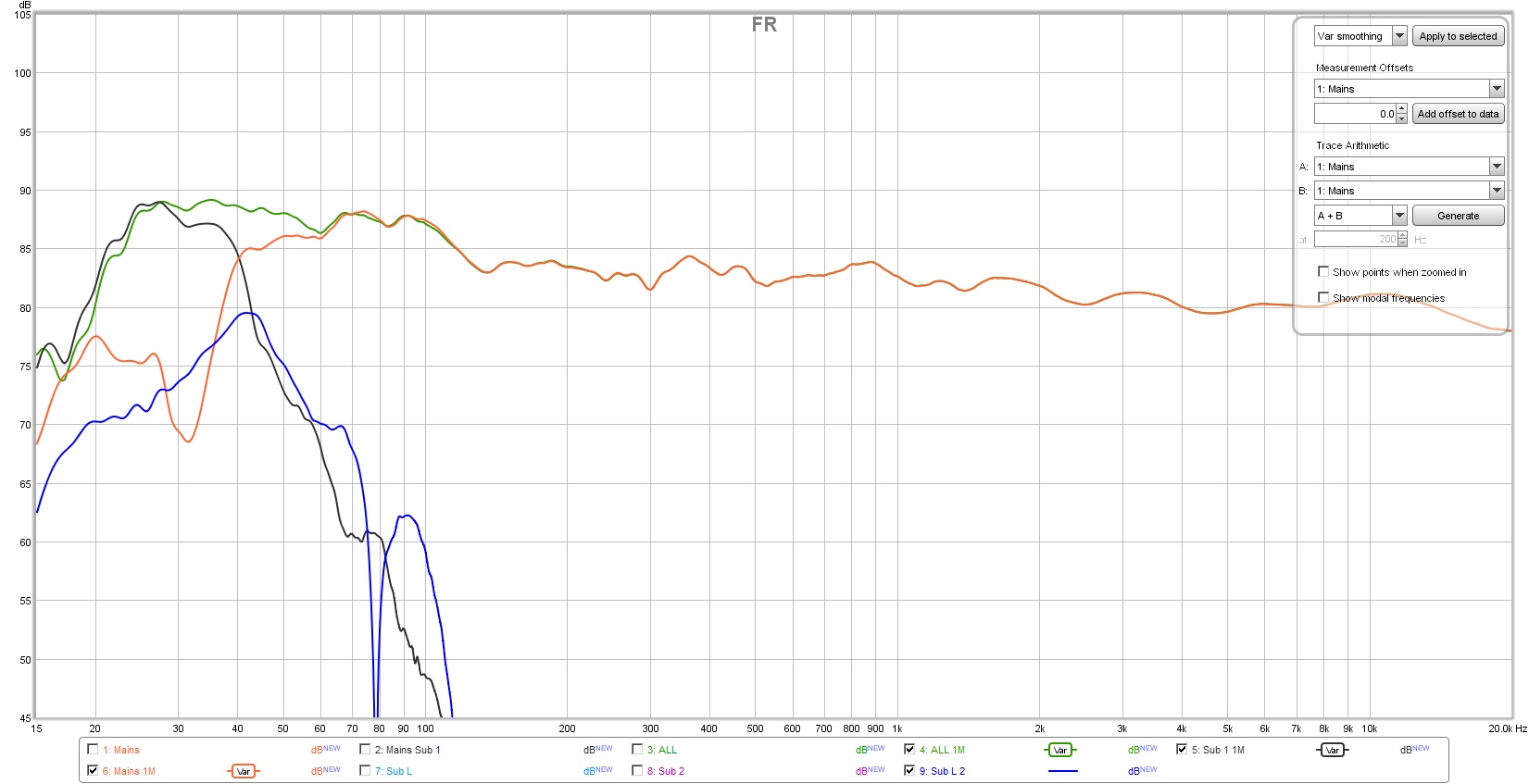

This is the mains response. I had to marry the sub to this. I am not using the DSP to affect the mains or the sealed subs at all.
I tried 2nd order slopes and they screwed up the FR in the 50-100hz range. I did try them, and with several XO points.
That is a really steep cliff on the mains at 50Hz - is there a high pass filter somewhere? A bass reflex usually falls of at 12dB/oct. Try moving XO point up to 80Hz, 40Hz is a very low XO point and your subs should work well up to 100Hz even.
The cliff is at 40hz actually. No filters on the mains. The "cliff" is a SBIR room issue. The mains are about 8' from the front wall.
I did try moving the XO up higher. All the overlap with the mains created a definitive bulge from 40hz to just beyond wherever I set the XO point.

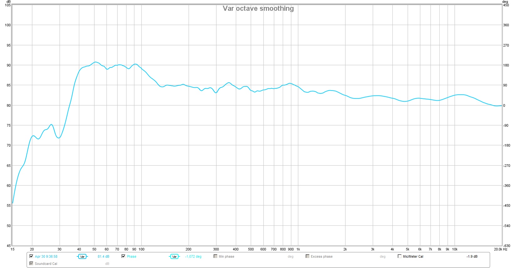

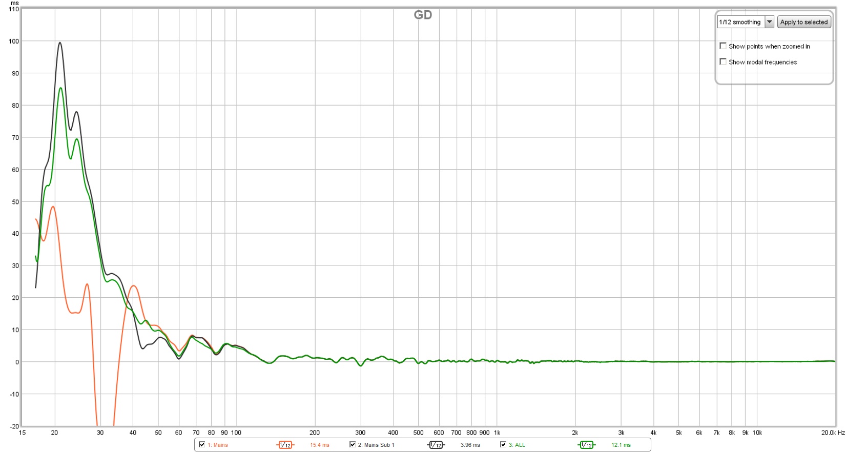

The new theoretical best is lower and quite a good number: 6.25ms at 40hz and 10ms at 30Hz
Ive been playing with the DSP and learned a few things.
I CAN get close to your theoretical numbers, but I have to sacrifice lots of magnitude in the low end to get there.

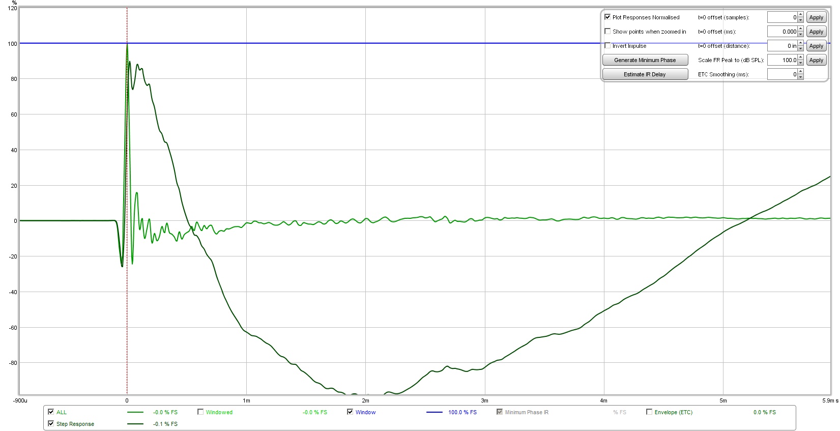

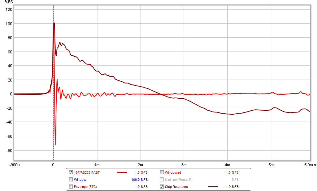

What does your impulse response look like? Click on "Step Response" and see what that looks like. If you can adjust all the time delays to get something like this - it will go from good to great (or extraordinary sounding tight bass).

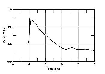

Here is SR and IR from my speaker - and when I got this - it knocked my socks off:
![480522d1430436110-10f-8424-rs225-8-fast-ref-monitor-image.jpg](https://www.diyaudio.com/forums/attachments/full-range/480522d1430436110-10f-8424-rs225-8-fast-ref-monitor-image.jpg)

GD is based on derivative of frequency response - so it can be tilted but not curved. Flat as in level is not required for low GD.
For the step response, you have a large negative overshoot at 2ms. I think that means that there could be better time alignment between your tweeter and your mids. But it actually looks pretty good - Wesayso knows more about this maybe he can suggest how to improve.

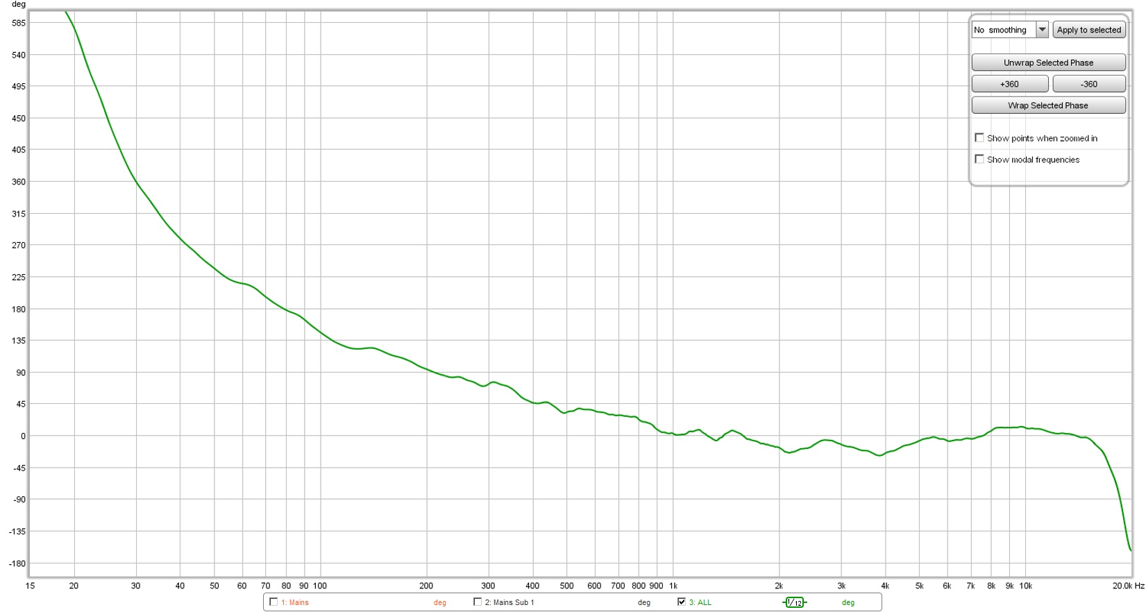

![phase now.jpg phase now.jpg](https://www.diyaudio.com/community/data/attachments/443/443727-6902ede3d02b18c582c5b59c9dcaca53.jpg)
If I am reading my phase graph right, the frequencies in the 2-4K range arrive slightly before the rest. The Tweet/Mid XO (LR2) is around 2800hz.

I've never seen such a step response (or group delay) and phase behaviour from a second order speaker before. If this were a commercial design it would cost mayor dollars I'm sure. More proof Troels knows what he's doing. It looks very well behaved in time domain and your room seems excellent!

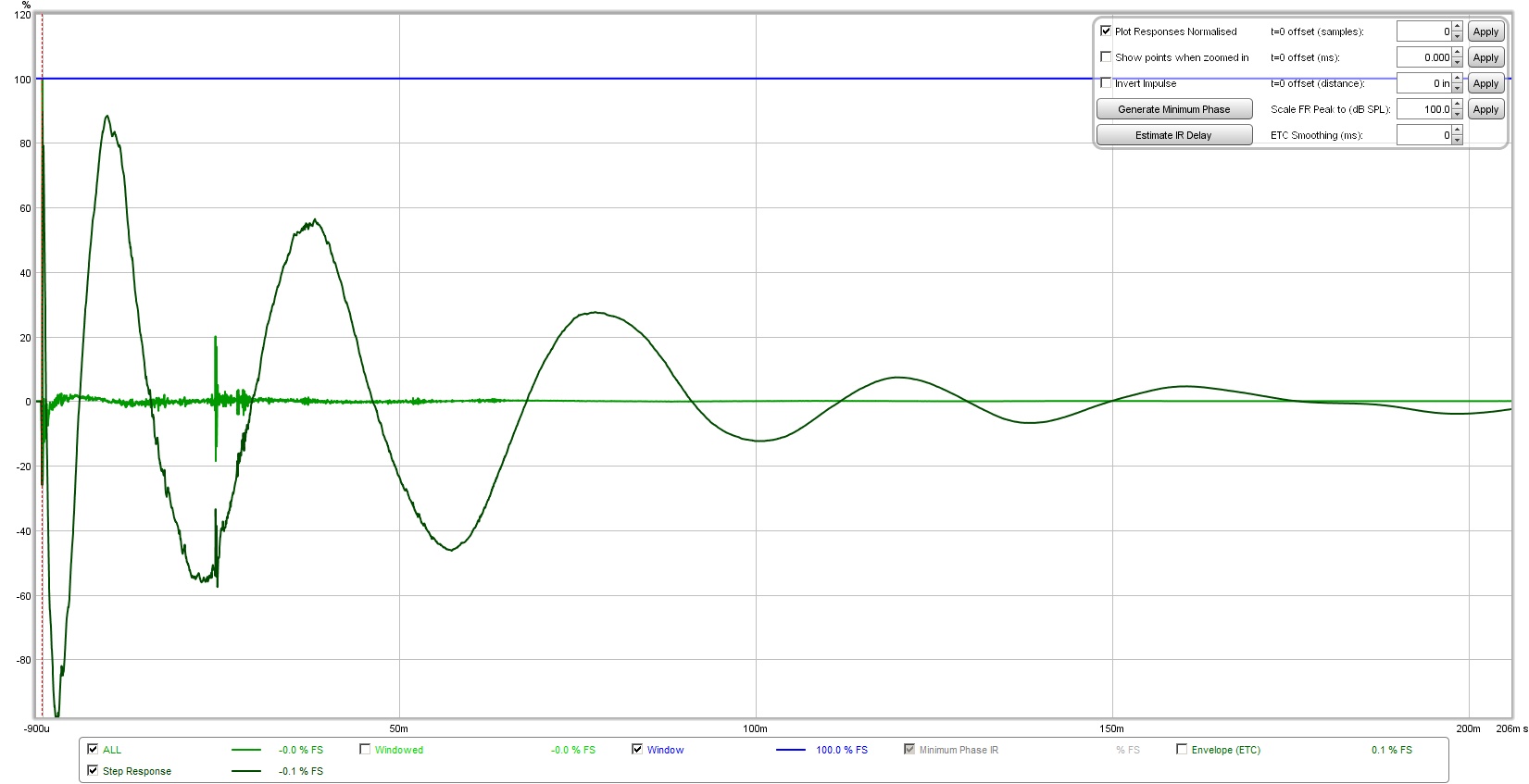

Just to indulge me, could you show a Group Delay plot gated 20 ms? Just curious.

I have to say that if this is your phase plot from listening position - it is one of the best I have seen. This means you have a fantastic sounding system and room any recording studio would be proud to own. It also means you really know what you are doing and have eeked every little last bit of performance out of it. Can we get a photo of your setup so we can all admire what audio nirvana looks like?
Congratulations! I am not sure you can do much more other than go to DSP DRC and FIR!!!
