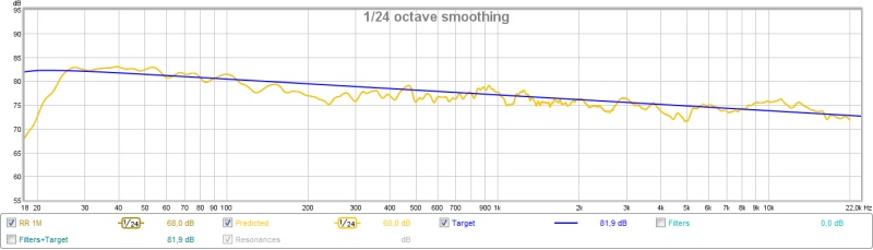

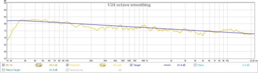

Greg, the supplied files (left and right) do have a general downwards slope. For this occasion (virtual audition) probably measured about a head's width from each other.
Would you be able to keep that slope for best resemblance to the current preferred sound? I know you like things flat
Measured in REW I'd say he is dropping very close to Sean Olive's preferred 1 db/octave...
With all the work done already I'd think that would be the closest to the preferred target here...

I already have my PC hooked up to my DAC (required for getting the REW sweeps over to my system). Long story short, the PC-DAC interface doesnt sound as good as the CD-DAC. I have have compared the exact files both ways. The CD-DAC interface wins clearly everytime.
The Rega DAC utilizes a different (inferior) chip set via USB than it uses for its coax and optical inputs.
So your proposal would be at a disadvantage from the outset. The only way to fix this would be for my PC to have a coax output (which it doesnt). And an expensive soundcard isnt an option.
Dont get me wrong, I appreciate the work your willing to do on my behalf. But I dont see a way for improved sound, which has to be the goal, given what I currently have hardware wise.
If you guys want to play with my mdat's, and there is something you can gain for yourselves in doing so, have at it. Id love to hear what you learn.
