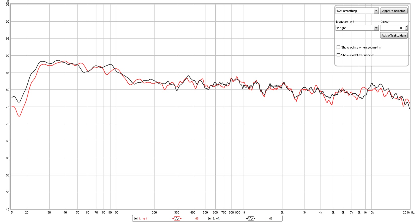

Hmm... not much correction of the GD plot by DRC. It probably corrects to minimum phase behaviour?
Nice frequency response though, cleaner impulse, is the kicker at 25 ms left intact?
That's a deliberate feature but I expect it to fall way out of the correction window.
I don't think the GD was too bad to start with and may be good enough after this level of correction, but I'm not sure. Maybe look at it as frequency cycles rather than time in ms?
The kicker is actually very slightly altered and so should probably be switched off for the sweeps.

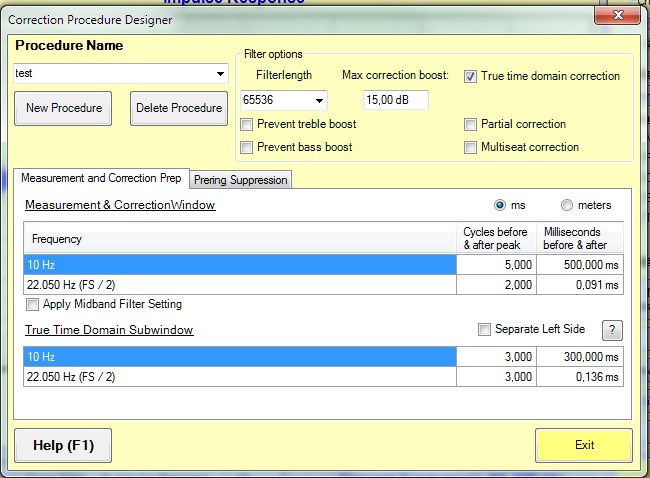

I know Audiolense can be run in minimum phase and linear phase mode:
attachment.php
The difference there is ticking that True time domain box.
Surely DRC must have something similar? I haven't found it yet though.

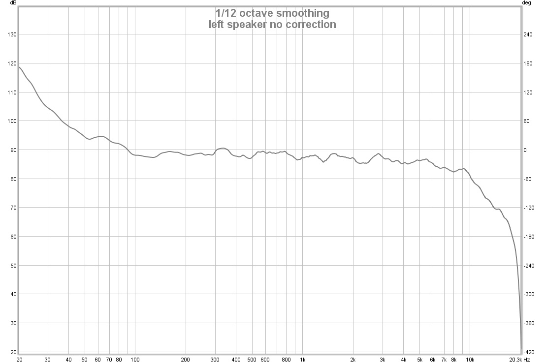

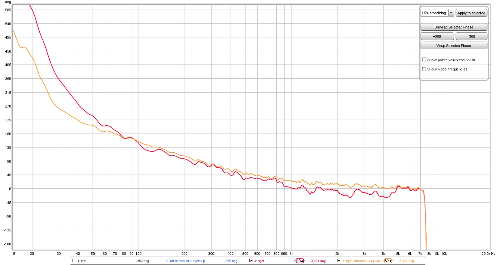

Min phase response

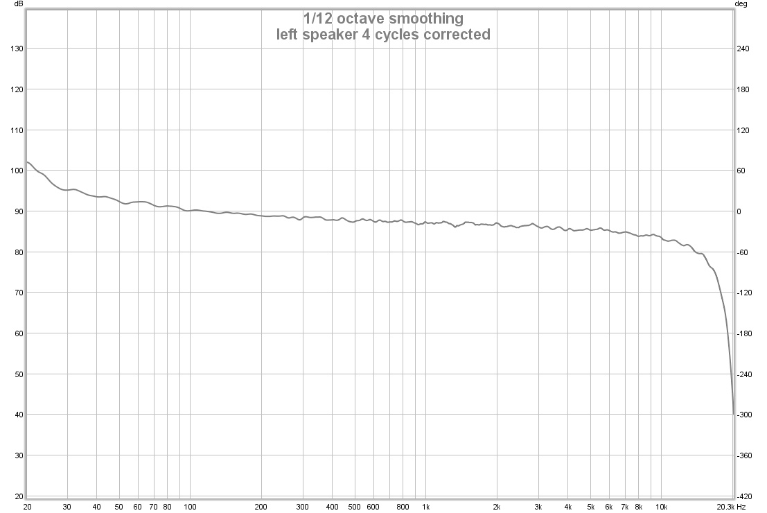

I would say there is a big improvement in low freq min phase response. At 20 hz we're going from almost 180 deg to just a bit more than 60 deg. I have the PL stage of DRC set to linear phase which will allow some pre-echo in order to improve phase response.
Yes, that's what I thought. But more should be possible. We see a nice arc where we would want flat phase to get the timing right.

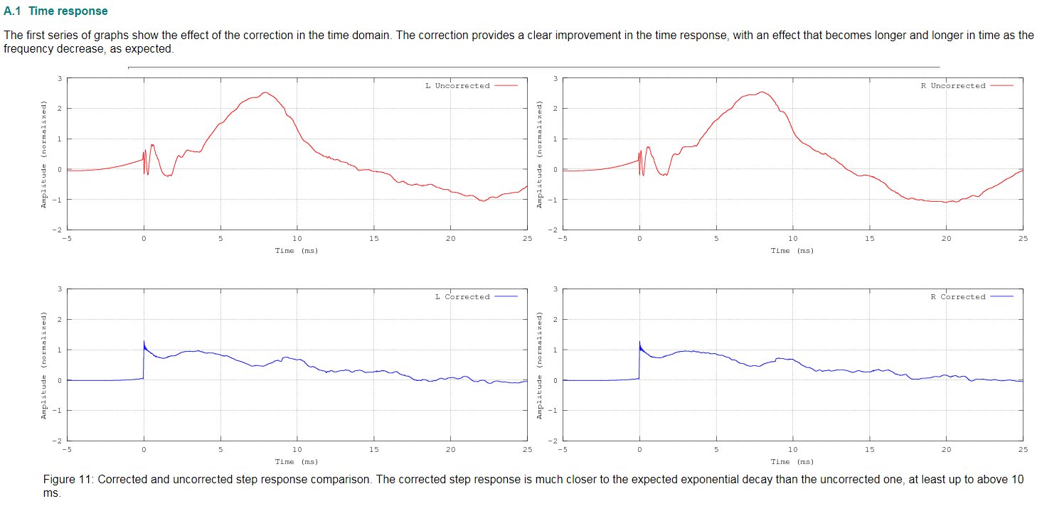

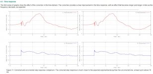

From the DRC documentation I see this plot:
attachment.php
So clearly we could do more in the time domain. What is done here seems like getting everything to minimum phase, but the group delay follows the slope of the phase response.
It's something I haven't figured out yet in DRC but should be possible as the above example shows. Your starting point is better than what's shown in these graphs.
wesayso, As far as I know, the examples in the DRC documentation are done with the "normal" preset which has a window length of 10 cycles. So, yes, we can certainly do more, but my thinking was to start at the minimum level and crank it up when we know were on the right track. In the meantime, I'll try to show you whatever you want to see.

Greg, did you notice the huge change in the Step response in the example?
That long horizontal tail slowly going to zero is when it is time-coherent.
The corrected impulse did not show that kind of correction, but maybe more cycles are needed to get there. I never got that entirely but as you know I use long windows on top and bottom and shorter ones trough the midrange. But I haven't found a way to get it like I want it yet.
Could you show what an 8 cycle preset would to the STEP?

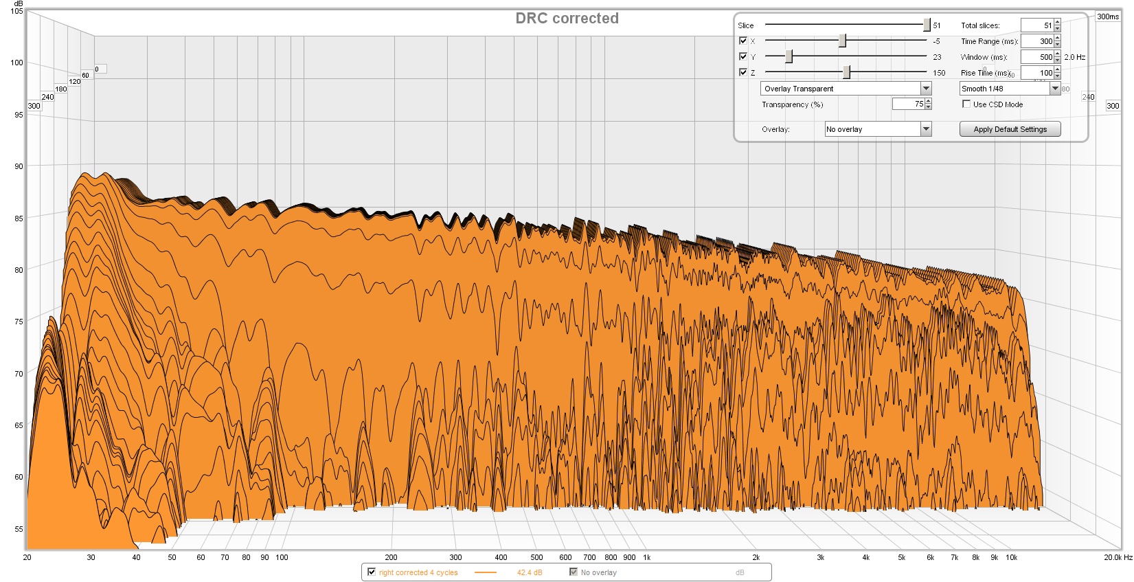

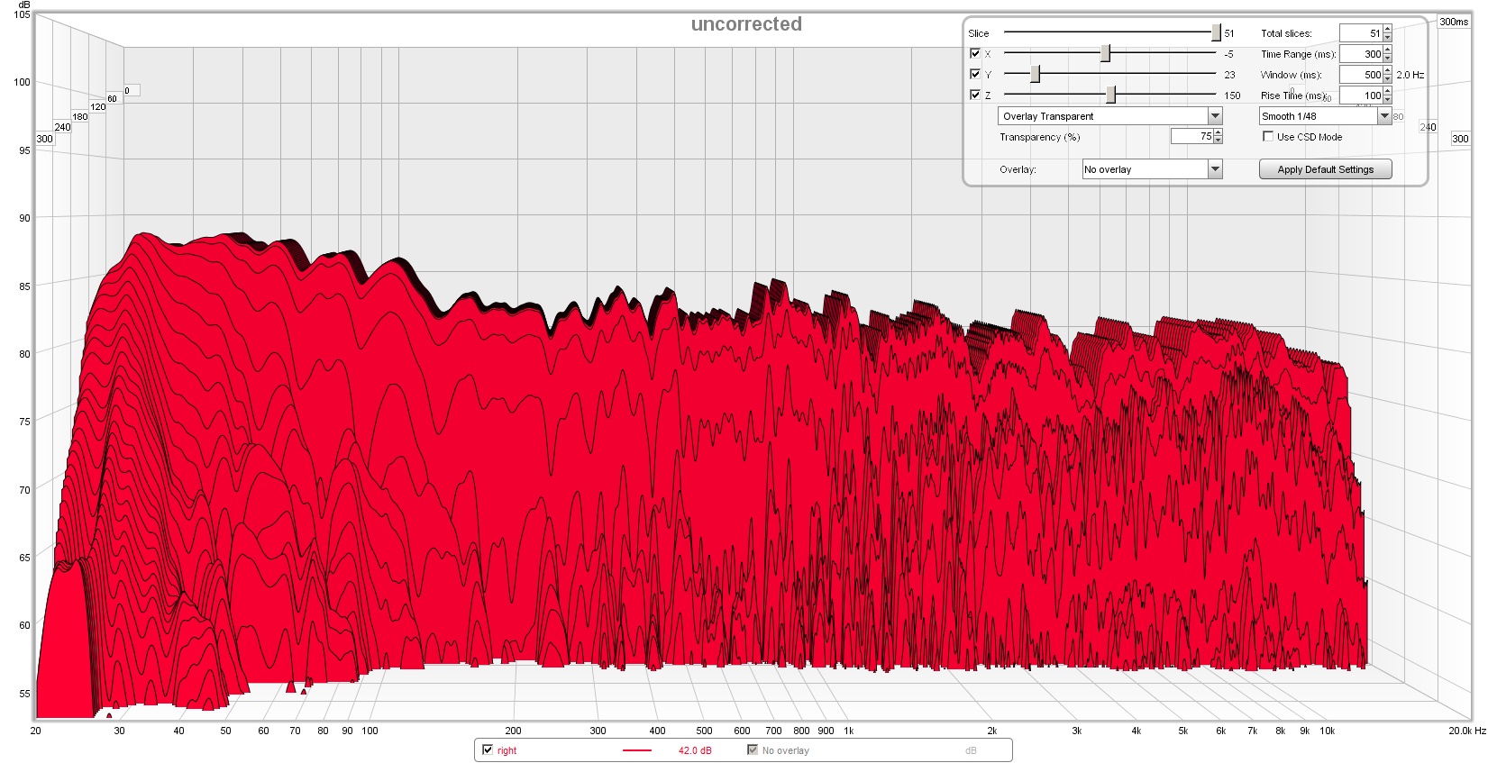

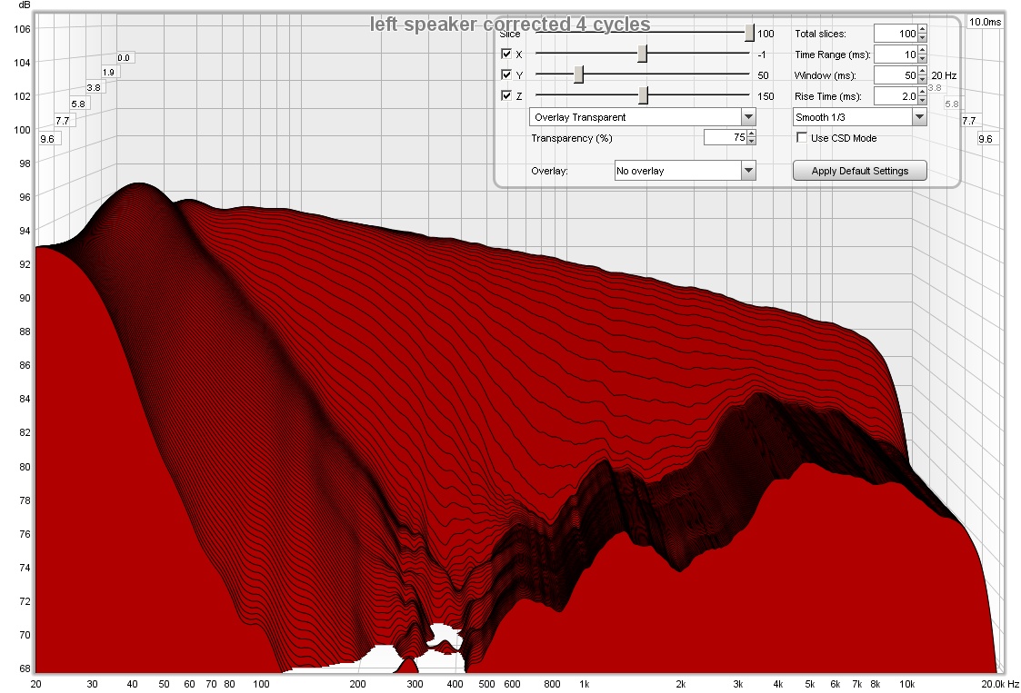

I see very positive things here, Jim does too. Just wondering what does what. We now have an almost anechoic room to play with, a luxury I don't have :D. just kidding on the anechoic part, Jim.
