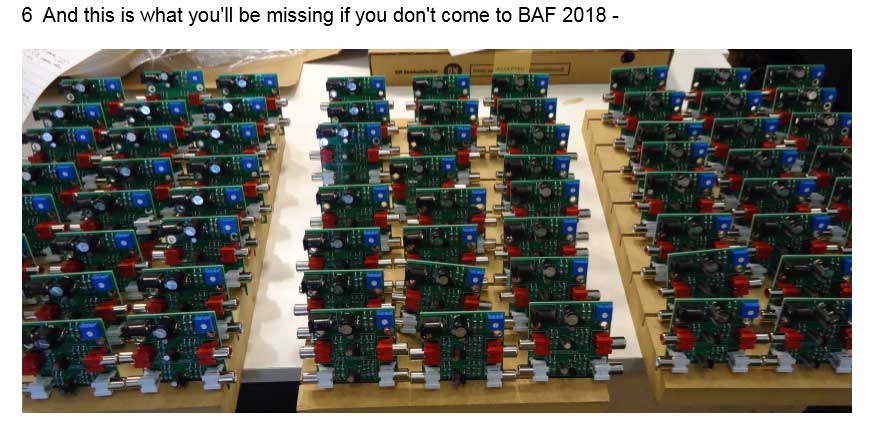

I just want to remind those interested in effects of H2 and blessed to attend the BAF 2018 that in addition to our beloved Papa and Wayne, another wizard versed in the magic of Hollow State electronics by the name of Roger Modjeski is scheduled to come. So prepare your questions and be totally wowed by the "black art". May the coming Triwizard meet unveils lots of Spooky level entertainment for us greedy boyz. 🙂
