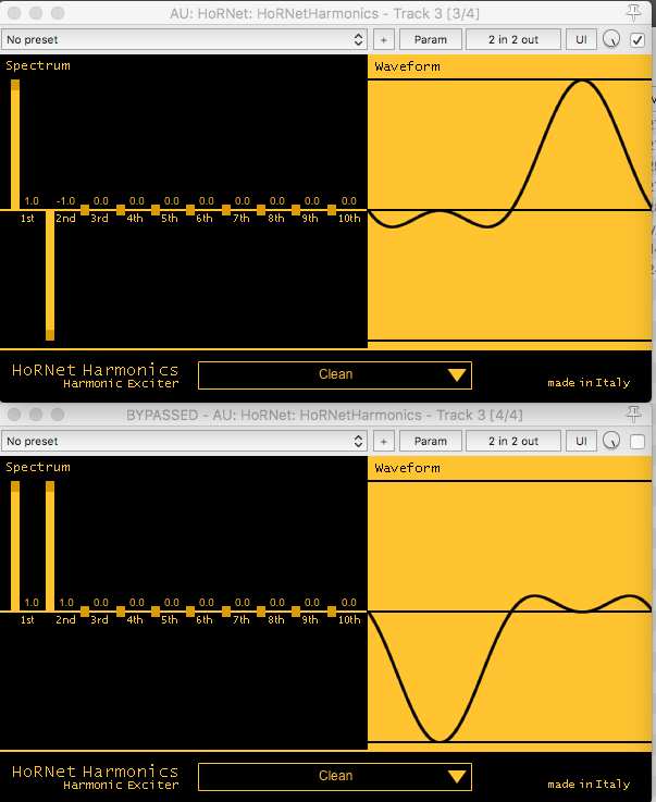

Interesting. I will insert harmonics plugins AFTER crossover EQ. I was inserting harmonics plugins BEFORE crossover EQ when I tested them before.
Testing. I find this is a very useful plugin for listening to the effect of distortion, and it's free.
HoRNet Harmonics, free waveshaper VST, AAX and Audio units plugin
The difference between positive and negative H2, and before/ after crossover is clearly heard, but...
It's hard to "directly" compare before/after crossover because of the input signal level differences. The plugin's distortion behavior is very different before/after crossover. If the test is done with the real multi-amp setup, the result would be the same...
The subjective impression about the sound is, one of the H2 phase is clearly preferable to the other phase, and post crossover insertion (after crossover) sounds better than pre-crossover insertion. The speaker units are precisely time alined, but the possible problem is the amp is Aleph J (H2). I'll do some more test next week with digital amp (no H2) if I have time to do it...

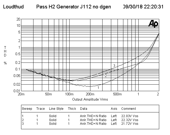

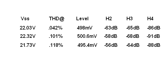

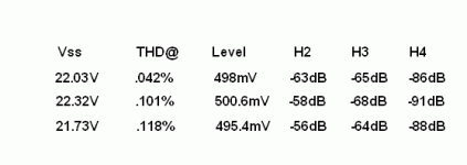

Could you repeat the test with Mr. Pass +/-0.3V range around the 21.96V, being the range 21.66...21.96...22.26V?
The J112 I'm using measured Idss 48mA and Pinchoff Voltage 3.65V. In the circuit it runs around 50 degrees C. Today, the null point is running around 22.03V. Hard to set the power supply with more than 10mV accuracy.
I was wrong in my earlier statement. When Vss is higher than the null point, the phase is negative. When Vss is lower than the null point, phase is positive.

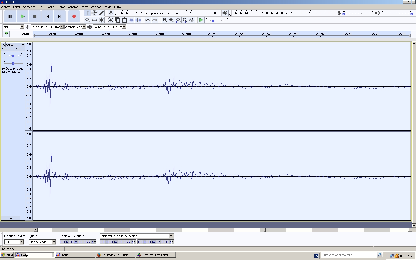

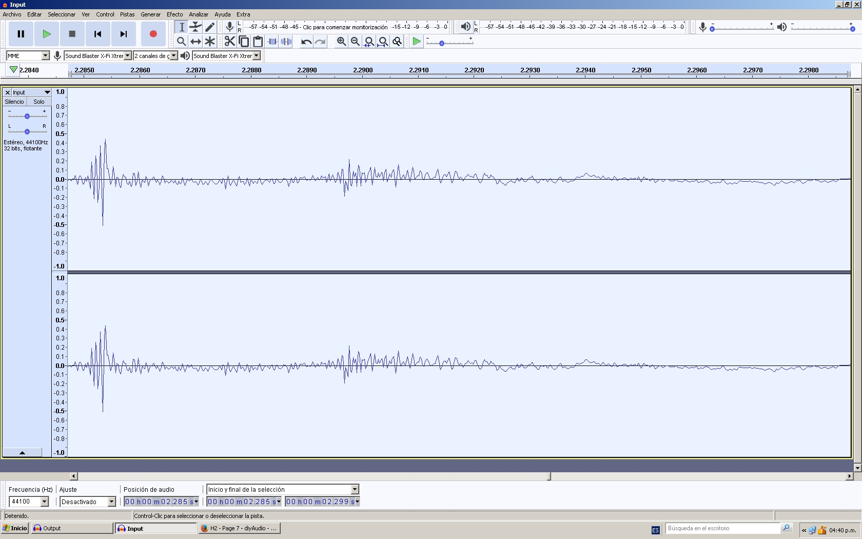

I roughly matched the level of pre and post-crossover H2, and recorded ONLY H2 signal with Logitech Webcam mic which I think is enough to tell the difference. Speaker is precisely time alined 2 way (650Hz Crossover).
1. Pre-Crossover (Linear Phase Crossover)
Theoretically closest to full range.
2. Pre-Crossover (Analog Phase Crossover).
Can you hear slight phase congestion buildup around crossover point?
3. Post-Crossover (Linear Phase Crossover)
Post-Crossover H2 has obvious dip at crossover point because the input level of the H2 generator at that frequency is lower. Also H2 of 500Hz (which is 1K) is less audible due to HF limit of the woofer. So basically, less midrange H2 with post-crossover H2.
3. Post-Crossover II (Linear Phase Crossover, More Woofer H2)
Same as 3, but woofer H2 level is raised. Subjectively, this is the most tubelike sounding option for today's brief test. Good thing about post crossover H2 generator would be we can control the level of H2 of each speaker unit.
I also tried a variety of other Jfets, including the Toshibas, but the
J112's with pinch-off voltages around 2 - 2.5V, gave the best overall
balance of characteristic vs maximum output voltage.

The is a fun toy, but I have a question about one suggestion in the white paper:
It seems to me that reversing the speaker leads only corrects for the phase inversion of the H2
and insures you have the correct absolute phase from source to speakers. But since the 2nd harmonic
distortion added by the H2 is phase relative to the fundamental (which is output along with the added 2nd
harmonic), the audible difference between positive phase H2 and negative phase H2 is unaffected by the
phase of the speakers.
Because the second harmonic goes up and down twice for every cycle
of the fundamental, we see that the phase of second remains the same
when you invert the output. But the fundamental has flipped, and that
makes for a relative inversion. The H2 generator flips phase, so without
subsequent inversion you will see flipped absolute phase and inverted
relative phase of H1/H2
If you really want to compare apples to apples, you would look at
absolute phase inversion before or after, so that absolute phase of the
music is retained, but 2nd harmonic phase is changed.
