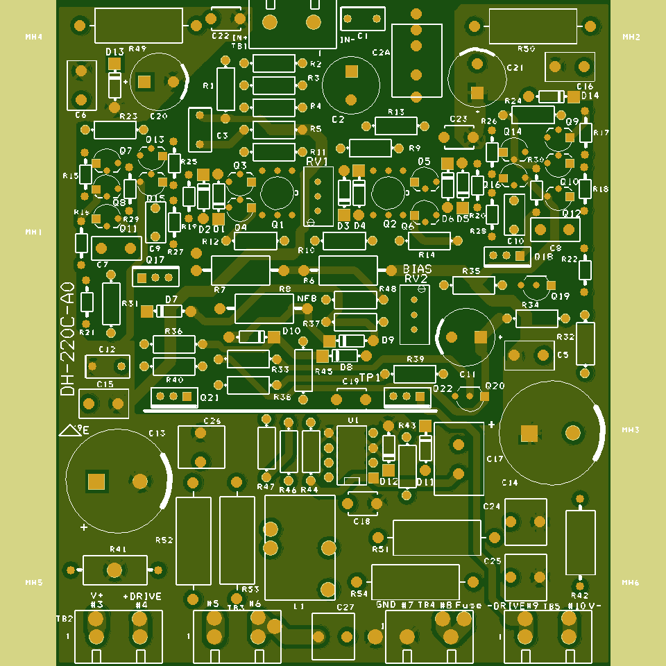

Did you look at the DH-220C schematic I posted, review Bob Cordell's presentation and compare it to the original?
"My honest appraisal would be to avoid these "upgrades" like the plague."
You are saying this about Bob Cordell's DH-220C re-design, without any review or evaluation? If so, sorry, I find your comments to be a very near sighted opinion imo. I can only speak for DH-220C, the others I have not evaluated to form an opinion, so I just avoid comment.
Did you use any of the smt matched input pairs that are available?
You are commenting on a posted schematic design in which you have not even bothered to look at! I suggest to do your homework first before blindly shooting something down.
The only matched parts for DH-220C are the dual jfets themselves with their inherent matching as part of the device process.
Since the DH-220C is all THT, matching other pairs is easier than discrete smd. If I was to do the design in smt, of course I would use the dual DMMT5551 and 5401 parts in the SOT-26 package.
Once/if you take the time to review the DH-220C design, what other parts in the DH-220C design are you suggesting need to be matched for improved performance?
Further to 'Maybe its helpful to add also the external components to the schematics." I have been in contact with Bob Cordell, he has provided me with additional information as to his DH-220C mods, in so much as a new wiring diagram for the mosfets and additions he did in his re-design. I will ask Bob if he will allow me to share this information with everyone in this forum.

DH-220C for Erno Borbely
I think Erno Borbely would be proud that we can implement a version of his treasured complementary jfet design in the DH-220 chassis using modern available parts.
I have on file a DC100 drawing that I assume was done by Erno, looks a lot like a DH-220C to me.
Erno are you out there, can I email you with the DH-220C layout for your review 🙂

In my opinion the design by Bob Cordell is at another level, and has obviously been intelligently implemented. Bob has also shown that he has bread boarded his design and taken measurements showing significant improvements. All included in his talk.
Thanks to rsavas for all his work to get a board designed that might allow us to implement Bob's design for further tests and listening.

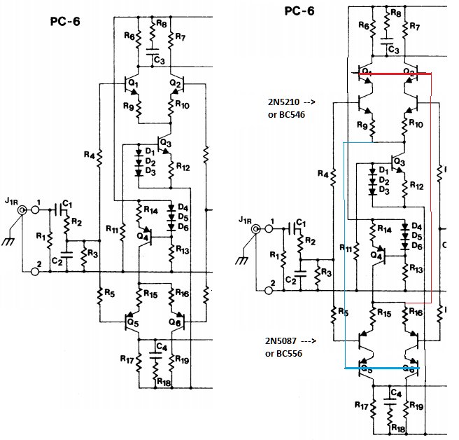

I used to fix and mod the DH200 back in the late 70's. Back then, a number of them were starting to generate significant DC offsets due to C-B leakage in the input stage. I fixed one by wiring in some other complementary small signal transistors I had (Motorola 2N5210, 2N5087 of Tiger amp fame) as new inputs, with the original transistors as cascode tops, like this:
719774d1543876589-hafler-dh-200-220-mods-hafler-dh200-cascode-mod-png
This was done by just pulling the emitter and base leads of the original devices from the board and inserting the new added devices into the holes and twisting and wiring the arrangement with a few jumpers.
This put the C-B voltage of the (new) input transistors at around 100mV or so, so they didn't leak, even if the original high voltage input transistors leaked moderately. The DC offset dropped to nearly zero. When I started modding the amps later, I added an integrator and inverter circuit using TL074 opamps to form DC servos, making the cascode leakage fix probably un-necessary, but I assumed then (with no way to measure or simulate) that distortion would be better with the cascode. I don't have any Hafler amps anymore -- the last one I had developed a mechanical hum/buzz in its power transformer that was driving me nuts so I gave away the amp, so no way to measure anything now.
Maybe some here can comment whether my quickie-cascode arrangement was an improvement or degradation of the original input arrangement?
Bill, you modified my DH-200 back in the horse and buggy days and it was an improvement. I still have it.

I am working off the slide set of the presentation material that is publicly available from Bob Cordell. There is a link a few threads back. It includes the complete design, enough for me to do up the design. Bob made up one channel in proto form, see pics. Bob is including the design in more detail in the new book.
