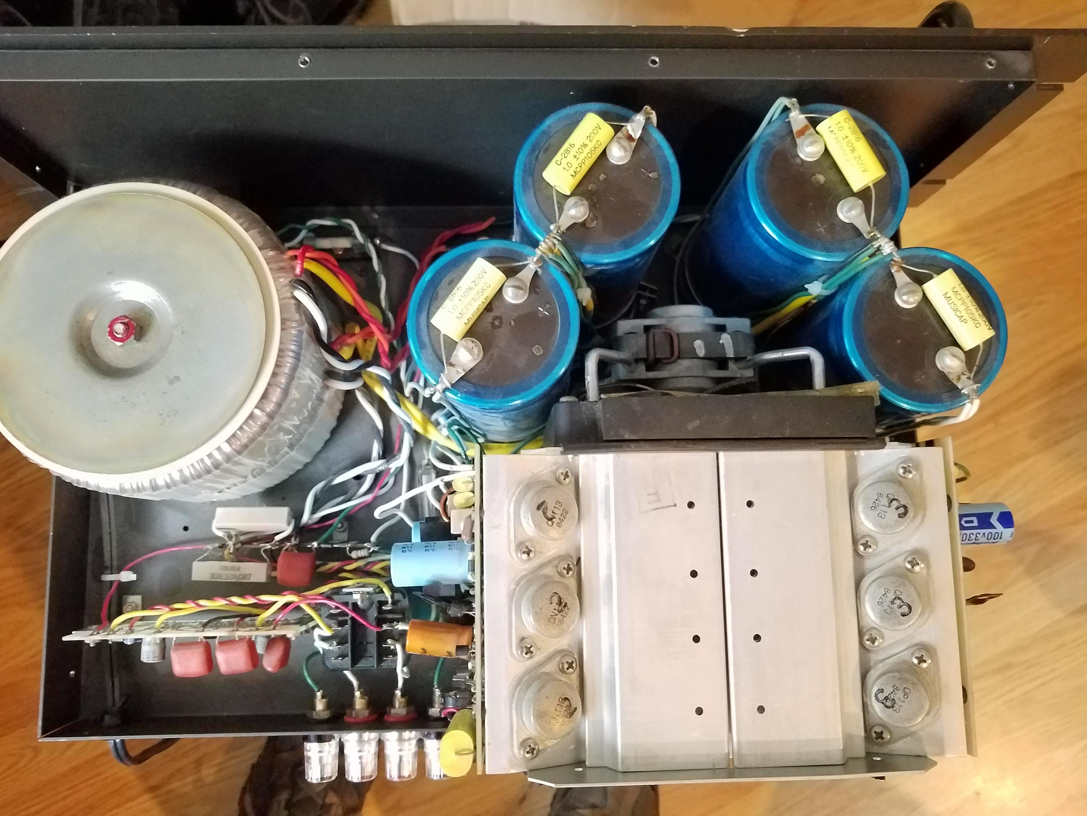

Questions about Hafler DH500 power supply mods
Hi All,
I just purchased an HF500 off Ebay. When I opened it up I saw that the power supply has been modified; instead of the single large transformer there are two large torroids stacked, (Talema 2185 (0500-1-130)). And instead of the stock capacitors there are 4 x "Capacitor Technology" 3800 uF caps.
Anyway I have a few initial questions:
Ron
Hi All,
- Does anybody known if "Capacitor Technology" caps are considered good for this kind of application? What are considered desirable characteristics for a power supply cap, and can those characteristics be measured easily?
- Is "more better" with respect to capacitance in a power supply as long as in-rush current and such are properly handled?
- What is the consensus as to whether bypassing the large caps with the 1 uF caps (as shown below) is a good idea? I seem to have seen some discussion that said it was at best useless to do this, but I'm not sure if it's referring to this exact context.
Ron

DH 500 Amp
Hi:
This looks like a DH 500 modified by Musical Concepts .
I have one like this and Musical Concepts rated this amp at about 350 Watts per channel.
Contact Musical Concepts / Musical Design Home for more info.
If not please let me know and I will dispose of this amp for your safety , just send it to me for disposal.
Hope this helps
Ed
