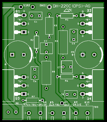

DH-220C update
As part of our DH-220C testing Bob Cordell suggested that it would be nice to have a pcb installed between the HS ears for the OPS, so that it is a clean way to add some components that were otherwise flying.
With Bob's help, I have designed this small pcb and we are in the process of ordering some to test.
One addition is a means to measure OPS bias current. Also added are the gate series R's, a source zobel network, extra filtering.
Since I do not own a DH-220, I made the pcb so that one can use these designs without one. I made a footprint for plastic fets so that this design can be used without the DH-220 chassis.
This OPS pcb is not necessarily only for DH-220C, it could be used in the stock unit as well or another chassis arrangement, such as the DIYAudio chassis. mechanical details need to be figured out, but trying to make these designs as universal as possible.

But I still don't understand why a single LED would perform better as a voltage reference than a string of 3 standard diodes.
All pn junctions have roughly the same temperature coefficient, its set by the physics, and stringing them in series will multiply the temperature coefficient by the number of pn junctions.
Thus having a single pn-junction from a material with a 3V bandgap will fare better than 3 pn junctions from a meterial with a 1.1V bandgap - the voltage will be less sensitive to change as the enclosure / pcb warms up.
To give a little bit more detail, the forward voltage of a pn-junction will typically be roughly around 0.4V below the bandgap voltage at typical small signal current densities (where the resistance of the material can be ignored). This voltage difference depends linearly on absolute temperature (for constant current).
This comes straight from the statistical mechanics of a voltage barrier, the bandgap being the barrier voltage V0, and the probability of a random charge carrier jumping the barrier being proportional to exp (- q(V0 - V) / kT),
where q = charge on electron, k = Boltzman's constant, T = absolute temperature and V = voltage of the charge carriers approaching the barrier.
Note that silicon has a bandgap of about 1.15V, and forward voltages tend to be 0.6 to 0.75V, GaN based blue LEDs have a bandgap of 3.4V, and a typical forward voltage around 3 to 3.2V (although such LEDs have a more complex structure with quantum wells, but the basic physics still applies).

Yes it would be much easier than PTP with those added components. But if one wanted to use the existing TO-3 FETs, would they be wired into the PCB? I assume the extra length on the leads would not be a problem.This OPS pcb is not necessarily only for DH-220C, it could be used in the stock unit as well or another chassis arrangement, such as the DIYAudio chassis. mechanical details need to be figured out, but trying to make these designs as universal as possible.
That is the idea that we will try out.But if one wanted to use the existing TO-3 FETs, would they be wired into the PCB?
