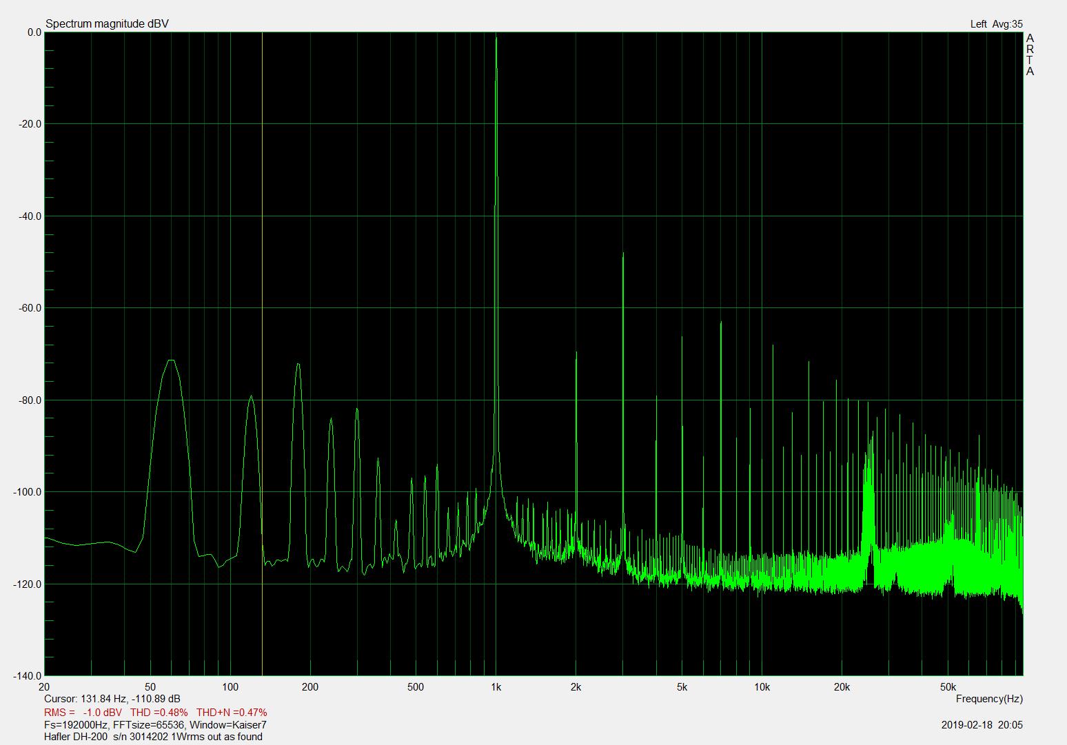

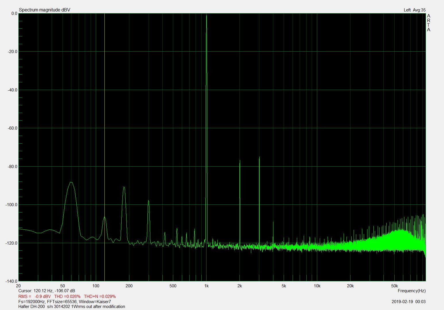

This Hafler design pretty much depends on matched diff pairs in order to maintain low distortion and low DC offset. Other designs may use an offset trim control, but you shouldn't need to do that.
I have attached a before and after measurement on a Hafler DH-200 I repaired some time ago. The right channel measures about the same as the left channel. On this one I just moved the input transistors around to make better matches instead of using a tightly matched pair.

Hi Rick,
Well, Bob and I sharply disagree on this then with regard to matching input devices. I have proved this to be effective continuously over 30 + years. So it doesn't bother me at all that anyone might disagree with me as I have years of accumulated proof. I have measured significant drops in distortion simply by installing a close matched pair into an amplifier or gain stage.

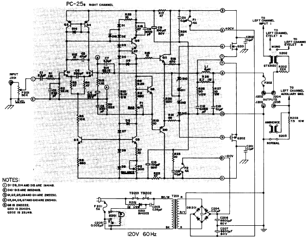

The spectra of the DH-200 posted above by Chris reminded me that there is an important design-dependent caveat to what I said in my overly-long post above. The Hafler design uses a fully complementary BJT input stage (NPN LTP + PNP LTP). In such a design input pair matching is important, since otherwise the two pairs may "want" different input offset voltages in the quiescent state. This means that they may fight each other for determination of the quiescent condition, often resulting in neither of them functioning at their best.
Further exacerbating the issue in the Hafler is that the IPS is not loaded with current mirrors, but just loaded single-endedly with a resistor. This adds another variable to achieving current balance between the pairs.
Finally, the input pairs do not seem to be strongly degenerated, so matching issues are not as strongly mitigated. By quick glance, it appears that LTP degeneration is only about 3:1.
So the bottom line here is that the Hafler and similar designs will be more sensitive to input pair matching, and their input pairs should be matched. However, the single-ended load resistors on the LTP should be carefully chosen to make the currents the same in the two transistors in each LTP, else the matching may be rendered for naught.

They may not mention this, but looking at the circuit diagram tells you what you need to know. It is entirely possible that the person that designed the amplifier may not be aware of this for starters. I know of one person that used to work there, and specializes in this product line as rebuilds who hasn't got a clue.
You (not you, but everyone) need a broad range of experience in order to properly repair or modify equipment simply because these omissions are common in this industry. The repairer / modifier has to bring all the knowledge to the table when working on any product in case no mention is made of important factors. Just because someone designs a product and it is somewhat successful in the marketplace doesn't mean they are competent.

In this thread below, I could not answer the question about adjusting the BALANCE pot P2 for lowest thd.
Repairing Hafler DH-120 Balance Adjustment
Can you explain how adjusting P2 minimizes thd?
Cheers
Rick
It looks like P2 adjusts the VAS bias current to an optimum value for low distortion. Not clear why this is without deeper analysis or even simulation. However, I would speculate there would be less need for the pot if a 2T VAS was used and if the IPS current mirror was degenerated. I have a Hafler SE-120 that I got on eBay, but have never tested it or looked inside.

I think P2 and P1 both can change the bias current of output's mosfets.
First, we may adjust the VAS current by P2. After this, output bias by P1.
So, the different pictures about distortion shown above may be just BIAS .
Hi all,
I believe you are correct about the effects of P1 and P2. P1 directly affects the output stage bias current in the usual way with the Vbe multiplier. P2 indirectly affects output stage bias by varying the VAS bias current, which has a minor effect on the voltage drop established by the Vbe multiplier bias spreader.
