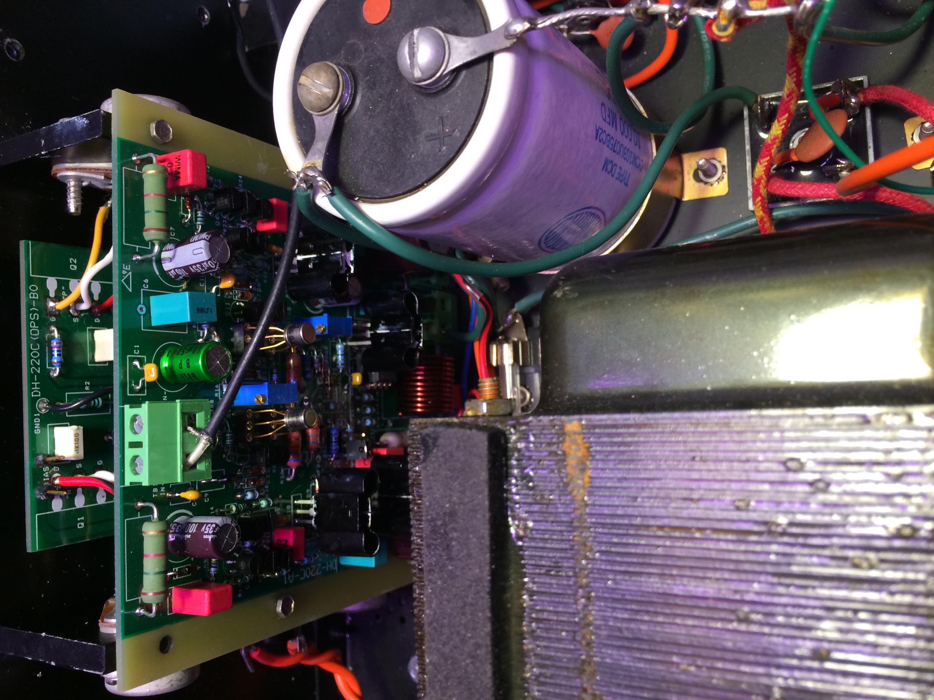

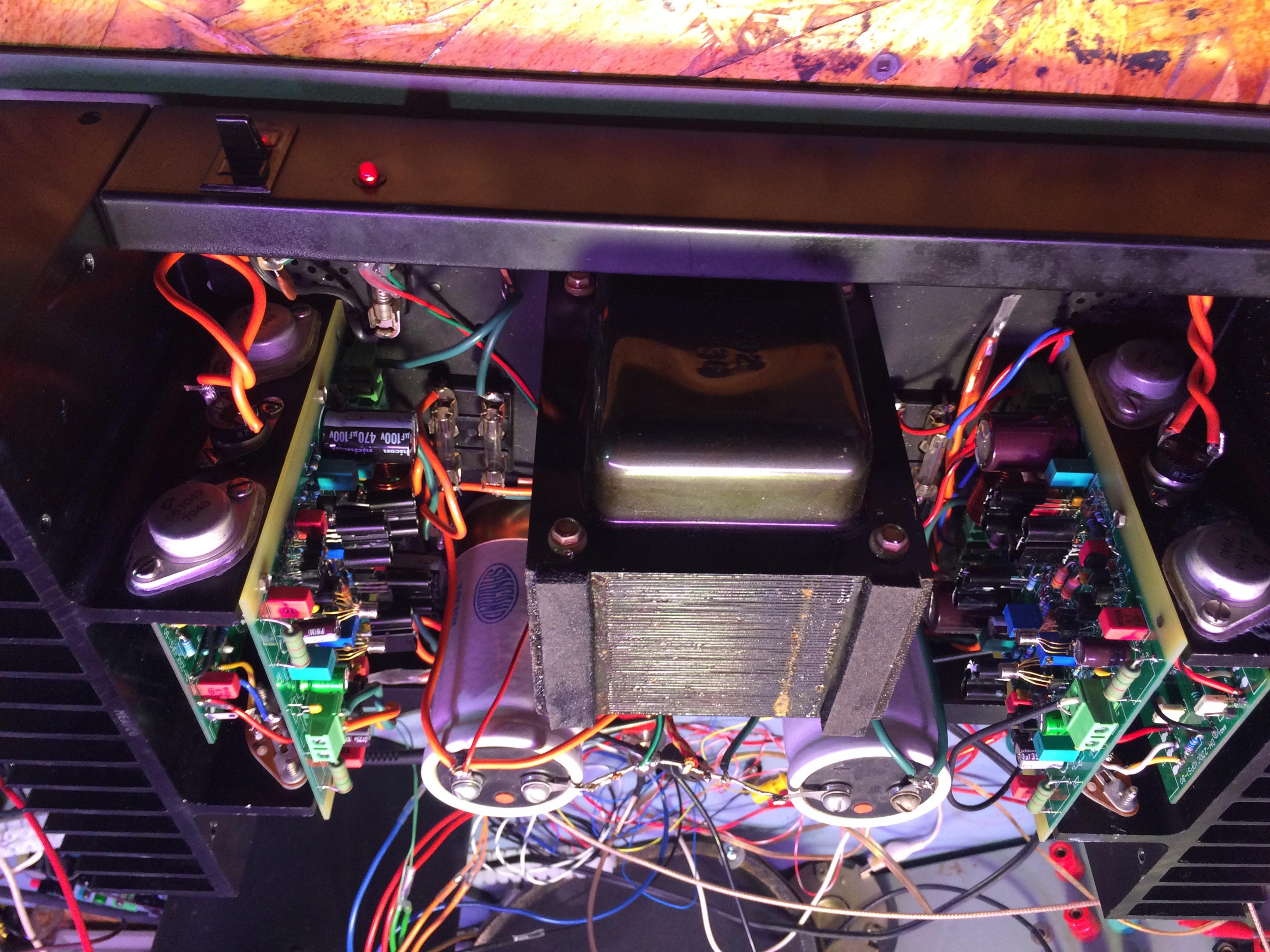

Once I secured a couple of DH-200 chassis to work with, I was able to get a better idea of the mechanics/assembly involved, actually be able to do one myself, find ways to make it as easy as possible to implement and document the build process.
Still need to verify the design with a +/-90V supply, for a DH-500 implementation, but the design seems to be working well in the DH-200/220 chassis.
A couple of pics of my prototypes in a DH-200 chassis.
Notice that we designed an addition OPS pcb in order to make that wiring easier and an upgrade to the output stage design to match Bob's prototype.
There will be a special OPS pcb needed for the DH-500 as well, it is in the works.
Enjoy
Rick

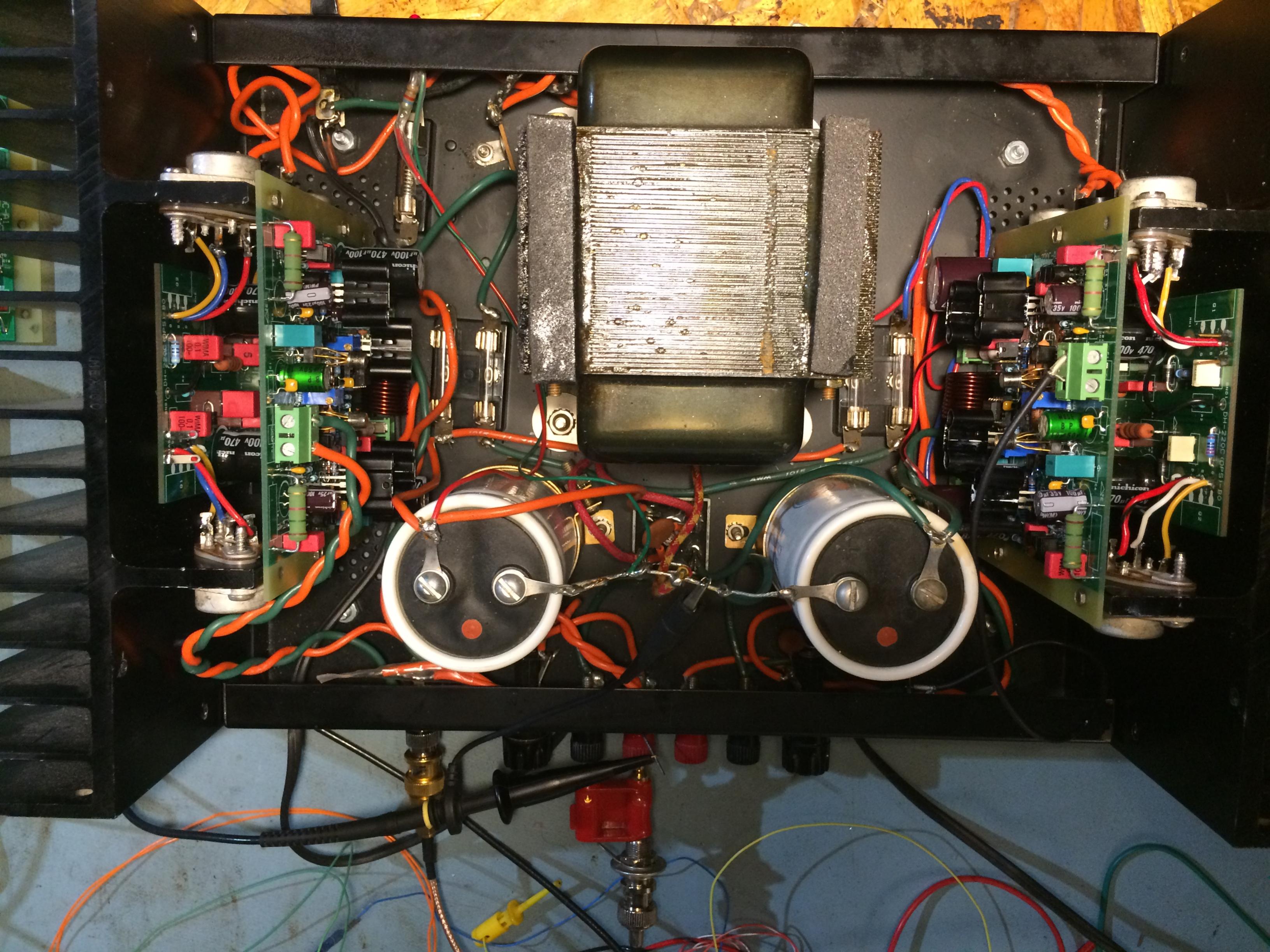

Enjoy
Rick

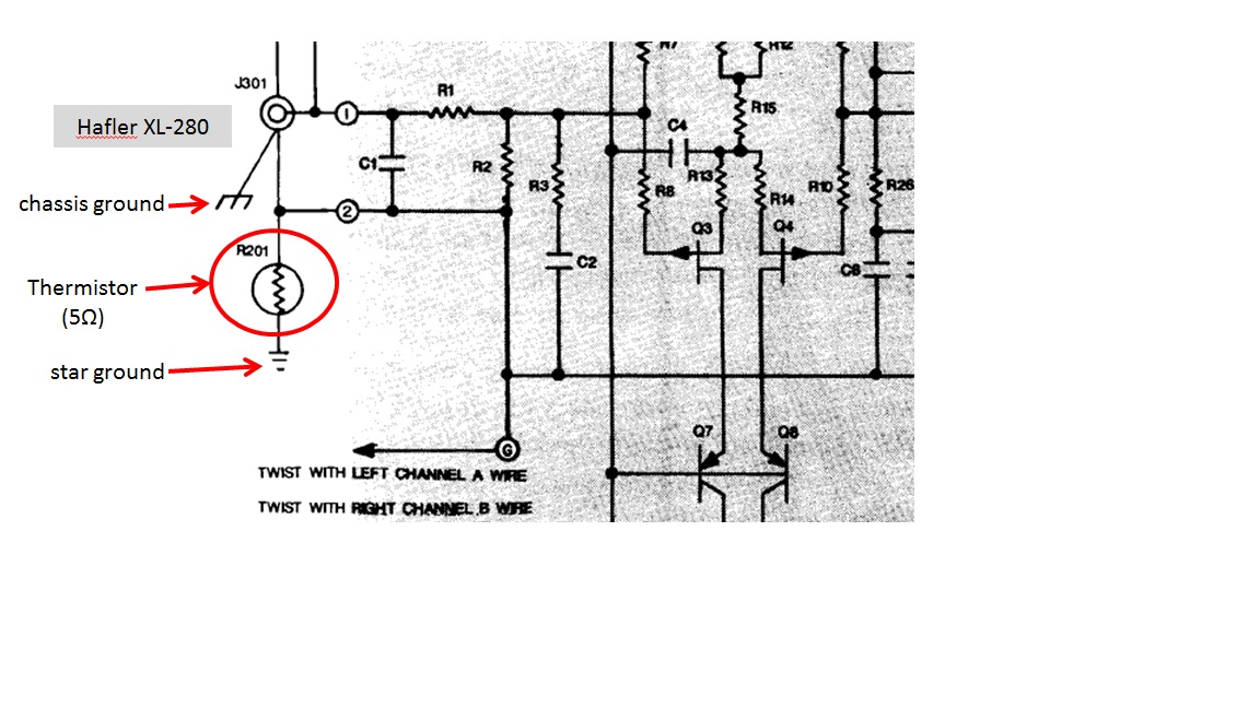

Question about XL-280
Since it's a little slow here lately I'm going to ask a quick quesiton about the XL-280: Can someone explain the function of a thermister between chassis and star ground? Shouldn't the signal ground have unhindered conduction to star ground?
In this case there is no earth ground connected to chassis--so what is the function of chassis ground?
I though it was desirable to have control over the path of the ground signal--it seems like connection to chassis defeats this purpose.
I understand chassis to earth for safety, but with no earth ground it doesn't make sense to me here.
Ron

I guess I wasn't thinking when I asked that 2nd question--of course the signal ground is connected directly to the ground plain on the board. But I still don't understand the use of chassis ground and the thermistor.

It breaks the ground in a safe manner, it is a high resistance and inhibits ground loop currents when there is little current but allows fault currents, which are high (and therefore heat up the thermistor and reduce the resistance) to safely conduct to ground.
Enjoy
Rick
Rick, What will be the constraints on the distance between the IPS/VAS board and the OPS board? I ask because I'm considering the feasibility of adapting these boards to a 5-channel amp chassis, but using only 3 boards so as to improve heat dissipation per board. But some flexibility in placing the boards would likely be required.
Ron
OK, thanks for the reply. So it is identical in function to a parallel diode/resistor/diode arrangement, but it seems in both cases makes much more sense if chassis is connected to earth ground, (which it isn't in the XL-280).
In the best builds, no signal returns (signal grounds) or power supply grounds are on the chassis. The chassis acts only as a safety ground for AC and DC currents to earth via the AC connector. Hence, when the AC comes into the chassis, the ground wire should be immediately bonded to the chassis, and tthe central ground for PS and signal (star ground) is connected via the ground loop breaker to that chassis ground. Thus, all single inputs and output jacks and some potentiometers whose cases are grounded, must be isolated via insulating washers from the chassis.
Grounding is truly difficult.
I do not know. Something that would need to be tested. What distances are you anticipating?What will be the constraints on the distance between the IPS/VAS board and the OPS board?

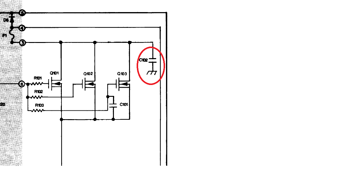

This then answers my next question: shouldn't the decoupling caps on the OPS of these Hafler amps be grounded to the ground plain instead of to chassis? Or is it OK to do it this way for some reason?In the best builds, no signal returns (signal grounds) or power supply grounds are on the chassis. The chassis acts only as a safety ground for AC and DC currents to earth via the AC connector. Hence, when the AC comes into the chassis, the ground wire should be immediately bonded to the chassis, and tthe central ground for PS and signal (star ground) is connected via the ground loop breaker to that chassis ground. Thus, all single inputs and output jacks and some potentiometers whose cases are grounded, must be isolated via insulating washers from the chassis.

Not sure as of yet--I guess I mean something like 5" separation instead of the 1" you show in your photos.I do not know. Something that would need to be tested. What distances are you anticipating?
You have to stick to a selected grounding scheme. The Hafler as designed and constructed used the chassis as part of the grounding scheme. It thus mixed signal and chassis ground. Thus, unless you are going to completely rewire the amp, you have to keep the decoupling caps grounded to chassis.
What this means is that the typical position for the ground loop breaker is not going to work. You have to put it between the ground wire where it comes out of the AC wire, and the chassis ground. That may violate some legal requirements and may not be safe because if the ground loop goes open on a fault, then there is no safety ground AT ALL.
I guess the bottom line is, unless you are going through the trouble of rewiring the entire amp and carefully segregating signal and PS grounds from safety/chassis grounds, the ground loop breaker may not be a good thing to use. Instead, if you need to break a verified ground loop, use a high quality line input transformer like those from Jensen or Cinemag.
IMO, of course.
