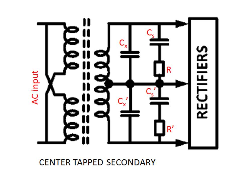

I have been doing some snubber optimization measurements on some Hafler amps using the Mark Johnson Quasimodo board. I thought the results would be relevant to this thread. I post them below, and to learn more please see the following thread:
Simple, no-math transformer snubber using Quasimodo test-jig
The measurements below were taken in order to optimize the value of R in a snubber circuit placed on the secondaries of the transformer in these amps as shown below.
Although it is not certain that the transformers for all the same type of amplifier are similar enough for these values apply to every amplifier, the fact that I obtained very similar results across 3 different DH-200's I measured leads me to believe that these values likely good for most of the amps out there. But if anyone has measured different values than this it would be good to know.
Ron

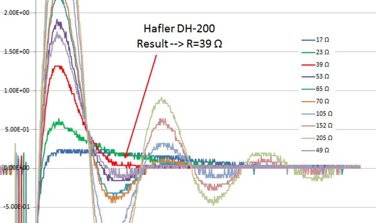

- Hafler P-230: Single secondary with CT yielding DC rails +/-65 VDC
Cx = 0.01 uF
Cs = 0.15 uF
Rs = 29 Ω
(Both sides measured the same R, see below)

- Hafler DH-200: Single secondary with CT yielding DC rails +/-60 VDC (I measured 3 different Hafler DH-200 amps, they all yielded similar results)
Cx = 0.01 uF
Cs = 0.15 uF
Rs = 35 Ω
Note1: I consistently obtained a slightly different result for R when I measured the 2nd secondary (against CT) vs. the 1st secondary. The results for each were 40 Ω vs. 28 Ω. So I think 35 Ω is an OK value for either side.

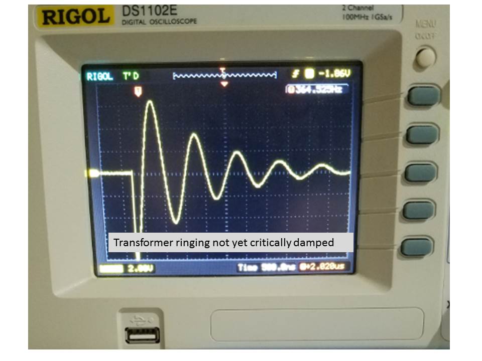

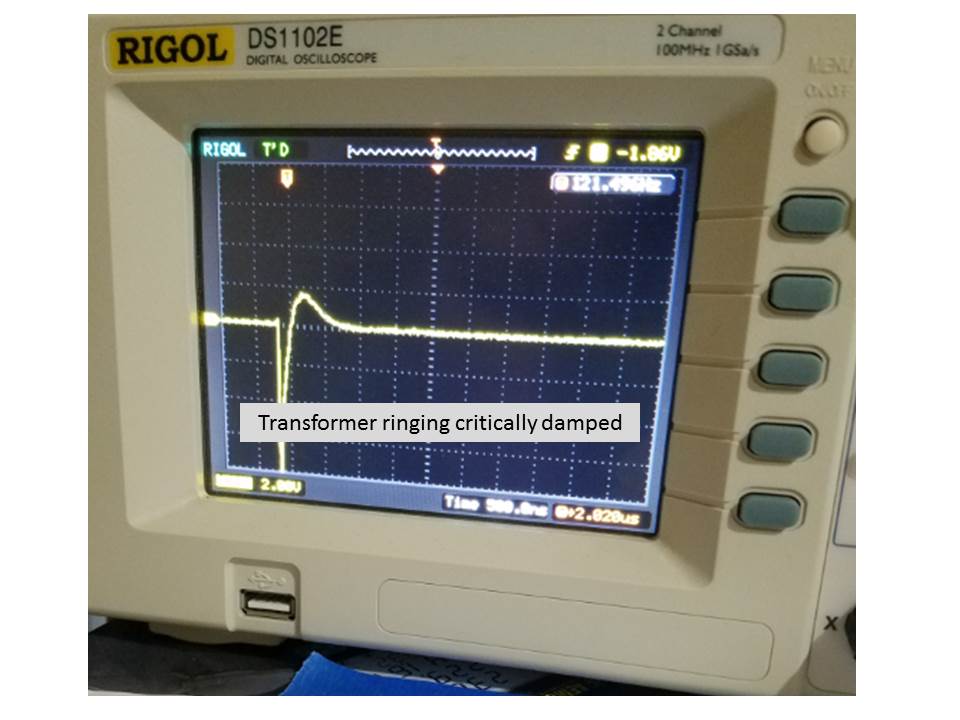

The optimization procedure is the brain child of Mark Johnson. In his own words,What measurement criteria did you use for find the optimized values?
Instead of measuring the transformer and then calculating the snubber, why not simply connect an adjustable snubber across the secondary, stimulate the resonant circuit to make it ring , and then adjust the snubber until you find a setting where all ringing is perfectly damped?
The adjustment is accomplished using a 20-turn pot instead of a fixed R. The ringing is accomplished using a jig (circuit) designed by Mark which when connected to the transformer secondaries and powered produces ringing which can be observed on an oscilloscope. The pot is turned until the ringing is critically damped, revealing the optimum R for the snubber circuit.
Per the procedure defined in Mark Johnson's white paper (available in the thread referenced in my previous post) the transformer is isolated from the circuit during the testing, the primaries are shorted and the secondary not under test is grounded to CT. The value of Cx is chosen so as to be much larger than the transformer secondary capacitance as well as the rectifier capacitance, rendering their contribution to the "answer" negligible. Or again quoting Mark Johnson,Were these evaluations done on units with original stock used electrolytics and rectifiers? Results may vary a little bit with re-capped units and new rectifiers, especially if the new rectifiers are of a higher-speed variety.

CRC snubber capacitor Cx is connected in parallel with the tranformer's secondary capacitance CT. (Cx is also in parallel with the capacitance of the rectifier(s)). Therefore the total capacitance of the resonant circuit is the parallel combination (CT + Cx + CRECTIFIER ), and it is this total capacitance which determines the oscillatory behavior...the CRC topology gives the freedom to choose Cx >> CRECTIFIER, thereby making the capacitance of the rectifier a negligible fraction of the total. ...If Cx >> CRECTIFIER , it simply doesn't matter what the actual value of CRECTIFIER happens to be.
I think this answers your concern.
I've attached some data from my own testing. Mark Johnson's white paper also has some excellent examples.
Ron
