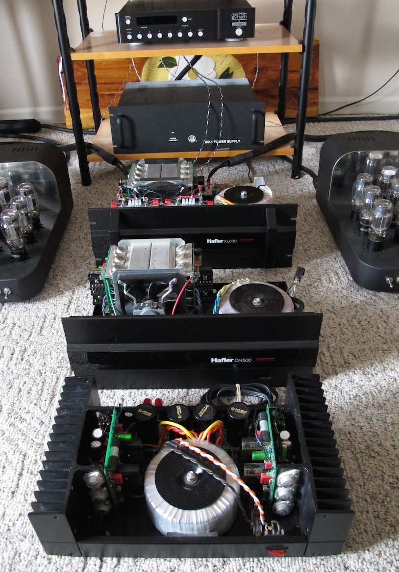

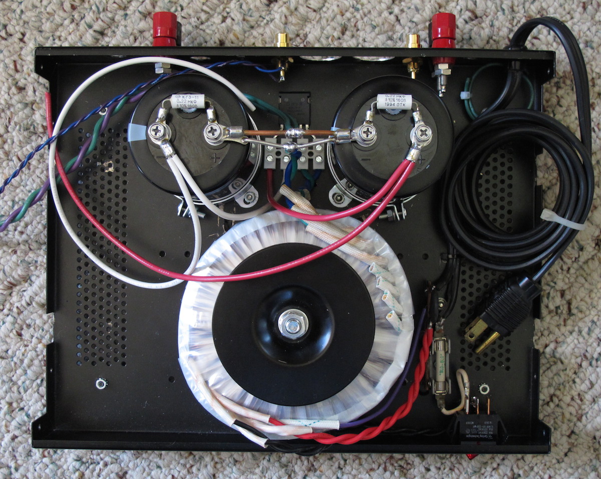

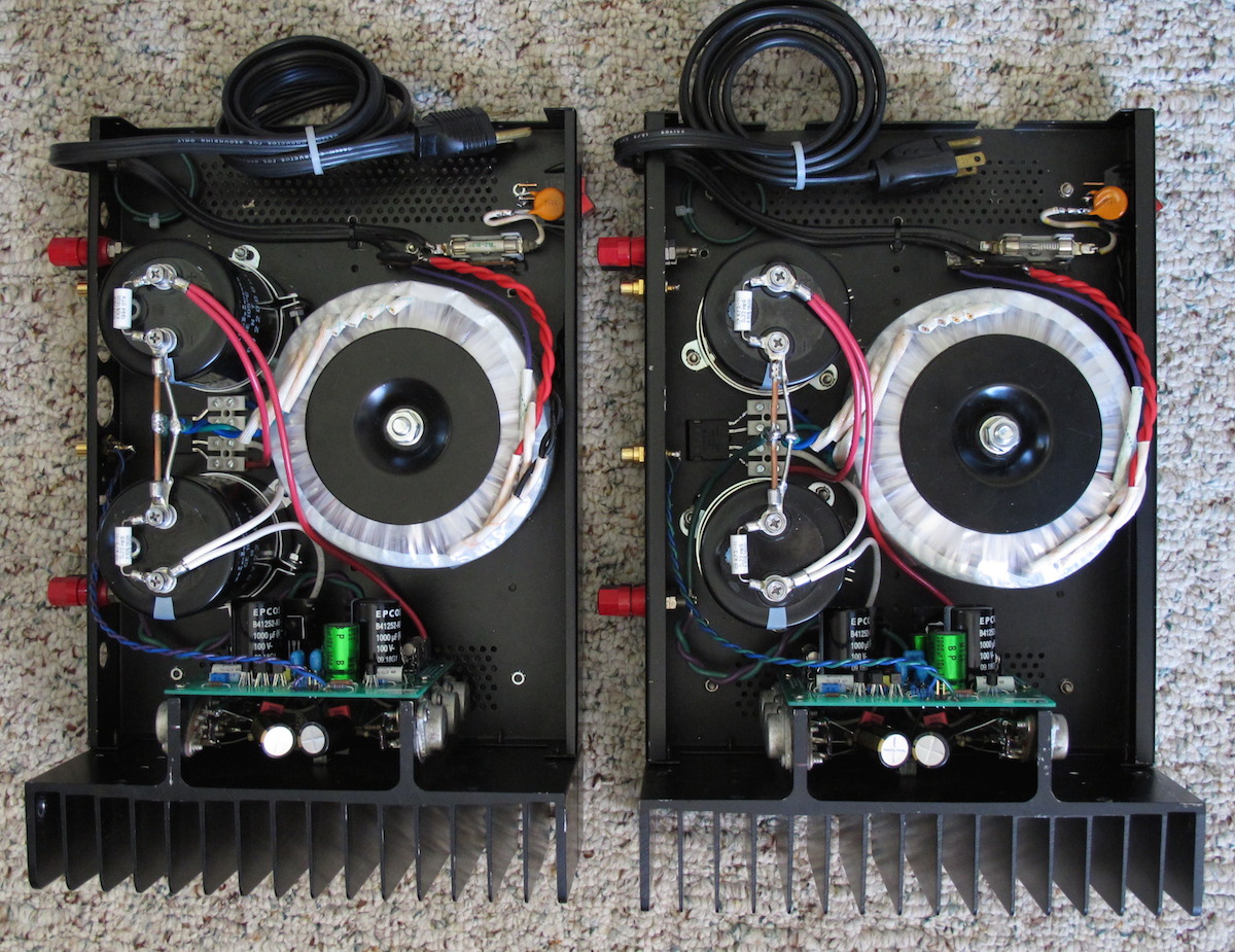

Mono P230... too many ideas and options.
I bought and 'updated' my first XL600 with Musical Concepts new PA7 boards, also built it *true* dual mono. It sounds so fabulous, unparalleled driving my Maggies, which started an amplifier building and rebuilding frenzy... I started swapping boards and parts around, updated my "once DH" MC500 with a 2nd set of PA7 driver boards, making appreciable sonic gains at every turn. I cannibalized the Jensen 4-pole capped P230, in the front (image 1) it 'no longer exists' as shown is now one of the dual mono amps. It turned out that the 6 output versions greatly overshadowed any of the 200 / 220 versions I had built prior... with the speaker assortment that I have on hand... will admit to getting a little carried away... those here may truly understand this...
A virtue in owning a dozen assorted "Hafler amps", I can model so many concepts... compare them directly to one another. I have had ideas to build mono versions for some time (over 30 years) first had to pick a power supply, driver circuit and chassis which warranted such a build. The safest bet was to build two identical stereo amps (better, more preferred for resale prospects) than odd-ball mono Franken-amps... The initial idea was to use a stereo amp, simply pull the fuses from one channel and devote the entire supply to running only one channel... x2.
[long term] Ideally I would like to build separate pi filtered power supplies, rather than cramming what I really wanted into one (or 2) already compact chassis's. This build would (does) ultimately support proof of concept... whether, such madness was warranted... 4 chassis for stereo amps... those amazing vintage lateral Hitachi MOSFETS were driving me (mad) to the extremes and filling up my floor and listening rooms...

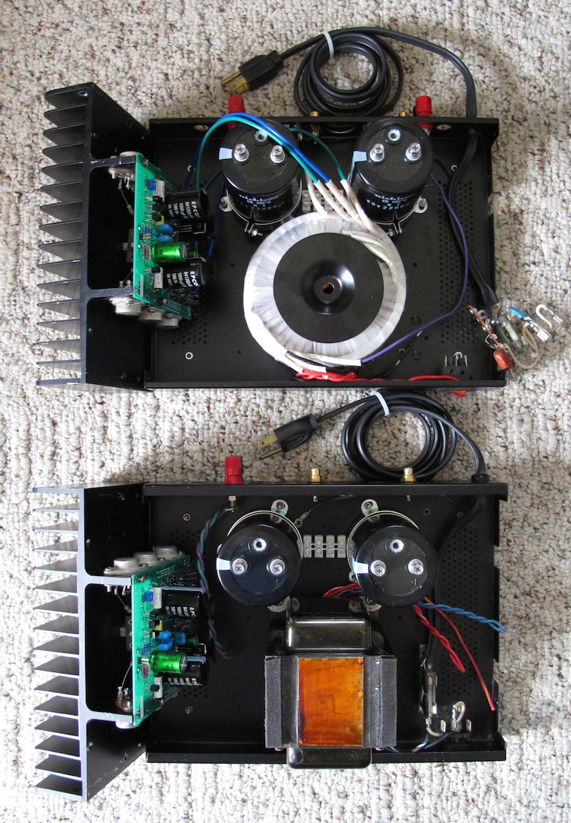

The second challenge was what 2 chassis's to cannibalize for such a project... I never really liked the asymmetrical layout of the P230 (or the XL-280, only had one of them) Positively ~ hated ~ the stock P230, it was a rats nest, which I bought to gut, needing to be cleaned out... So the (2) P230s became the sacrificial candidates. I went through many ideas and layouts, even drilling and mounting parts only to change my mind, so as not to duplicate other builds... I really wanted to try something different, wanted to experiment. I re-positioned the second pair of 5 way binding posts, while drilling and mounting toroid and P/S caps, with the chassis pan empty, in the event I will ever complete these as stereo versions. The 'OCD' perfectionist in me was satisfied. It took me a solid month to make up my mind...
Most of my listening and comparisons were the with Atma-Sphere OTL amp(s) and DH500 (based amps) with an honorable mention to the XL600, ...with that noisy fan... Very stiff competition for said concept amplifiers, in the idea, design and build phase... At a point, I had chassis's and parts laid out in a checkerboard (literally) on the floor to try and reason, the great many options. My biggest single obstacle (not joking) was cutting / shortening the power transformer wires... it was a commitment to this chassis and layout, with no going back. One other *key objective* was to position all AC on the opposite side of the chassis to the amplifier circuitry... I really like this layout and the way it turned.

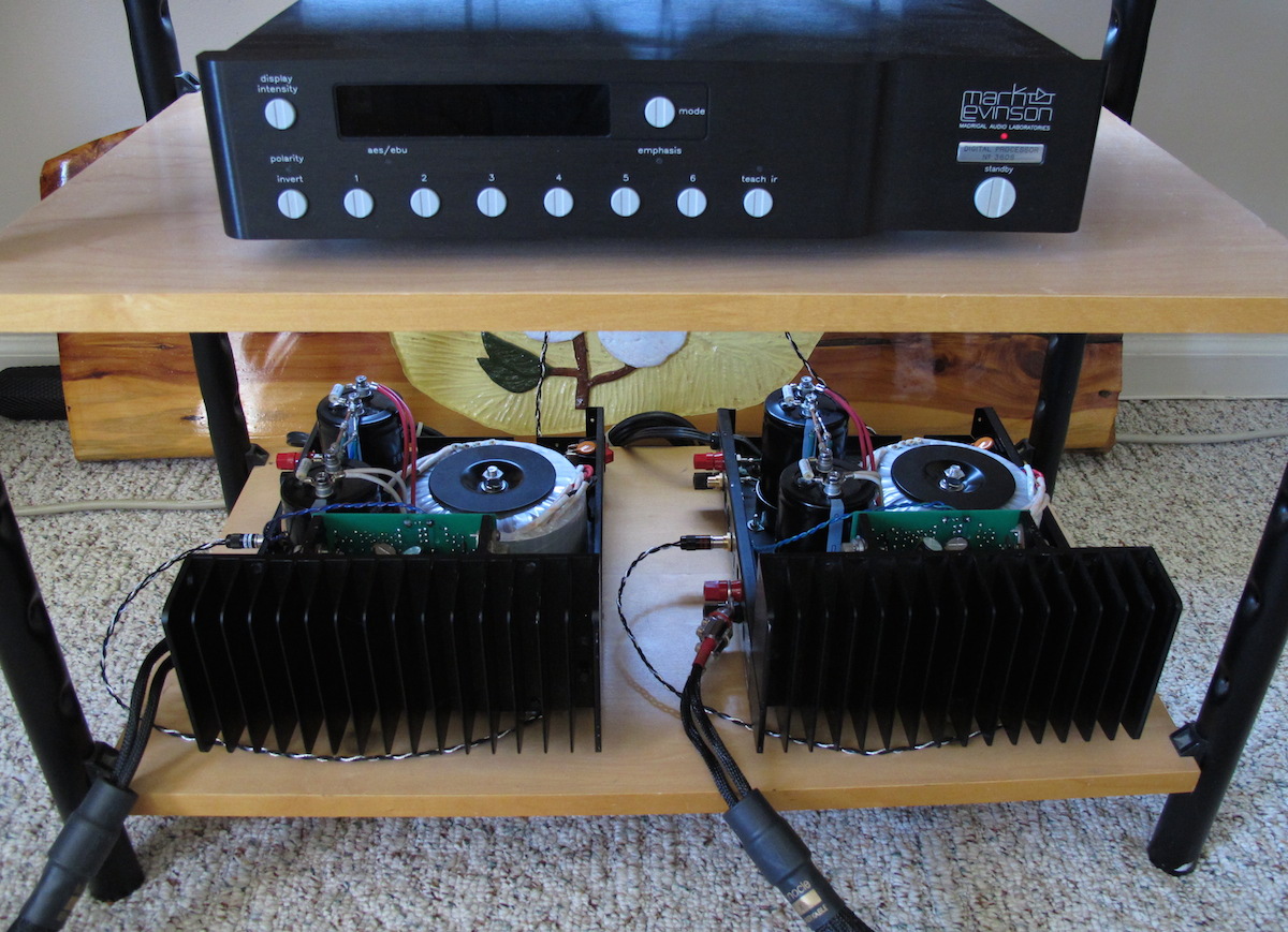

Twin mono P230 amps are now gracing my sound system... I always start with the amplifier core (image 2) get that set, as it really [is the amp] and work my way outward to driver and output stage. It was not a matter of lower cost, or a build budget, it was about how close I could get to the dual mono, Jensen capped MC500 and the venerable Atma-Sphere MA1 amps...
Honestly, I have about 1,700-1,800.00 into these mono amps, they sound fantastic and are not even broken in yet! A 30+ year 'dream' manifests... and I will be selling some 'other' gear... cannot imagine selling these mono Franken-amps. The only thing, that I want to change or add, is Cardas Rhodium RCA and 5 way copper binding post (add another ~ 200.00)
A long post [sorry] It was a lot of work, long journey and story, the past 3-4 months, much of it 'in lock down' with the current global madness...

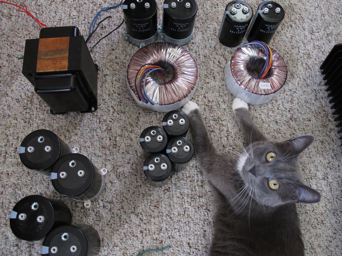

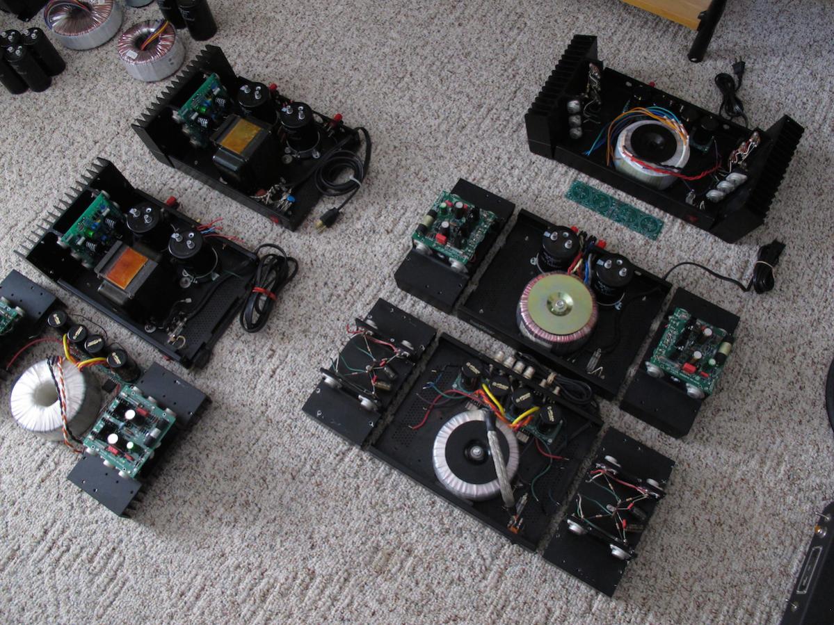

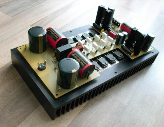

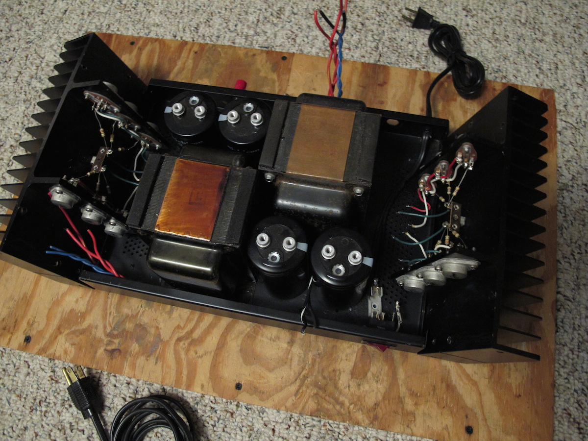

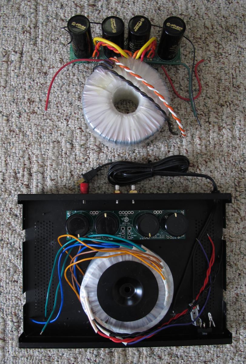

Random pictures, as a build up to amps...
I really struggled to make up my mind. I did layout several ideas "in a checkerboard", on the floor, not all parts and amps are shown, I could not fit them into the frame. (Image 2) I was kind of modeling, external Pi filter notions, with the staggered caps. Kitty Roe Roe really likes the toroids, being the lady of the house; she has a say in things...
I have so many parts, stock pulls old and new, I will admit to supply chain concerns and that I have stock piled / hoarded many parts. I feel a confidence in having (on hand) some things which are hard to get... I think the cat at a point was even perplexed by the amassing of parts and clutter, as I was thinking near term and long term. I did not want to duplicate past efforts and honestly, I am building several amps for a few friends... swapping things around, while turning over a few of my PA4 boards and a few other parts. My head hurt on some night during this process...
At a point I considered, using 2 of the 3 stock power transformers with dual (higher voltage) secondaries, pulled from both the P230 and XL280, and building *separate front end supplies, but ruled that out... I wanted a clean chassis and aesthetic. More likely in 2 chassis model...
I ended up building with the 'new' Musical Concepts TP-202 that has the outer shield band and a static ground band, which conceptually fascinated me... I am glad I did, in spite of having already having bolted 2 stock power transformers in place. The TP-202s are that ~ amazing ~ I think a great portion the fundamental refinement in the amps I built and am enjoying so much, right out of the chute. The next month (break in) will be amazing... with all the new parts breaking in.
The last image (staged) not actually planned concept of an unrealistically stuffed chassis with 2 stock transformers and 4 caps (in a 69 position) was an homage to the mighty Mark Levinson ML3 that torqued my imagination so many years ago... it actually singularly started a lifetime of amplifier study and my building obsession... leading to this intense hobby and ways of spending time [and money] in retirement.

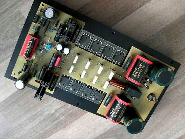

#Felixx from Felixx....
Here's something in between but maybe there is someone curious about Exicon?
Nobody use it on Hafler mods?
