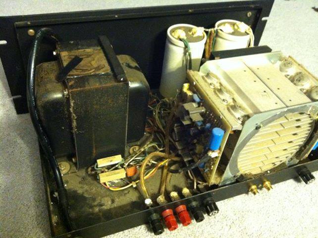

An example of chassis pan rebuild (cleaning comments)
My very first Hafler 500 - the Hafler 500 crud amp.
I actually got sick for 2 days after cleaning this amp.
E. I., Environmental (exposure) Illness - literally.
*as reference to earlier post...
Chernobyl - Fukushima rads, God only knows
what was coming off of it... off gassing crud...
**no longer so... it took alcohol to clean it.
I wore nitrile gloves as a protective barrier ~ and ~
I used a leaf blower and brush outside, to clean
dust out, I did not want to even breath any of it
into my body, I still got sick...
This was the way I got it, I was so freaked out.
Looked like it had been in a barn for years...
it even stunk - it was wretched...
*notice how discolored the heat sink was.

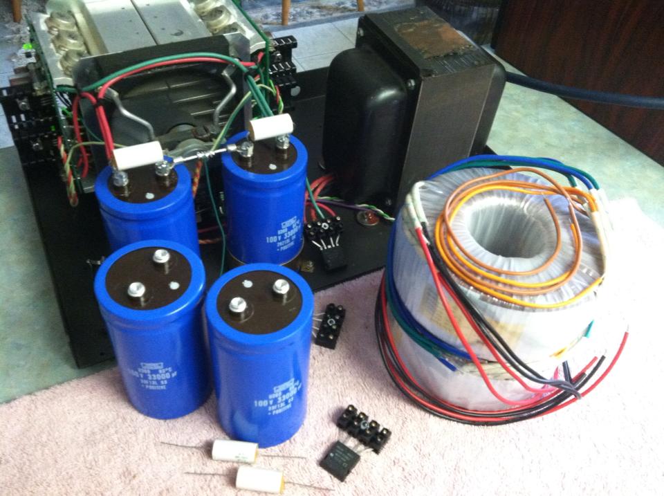

Image 2, there is a partially cleaned fin.

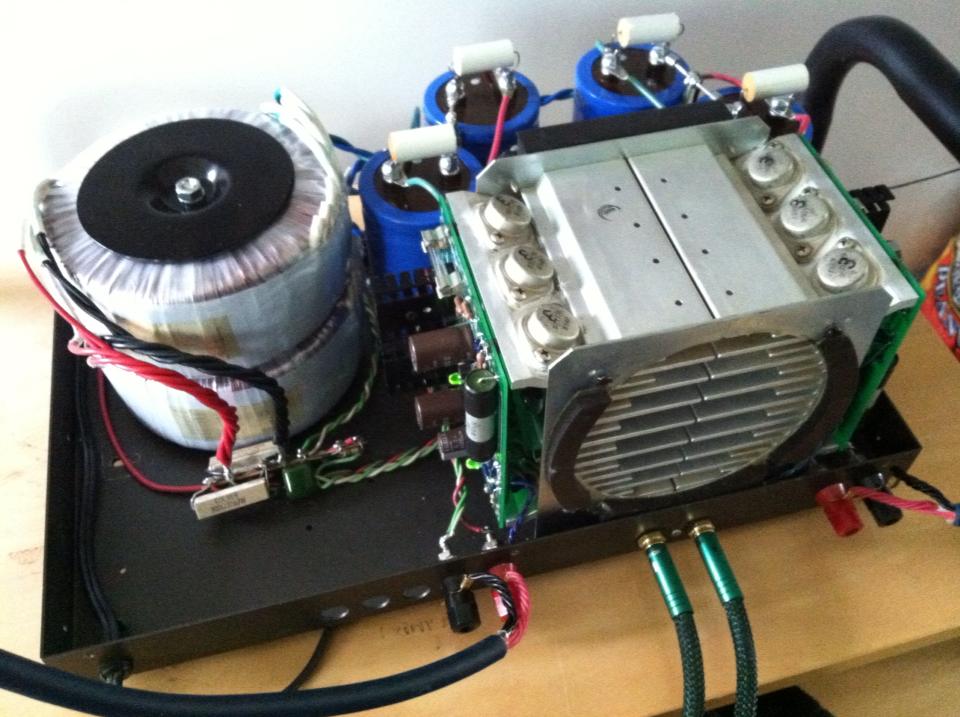

Tidy wiring dress is easy... stock wiring
would not have even worked.

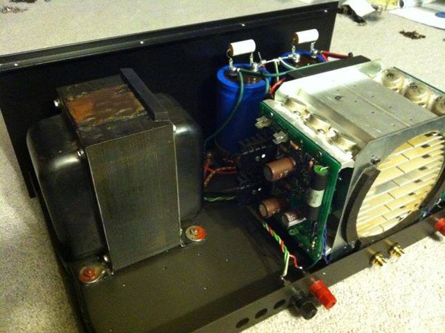

A before and after... (image 2) only 'listened to'
it for 6 hours, let is stabilize, set bias and DC offset
only to determine ~ it had to be(come) dual mono ~
it did not sound that good, not as good as
my overbuilt Hafler 220, believe it or not.
To think that image 5 was my 5th build iteration,
as I gradually worked in stages, checking the
process, as it got better along the way.
I had 3x the money in parts, as the chassis cost
of the DH500 crud amp... Actually liked it better
than my 9,500.00 Mark Levinson No.336
which I sold soon after...

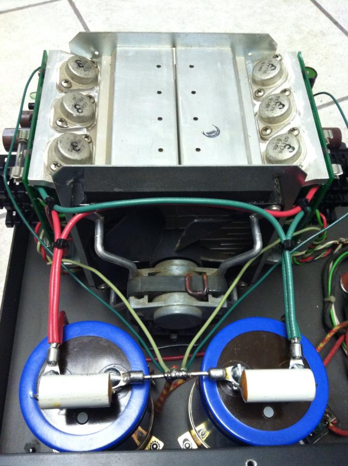

I re-positioned the 5 way binding posts,
...making for a super tidy chassis...
looking like dual AMG exhaust tips
Shorter, more direct wire runs, no protection
relay or speaker fuses. This amp is amazing.
I plan to compare the new P230 mono amps
to this amp, shortly... after they are broken in.
