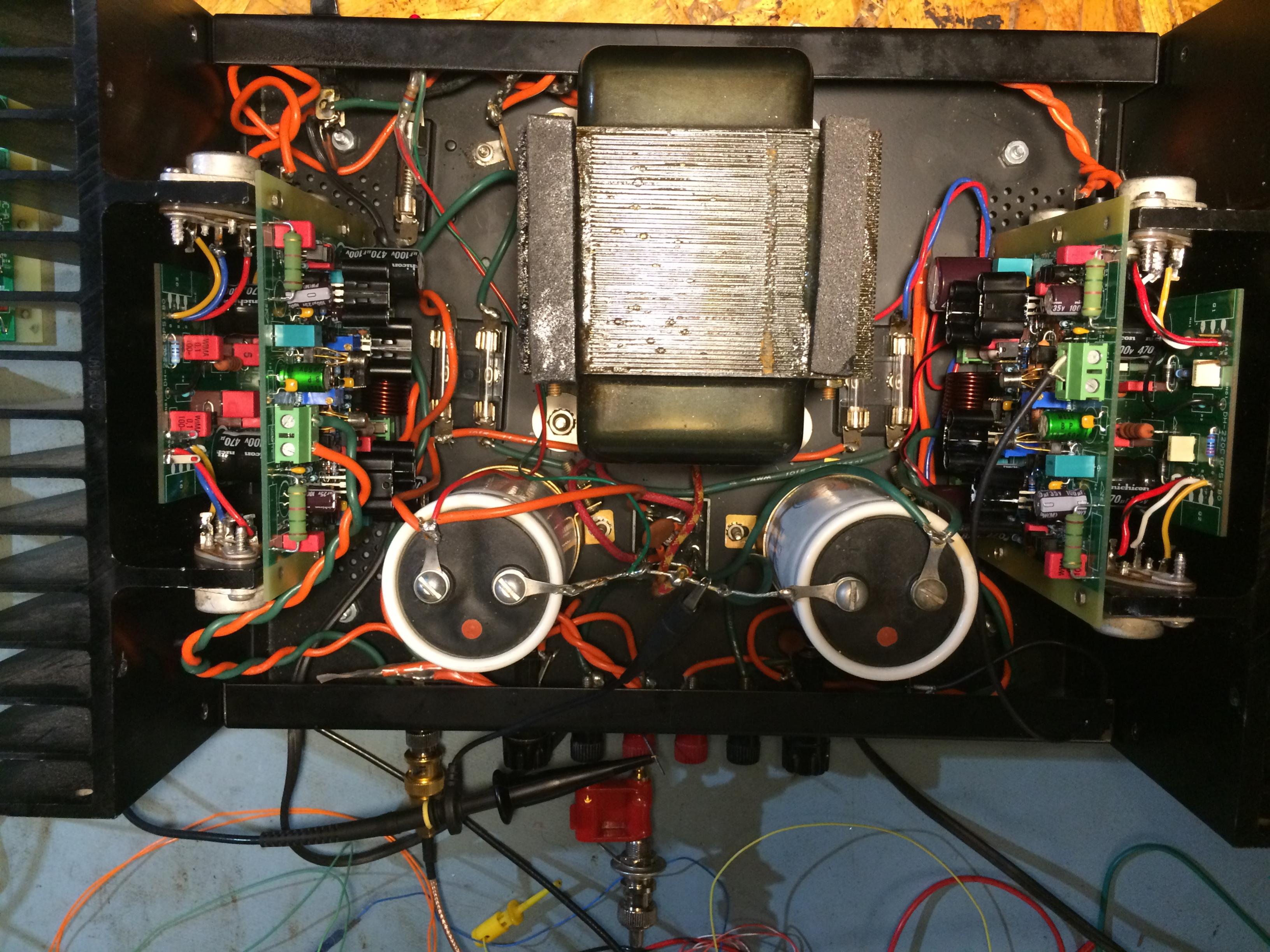

My rational for rewiring... (not meant as a challenge)
I am quite allergic, much of the amps that I see have been used in bars, businesses or in a smokers home (not a knock to those) there is a smelly, oily crud, (cooking oils?) funk on all the internals, virtually on every surface. *I wash the entire chassis, inside and out, with citrus based cleaner and/or alcohol... so 'my amps' do not emit a funky odor in the room as they heat up and during use. **I believe, 2nd and 3rd hand off gassing to be (not good) toxic, another discussion entirely...
I also completely 'rewire', use the same exact wire and parts to eliminate, intra-chassis variables, that may additively impact build variability, and to ensure greater continuity in the wire dressing of all my individual work and to make every single solder connection myself (eliminating another variable) I know what I am working with, no second guessing...
And some people (kit builders) can use old or funky solder, that 'may be' another variable and/or be [hidden] source to cold solder joints, tell-tale veiling and noise.
Over the years, I have seen too many (kit built) amps, where people have done poor wire stripping [often hidden] cutting the conductor bundles.
~ for me ~ not an OCD or simple aesthetic element, I do it for continuity across the board, often is the case, a tidy amp ...is generally a great sounding amp...
Often [too many] kit builders, cut their teeth, learning to solder (I am sorry, make mistakes) on these products, it is easy to inherit another persons mistakes... that may reflect on my efforts... Every piece I build, is done with the prospect of possible resale. My name and 'reputation' is on it, I do not see my gear come back 'broken'.
**Often, when I turn over, and sell my *proof of concept* project amps... I KNOW EXACTLY what I am handing over to that person... These amps ..are.. for practical purposes, "new amps" in nearly every sense of the expression.

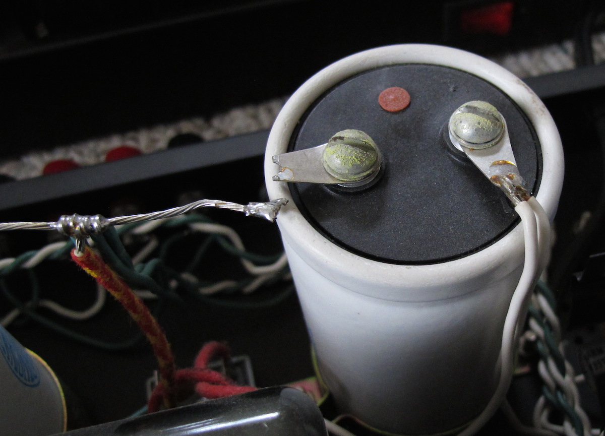

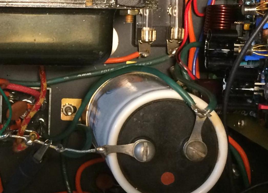

Rick, this is not a criticism, I cringed when I saw it...
[I HAVE IMMENSE RESPECT FOR YOUR WORK]
I reworked this on my very first DH200 amp in 1980,
it popped in my view, as I first saw it, when building.
There should be no shared wire between left and right
channel fuse blocks... very common, even on
factory wired units. Except most "p-series" product,
as this became understood and addressed.
There ~ should be ~ 2 separate wires from capacitor
to each fuse block, so that there is not shared power
for left and right channels. **Again, not a criticism.
I rewire most things that cross my work bench
*this being one of several things I address...
image 1) your original image *post #1682
image 2) a close crop (I made) to better illustrate.
image 3) a good friend sent me his 220, with a loud buzz
that we figured was bad caps... he never opened the
case. I was going to rebuild, recap, (yes) rewire,
and 'touch' every single solder point...

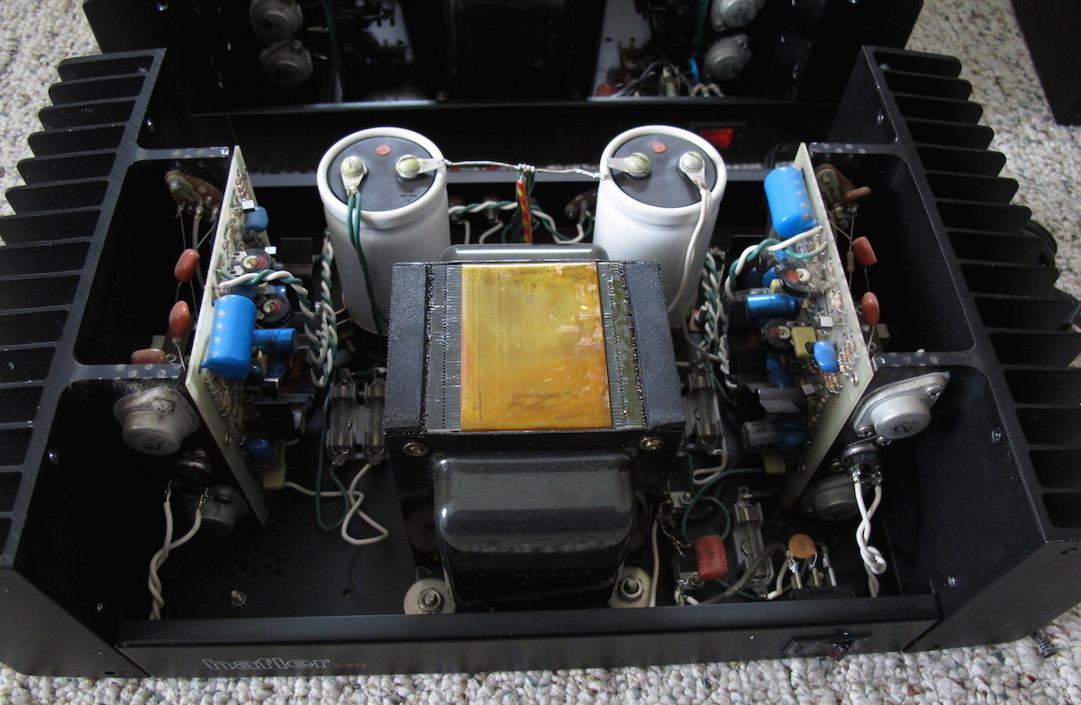

image 4) this amp, was among the most pristine
externally, a real cream puff, *with mistakes*
only 2 shared wires, would never know...

You did not touch a nerve, but making a blanket statement than they all should be re-wired needs to be qualified as to why, what to use, how. You did touch on some of the reasons which are fine, but I think evaluation can be done, some touch ups can be done without resorting to gutting it and a complete rebuild. It might not be necessary and if done incorrectly could make an operational unit non-operational. I see this a lot even with re-capping efforts.
On my unit, that you show, it was wired by the original owner. I did not even bother to evaluate or question it. I see what you mean however, it could be improved upon as you describe. Nothing wrong with finding faults in the manufactures methods and materials, suggesting improvement, i am all for that, since that is what we are doing by designing new boards.
As you are suggesting to others to re-wire them, some might just wire them up as they were done originally and not even question if they were done properly in the first place. Now that I look at the Hafler instructions, my unit is wired per the instructions, but I do agree with you that it can be optimized, as you suggest. How much difference it makes I am not too sure of but it certainly would not hurt to do it the way that you suggest. Everyone take note. If you have other suggestions for improvements, make an itemized list of them, so everyone is aware of them and they can decide if they want to implement. Nothing wrong with that.
I did not mention that I have been getting my teflon wire from a eBay seller "superiorbuy2014". It is PTFE FEP Wire High Temp. Stranded Cable UL1332. If I could get it locally in small quantities, 5m lengths, I would but I do not know of anyone selling it.

- Use separate ground wire to each fuse block
- Make pretty wires (LOL)
- Add more uf to the PS filter caps
- Replace other old electrolytics
- Add inrush limiter to AC line
- Replace bridge rectifier with 35A if required to feed larger filter caps
After this is all done and I have a perfectly quiet amp I will proceed to install the bridge kit to run it mono for the sub.
If the above sounds better than one channel of the stereo ashley amp I am using for my subs now I will get a second DH220 and give it the same treatment and run dual mono 220's for my subs.
My friend used to power his subs with a Hafler XL-600, never forget that bass! I know I am not going to get there with this, but 400-450W of DH220 bass should be pretty sweet I am hoping!
Really, #18 and #20 wire, seems kinda thin?
You are correct, looks like a 25A bridge, no reason to suspect it is faulty. However, I read if you bump up the filter caps to 18,000uf you should bump up the rectifier to 35A as well... and possibly insert an inrush limiter in the ac line to save the power switch? Something like this perhaps?
SL32 0R536 Ametherm | Circuit Protection | DigiKey
From what I gather the best way to improve bass performance is to stiffen up the power supply a bit with more uf in the filter caps. So I was thingking:
- Rewire to eliminate kit builder mistakes and noise
- Use thicker wire / Quality solder
#18 wire is plenty big enough for the high-current lines in these amplifiers as these are short runs. It is very doubtful that thicker wire will improve the bass in these amplifiers. The wire that bridges the main reservoir caps and serves for the star ground should be thicker, or even a plate as used in the P230, but that is for reasons of forming a better star ground point than improving the bass. #20 or #22 is plenty for small-signal wiring.
Bob
- Hafler DH-200/220 Mods
