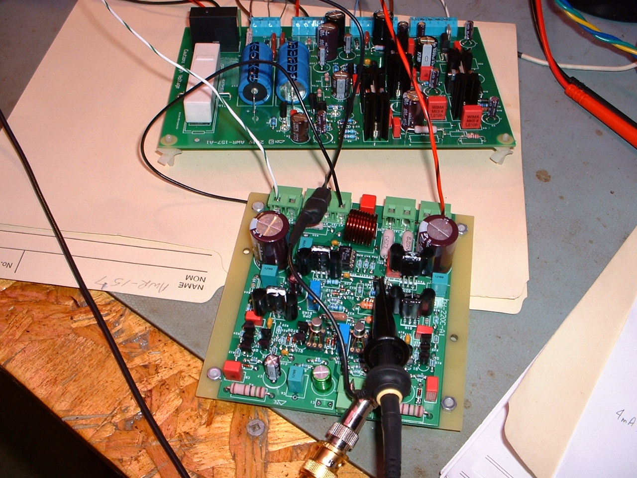

I would be interested in testing a complete unit with Bob's new boards. Then, if the parts haven't been matched, maybe I should try one of these with matched pairs (which I would do of course). I can match BJTs within 1% using the jig for that purpose. This always makes an audible and measurable difference in my experience.

Chris, boards and parts are still being revised by Bob and Rick.
I’m looking forward to them finishing so I can renew several Hafler ( and hopefully an old Perreaux with similar Hitachi TO3 Mosfet output stage). Once Bob’s update gets released the price and availability of Haflers will become competitive, best to get one soon.... some old Ashley and Soundcraftsman too.
Your welcome to test or build . I bought parts to rebuild 7 of them, so plenty of semiconductors around for matching.....

I have the DH-220C-A1 fired up and running on the bench. I put in all Vbe matched devices except the KSA1381E and KSC3503D, they do not come in the same hfe grading anymore, chances of find a match are like winning the lottery = waste of time & $.
