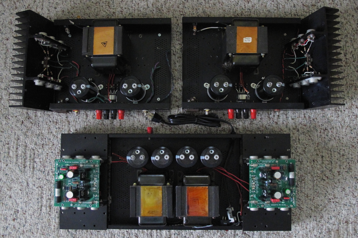

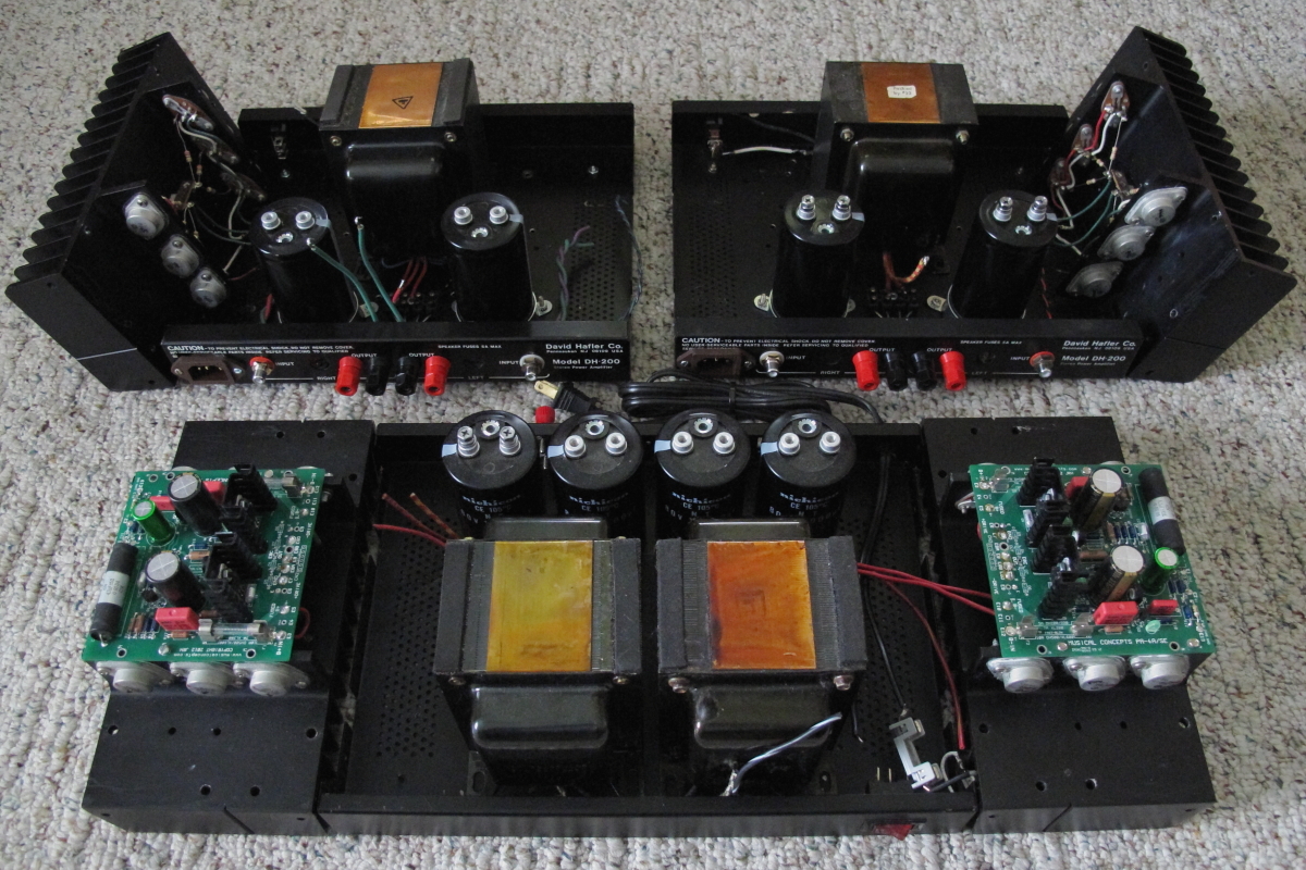

I figured I would post an abstract of my ideas, portion to why I am modeling this in the ways that I have. It is a challenge to clearly convey my [mental battles] abstract ideas... a picture serves to better illustrate the challenges of ~ squeezing ~ 2 reasonably large power supplies, without sacrifice into one small'ish, very tight chassis pan. I always start with the amp core and work my way outwards. After all, *the amplifier* is the power supply, gotta get that right before doing any other work on the amplifier circuit. (of course, my way, my approach) this may not suit others, we each have different design goals and more importantly, budgets which influence or result.
*for note, my main amps... my musical reference are dual mono (tube amps)... in order to work effectively in my listening set up... Said amplifier chassis best fit the footprint within my main listening rig(s). Constantly re-routing cables, stressing spade to speaker wire interface (is unacceptable) by constantly bending cables and repositioning everything is a P.I.T.A... This may be hard to understand. Conventional stereo / 2 channel amps, just do not work well for me… as my amps do not fit in a rack, or in between the speakers.
My principle goal, was that, I wanted to increase power supply capability in a mono approach, not halve the power (in dual secondary) transformer configuration. Though I am thinking of stacking two toroids in *future* XL280 amp / chassis build. First, I must test, proof of concept... to see if there is a meaningful difference, to warrant the extra effort. Second, said build, will mean and amps chassis that will never allow a top cover... A whole other story, save for later...
Images: front amp is a XL280 chassis, with 1 inch greater width, yet this idea is (utterly ridiculous) not a good idea and impossible, there is no room for driver circuit, not to mention magnetic issues. **the image is simply to help me illustrate a point to others.
The 2 DH200 chassis's behind have the exact same power supply,
divided and effectively doubled over stock amplifier. A given.
I am leaning to using stock transformers for these reasons (on first build)
#1) for 625va size. [I want to hear them, as proof of concept]
#2) they permit more room to adapt later. [choice of capacitors, wiring ease] Mundorf MLytic HC
#3) be able to compare them to 400va toroid ~ and ~ while remote
#4) be able to build separate higher voltage front end supplies,
as they are XL280 power transformers… (pretty unlikely, an even longer story)
**the only way that I will know is to try this, model it and experiment.

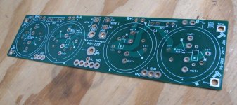

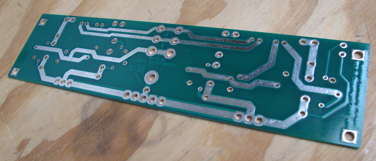

I have had great success, with dual secondary 625va toroids associated to the PS200 / PS220 circuit board, power supplies. They are or appear to be without compromise. I used a DH220 based amp (for years) driving Maggies, never noticeably clipped or ran out of power [admittedly] was mindful of the amps power capability, but never noticed any lack of authority or power.
I am going to build up (the dual secondary toroid shown, on top) with the new PS220 board with (4) 80v/10,000 Mundorf MLyitc AG caps...in place of the of the *exemplary* Jensen 4-Pole caps, as shown. Save the Jensens for yet another project... The amps chassis shown is a XL-280 (it is a future project) I want to try everything that I can before, committing a plan.
...Yes... yet another [proof of concept] project...
My intent is to be comparing the board mounted Mundorf MLyitc AG, to the Mundorf MLytic HC in a point to point wired configuration (the only way to do it) This affordable, very well engineered PC board is fabulous sounding, permits easy installation and can be used stereo/mono or dual mono... in essence is scalable to any type of build... can use 2 pole or 4 pole caps. *Is not limited to Hafler amp use...
