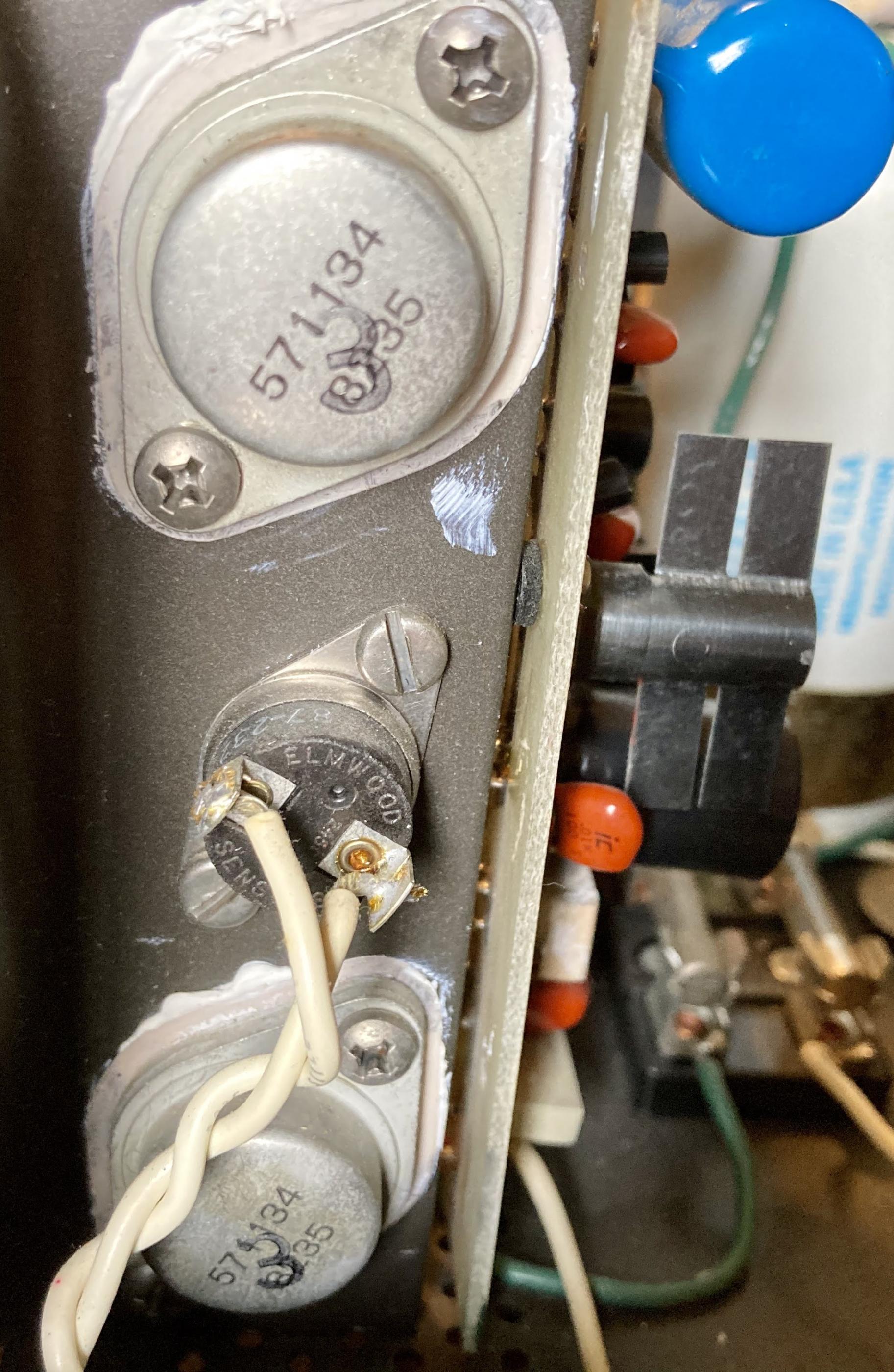

Clean Slate
I am excited to get started on this journey. The DH-220 I picked up is in very good shape. It appears to have gone under the iron not too long ago, with some good cap replacements.
I used it for several days in my main system to get a feel for its stock character and it is surely a fine amplifier for being nearly 40 years old.
I received the boards and jfets today for the 220-C upgrade, so the BOM exercise will commence.

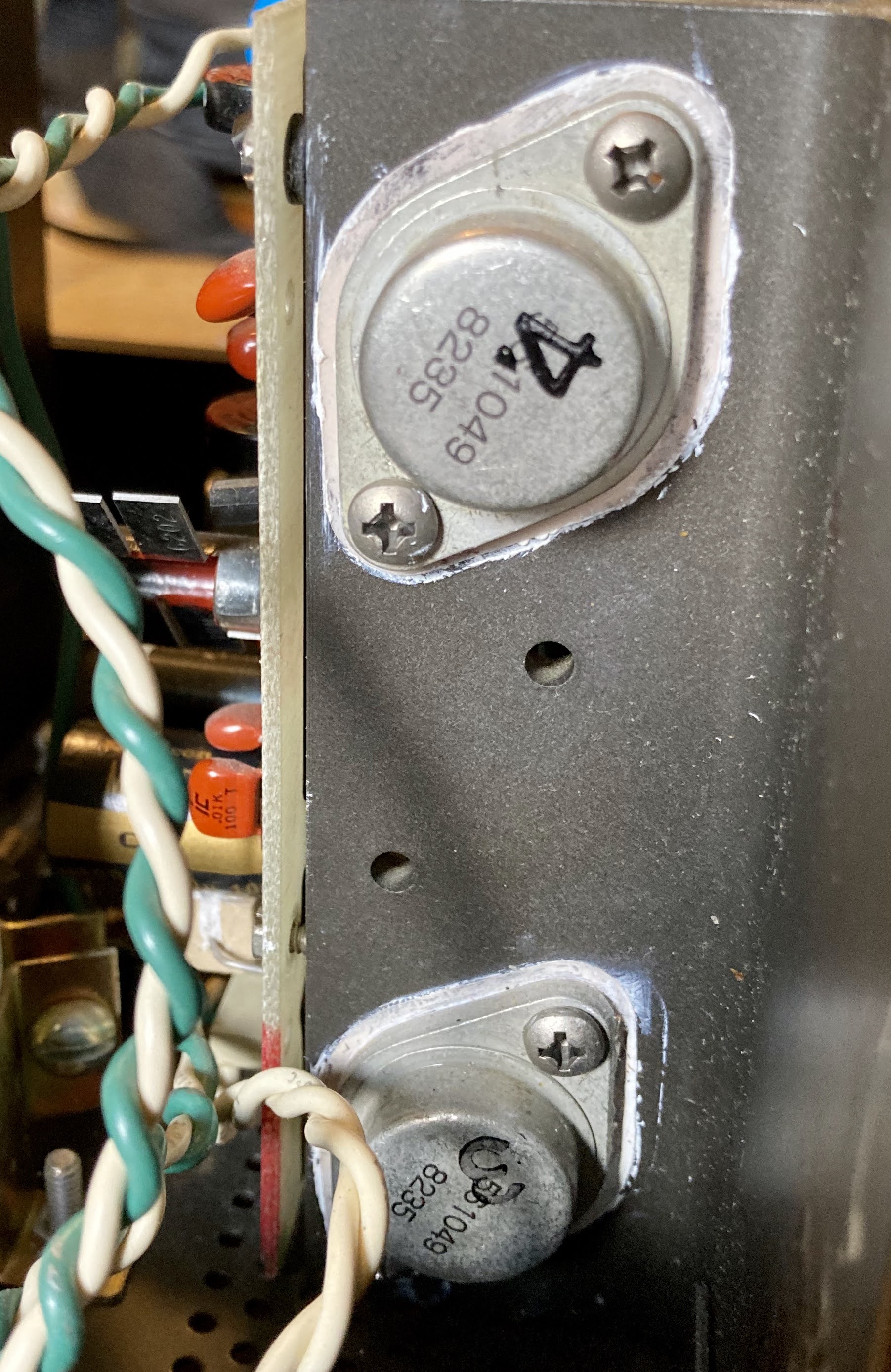

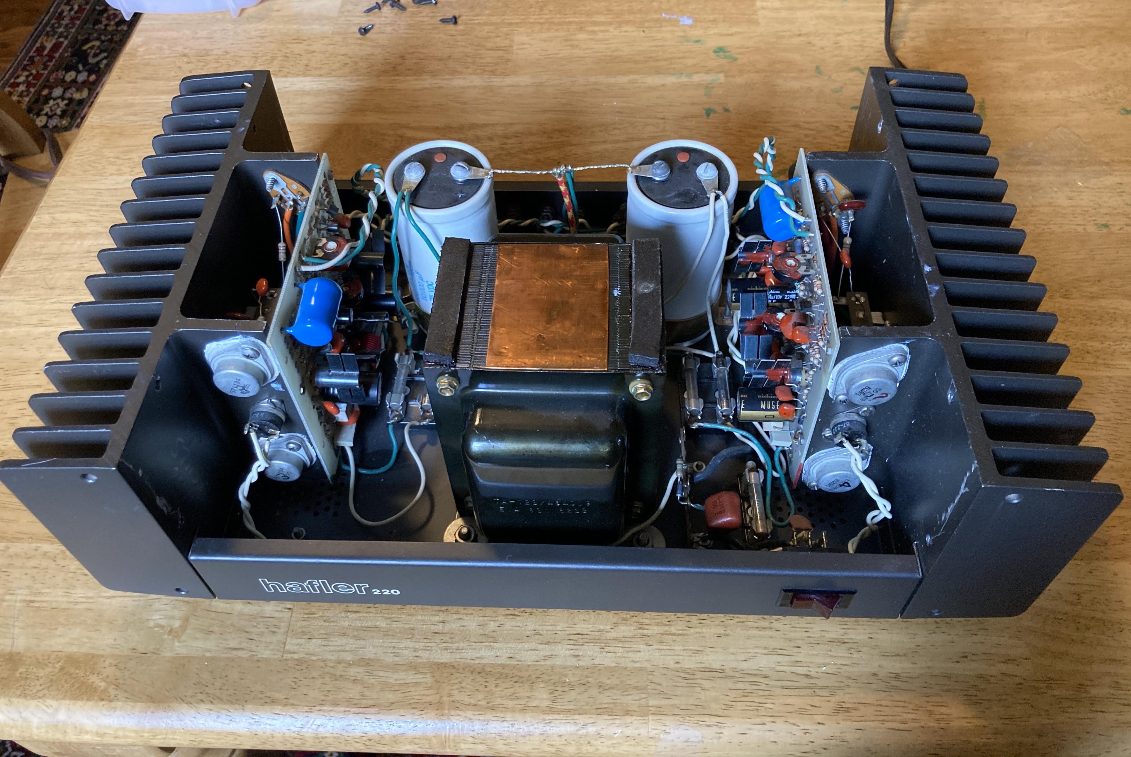

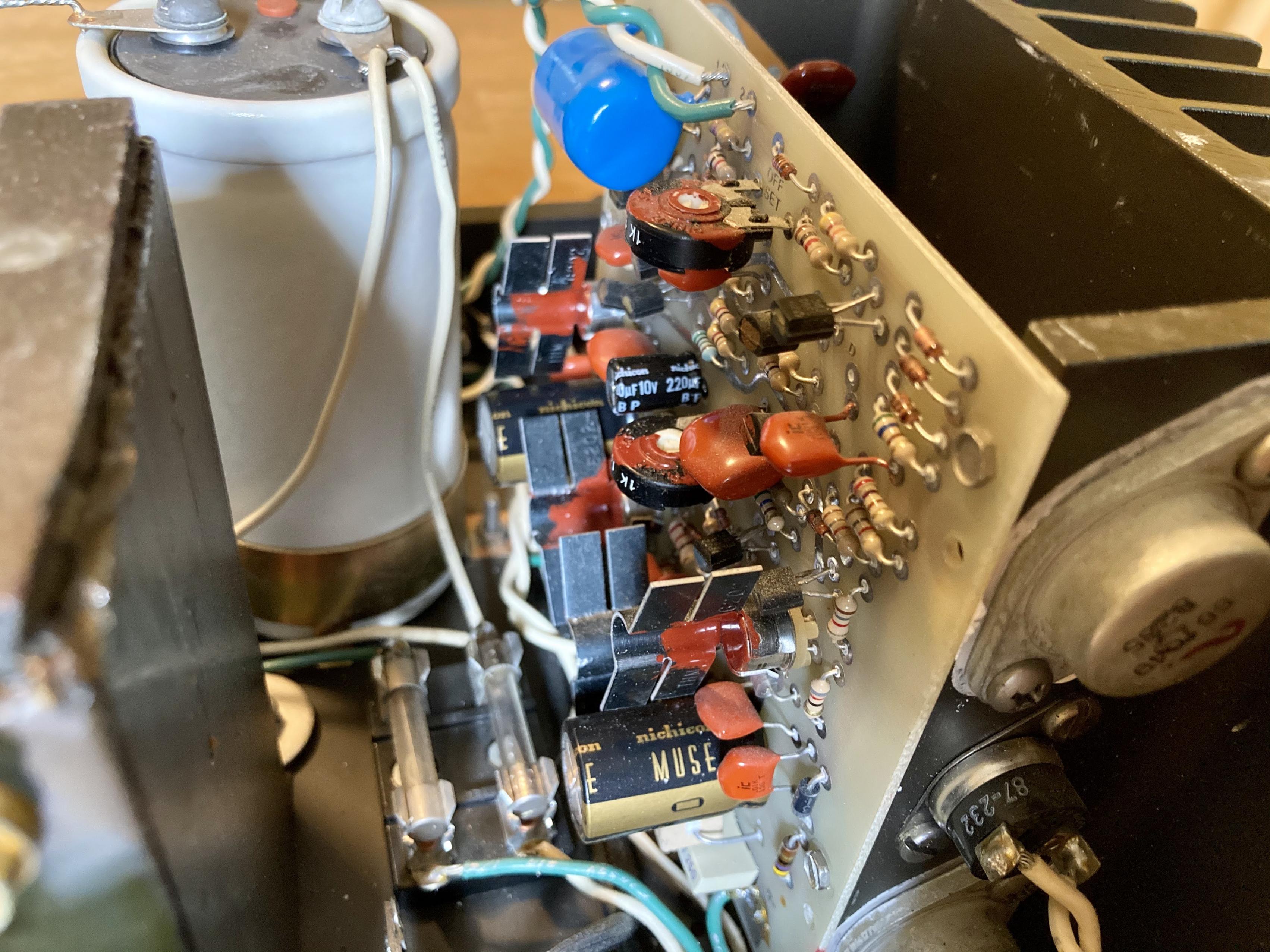

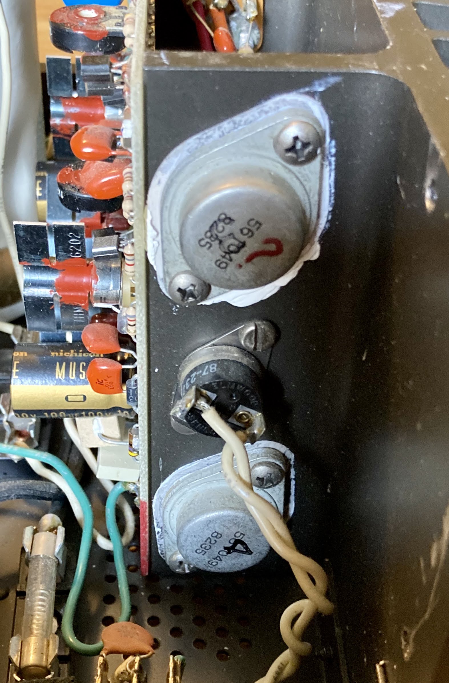

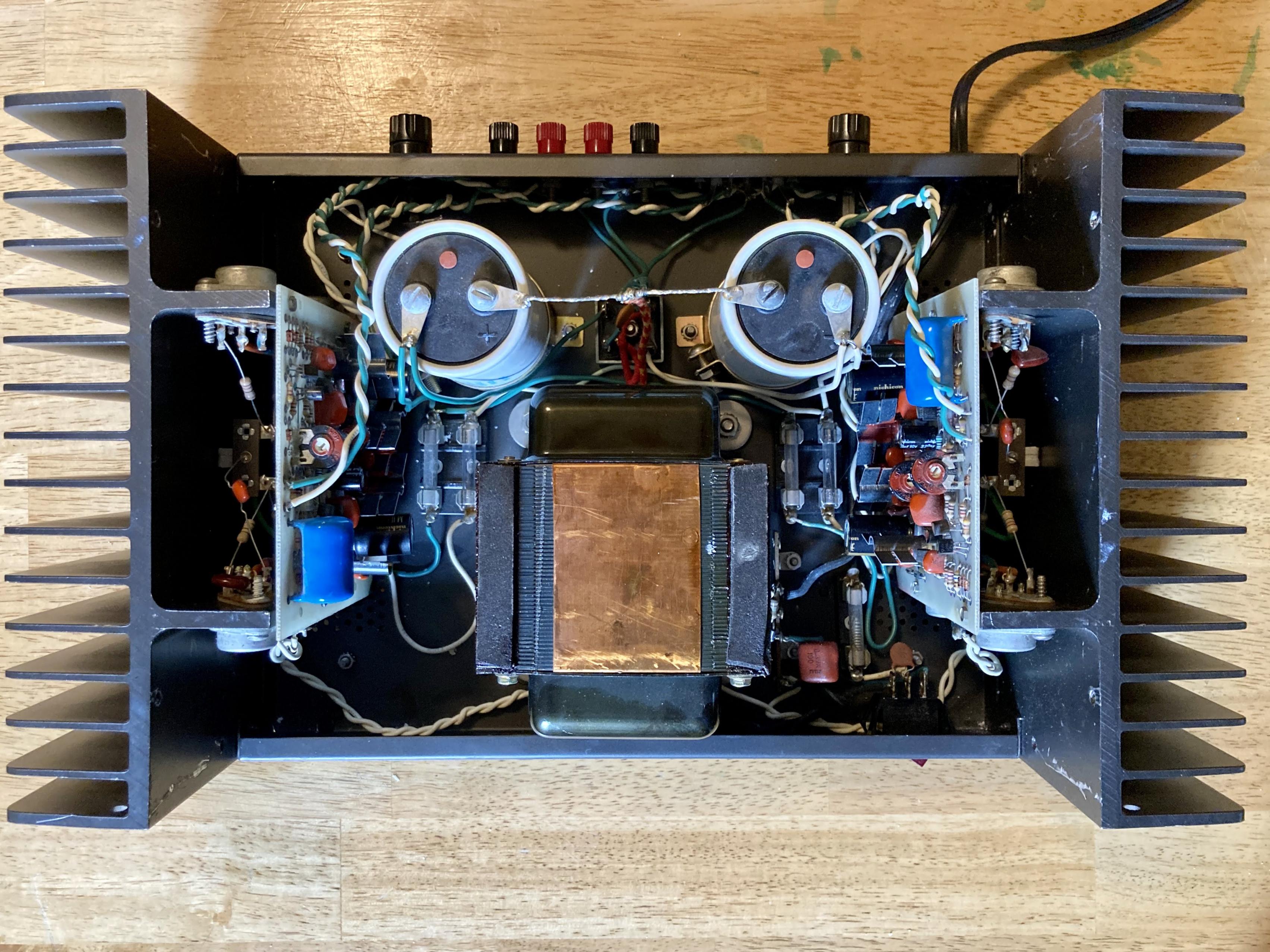

Anything in these photos look awry? The T03 mosfets look original. Though someone wrote a "?" on one of the 2SJ49s.
Enjoy the peek under the hood!
Anything in these photos look awry? The T03 mosfets look original. Though someone wrote a "?" next to one of the 2SJ49s.
Everything looks fairly normal and standard. However, the question mark may mean that the person who put it on was either unsure if the device was good or unsure of its matching to the other same-sex device on that heatsink. Hafler matched output MOSFETs into several bins, each bin designated with a stamped number. We normally expect a pair of devices next to each other to have the same bin number. It may also indicate that the bin number was illegible or that he removed all of the devices from the amplifier at one point and perhaps didn't keep track of where they were put in originally.
Bob

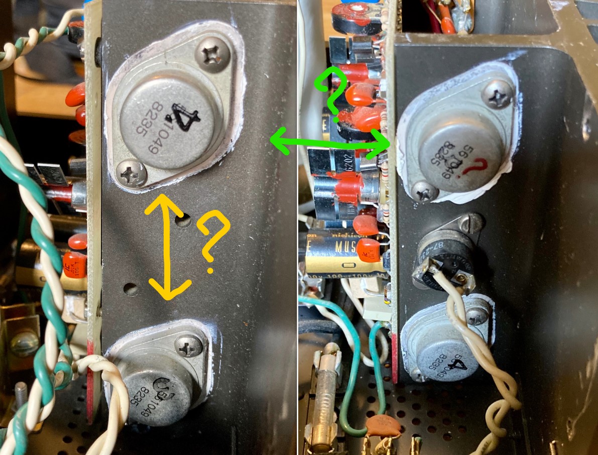

Thanks, Bob.
So in theory, if all the 2SK134s are labeled 3, two of the 2SJ49s are 3, and two 2SJ49s are 4, should the 2SJ49s match up per channel or across channels?
In other words, when I remove the devices and reattach them with the new boards, should I move the 2SJ49s around (swap green or swap yellow in the photo)?
