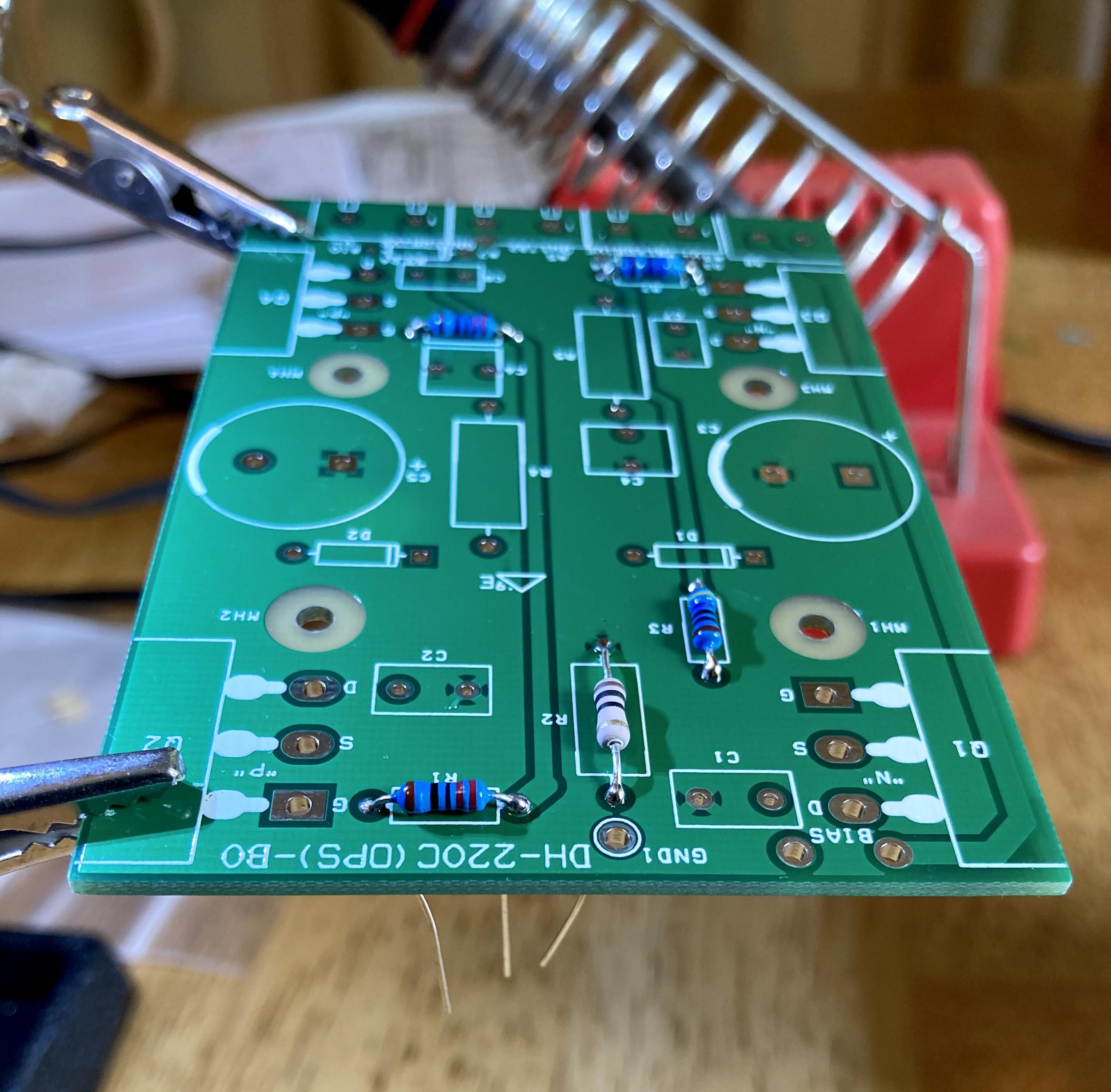

So I’ve been progressing through soldering components to the PCBs. Both OPS boards went smoothly. Simple work. I got frustrated with the little TO-92 transistors on the AFE boards. Tight spaces for my ham-fisted soldering. Until this point I’ve been soldering both sides of the PCB, except for the caps.
Is it OK to solder these just from the bottom side of the PCB?

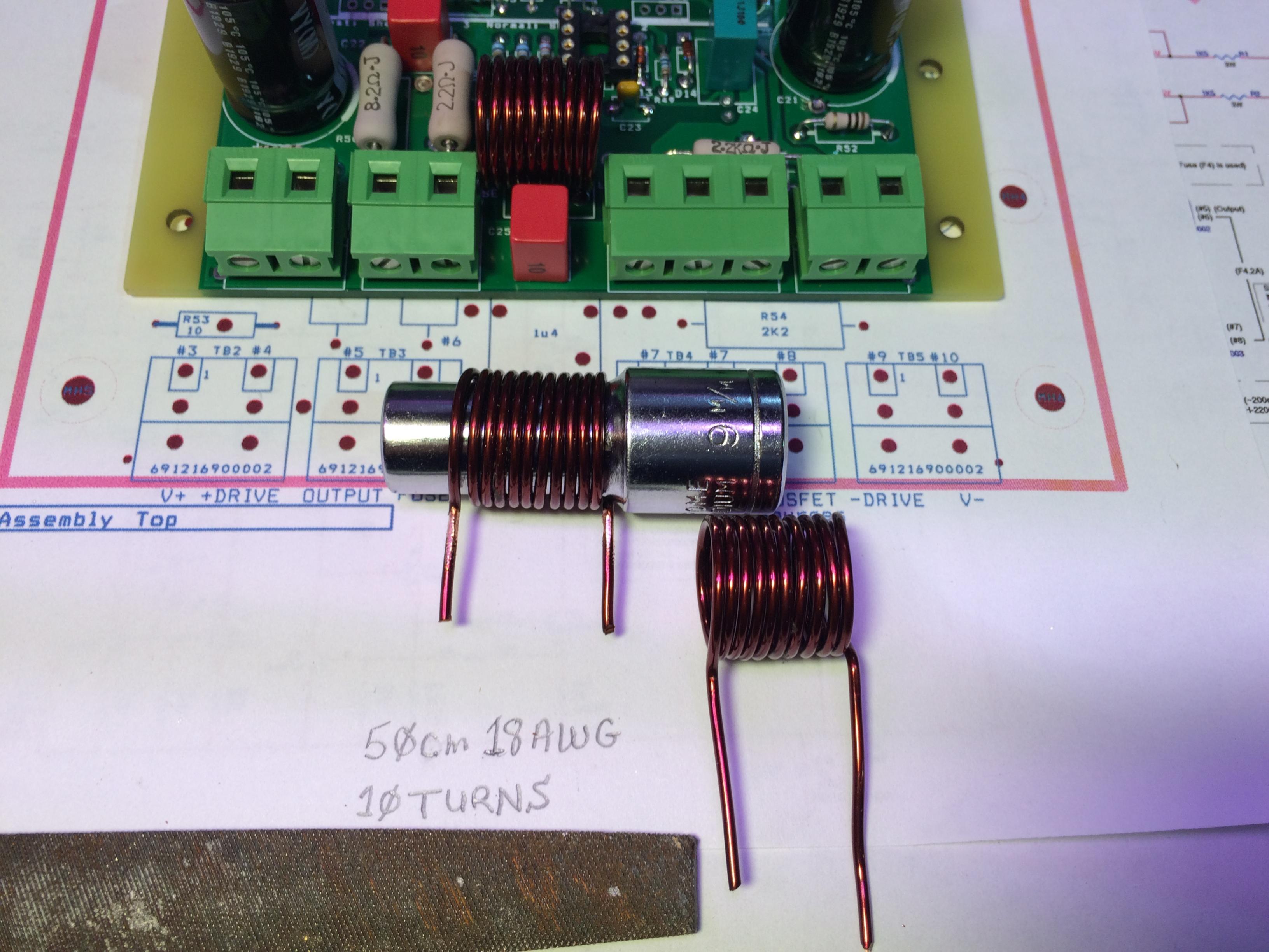

In disassembly of the old DH-220 boards, I’ve discovered that the old L1 coils are not the same between channels, nor do they match the description of the new DH-220C L1 coils.
So, I’ll have a go at making my own. What is the diameter and inductance value of the DH-220C coils? I know the build instructions describe how to make them, I just want to make sure I have the right target values.
The DH-220C schematic shows the L1 coil inductance as 1.4uH which is the same value for the coil on the original PC19 board. For some reason, the coils on my PC19 boards have 13 turns vs 10-11 turns. I don't think the value is too critical, just as long as you're in the ball park. One suggestion is to take the PC19 coils and modify them to have the 10-11 turns.
One of my old coils is probably good, and looks like you describe from the PC19. But the other is thinner wire, and less turns.
I just want them to be as similar as possible in my amp, so I will make 2. I doubt I would be able to get a coil as neatly wound as the “good” original.
And thanks for pointing out the 1.4 uH. I saw that after I posted.
The value of the inductance is quite uncritical. Anything in the range of about 1.3 uH to 2.0 uH is fine.

I made my 18 gauge coils and soldered them in.

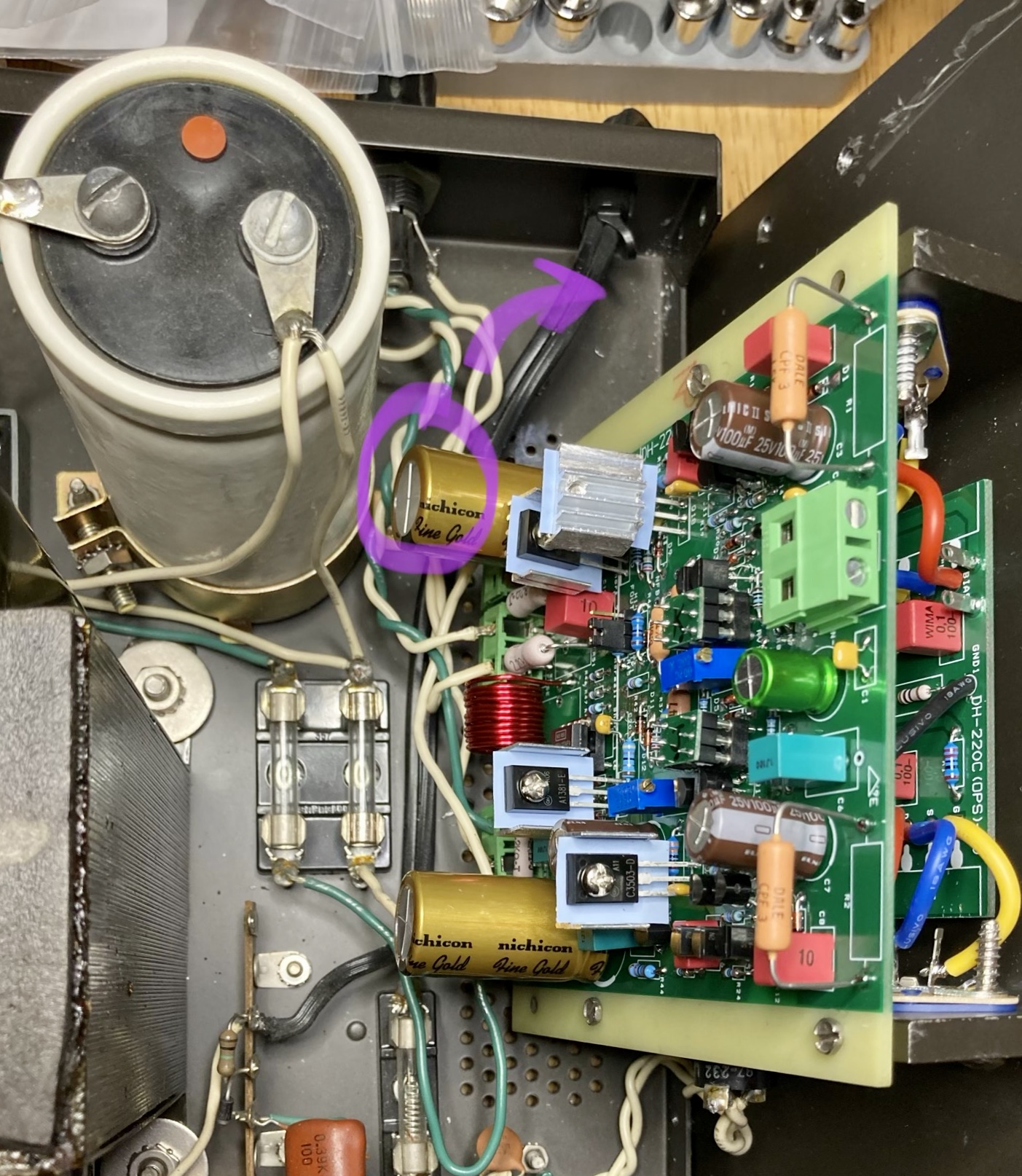

Your new DH-220C boards look good! The UFG series caps are a good choice if they fit. I assume they are the 470uf size which are 35.5mm tall. If you cannot make them work by leaning them sideways, Rick reported good results with the UBY series which you can get in larger uf values that will fit. Concerning your original Sangamo white power caps, those things should be replaced being 30+ years old. They will hinder your amp’s performance and are a reliability issue. I replaced the original caps in my DH500 upping them from 20k to 39k uf and heard a nice improvement in both bass response and dynamics. I believe you can get 22-24k uf value that are the same physical size as the original 10k for your DH220. When you do that, replace the flimsy wire between the power caps with heavier gauge wire or even copper rod. There is a lot of current flowing between the power caps. The wire from there to chassis ground should be heavier gauge wire as well. Some previous posts cover this. With the larger power caps, probably should add a thermistor on the AC supply to limit current at initial power up to reduce the load on your transformer and power switch for reliability. After the thermistor heats up and the power caps are charged, it will reduce resistance to not limit current flow.
Thank you!
I will likely do the big cap upgrade as 2.0 after this first phase of work. The old Sangamo caps measure well (cheap transistor tester from amazon) and the amp sounded actually great before I started this upgrade.

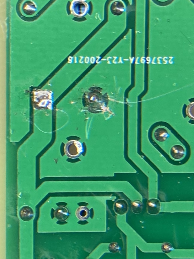

I managed to lay one gold nichicon down on one board and am about to do the next. However I somehow scratched the bottom of the board in the process, or didn’t notice this before. Are these little scratches a problem?
Those scratches appear to be to the outer clear coating and not the metal traces so should not cause a problem.
