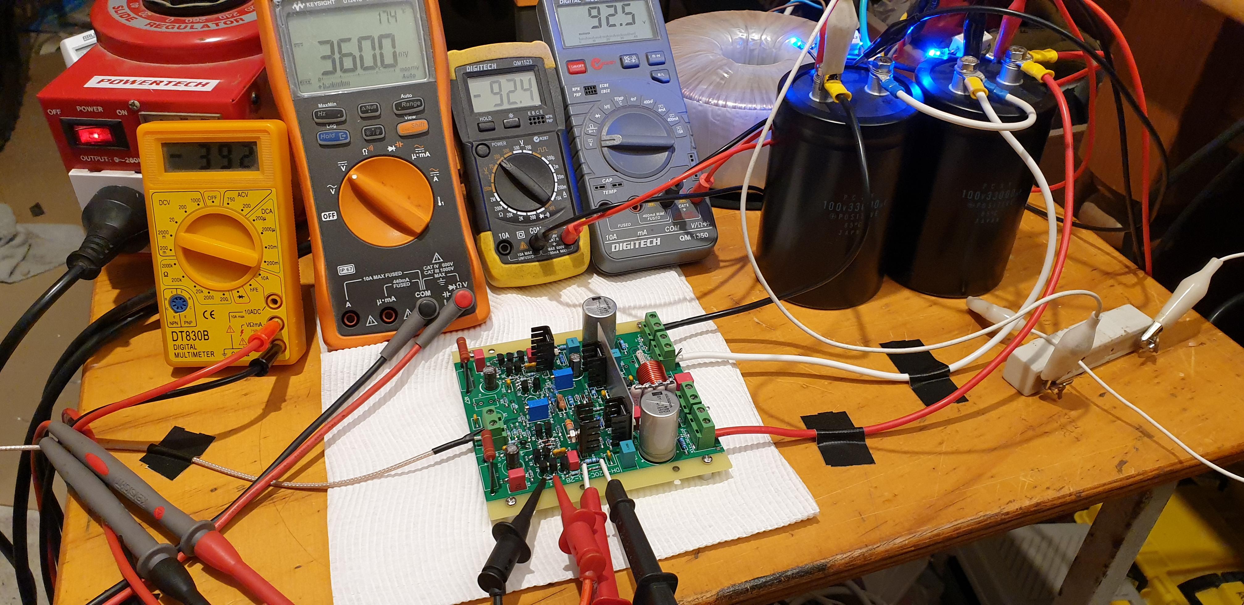

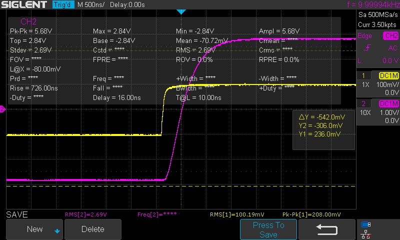

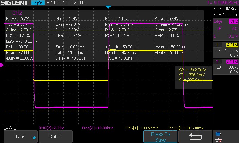

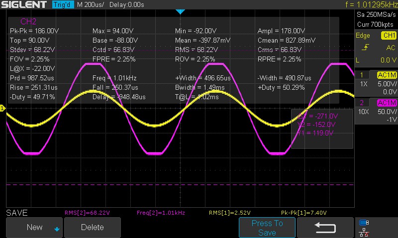

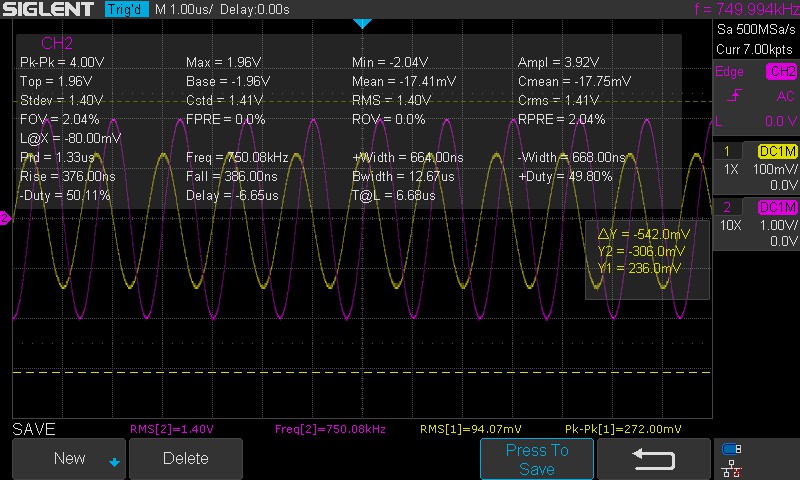

Hi Rick,
I have built the front end and tested it.
Bob Cordell has done an excellent job with this design, and your boards are great to work with.
I have scope shots, and THD graphs of the front end running at 92Vdc rails.
Happy to post results if you like.

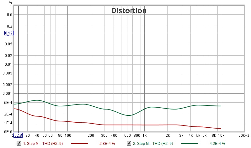

The measurement floor is the lower curve of the two graphs.
This is at a relatively low output voltage of 1.5V. The results are slightly better with higher voltage output. The load was 10 kOhm. The graph with 10 kHz maximum was filtered at 20 kHz. The Graph out to 40 kHz had an 88.2 kHz low pass filter (software based)
-Dan
-Dan
