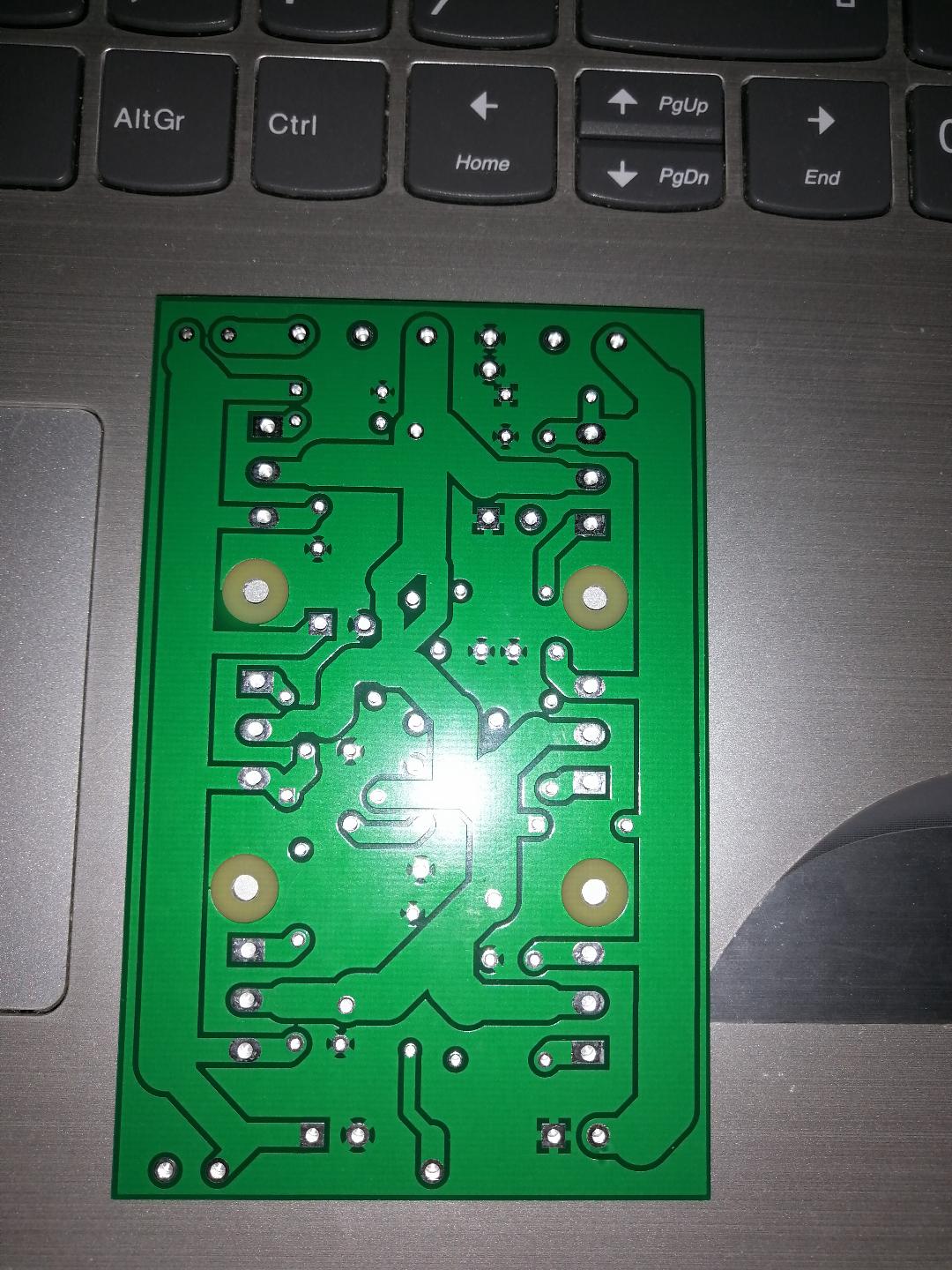

- Thanks for your efforts here, I applied most of your changes in getting my boards up and running.

You post that message exactly when I want to hit the "Buy" button at the Mouser bom materials....That save me to change a few things based on your guidance. Great.

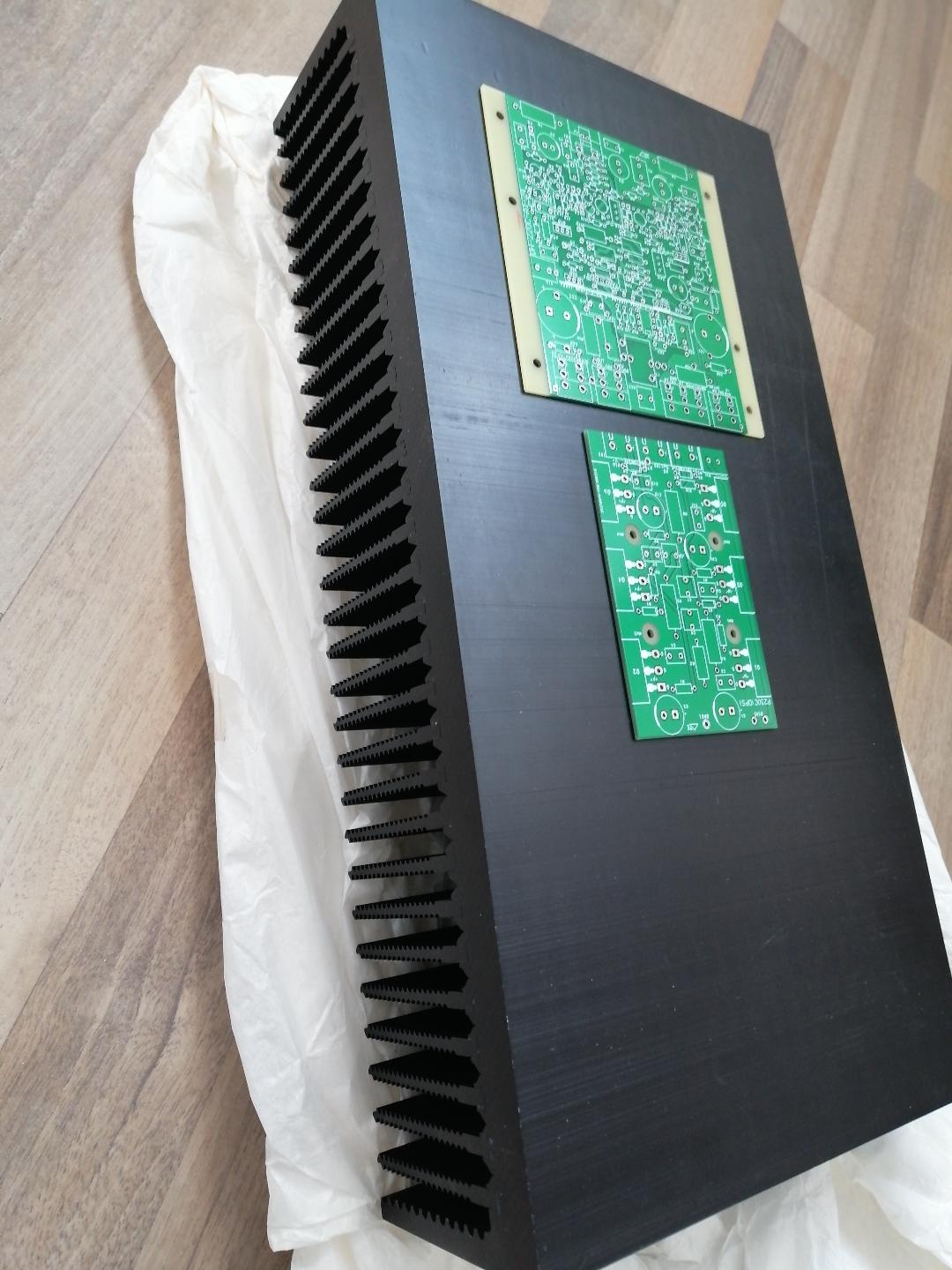

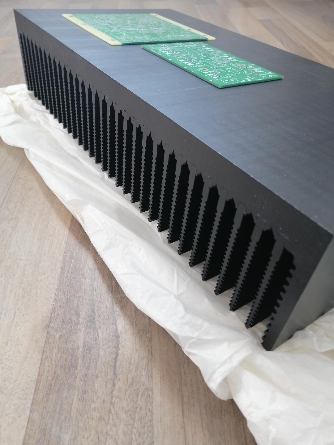

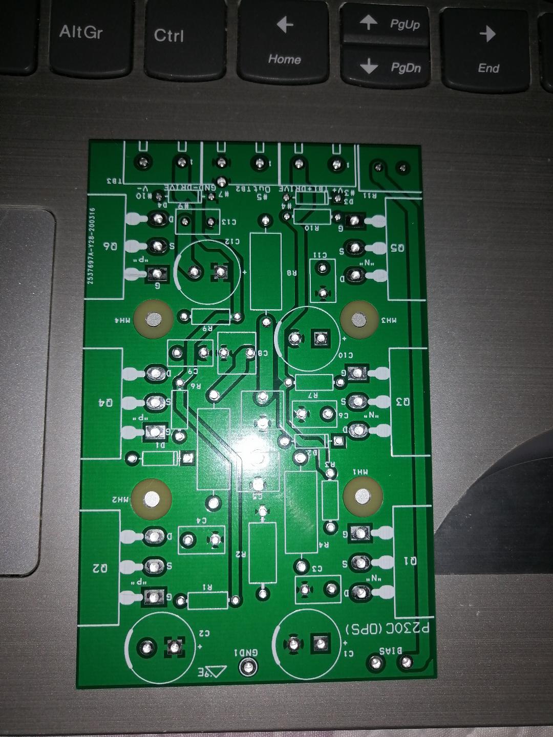

I see that folks are wanting to build this DH-220C design project in other than Hafler chassis which is great imo. But it is not 100% setup for this for the best mechanics.
It is possible to design new OPS's which the mirror along the long edge so that AFE and OPS face each other and can mount on the same HS surface. With no or minimal wires crossing. DH-220CR(OPS) was designed for this but it looks like the P230CR(OPS) and DH-500CR(OPS) need to be done too. Add them to my to do list, if there is enough interest.

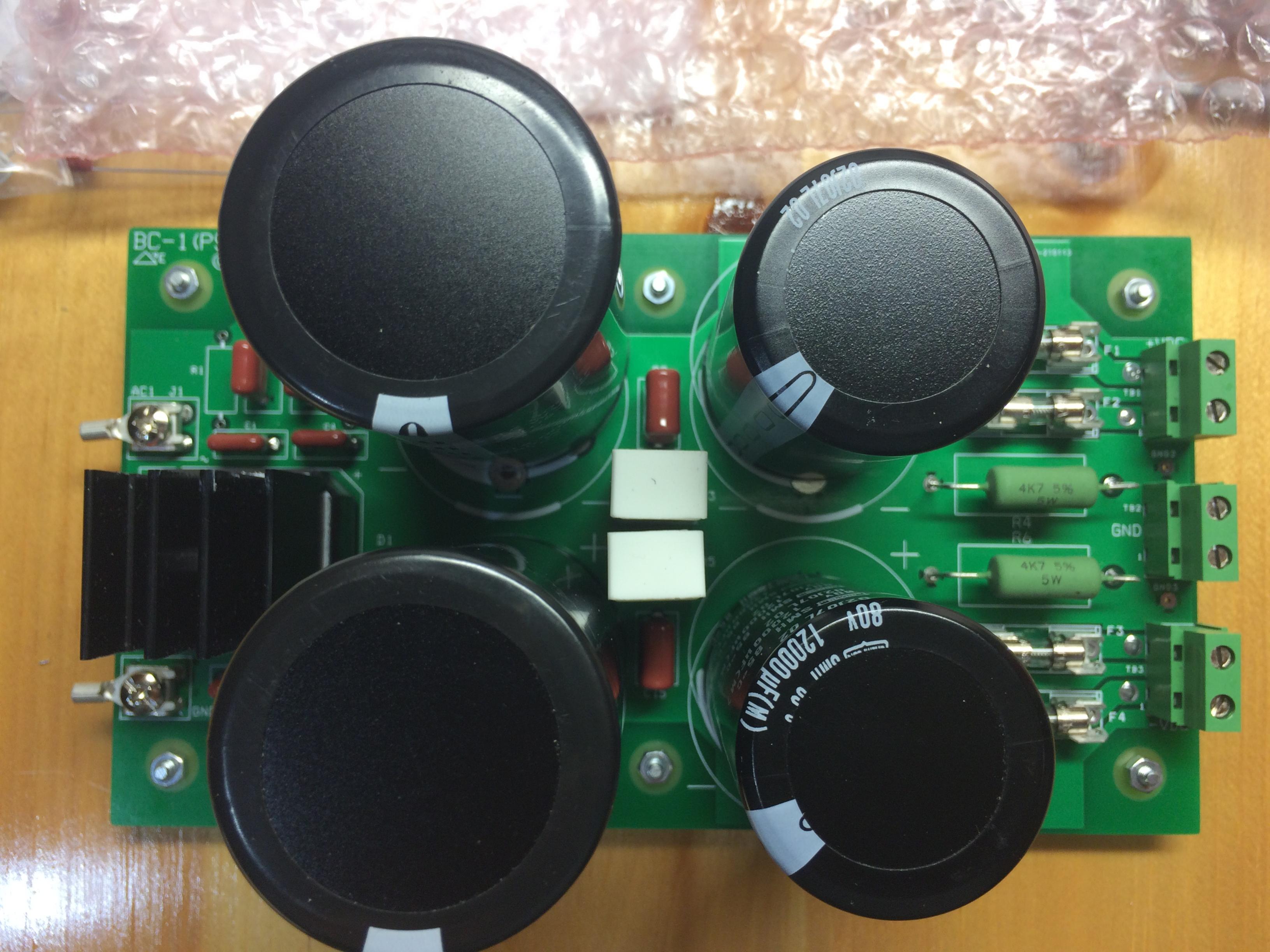

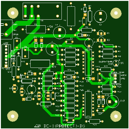

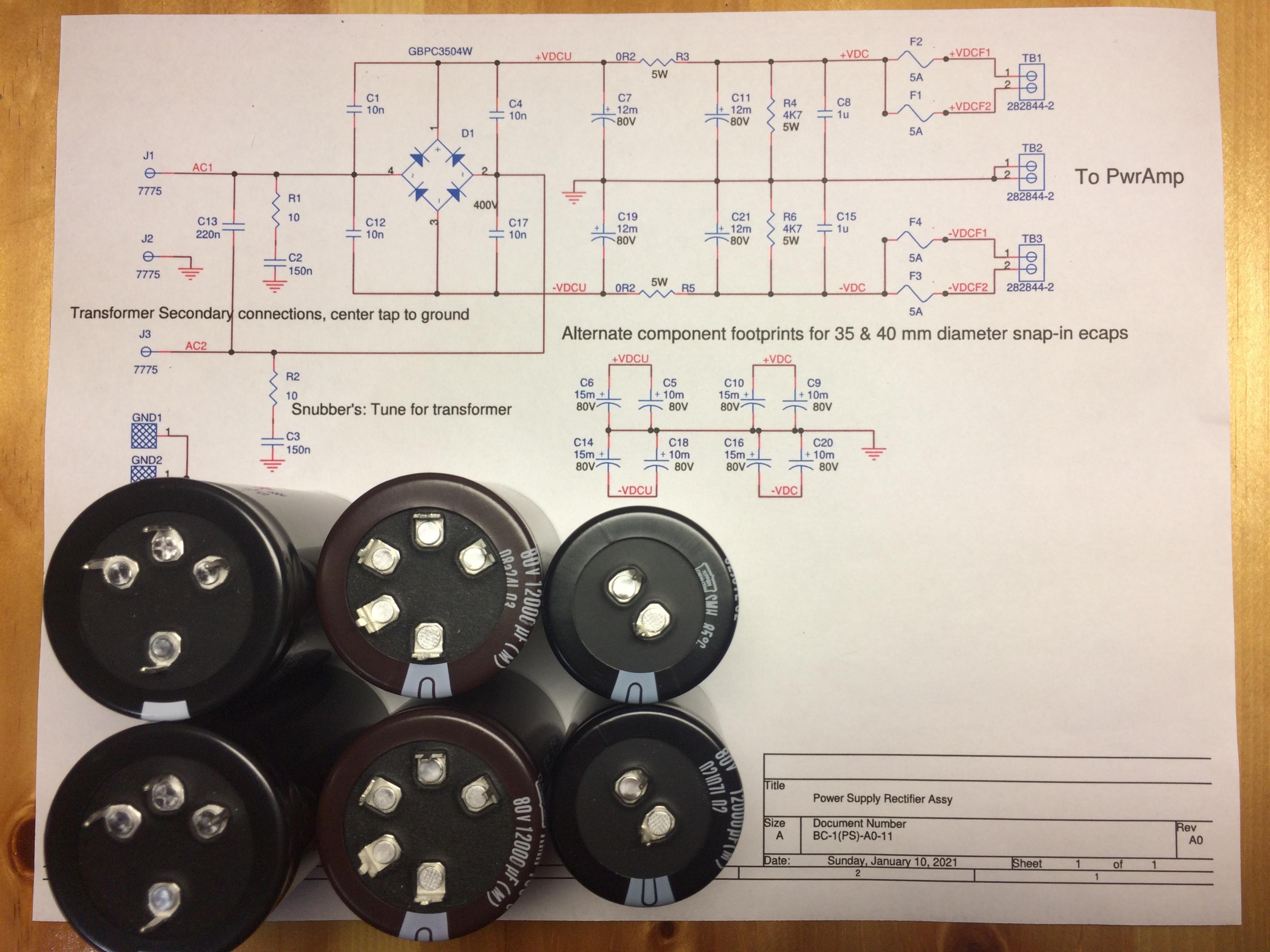

We have been designing some other pcb's as well, PS & Protection, to go along with our BC-1 design as shown in Bob's latest book. We are working them up in a 3U Modu shop chassis presently. They could be of use for others to use. If we split the thread they can be discussed at length.
So it would be good to hear your opinions.

Do you have Bob's latest edition? It has the BC-1 PS and protection ckts in chapter four.
The goal is to make them for use in the Modu-shop chassis ( 10 cm Mounting hole spacings) but they are for general purpose use as well. I have a few pics I can share.
I am making use of the PS as a test supply.
Plan on doing another PS version, if this form factor works out for that chassis. Use some ST FERD diodes instead of the old 35A bridge. There are many possible options.

I would be interested to see the protection circuit. For future builds.

i believe that the C snubbers across the diodes get dropped when you do the transformer snubbing.
Rick,
See posts 126, 148, 216, and 341 in the Quaismodo thread refer to leaving the caps out-

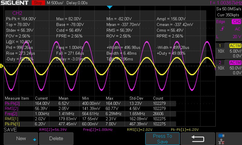

I recently replaced the original DH500 speaker protection (mechanical reply switch plus PC9 board) with a Neurochrome Guardian 686 board. It accomplishes the same protection (guards against excessive DC voltage and any sharp voltage transients on power-up and power-down) without the need of a mechanical relay switch where the contact surfaces can deteriorate over time and impact performance. Instead it uses MOSFETs to do the switching. The board also gives you the option of mounting directly to the binding post terminals that are spaced 0.75” apart. I originally intended to do that but changed mid-course from binding posts to GR Research tube connectors so I mounted the Guardian 686 board just above the speaker outputs. The board uses the DC power supply and two diodes had to be changed on the board to handle the higher voltage supply in the DH500 (which Tom Christiansen pointed out). I believe it's the first time being used in the DH500 and works great.
DH500 build(s) - before and after

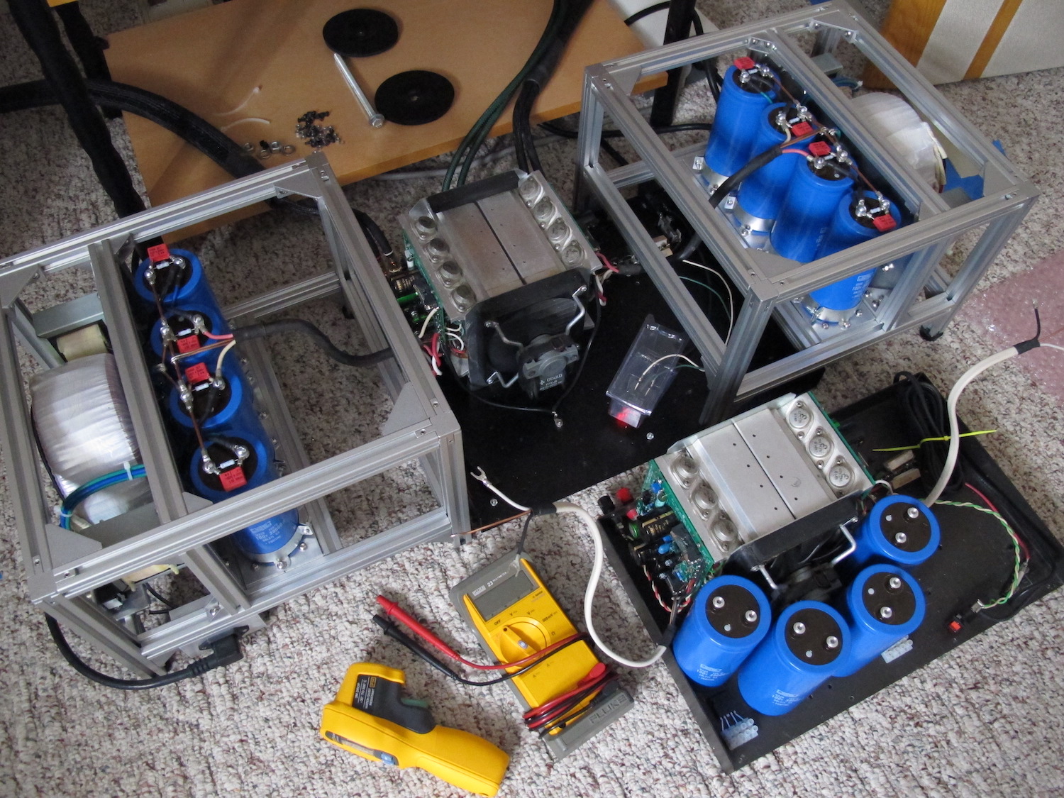

More room for improvement than for parts... Most people (too many) neglect much needed power supply improvement(s)... absolutely, the Achilles Heal of an otherwise very good amp. Sadly, people do not realize what they are missing.

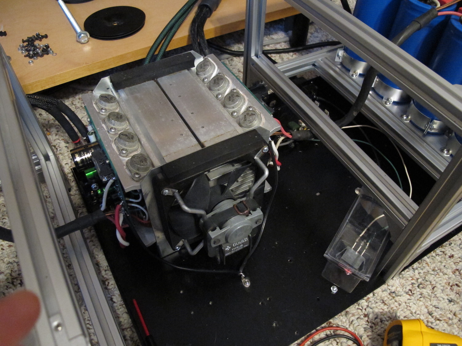

A friend brought me these 2 bridged DH-500 amps, to repair and modify, both had been badly abused... I had never touched a single Hafler amp with blown outputs. These amps were used on sub-woofer stack with 2 ohm load. The prior owner had 10 amp slow blow fuses in all 4 B+ slots. I guess he got tired of replacing fuses, killing his amps...
I was 'half afraid' to plug them in to even test them... they were that scary. These were the worst Hafler(s) that I have seen in nearly 40 years of work with an amp we would sell to customers that seem to destroy every amp they bought. EG. in the days of switch boxes, with multiple (too many) speakers connected at once in multiple rooms.
I liked the sound of his amp SO MUCH, I am building the one on the bottom [now mine, rebuilt image 2] to be just like the one I built for him with Exicon dual die MOSFETS, I think that it **out preformed my Hafler XL600 (which I am now subsequently rebuilding) I did everything that I could think of to his, and it outperformed my own amps... I struggled unplugging and delivering his amp, with did AMAZING things on my Maggies, never heard them sound this good.
Image 2 and 3 are the 500 / 600 power modules connected to my MONDO CLC power supplies, to test different amp configurations and is the **basis for my comment and comparison. The 600 *not shown, is now nearly finished, still on the workbench...
The more that I [test] "throw at them", the greater the improvement(s). The beefier P/S benefits the 'super-charged' amp module ~ and ~ the "enhanced" amp module(s) render the P/S sound quality improvements and is capable of "handling" a massive and super stiff P/S, in ways a stock PC19 PCB could not.
Lastly, these reworked amps (as shown) have the small amp finesse and delicacy, with the big amp effortless ease, neutrality that gets out of the way of the music.
