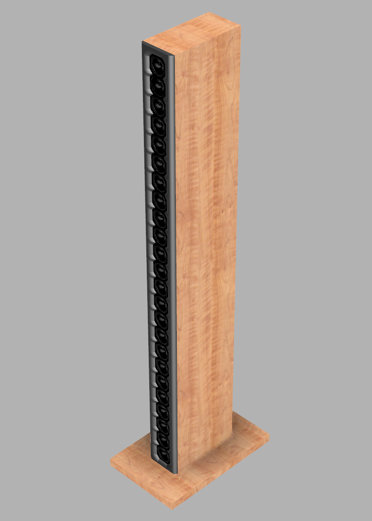

My main goals this time is to improve sound quality, by increasing numbers of drivers from 20 to 24 and making a "extreme" cabinet
The outside will be conventional with a rectangular box but the driver volume will be elliptical and the "unused" volume will be filled with "epoxy granite - EG" which is simply epoxy and sand in this case.
EG is often used for machine bases (CNC) as they are easy to cast, are dimensionally stable and also act as a mass damping device. Both attributes come in handy for my intended application.
Speaker weight is estimated to about 80+kg/side.
With 24 drivers per speaker I will group them into two lines of 12 speakers each => I need 2 amps per side. My current LA is connected to a 5x125W amp
but utilize only two of them => I have 3 channels that are unused.
With a 20% cone area increase and 2x available power I expect improved system capacity + a much improved cabinet should help even further on sound quality

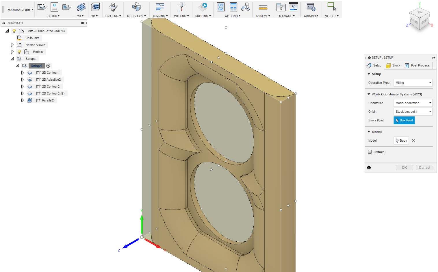

- Link - Front baffle design finalized
- Link - CNC'ing the front baffles

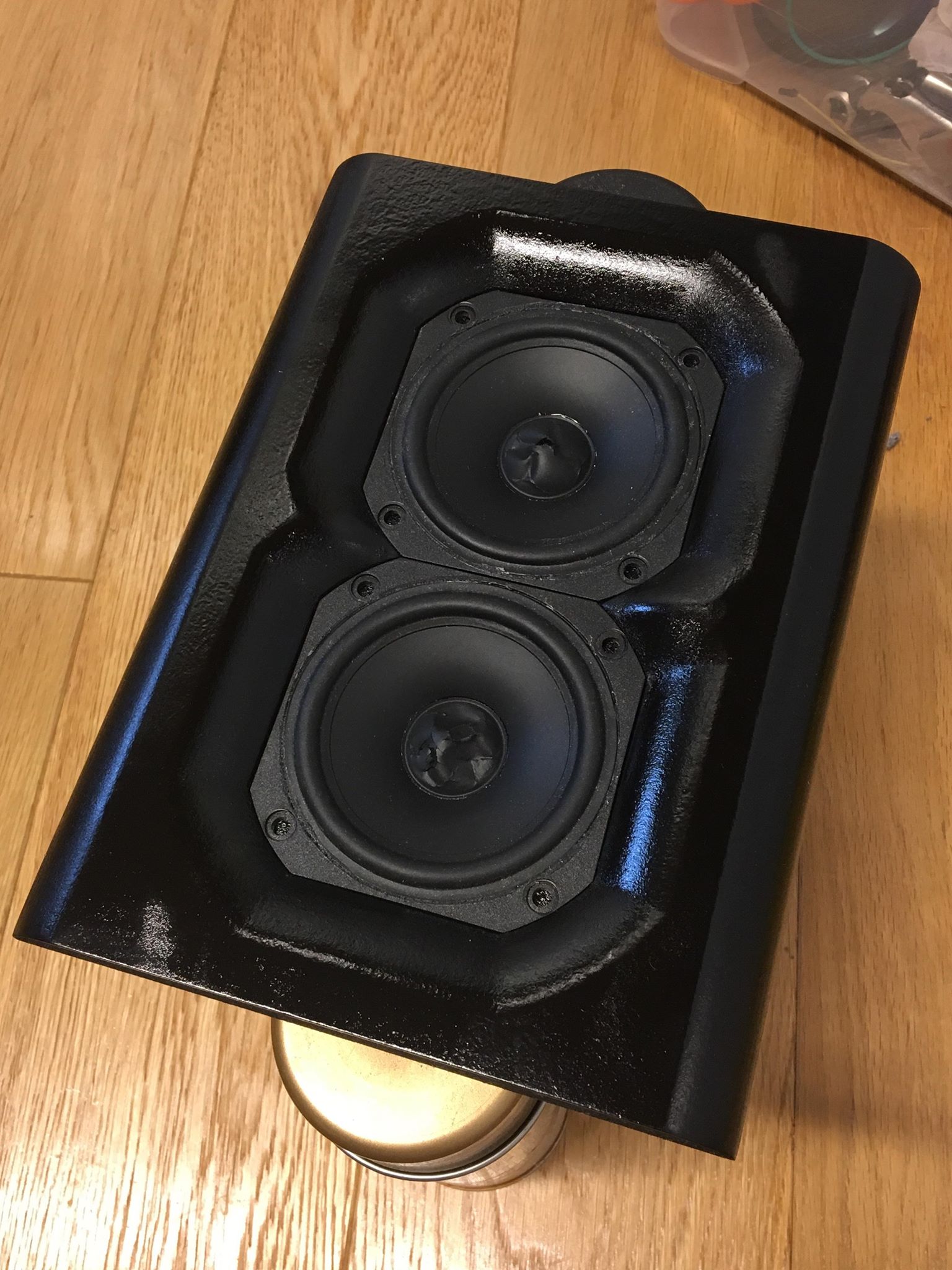

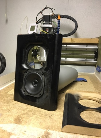

I have machined two test baffles, primarely for testing fit & tolerances but also to see how it may be finished. Test baffle is regular 19mm MDF.
Very quick and dirty spray paint applied to raw MDF, with a proper primer/sealing and black satin...it could be quite sexy...

Poor little dust caps.
Yeah, finally got to replace the broken ones with fresh stock

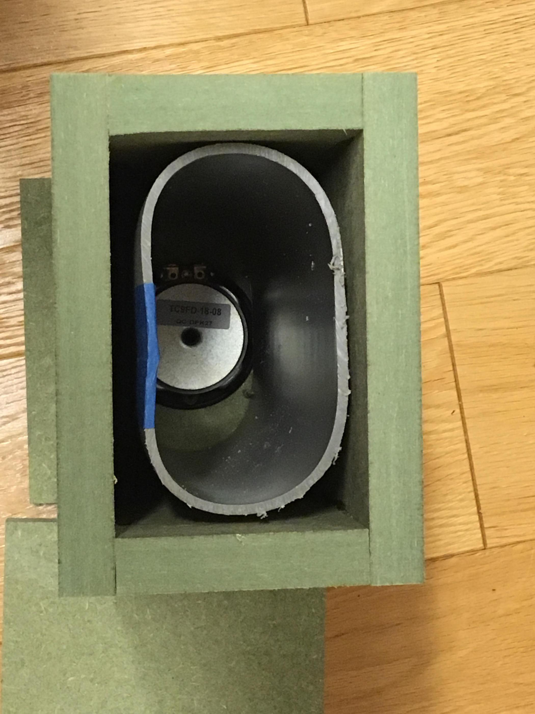

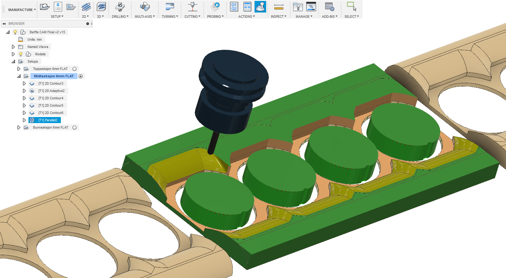

Some practical progress was made yesterday:
1 - Material for the tube tested, to see how "playable" it is regarding reshaping. Also to verify the final width when compressed from round Ø100mm to 84mm height (elliptical shape)

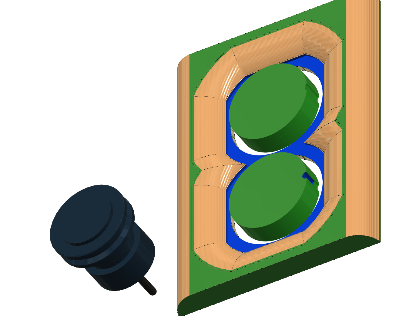

2 - preparing the cut files (CNC) for the front baffle.
Since my CNC is limited to 380mm travel along the Y-axis I need to tile the carve. The CNC is open front and back so I can feed longer material.
So the intention is a single one-piece front baffle, and the cut files are split into 3 different sections, top 4 drivers, mid 4-drivers and bottom 4 drivers.
Total carve time per baffle is approx 3hrs, I can spend less time carving but 3hrs should give me good surface finish, requiring very little pre-paint work

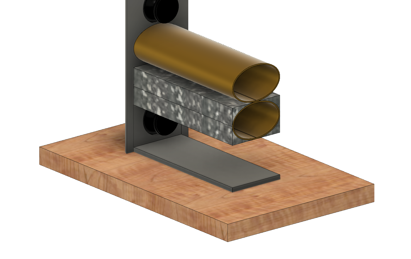

My original intent regarding the tubes was to glue them in place with EG, but it occured to me last night that I can slit them longside and simply use them for casting, pulling them out after the EG have cured. This will allow for more EG but more importantly - a single EG matrix per array vs 4 cells of EG per speaker. The EG wont conform easily when cast thickness approach <2mm.

I'm wondering why you don't opt for a back mounted driver... as now the baffle is protruding beside the frame, not really forming an extension/wave guide shape.
It doesn't even have to be back mounted if the baffle is split up (like I did).
Have you tested the off axis performance of this shape?
I havent really given that much thought so far, the thickness of the material is what pretty much dictated the overall "waveguide shape", no acoustic considerations have been done yet.
For my first LA I didnt do any testing prior, just built it and use them, but I will test this one, both in terms of impedance and off-axis response.
The only way I can rear-mount them would be with a similar arrangement to yours, a clamshell setup.

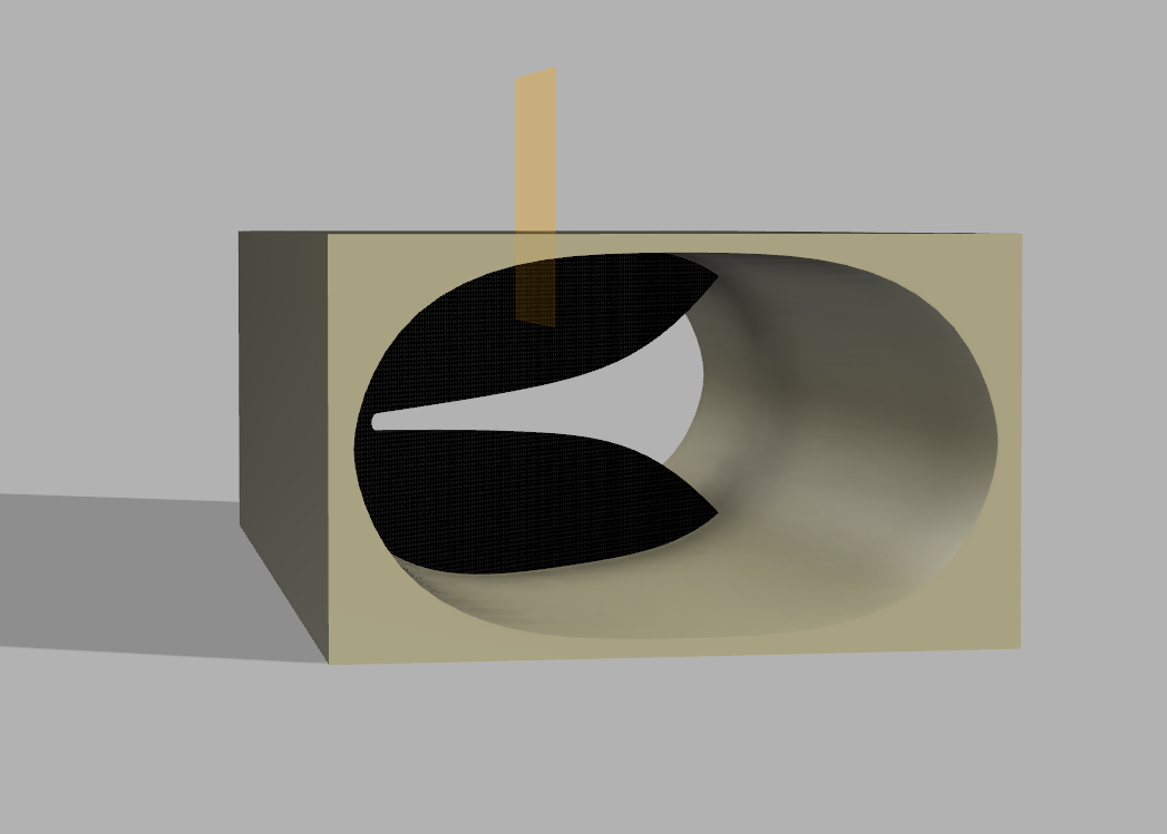

Not a lot of playtime today but made a forming jig for the chamber molds and a mock-up of the diffusor plate.
The diffusor will be CNC´d out of 6mm plasterboard and lined with foam/felt.
Main purpose is to break up the rear wall reflection by diffusing/dispersing the timing of the waves.
Also traced the actual and final shape of the chamber form so I could do the length calculations.

That's a Karlson aperture inside the enclosure? Interesting.
Yes it is, main intention is to break up the rear wall reflections by diffusion
It is
Construction of test chamber complete, casting epoxy / sand during the weekend Then impedance sweeps can be made to finalize stuffing ratio in front of/rear of diffusor plate.
The longside slit in the plastic tube is to help prying it out after the EG matrix have cured. So the test cabinet will also be used to verify method of construction..! Rather fail to pull this one out vs the 24 next ones!!
