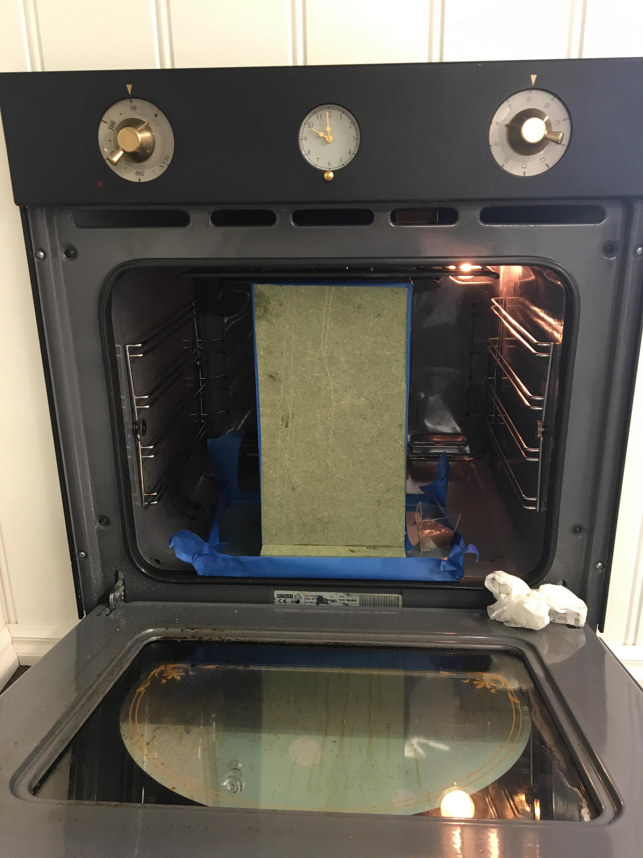

Todays efforts, baking time!
1660g EG, 125degF for several hours 🙂

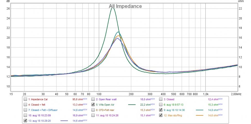

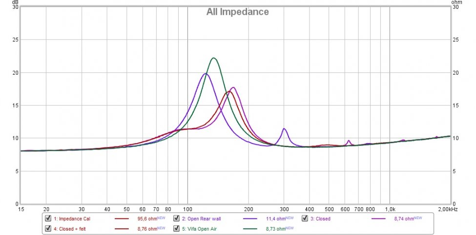

Okay, test rig completed and seem to be operational - this is no quality test performed just a quick scan to get baselines and data to learn from.
The cabinet is not fully sealed, neither at the driver side or rear wall.
Time to read up on how to "read" impedance plots, I mean they read resistance but how it all connects 😕😀
The Magenta trace, open back, is showing extra peaks at harmonics of the fundamental resonance.
That is how I interpret the plot. The two sealed plots dont show this cavity resonance. Stuffing the open back version to varying degrees may help damp this resonance out.
That would be a good test...
How much damping to eliminate those peaks?
Seeing as there are two magenta traces, its confusing to look at.
The Fb has dropped from Fs due to air mass loading the rear of the cone, but the column of air is resonant. Damping rear should help damp that out

Okay, the driver have been sealed properly and same is the rear (removable) back wall.
I briefly tested with diffuser with/without other stuffing (interior lined with felt on all)
This should be considered the first "valid" set of sample data.
attachment.php
To really know/learn what's going on, don't be afraid to zoom in on the plots.
You're looking to get the least amount of wiggles from the peak value and above.
Open air looks nice and clean, now zoom in on the 150-2 Khz to see from 6 to ~16 Ohm.
The better damping will show the least amount of wiggles. That's what we're after.Every wiggle could possibly lead to a FR anomalie (dip/peak). Use the Vifa open air as the reference. The Max stuffing seems to look good, what stuffing? I'd expect a max stuffing to shift the peak to the left (lower in HZ) a bit. The itchy fiberglass does that quite well. While a layer of felt generally lowers the wiggles by quite a bit. That combination worked best for me. While on this scale everything looks fine, don't be afraid to zoom in a little closer. Like I said, felt on walls and itchy fiberglass (loose but kind of filled) in the open middle works wonders. Keep the back side of the driver free. I have a layer of felt there between back of driver and the fiberglass fill. About ~ 1.5 to 2 cm free air between back of driver and that felt layer.
Thank you Ronald, I will visit this aspect of the build several times before they are completed 😀
Tested a little back and forth today and the diffusor dont seem to smooth out for me, it causes the peaks to be a little "loopsided". In terms of peak symmetry and lack of wiggles it seems to be a KISS=better scenario.
Interiour fully covered with felt and various degree of "itchy stuff" placed inside seemed to be the cleanest. As each driver will be a closed chamber I can later test each driver individually, so if I decide to go all-in I might opt to tune each one individually so they all are as close as possible. Its gonne be a FUN fall/winter :hphones:😱

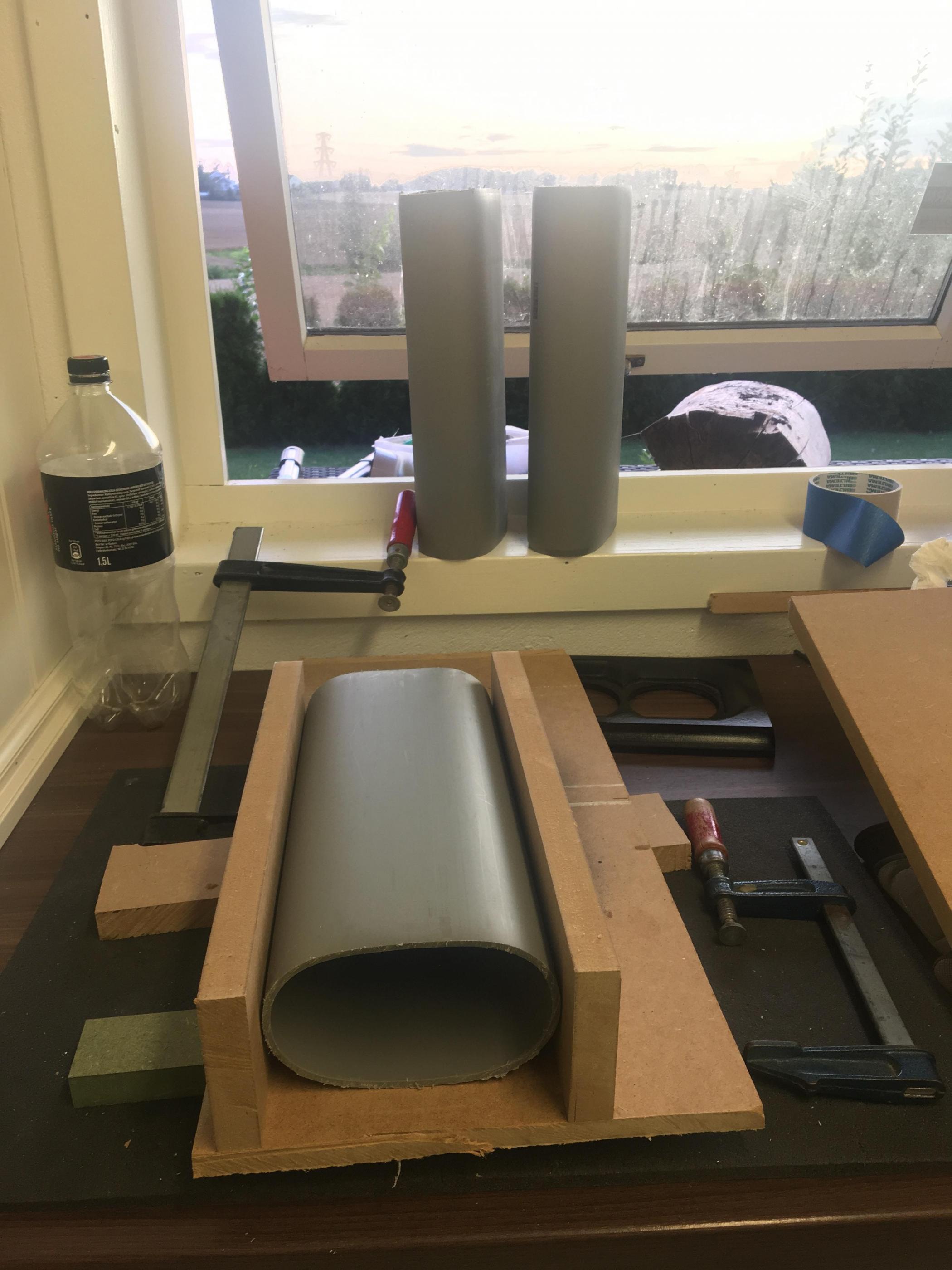

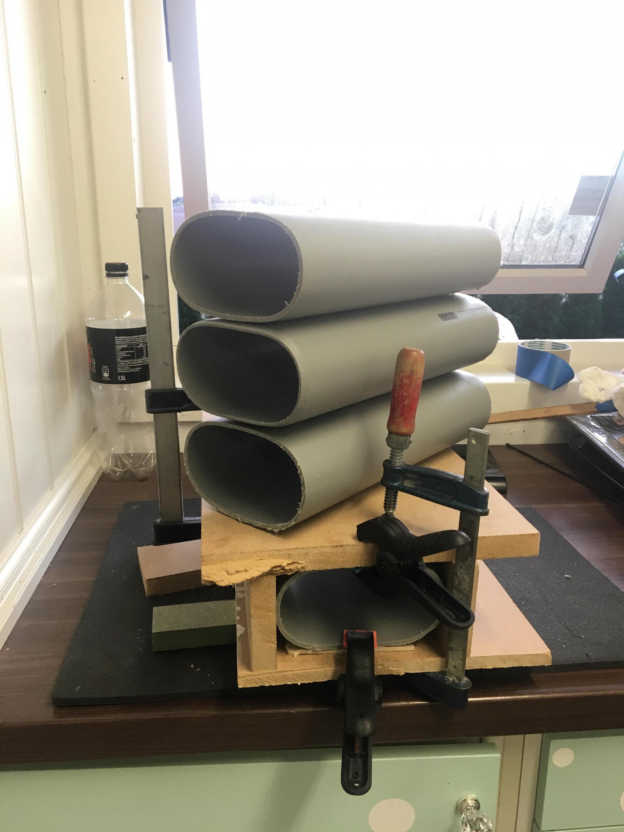

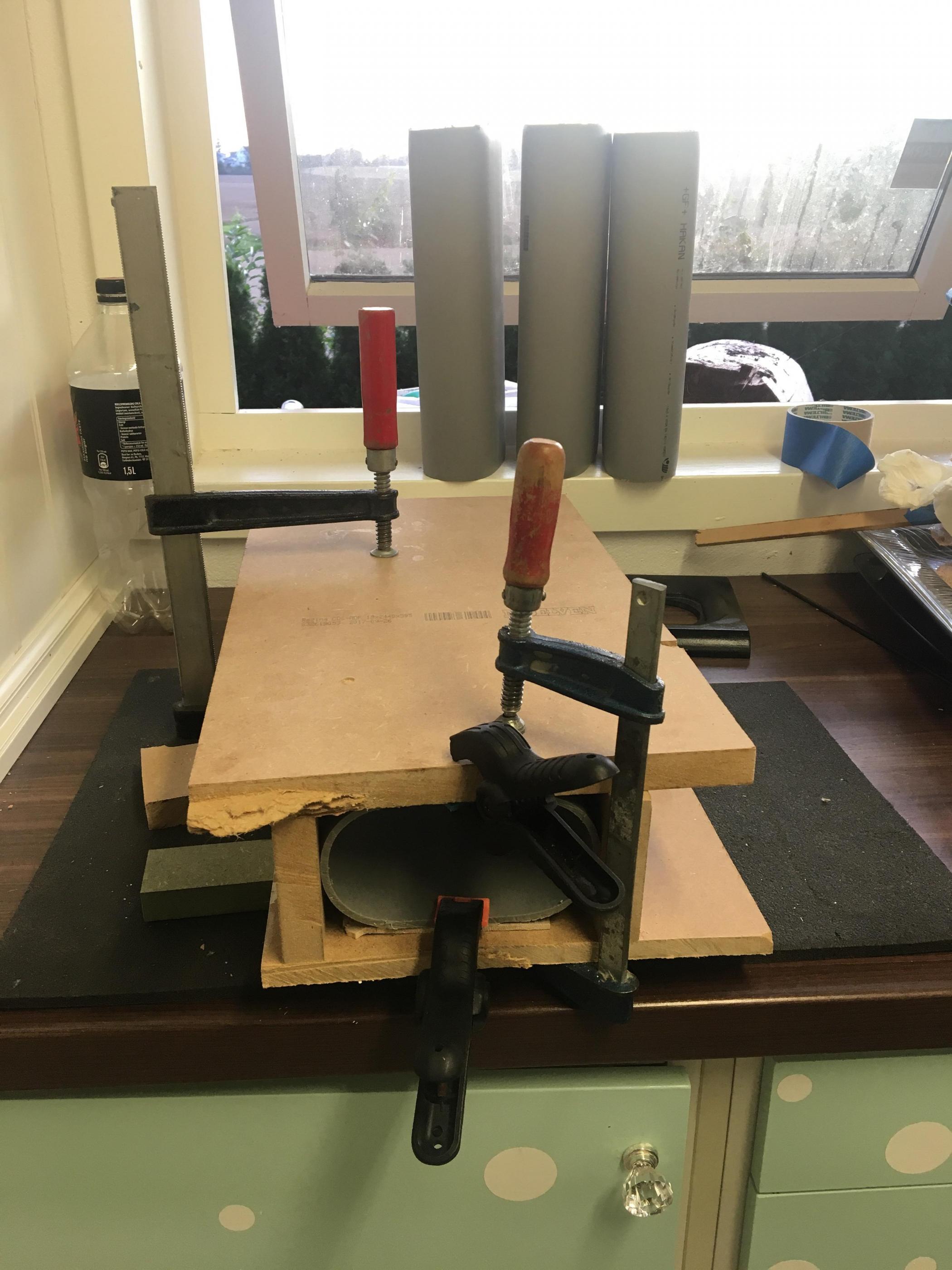

A couple of pictures from today test run forming the casting tubes:
The last one is especially enticing, resembelling a "top fuelled" compressor intake 😀 Can´t wait to stack 24 pieces of these up... 😛

Minor update, image wise not much progress to show for but:
  1. Currently tweaking the pipe shaping to get a uniform thickness of each section, I have 15 done, 9 to go.
  2. Bought hardwood flooring, which will be stacked horisontally and act as cabinet sides. 15mm thick vs MDF 19mm = close to a 10m slimmer cabinet.
  3. MDF sheet purchased so I can CNC the front baffles during september.
Test piece of the stacked floor tiles look good, so I'll do the remaining 3 in the next few days. Gross dimension is 340x2340mm which will allow final cut-down later.

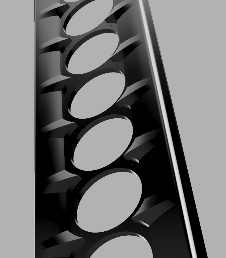

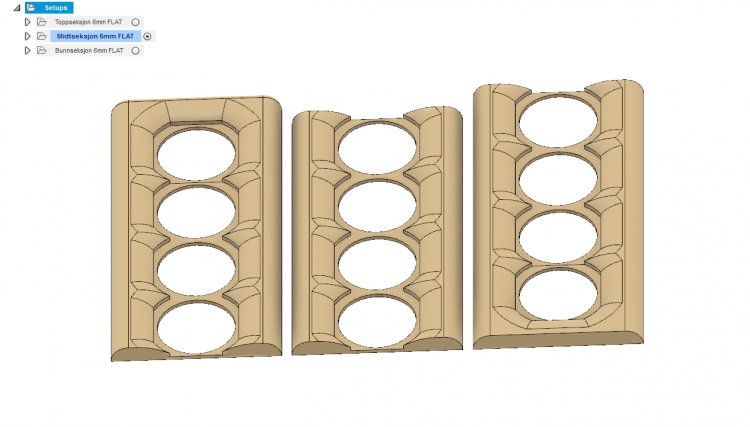

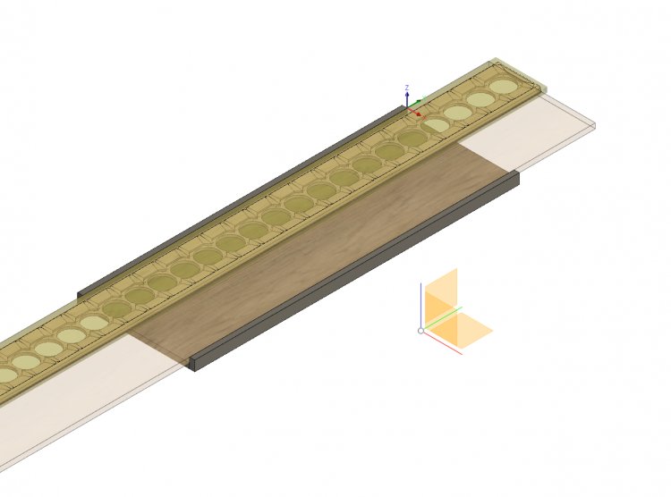

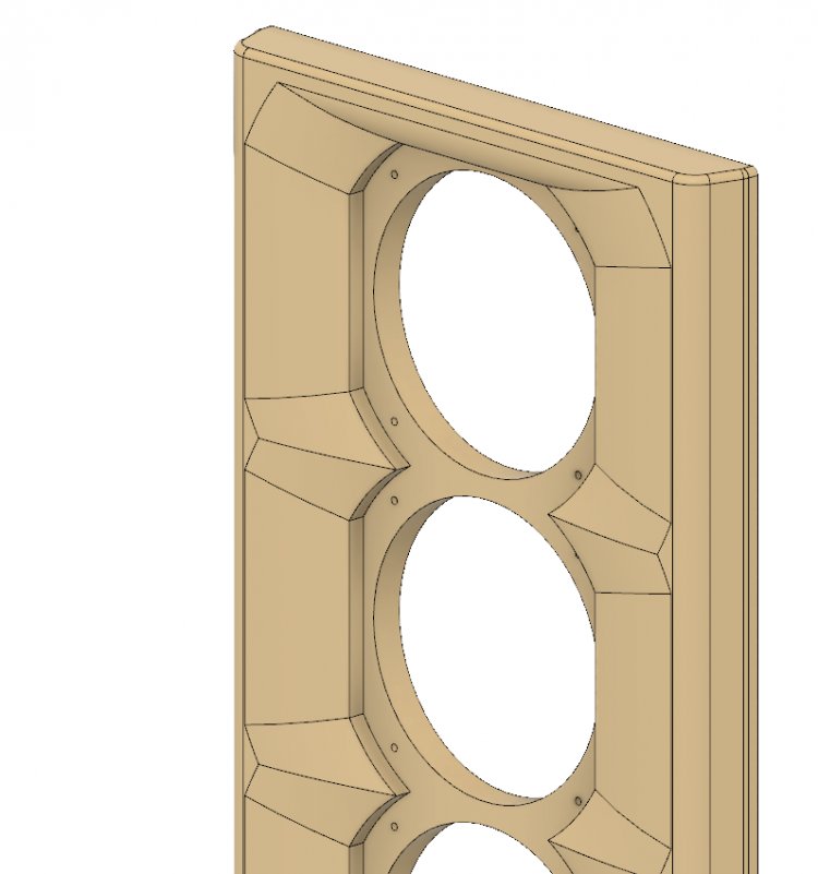

After being away most of the past couple of weeks I am back on it 🙂
Decided to redesign the baffle with shallower (larger radii waveguides) pockets for the drivers and add some angles to the outside edge vs the continous radius I had previously.
Yesterday I also finalized the three CNC-programs needed for the long, tiled carve. Top/Mid(x4)/Bottom section.
A jig and alignemnt pins will make sure the intersections are carved at correct length offsets and kept straight.
If I am lucky I may get the first done this weekend 🙂
Video of the CNC-simulations at high speed, real carve time is approx 30min per section (6 needed for each baffle):
YouTube
(First two motions are pecking operation for the alignment pins)
Image show front baffle rendering, I am leaning towards satin black or satin dark grey:

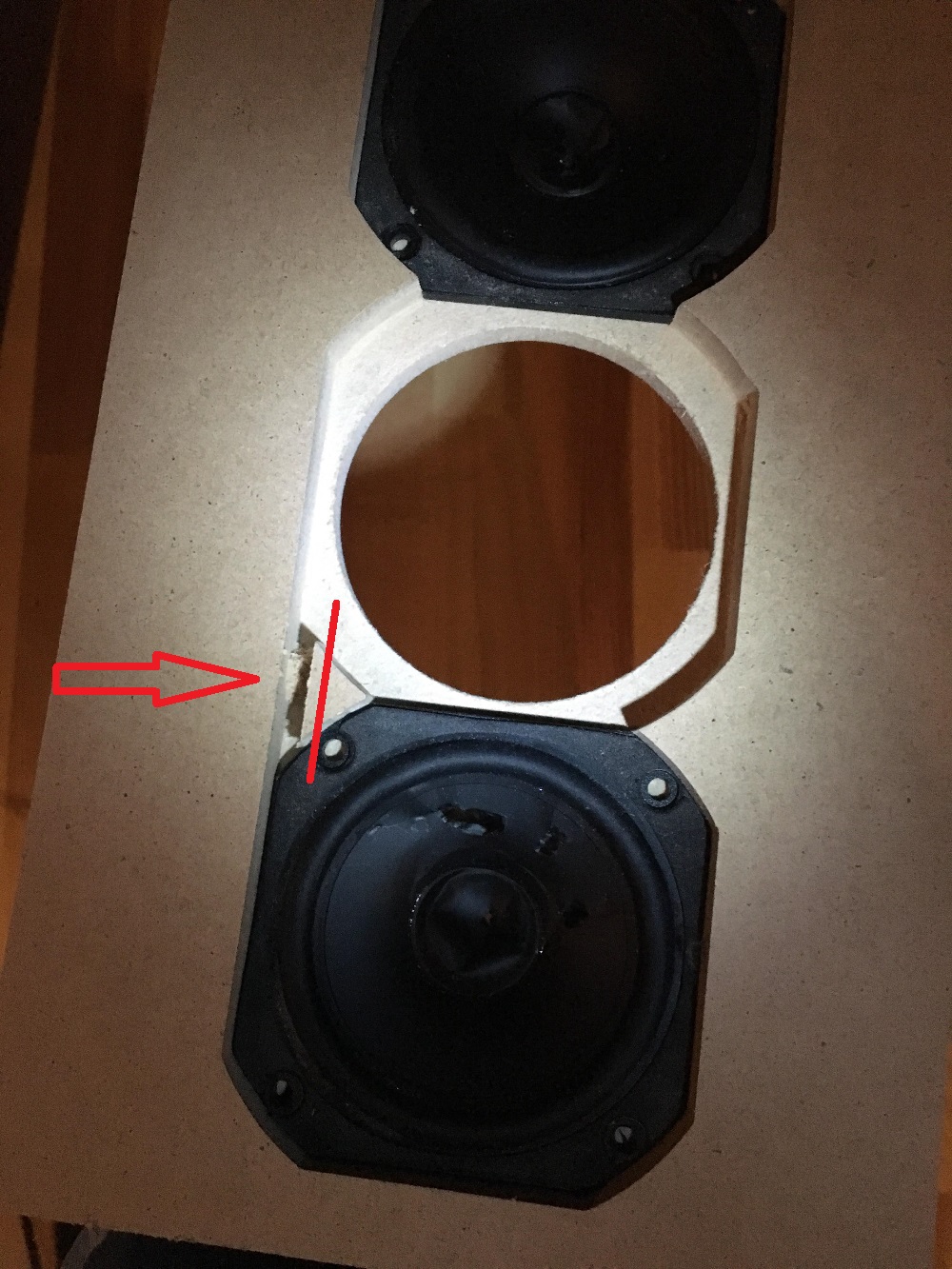

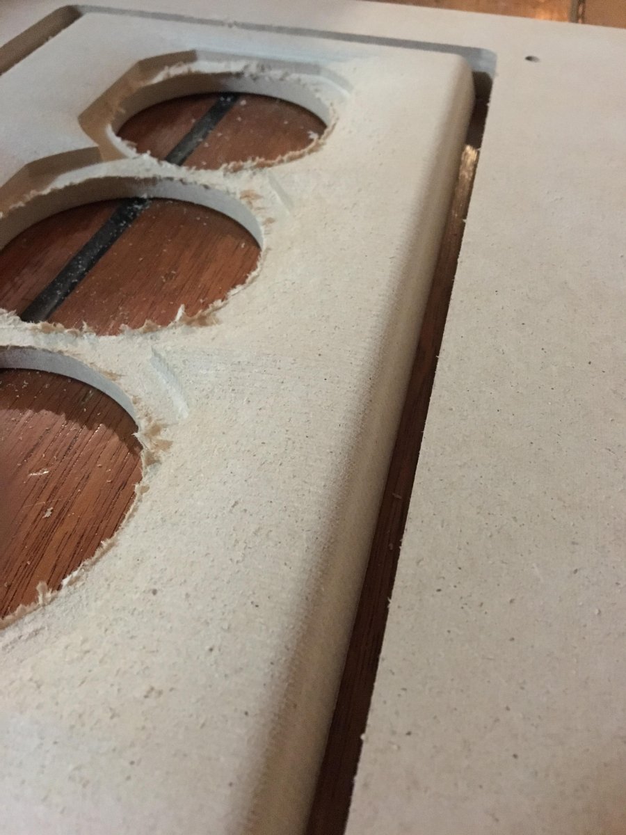

Partial progress, another issue to deal with 😱
I ran a full baffle yesterday, with no surface contouring for the lower 5*4 sections to nail down my workflow.
My machine code however have a bug I need to deal with - most likely a motion command that is misinterpreted by the controller. See picture.
It happens for the 2nd driver on the right side on each section of 4. Since the error is relative small, and hidden by massive amounts of MDF-chips I didnt notice untill I test-fit the Vifa's.
Good thing I didnt do the surface contouring 😀

Another picture highlighting the flaw, it occured for each of the 6 sections that I carved.
I also have a 2nd bug that happened between the two lowest driver openings.
Already preparing a new set of machining files that will be individually tested on some scrap MDF 😀
