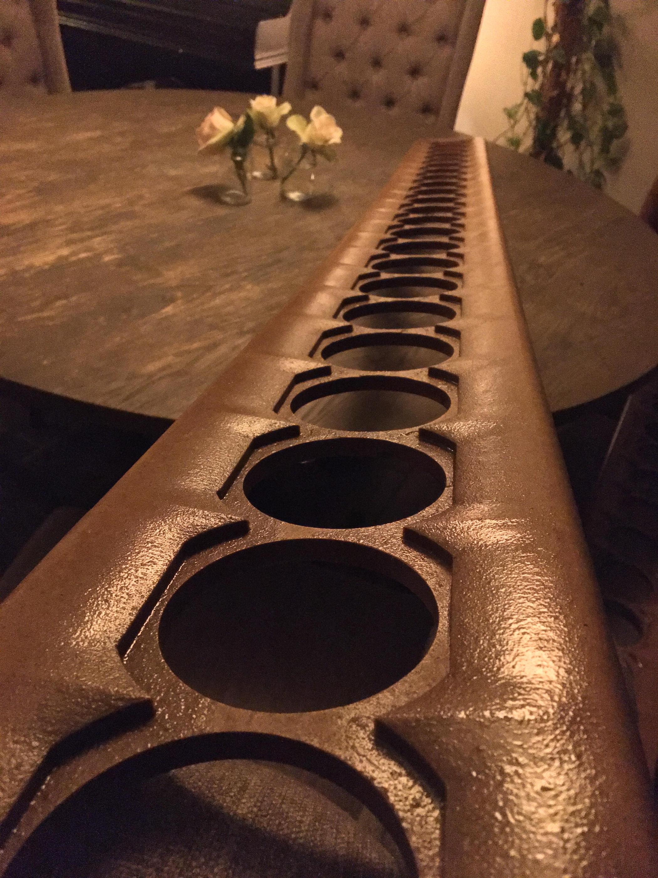

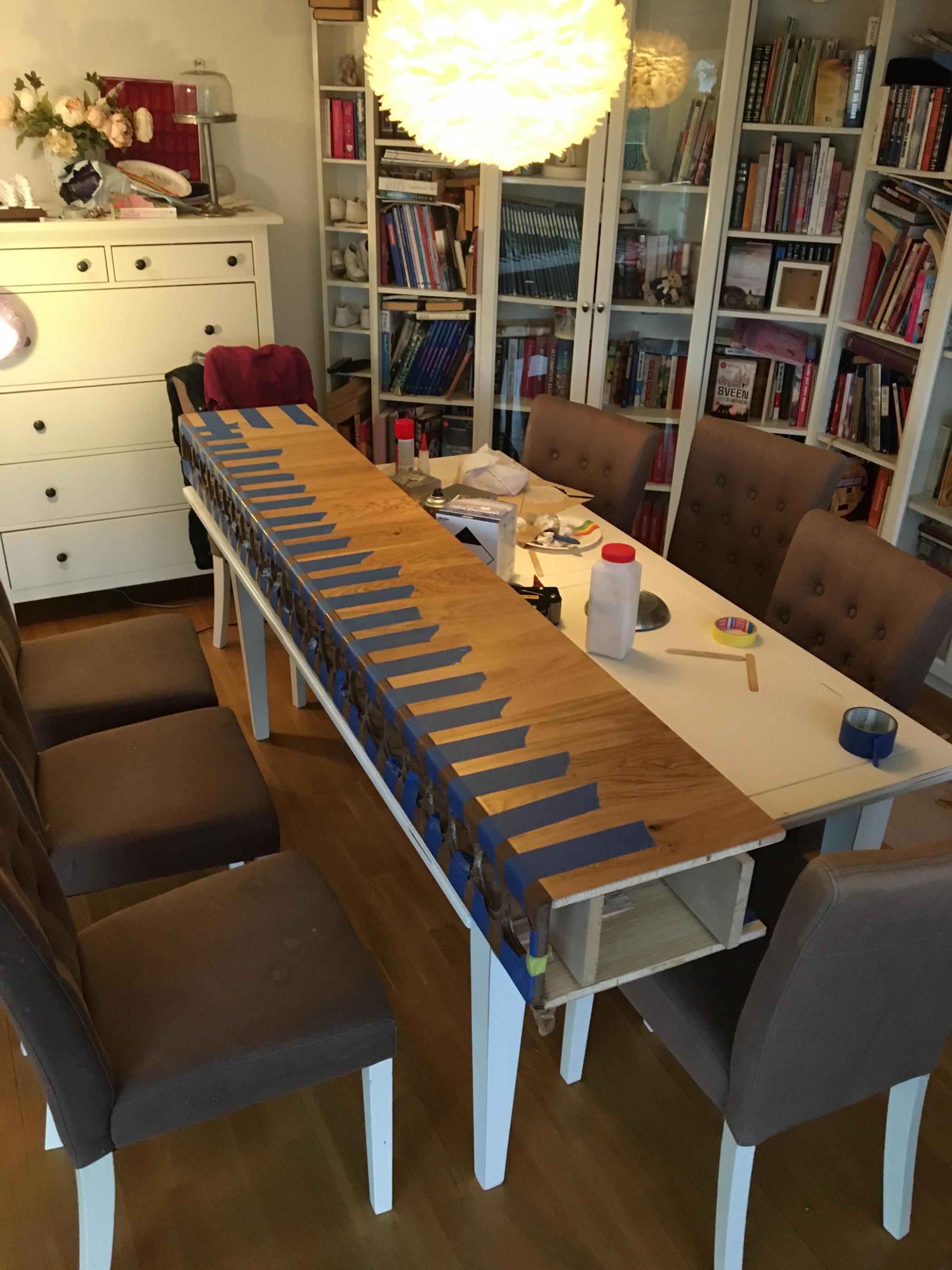

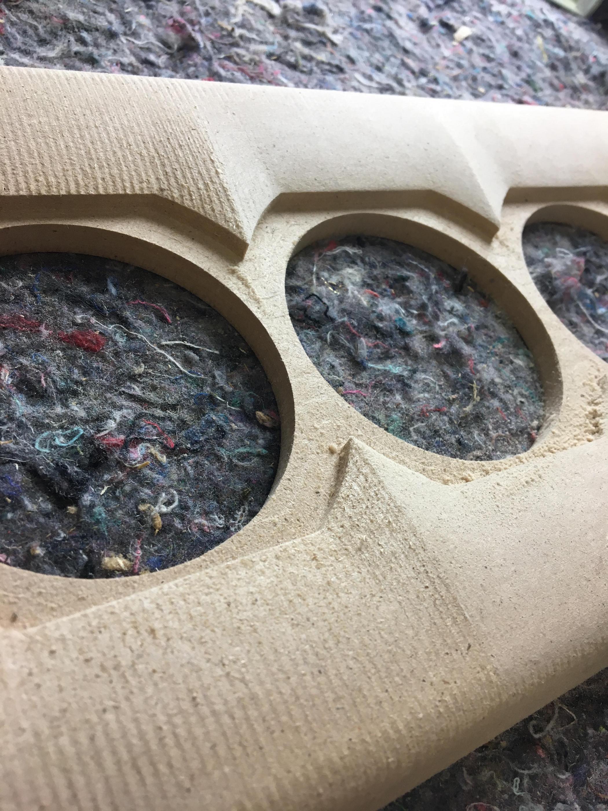

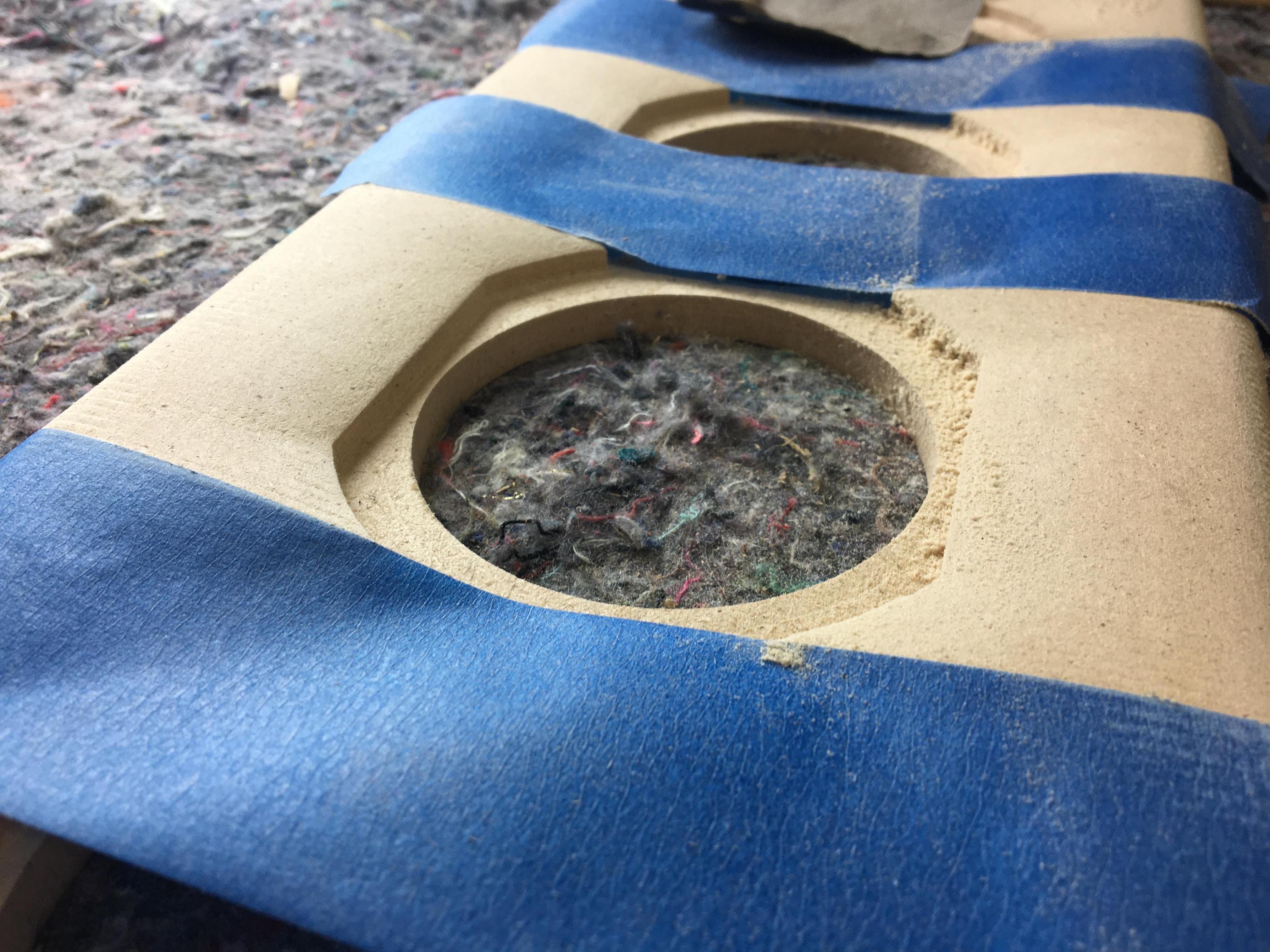

Some progress:
Last night I sanded the first baffle and tonite I gave it its first coat of primer (epoxy). Also managed to do the sanding on half of the 2nd baffle, which will be completed tomorrow + its 1st coat of primer.
Masked each adjacent driver when sanding, trying to preserve as much as possible of the sharp "edge" the profile have.

I have today managed to prep and 2nd coat both baffles which right now is curing downstairs 🙂

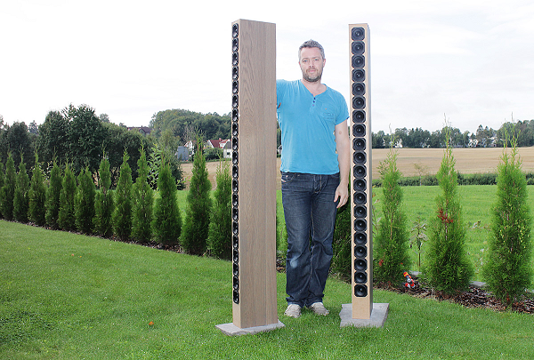

BTW - Seeing is believing, tall and slender she is 🙂
210cm tall, 17cm wide and 35cm deep.
