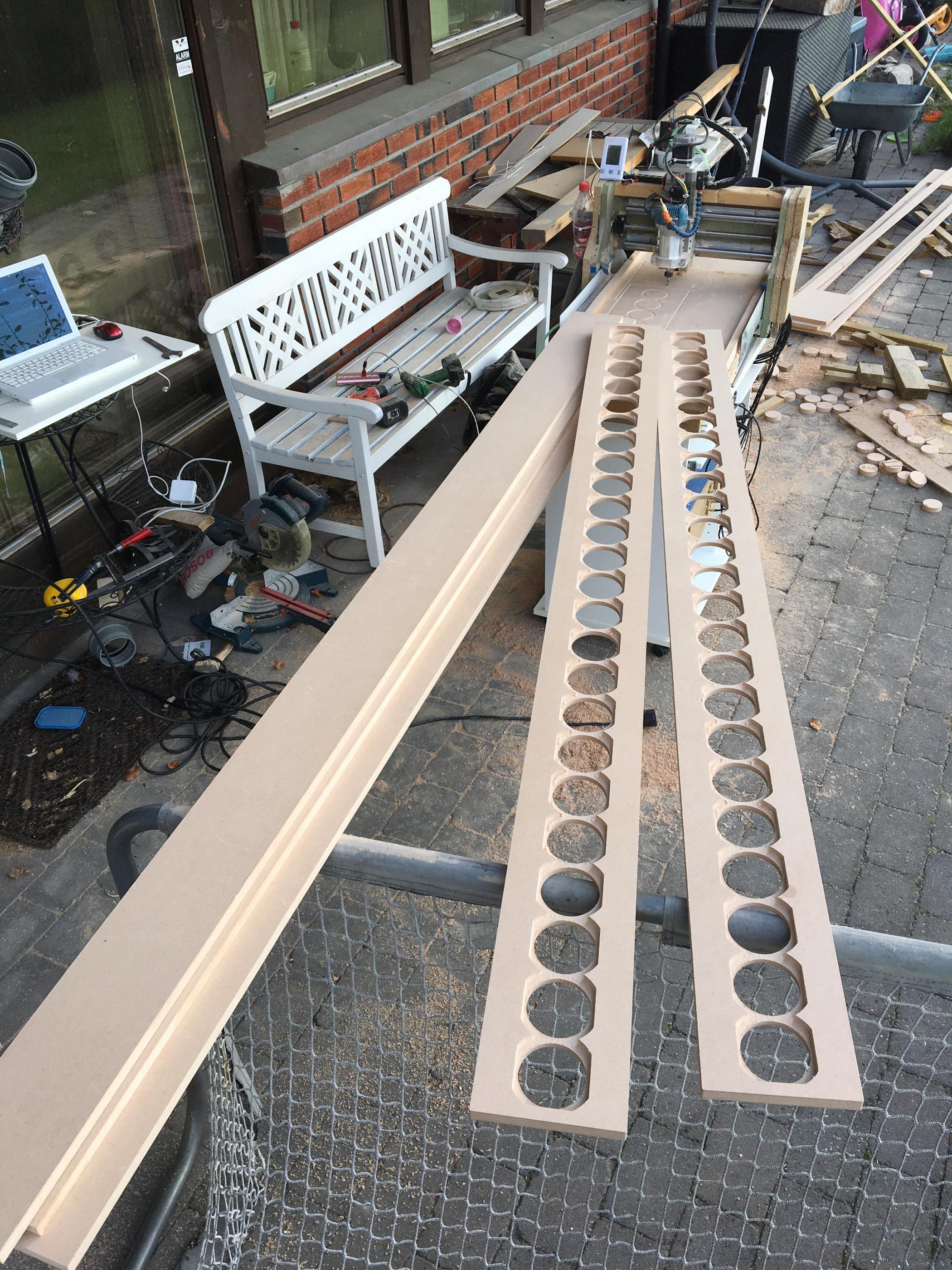

First CNC-stage completed included cabinet rear walls.
I had a CNC-crash again today but managed to abort it in time, no damage done to the router or baffle - phew!
I experienced some binding on the CNC Z-axis (up/down) causing it to loose position. I need to trust this axis when I will contour the baffle surface so time to go it some TLC. MDF chips/dust probably packing up in the bearings...
Anyways, first stage is complete with 2 baffles done and 3 precut rear walls.
The rear walls are 137mm wide, the baffles are 168mm and sidewalls 15mm. This give me a 1mm room for glue etc.

Must be exciting each time you start a job 😱
The CNC have "homing switches" which syncronize machine with design, so with that as a reference I can re-home to re-establish design sync 🙂
(within precision of the switches) As it happened today I was imideately able to power down the router, preventing damage to it which did happen last time three weeks ago. The machine itself is not strong enough to destroy itself LOL 🙂
When a stepper stalls there is a specific sound to it, so keepeing my "ears on it" with my hand close to the panic button....I also slowed don the rapid and accelenration rates for that axis giving me less chance to stall / more time to react.

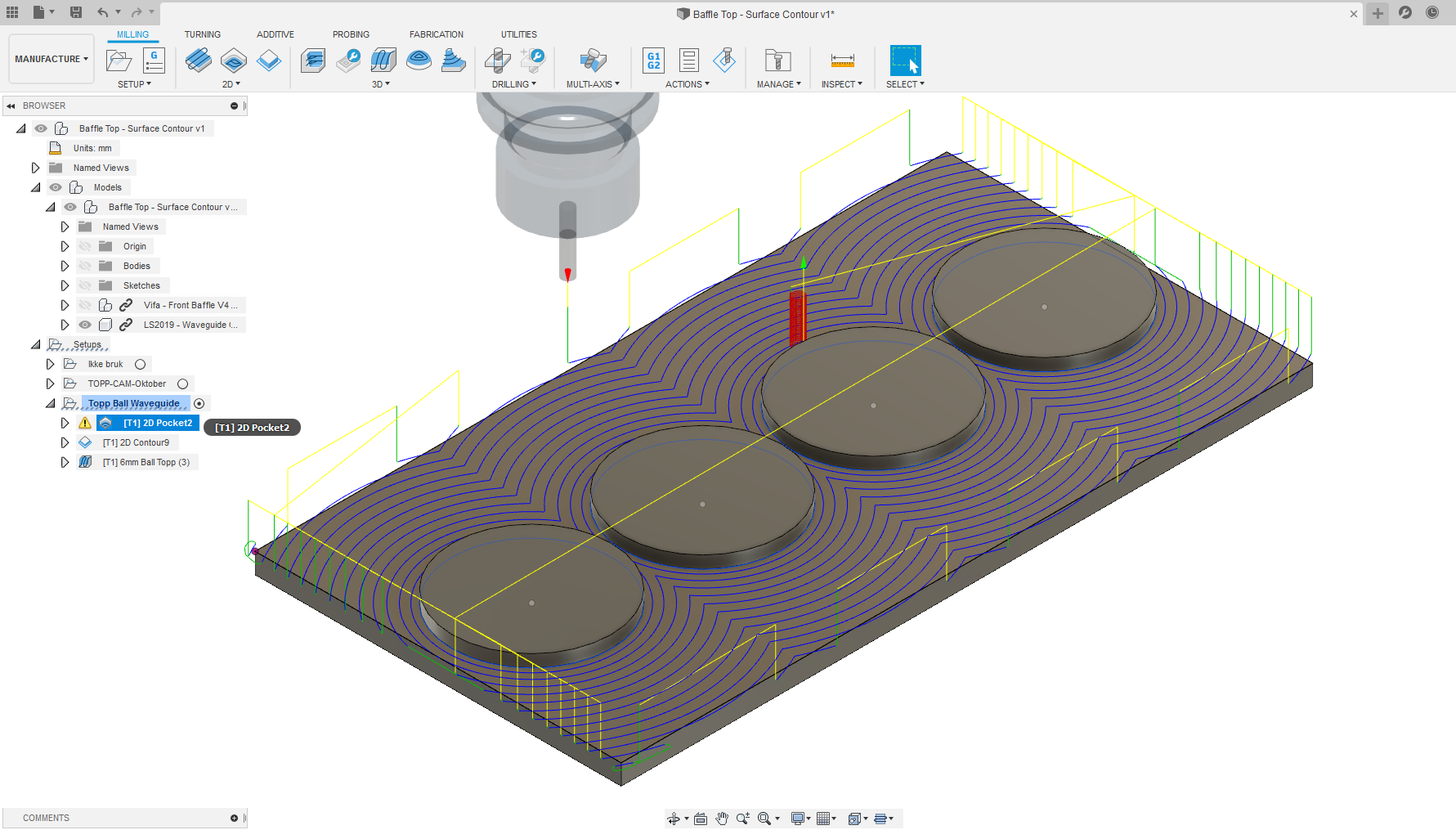

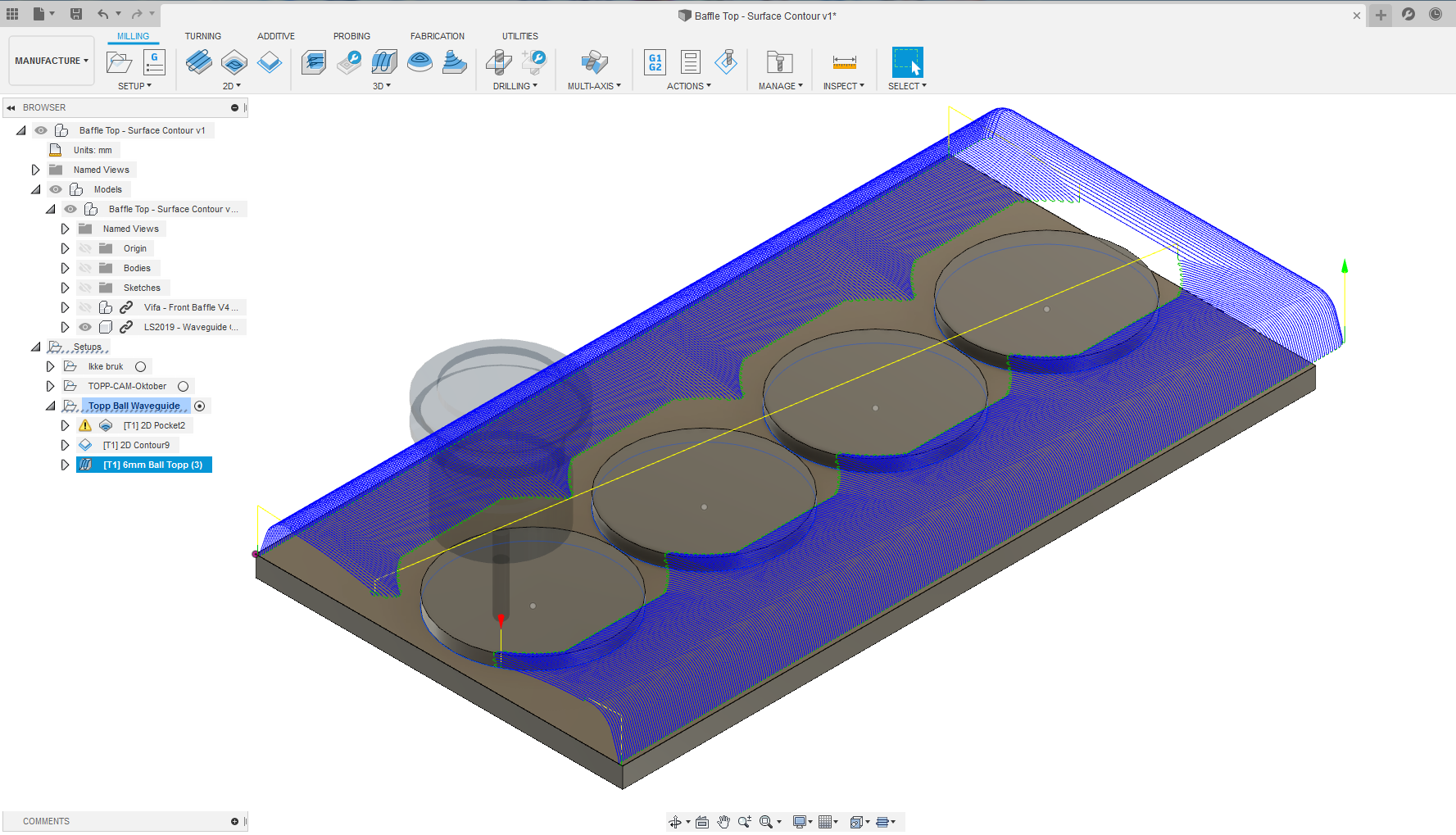

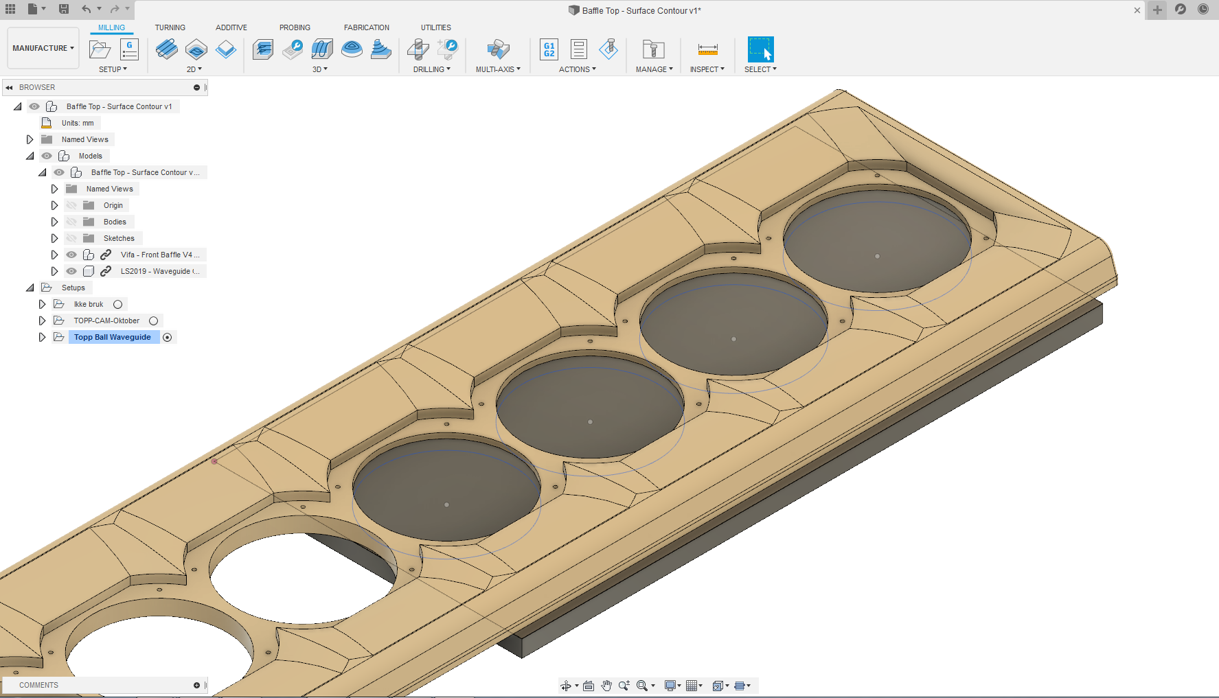

Some progress is made, the files for contour surfacing the baffle I need an arrangement that keep the precarved baffles aligned with design/3D surface.
In order to efficiently do that I opted to make a "driver opening negative" that I can mount the precut baffle over.

Some progress 🙂
First baffle has started its "face surgery" procedyre, contouring of the waveguides. So far so good... The upper 8 driver openings are done and here its mounted in preparation of the 3rd.
As I can only do 4 drivers at the time I needed a fixture to make sure I kept it all in alginment, so a driver opening "negative" fixture plate was machined.
Two sections done, four to go for the first baffle, scheduled for later today.

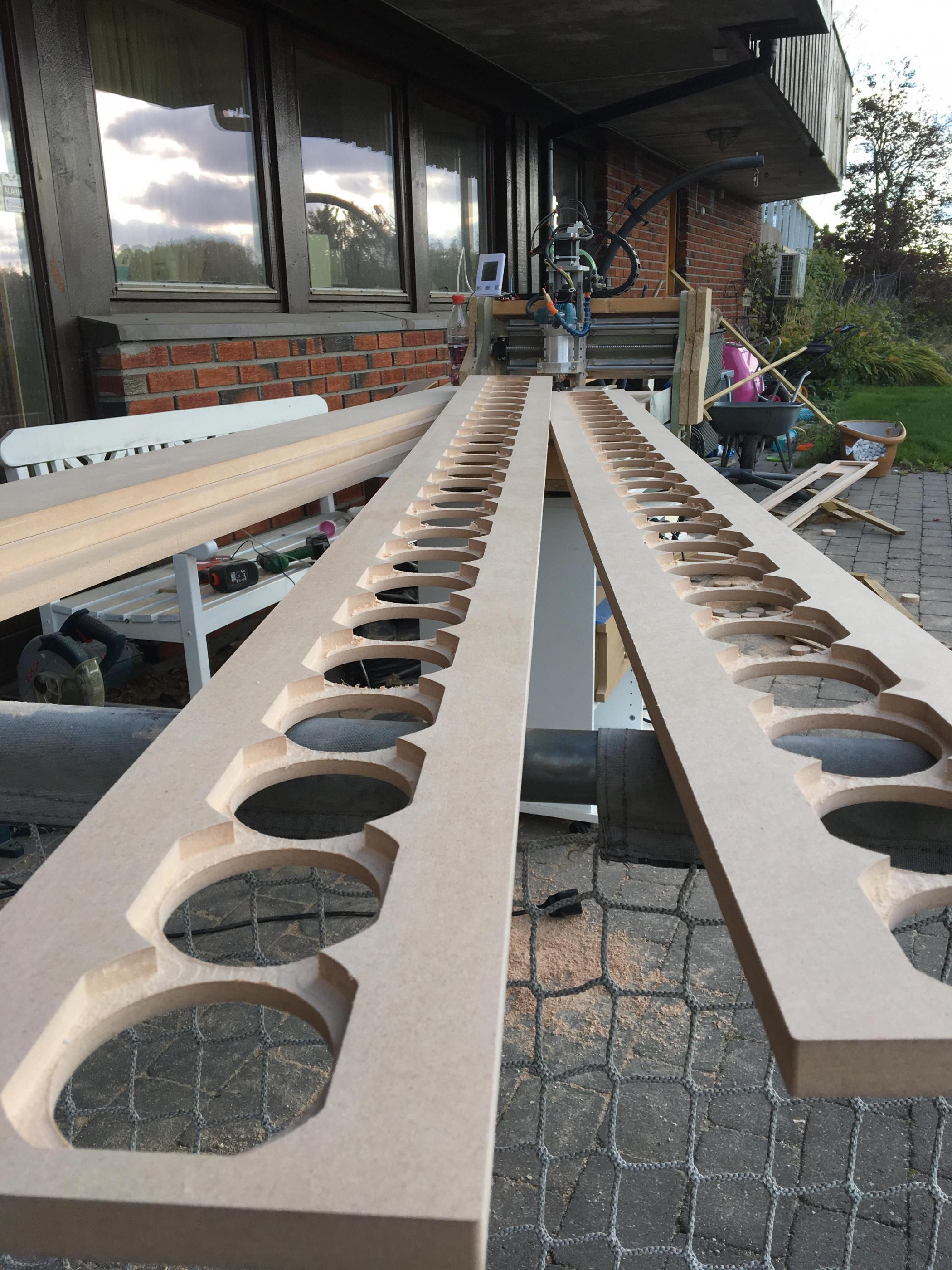

Phew..... first baffle fresh out of the CNC-machine 😀
I am extremely happy that it came out this good, after having mechanical issues, router break-down I was feeling very anxious and baby-sat the machine during the final stages for baffle #1.
It came out goooood 🙂

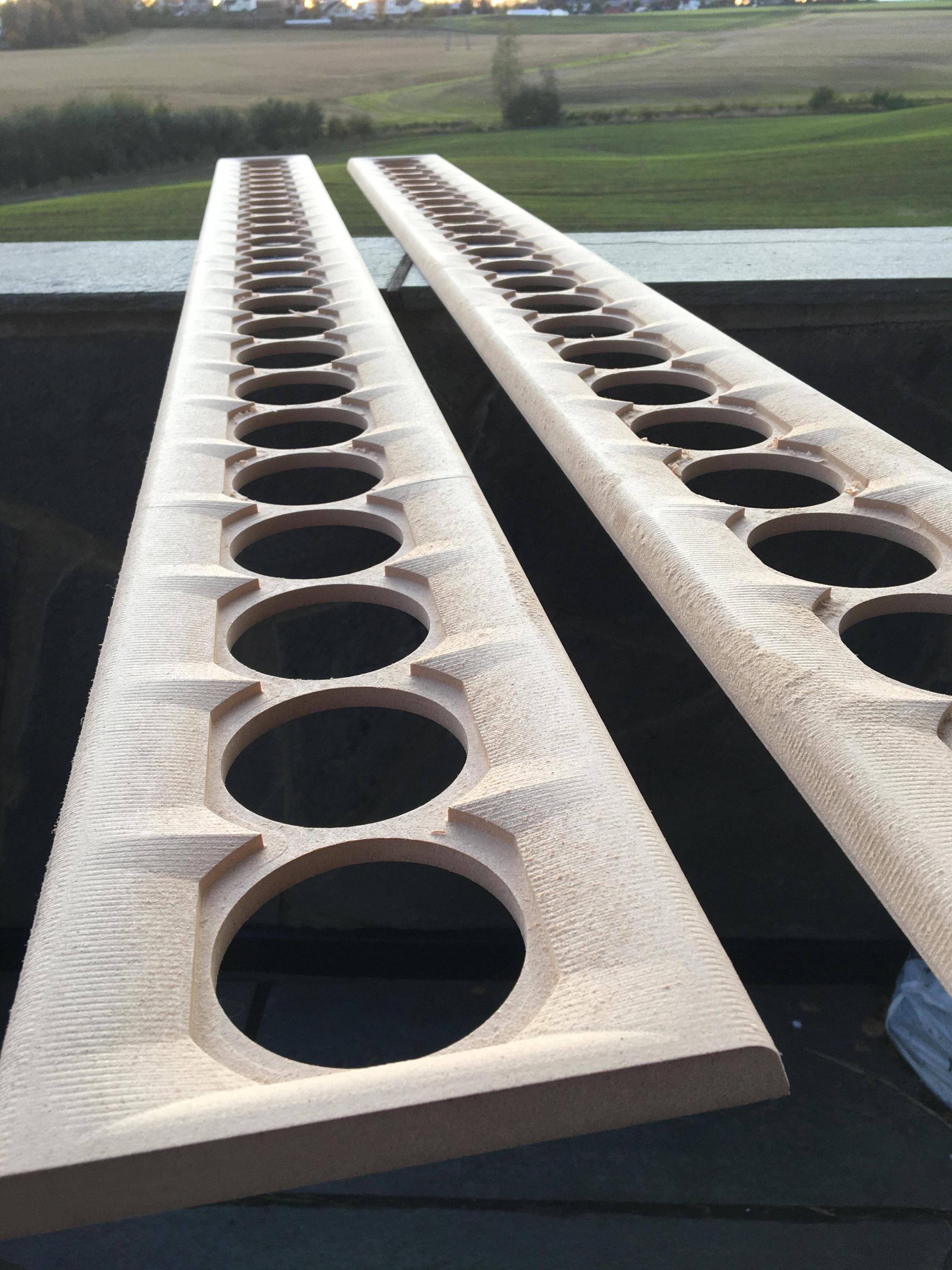

The baffles are done, no more CNC´for these 😀
Here is a slow-mo video clip of the final baffle - YouTube
Photo of the pair, it looks much coarser on the photo in real life. I could have machined them to with much finer resolution but => a lot more machining time (and possibilities of failures..)

Looks great! wondering how much machine time you have invested in them.
I would have liked to do something like that myself but its too much when paying an hourly rate on someone else's machine. So I settled for surface mount drivers and CNC drilled pilot holes for the mounting screws and a bevel in back cut with a V bit.
Early on, I did some AxiDriver sims that showed this kind of surface sculpting does make a difference in the top half octave but especially for rear mounted drivers.
And the other thing was worrying about having enough material left after sculpting to keep the baffle in one piece until final assembly where it would be braced.
Based purely on Fusion360 carve estimate the total machining time per baffle is 3hrs. 1hr for the cutouts/openings and another two hrs for the surface.
Time for preparation/setup/fixtures/cursing etc probablya bit more 😀😱
When I buildt my first pair CNC wasnt an option, so I went with drilled holes/raised mounting/chamfering from the rearside too.
