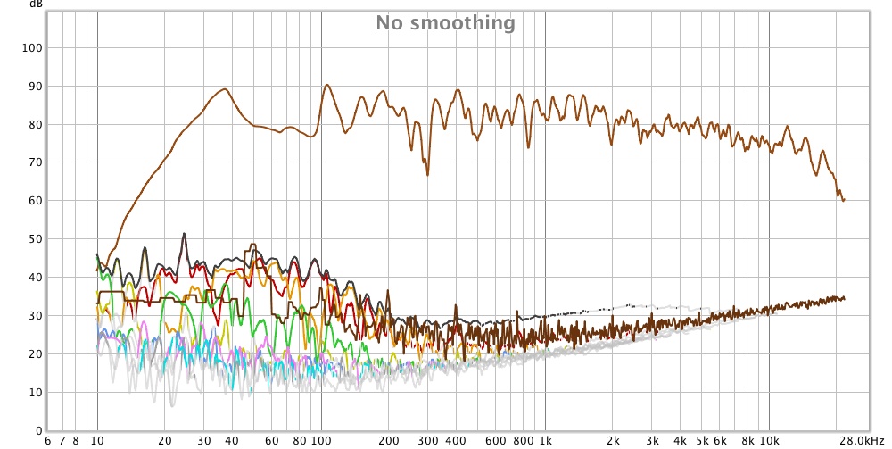

Pulled out REW to get a baseline before I start any serious EQ efforts.

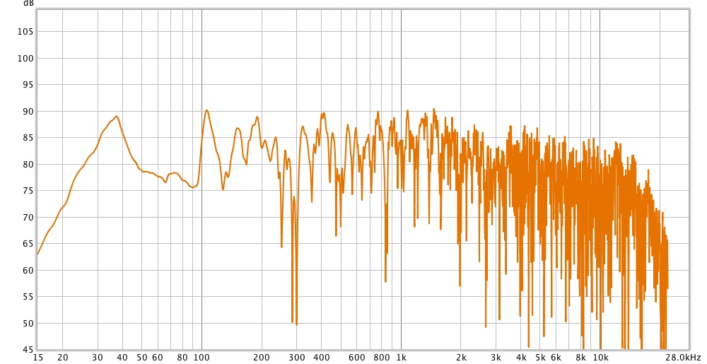

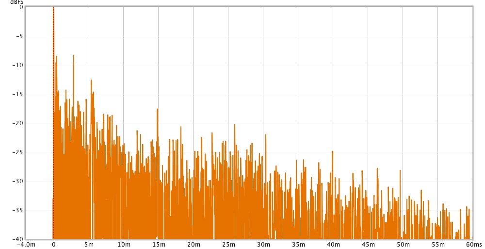

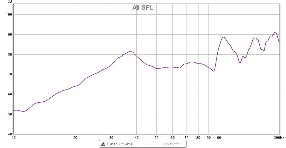

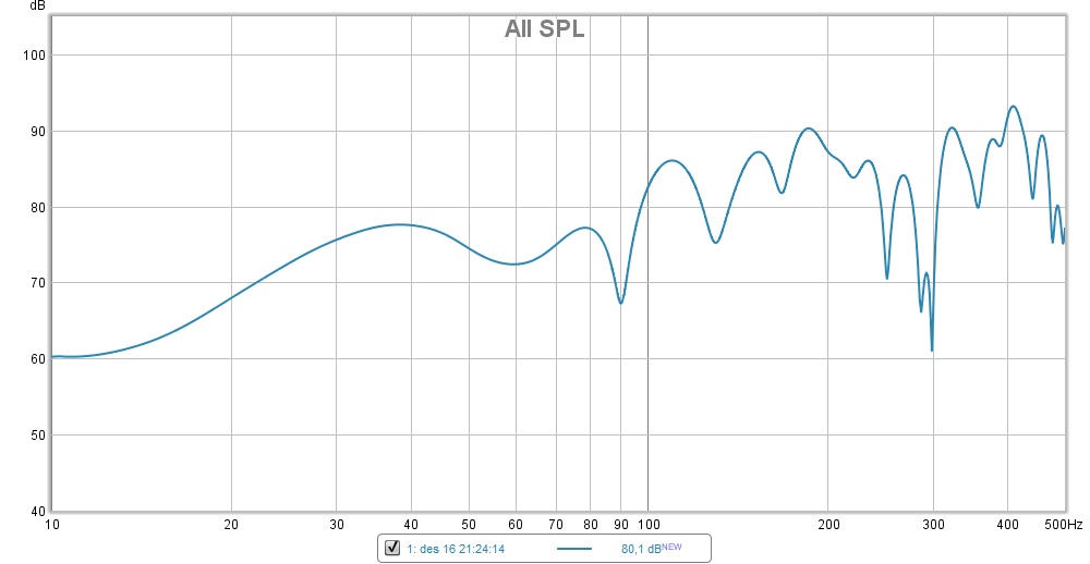

Here is a non-EQ 10-500hz sweep, with 50 and 500ms IR gate, the dip at 90hz indicate problem with the room (depth at 3,8m):

Is there a difference between left and right? If so, you might be able to use that.
Measurements may be void

Must be bad data, I have no idea how you could possibly have any comb filtering at such a low frequency with your driver setup
Must be bad data, I have no idea how you could possibly have any comb filtering at such a low frequency with your driver setup![]()
Comb filtering at that freq. is physically not possible
I tested again last nite briefly and with a shorter timewindow that dip is gone so its primarely the room itself.

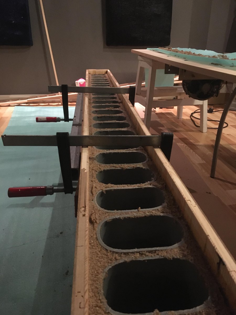

Just out of curiosity, was making sections of say 6 drivers sharing the same box considered instead of a separate box for each driver?
No, not for this build. I wanted individual chambers due to chosen construction method. If I'd have gone with shared volume I'd give one volume per 3 drivers (one volume for each chain, series, of drivers)
See image for reference, this is the back side - since sealed off before completion.

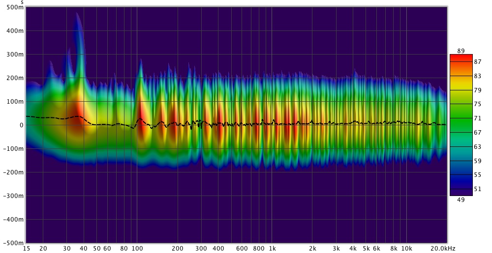

One of the things we used to say in R&D was that the worst thing that could happen is that when you first turned on a prototype, everything seemed to work. That made it easy to overlook some detail that wasn't quite right. But you aren't doing that!

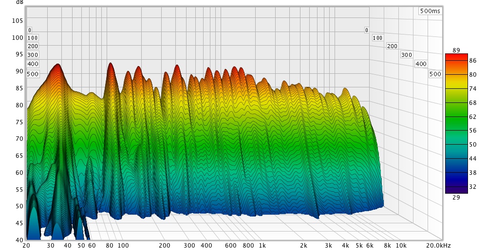

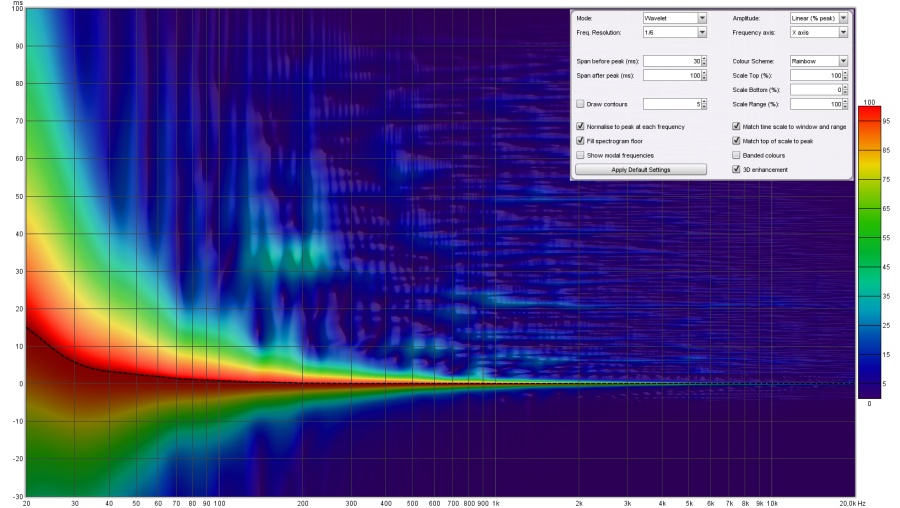

I don't see a lot wrong with the initial measurements you posted, certainly not above 320 Hz. Below that it looks like room interaction, except I don't see compelling evidence for that in the spectrograms, but you don't have your spectrograms configured like Wesayso and I do to show the room better - swap the axes and zoom in on the first 100 ms or so.
THD down about 50db down above 400 Hz is really good. Interesting that it starts to rise so soon below that, given what we said earlier in W's thread about where to bring in the subs. But THD is down in the noise and that may be affecting the accuracy, making it look worse than it is. Is that 80 db calibrated?
Do you have a quick reference for a spectogram view sharing configuration you mention? I did a quick search but didnt locate one
