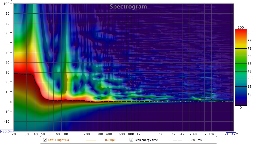

Definitely something going on with the room near 38 and 105 Hz. Given the effects there are spread over time, I would say a room mode rather than a reflection arriving at the delay necessary to cause nulls at those frequencies. It looks different at/around 300 Hz where you also had an anomalous dip.
Room dimensions are 4,85W x 3,90D x 2,2H (m)
38hz 9m and 105hz = 3,25m

Concrete is good for room gain and bad for room modes. 2" of absorber spaced out 2" is good for perhaps 400 Hz and up.
You can use REW's room sim tab to see its prediction of the modes and the bass, for what that is worth. Of course one measurement is worth 1000 simulations but if you can find some correlation between sim and measurement you can save a lot of trial and error.
Of course the first thing to do is to cut those big LF peaks down with miniDSP PEQs

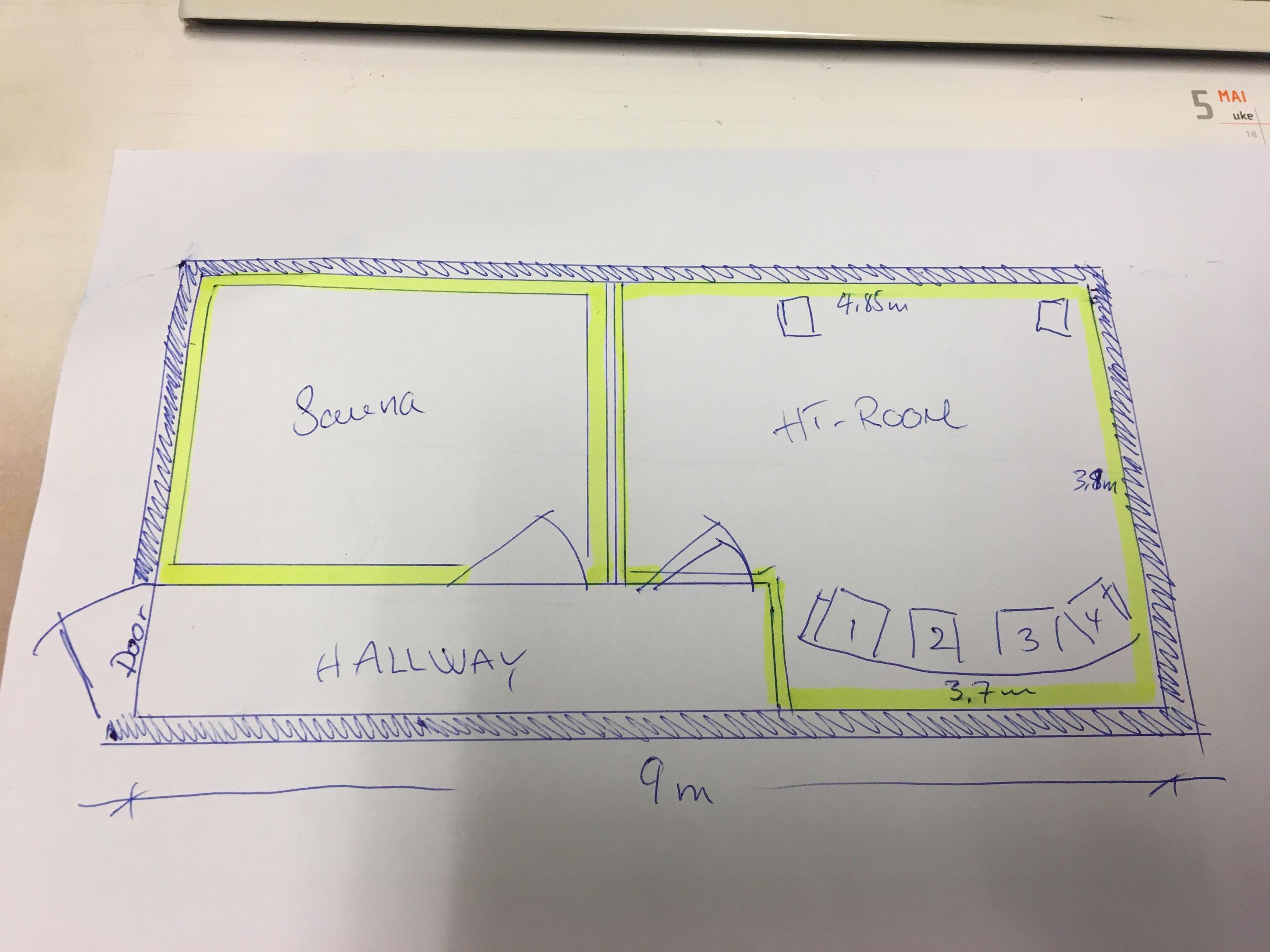

Here is a plan drawing of the area in my house.
Blue filled lines = concrete
Yellow lines = wood frame work/plaster board and insulation. These are kept thin without consideration of SPL attenuation There are no windows at all.
Pos 1-2-3-4 = a 4 seat couch / listening position
Hallway + HT-room listening area = 9m in width...38hz wave?

Did you install those slotted walls in the cavities? Any "w vs. w/o" measurements?
Are you thinking about the "Karlsonator aperature" I mentioned earlier? No, initial testing with the test chamber didnt give me confidence to continue with them. Not sure they are wrong, just felt adding those could give me more to deal with than I could chew.

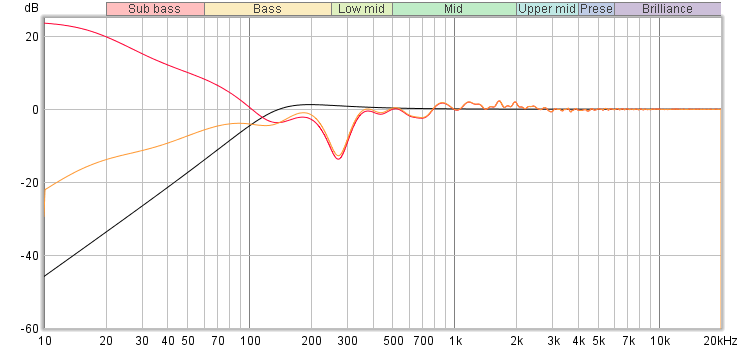

Was it the right array channel that had the close to 300Hz such out !!! below is a dirty quick model of trancducer position number twelve relative to floor using same 45 cm distance to rearwall and sidewall.
Black curve is 2nd order HP of 140,3Hz Q1 times red room curve results in orange curve.
