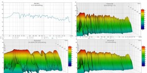

Here are the non-EQ measurements from sweet spot for top right (RT), bottom right
(RB) and LT/LB (1/12 smoothered). The idea is to use these measurements to generate EQ-profiles I can play with. (1/12 smoothered)
Measurements are done at 80dB calibrated.
For the Left side there is a bigger difference between top/bottom group between 40-90hz, otherwise they are more or less on line with eachother.
There is also a 3rd plot with the average response from RT+RB is shown, along to LT/LB.

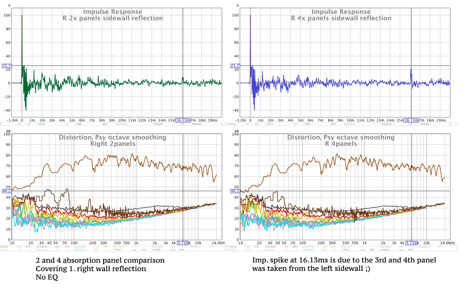

Here is a distortion and impulse measurement for the right array, this is the array that is close to the sidewall (approx 45-50cm). This wall have two absorption panels and I wanted to see the effect of more![radar :radar: :radar:](https://files.diyaudio.com/forums/images/smilies/radar.gif)
Each panel is 125mm thick, using 75mm Rockwool + 50mm air.
So left set of data is with 2 panels and the right side is with 4.
No EQ applied.
As seen the distortion drop in the 60-80hz range.
Funny side effect, the 3rd and 4th panel was taken down from the left wall and now appear as a spike in the IR!![rolllaugh :rofl: :rofl:](https://files.diyaudio.com/forums/images/smilies/rolllaugh.gif)

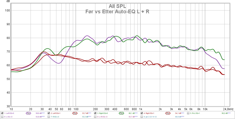

First attempt with an auto-EQ excersise just to learn what the miniDSP favour.
The SPL slope is a little too steep (13dB span) and too rich on the low end, will try a gentler slope next time. Vocals and string instruments a little too tamed down.
L + R measurements was done at 75dB and the miniDSP target level was tested at 63dB
