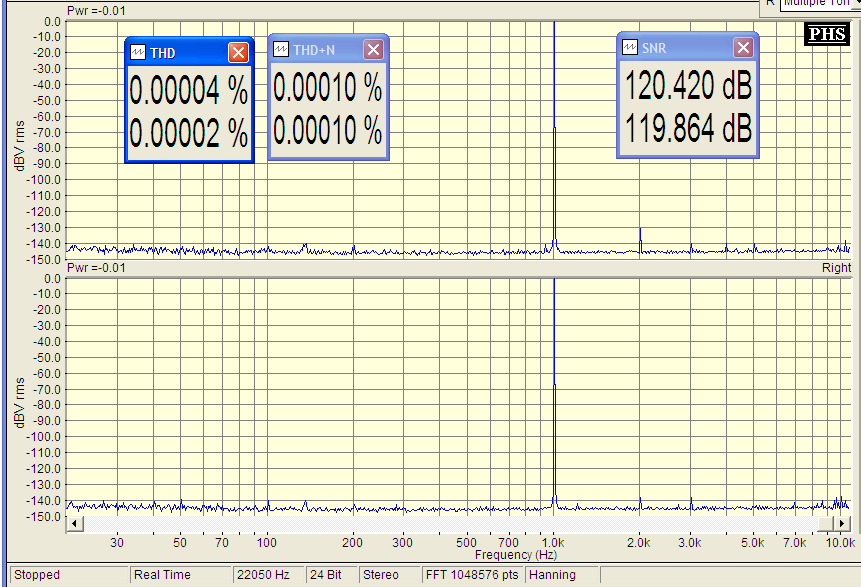

The official specs of the Xonar are over-flattered.
The official specs of the L22 are under-flattered.
As for the Xonar, I can't measure right now (as I've sold this card as soon as possible), but regarding the L22, the distortion of the ADC and DAC together at 1kHz is 2ppm. See pic.

That would be a big surprise and I would be very curious if you could independently (not "because I said so" as usual) substantiate this claim.
The L22 uses OP275 opamps, which are specified at 6ppm distortions (@1KHz and +4dB) and no less than 6nV/rtHz noise. Even the "poor" NJM2114 are specified at 5ppm (@1KHz and +4dB) and 2.7nV/rtHz and of course the replacement LM4562's are much better.
It would be interesting to find out how the whole signal chain can have 2ppm distortion when only the DAC opamps do have 6ppm. I am suspecting your comparison between the L22 and the Xonar to be (as usual) biased and not apple to apple.

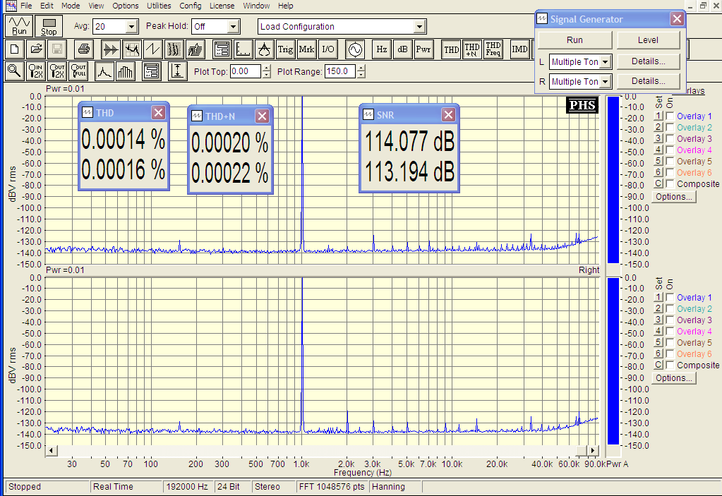

And this is my other card, that I was able to get for 50 squid (so under 10% the price of an L22).
It's a little noisy (noisier than the L22 and the Xonar), but then carefully count the zeroes in the THD box and check the noise floor... This is the stock unit, before any mods (better opamps, etc...). The noise distribution is clearly due to the lack of shielding in the noisy PC case, another thing a handy man could improve (thinking myself to add a mu-metal casing, not an easy job though).
Guess the brand and model (hint: it is still current and available on the market, both as new (100 squid) and used (under 50 squid), and has W7 x64 rock solid drivers available).
With 140dB noise floor, 2ppm distortions (@1KHz and 0dB), balanced inputs/outputs, digital I/O too, who would need anything more than this card for audio (except the cranky old dutch simulation afficionados).

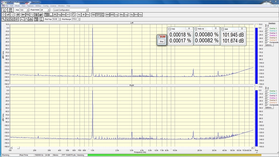

L22, same conditions..
Less noisy, as expected and already mentioned. You would think it's worth the money? :D
A brand new in box of mine just went on EBay UK for the stunning price of... 38 squid :D:D:D. Of course, if one already owes a L22, there's little reason to look for anything else. Otherwise, as a hobbyst, to buy a new LynxTwo or L22 today you have to be either a snob, or equally rich and stupid.

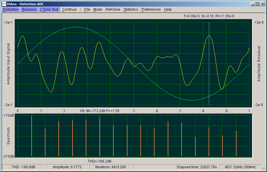

And this is what can be achieved with my distortion analyzer and 10 years old sound card:
Test signal: 19201Hz, BW: 250kHz, measurement floor < -160dB. Harmonics are around 2ppb. I wonder if this is possible with a Xonar Essence, despite its gold plated bracket. :rolleyes:
(NB: All done in software; no analog distortion magnifier or notch filter has been used.)

Hi Harry,
I don't generate a 19 kHz test tone with -160 dB harmonics, instead, the measurement floor of the whole setup is 160dB down. How? Sorry, I can't tell because of commercial interest. The same applies to that 250kHz bandwidth, which, btw, is not the BW of the sound card (normally Fs/2), rather a constraint imposed by the software.
(The 'software' BW is much higher than Fs/2. Hint: think of undersampling).
E.
Hi Harry,
Then I obviously don't understand what you mean by:
Test signal: 19201Hz, BW: 250kHz … Harmonics are around 2ppb
Or your screenshot showing a sinewave and a measurement reading that states "THD = -168.2 dB"
Where is that sinewave coming from?
