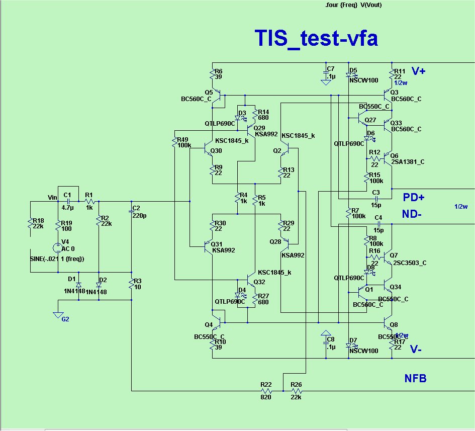

May I build it ? (trans-impedance stage).
Works with exceptional performance , BTW.
Thanks, OS
Of course, you may build it.
Cheers, E.
Cheers, E.
I said it worked very well.
I made a CFA and a VFA version (close to the concept art).
(below 1 = CFA/ below 2 = VFA)
10ppm 20K -100w with each .... but lowish pssr on the CFA one.
Not really any better than a Baxandall or Hawksford.
Is there some other aspect I may be overlooking in performance ?
(Versus a simpler transconductance setup).
OS

Hi OS,
>"Is there some other aspect I may be overlooking in performance ?"
Yes, there are a few essential aspects:
1. Input inclusive compensation (MIC).
2. Using pre-drivers, because the current gain of the TIS is just unity.
For utmost performance, it is also recommended that the collectors of the pre-driver are bootstrapped, see fig. 6 or 17 of my web page, because the TIS output is very sensitive to a nonlinear (capacitive) loading. As you certainly know, Cob vs Vce is far from linear.
Cheers, E.
