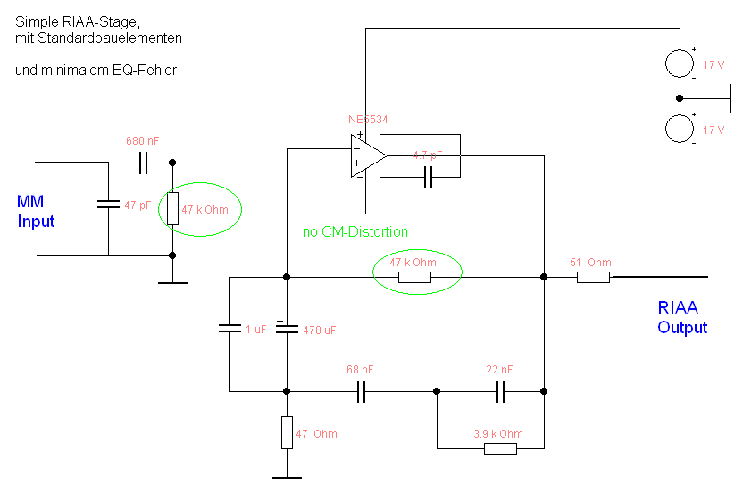

You've got it.(...) I'm not sure if I'm more intrigued by the phono or the presentation![]()
The circuits of the old masters of the 60s and 70s are more interesting.
I actually find these passive stories the least interesting. The whole theater is somehow dependent on the mood.
Let's build a SUPRA, the ancient Elektor circuit or ...
You could also simply use all four well-known network topologies in a switchable way, in the hope of finally finding the ideal today.
Or once again a kind of SRPP.

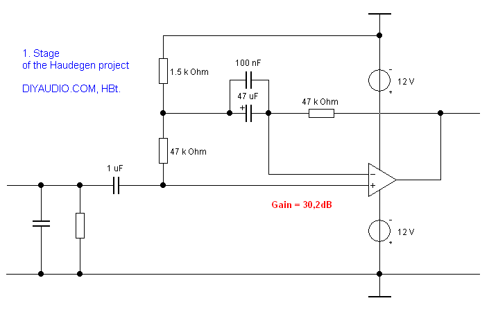

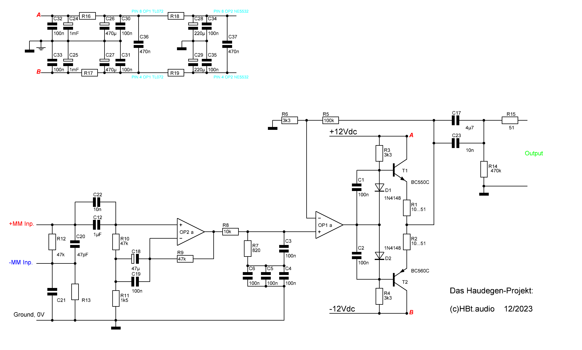

1. Stage:
Now that the project is clearly outlined and we are all just boiling water, I decide on the first stage.
I will use the NE5532 as the operational amplifier, U1a for the left channel and U1b for the right channel. The result should be absolutely inexpensive and small in form factor. All the components required can usually be found in any standard range /boxes.
You can play with the component dimensions for the purpose of optimization. Feedback regarding any errors is welcome.
HBt.
HBt.
A short excursion into reality:
5mV(rms) multiplied by 100 is equal to 0.5V(rms), which corresponds to a peak of 0.707Vp.
We could also calculate with the infamous 2V(rms), I have done this countless times, always with the same result
. Given a load (our input resistance of the preamplifier, for example) of 10kOhm +/-j0Ohm. Our last stage of the Haudegen project should now be able to supply a current of 0.0707mAp. With R_load=1kOhm it is 0.707, we generously round up to 1mA.
Any operational amplifier can supply this current virtually undistorted.
If you compare the internal output stage of an NE5534 with the classic JLH class A amplifier, for example ... you'll go crazy with excitement.
The gimmick of an additional, flange-mounted push-pull power amplifier is normally nothing more than a gimmick.
I will, however, also give the TL072 a small afterburner, but for other reasons - even if the additional circuit is actually nonsense.
I don't want to build a headphone amplifier at the moment.
More on this later ...
HBt.
(depending on the load, the quiescent current could be in the range of 353µAdc and 3.53mA - and we are still talking about class A. The most common extremes are included in this average estimate)

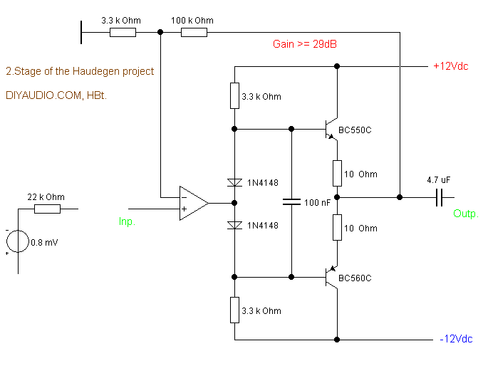

2nd stage now:
Now the output stage looks completely normal, just like in the textbook - and it will work perfectly. The prototype will ultimately show whether minor adjustments are still necessary. The only thing that interests me personally is the distortion spectrum and of course the noise.
HBt.
HBt.

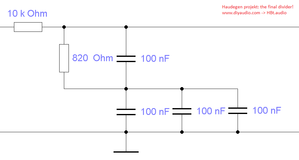

The final center:
The initial situation is now ideal: source resistance almost zero, no load on the complex voltage divider!
Without exception, only standard components are used. The resulting approximation is amazing, no fiddling is necessary.
Here is my final proposal, now the three groups just have to be plugged together ... It's all very simple.
The overseas client can consider his catalog of requirements fulfilled, but it is doubtful whether our CEO will be satisfied. He can't win a flower pot within his Rotary club friends with this circuit. Alois Lederhose, the boss, will go berserk, but Haudegen couldn't care less.
What SNR will this project achieve?,
HBt.

Lower corner frequency:
However, we can make excellent use of the criticized capacitor (47µF/63Vdc + 1µF MKT) in the feedbackloop of stage one.
We determine four values for four cut-off frequencies, 5Hz, 10Hz, 15Hz and 20Hz. We make the scenario switchable and call it a soft subsonic filter, the last setting we call IEC/RIAA.

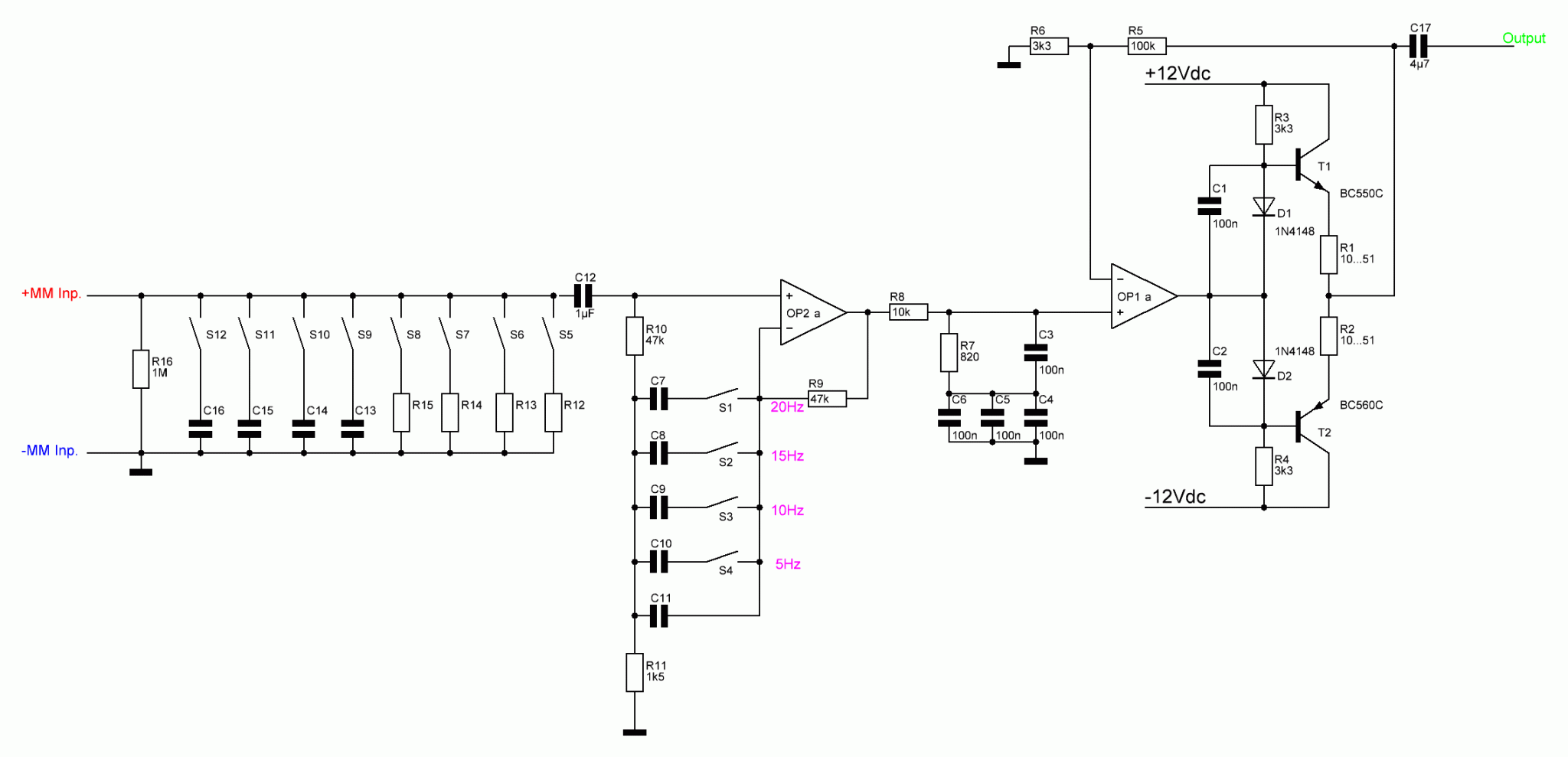

Overview of the EQ:
As promised, a complete circuit overview of the equalizer can be found in the file attachment.
Of course, this is not yet the final version, but everything that follows are marginal (and yet important) details.
Questions are welcome, as are suggestions or even cooperation.
Best regards,
HBt.

I'm adding a symmetrical power supply unit to give the project another boost.
LM317 and LM337 will also do the job.
But Technics had once built a controller that I liked, oh, we'll copy the main features of it now.

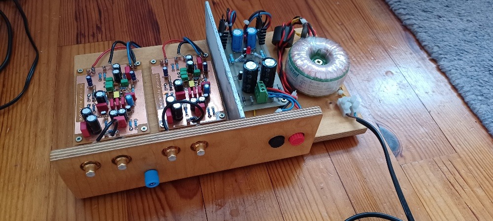

Do you have something like the picture in mind as a test setup?
There are other DIY-style structures in my photo album.
Mounted on a wooden board it's the most fun - I used the kitchen extensively, until my first analog oscilloscope complained about the frying fat.
And now for the riddle: which commercially very successful equalizer is in the picture?

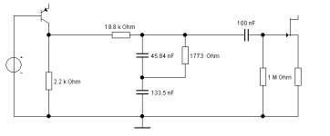

I do have a question regarding the RIAA network.
Probably I'm missing something but I got the 820//100nF but for the 300nF the parallel 10.6Ohm is missing.
For my understanding the 10k in series - if not part of the feedback/gain of the first stage - is probably misplaced in the drawing?
Somehow I need to get my whiteboard back to calculate 2/4pole networks again in a proper way.
