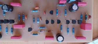

I must admit a well documented summed up project - I wouldn't mind having one of those PCBs but can't provide one.

For me, DIY actually always means that I create my own layout.

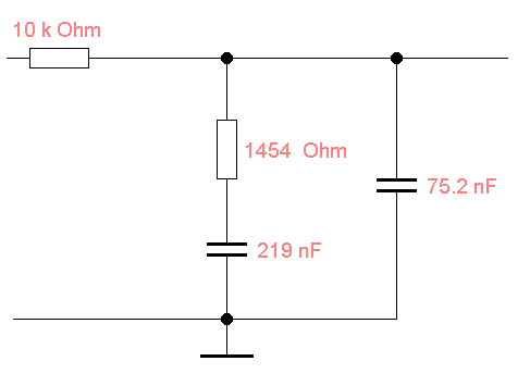

Networks

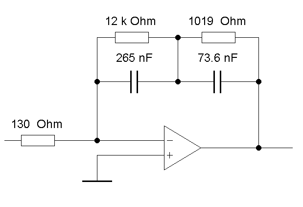

The following ensemble may be better known. DIY is actually like a big LEGO construction set. We can also rearrange the passive voltage divider a bit.
We have to leave as soon as possible, tragically Haudegen's landlady has died. They lived under one roof for twenty-eight years, almost like Mr. Holmes and Mrs. Hudson in the Baker Street of London. Tomorrow we must now pay our last respects to her. It is a great drama, an immeasurable loss, a shock.
Networks
Our LEGO bricks are becoming more colorful:
This network, a complex resistance, can be also activated.
Let's see
(two other networks are very well known and can also be found in ancient table books)
Let's see

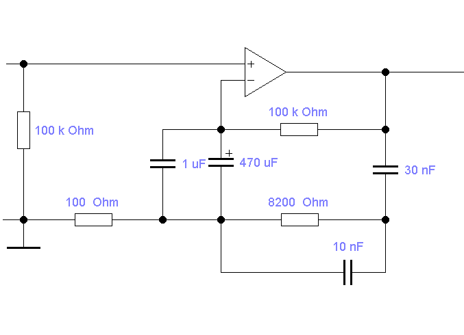

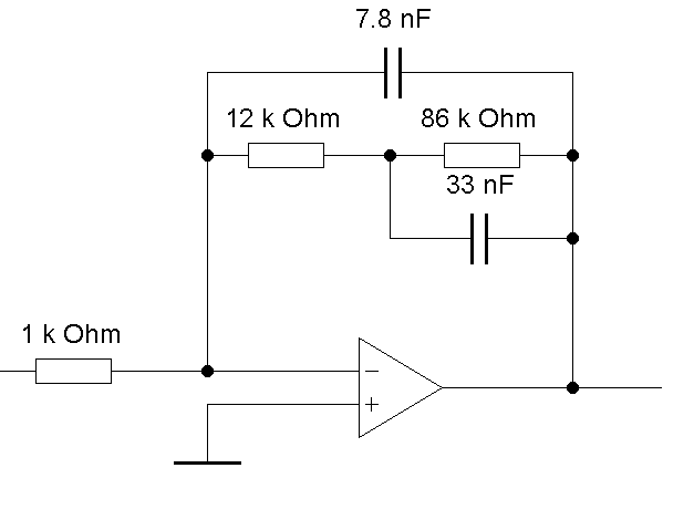

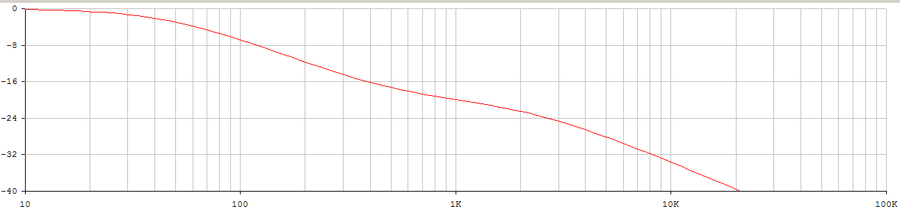

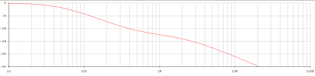

Networks and two poles

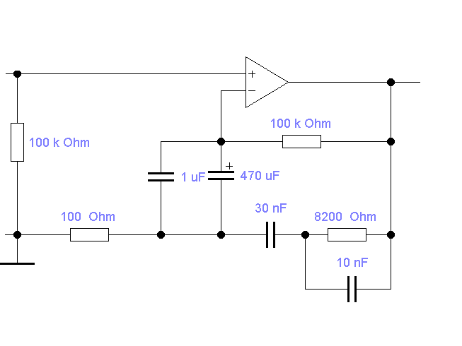

Let's call the better known of the two dividers number 1 and the one I prefer number 2. Then there are two complex resistors missing, number 4 can be found in almost every commercial product. Number 3 is largely unknown. We juggle with these components, including the operational amplifiers.
Would anyone like to prepare a summary of the best-known implementation options and set out the dimensioning rules? Questions?
Yes, Haudegen is also a kind of detective with mild Asperger's syndrome. I hope his therapist will leave him in my care for a while longer and won't be so strict with us. She's so sweet.

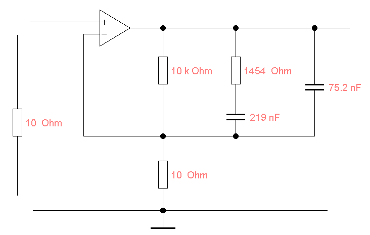

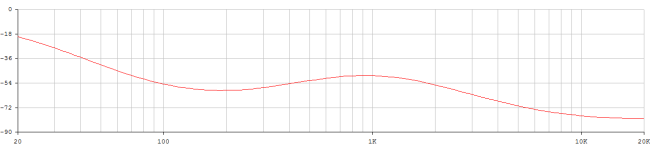

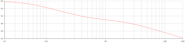

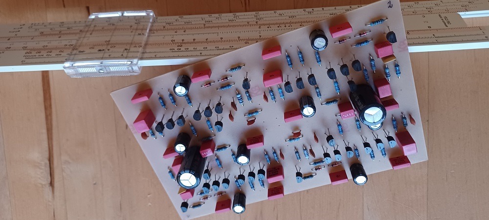

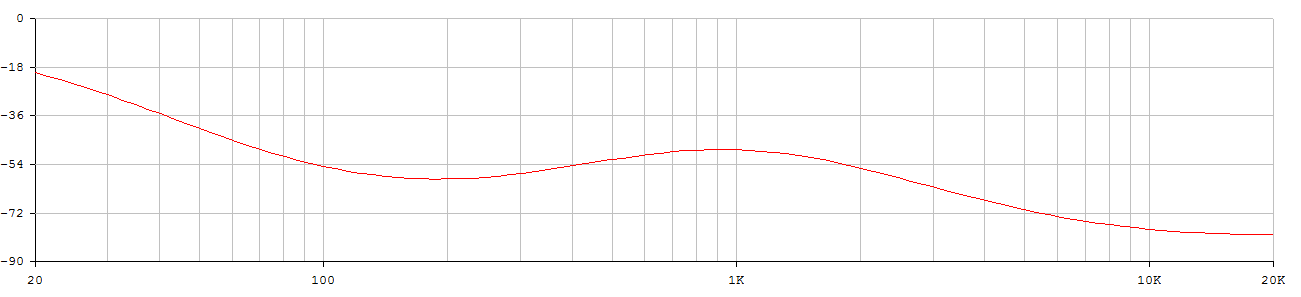

From the evidence room
Network 3 in discrete single-ended circuit, a total of four discrete operational amplifiers.

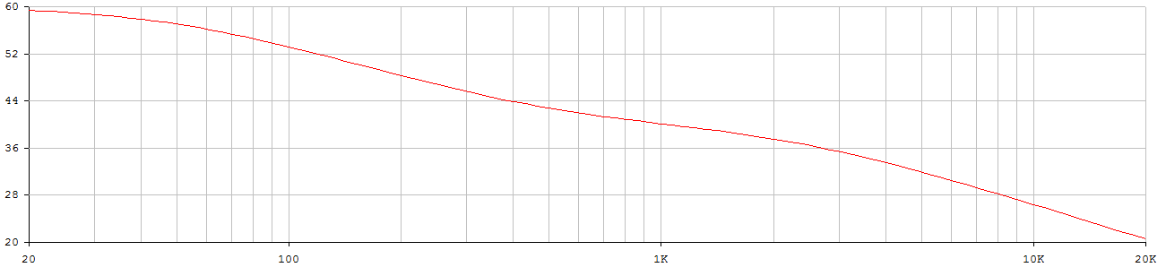

Measured deviation at 30Hz -0.5dB and at 16kHz +0.3dB ... k is relatively large with less than or equal to 0.2%. Everything under full scale just before clipping. The preamplifier is mainly built with PNP and the actual equalizer with NPN transistors ... they are virtually a mirror of each other.
In normal operation, the k>0.001%, so everything should be totally normal.

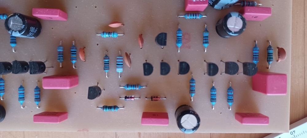

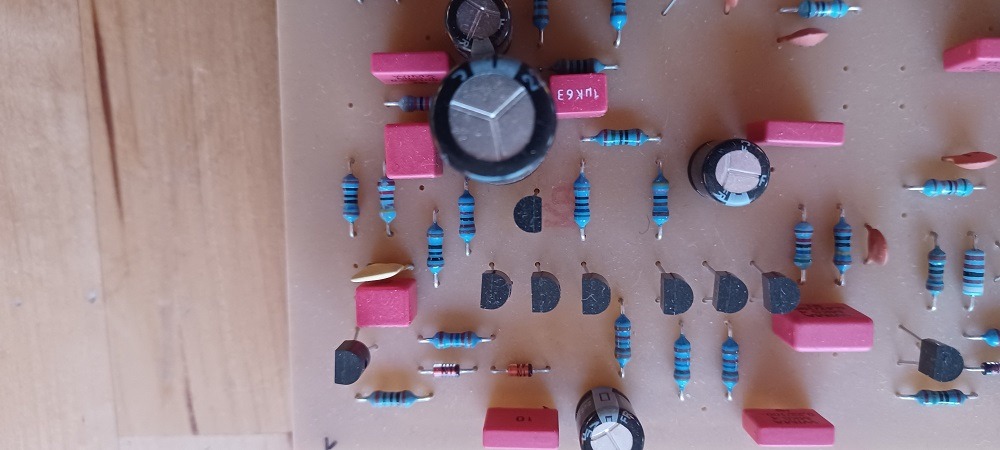

Before deciding the type of RIAA network I like to suggest to get rid of the OPs.
There is a very well regulated PSU and not a wall wart amps - why not push this project any further.
The input stage could be done with a complementary differential amplifier with gain and RIAA in the feedback section.
For maximum stability a current source with an additional transistor, 1-2 resistors and diodes would be a nice feature.
To achieve a low noise input stage and build a magnifying glass for the MM we need transistors with a quick slew rate to avoid limitations.
My mayor issue is to find any that are not SMD types - my fingers can't handle those fiddly thingys.
Easiest can be the good old BC550C/560C types but there are better ones - hard to say...

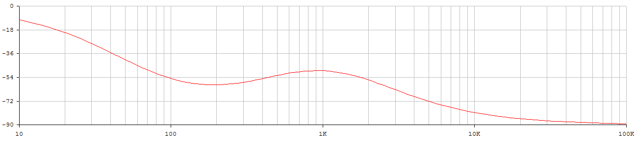

The solution that immediately springs to mind is a reboot of the equalizers of the NAD 3020i and the AR A-03. Suitable low-noise bipolar transistors exist on the market and I'm sure I still have some in stock. But now we are moving far away from the original idea and becoming sensible and economical.
I like your approach. As a network, however, I would then consistently use number 4. There is still a lot to consider and learn here.

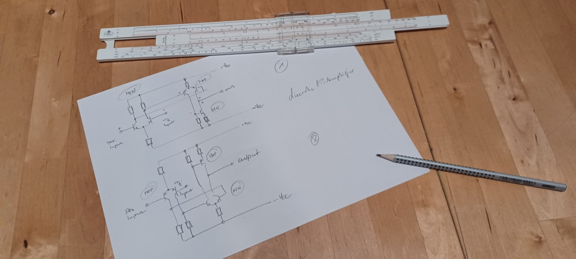

My friend Haudegen and I are sitting in the car, this time not in the clunker, I gave the Fiat500 to an old fisherman. More mass, smoother running - and my co-driver falls asleep straight away, he's having a good time. Okay, I'm the engine and he's the brain.
Take a look at what he just scribbled on the paper. I can tell you it's going to get me into a lot of trouble with his doctor. I have a bit of a crush on her. If he has a nervous breakdown now, it'll be my fault.

Two differential amplifiers and one unbalanced output. That should be the basis without a SUPRA clone seeing the light of day and without us copying from NAD or Acoustic Research. Install PSPICE and search for suitable models.
